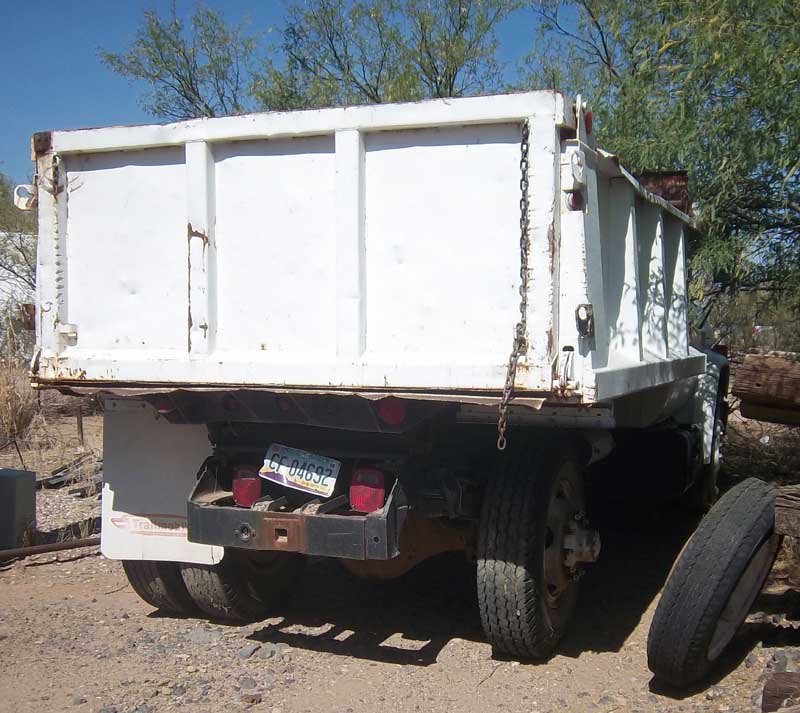

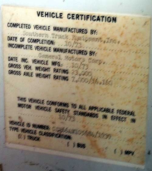

Your truck should have a tag similar to the picture, the top line is the maker or installer of the dump bed. The lift capacity of the hydraulics may or may not be up to GVR of the truck. If possible check with the dump MFG on lift capacity.
The reason your doors open sideways is for dumping bulky light loads. Great for brush and that sort of thing. With a standard dump bed brush and light bulky loads can hang. Twice I have had to use the back hoe to pull a load of brush out of the bed.

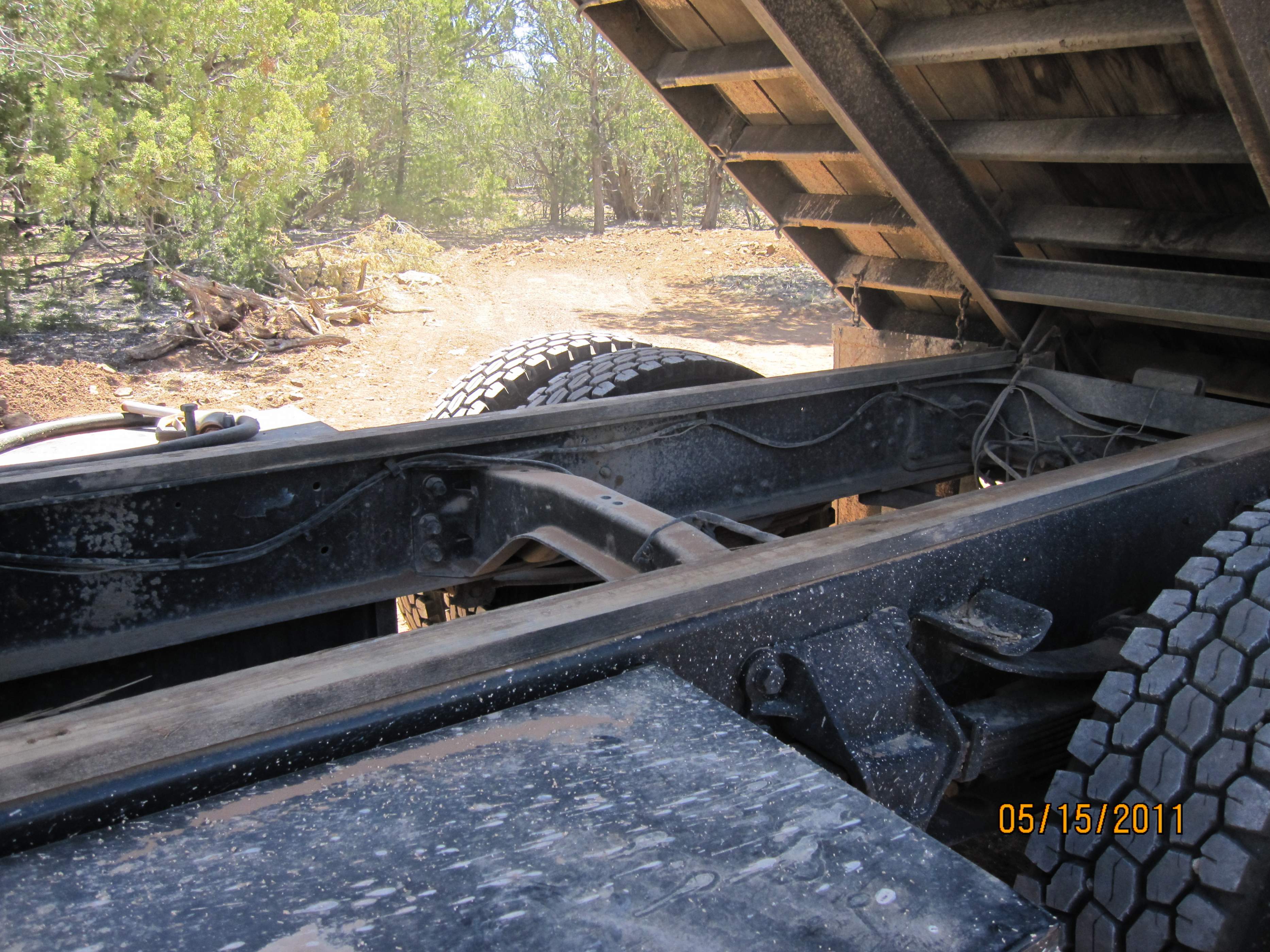

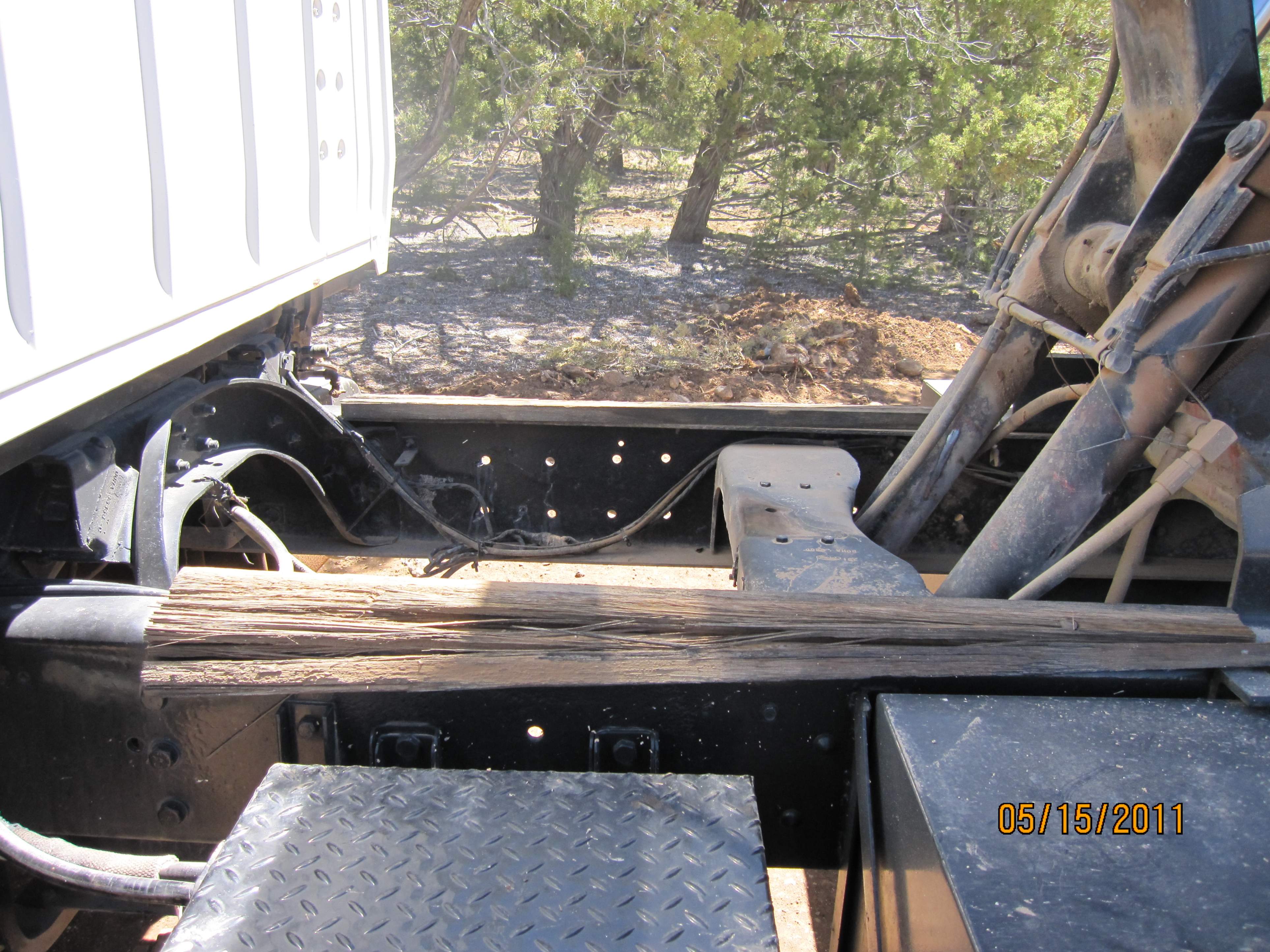

Thanks! And thanks for all the info too. The dump bed has a metal brace tube that you can swing down, and then let the bed down until the pressure is off the cylinder. I used that when I was snooping around under there. There are wooden frame rails (1 X 3 boards) screwed to the frame and the bed sits on these. The back ones are in good shape but one has broken loose (first picture). The front ones are cracked and beat up (second picture) and need replaced. Is one kind of wood better than another for this purpose?

The wood is meant to act as a spacer, cushion and sound deadener so you don't get the loud metal-on-metal crash bang sound when going over bumps with an empty bed. I'm guessing pressure treated wood would be just fine.

Oh, and about the wood under the bed, pressure treated is not so good touching metal, they say it causes metal to corrode/rust faster. I think I would try to get some oak, etc. Nice truck there!
