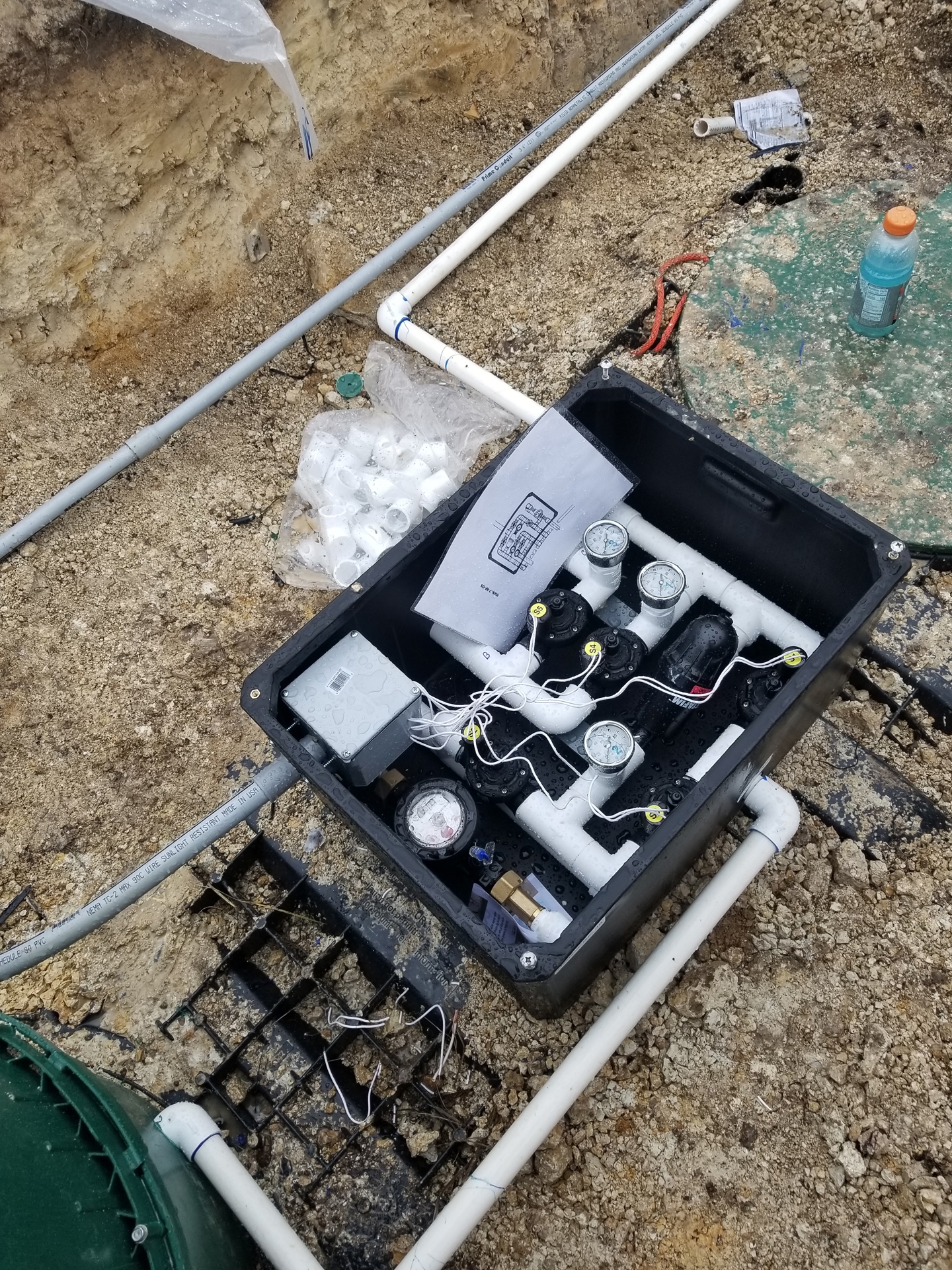

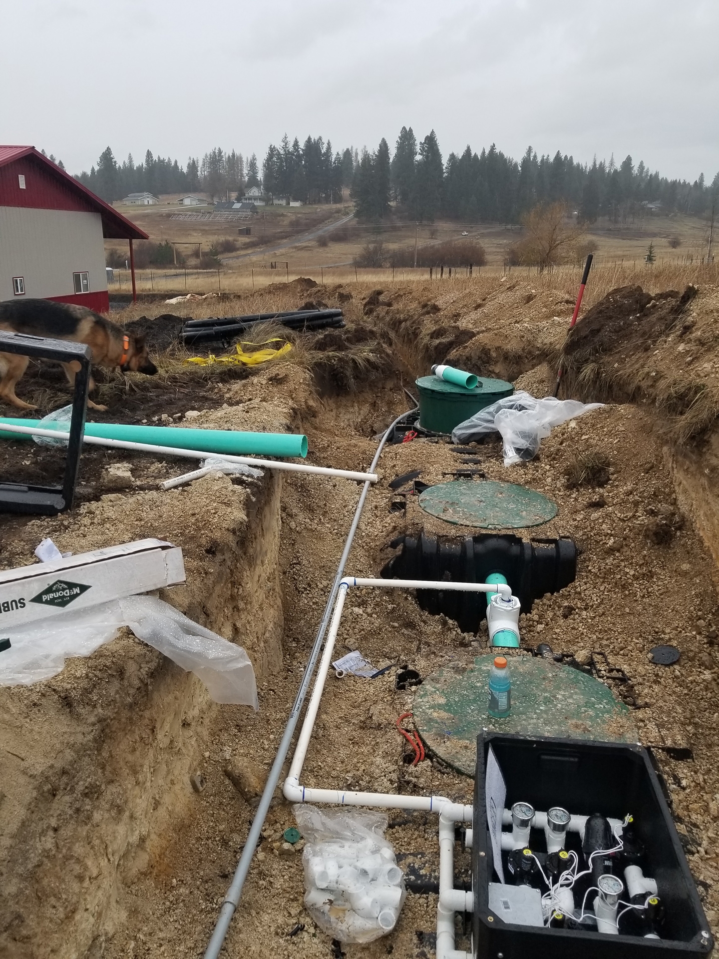

i do the electrical for a guy that installs very intricate systems to use on lake front property. some consist of 3 x 1000 gallon tanks and sand filters. plus positive pressure drip systems. the control side sucks

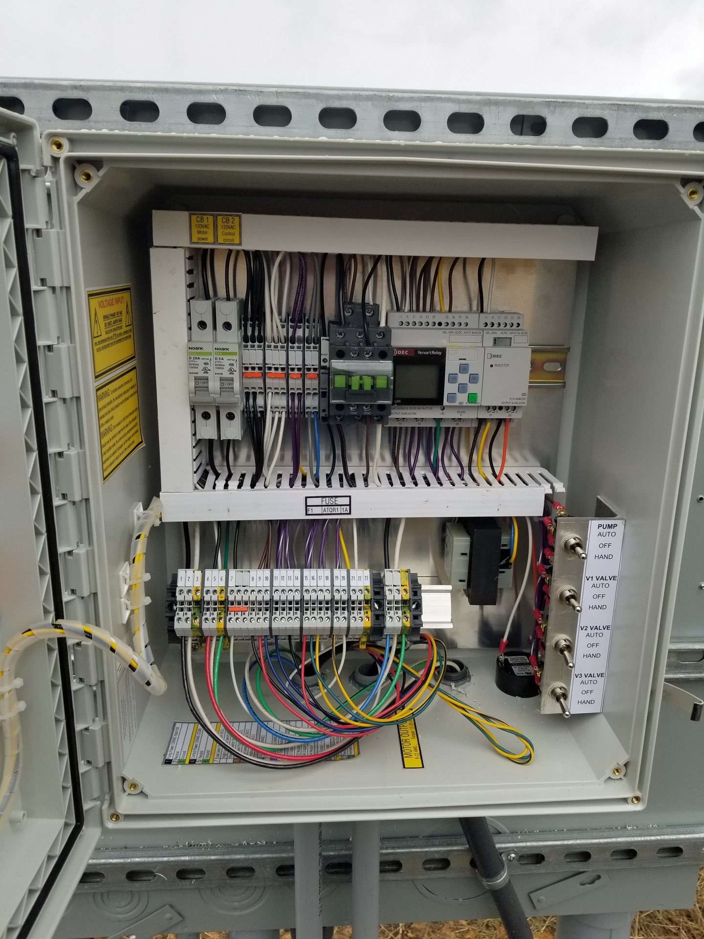

Yikes! My septic controller looks like this...
/ DIY septic tank and drain field? #51
If-then-this
I just looked up ladder logic….
Been so long since I have written any, and have forgotten so much!
Close to 30 years since we got rid of ladder logic!
