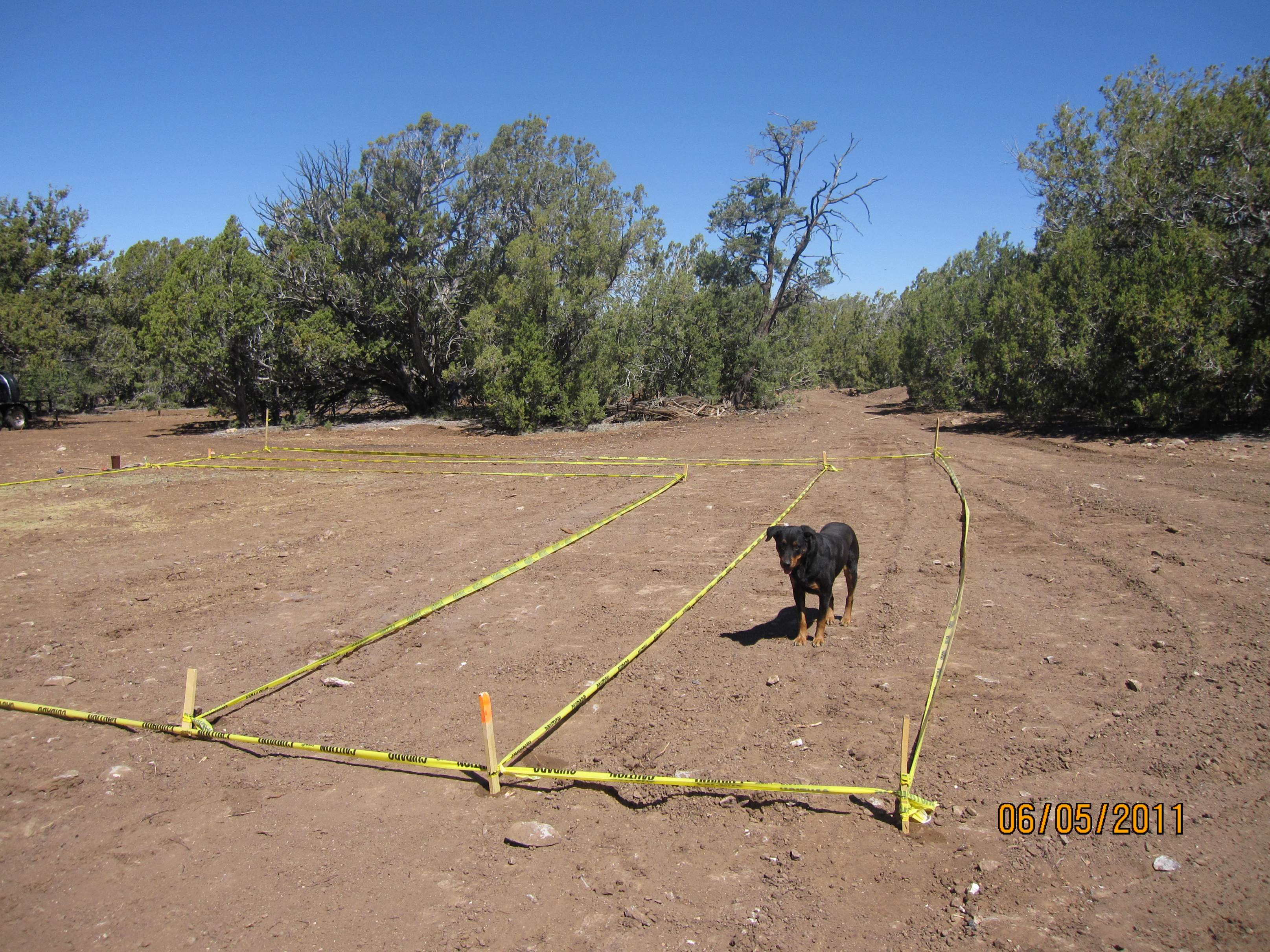

This weekend I was marking out lines for a 30 X 30, a 35 X 35, and a 40 X 40 cabin. I think 30 X 30 is big enough for the two of us but mama thinks we need 40 X 40, so we'll compromise with a 35 X 35.

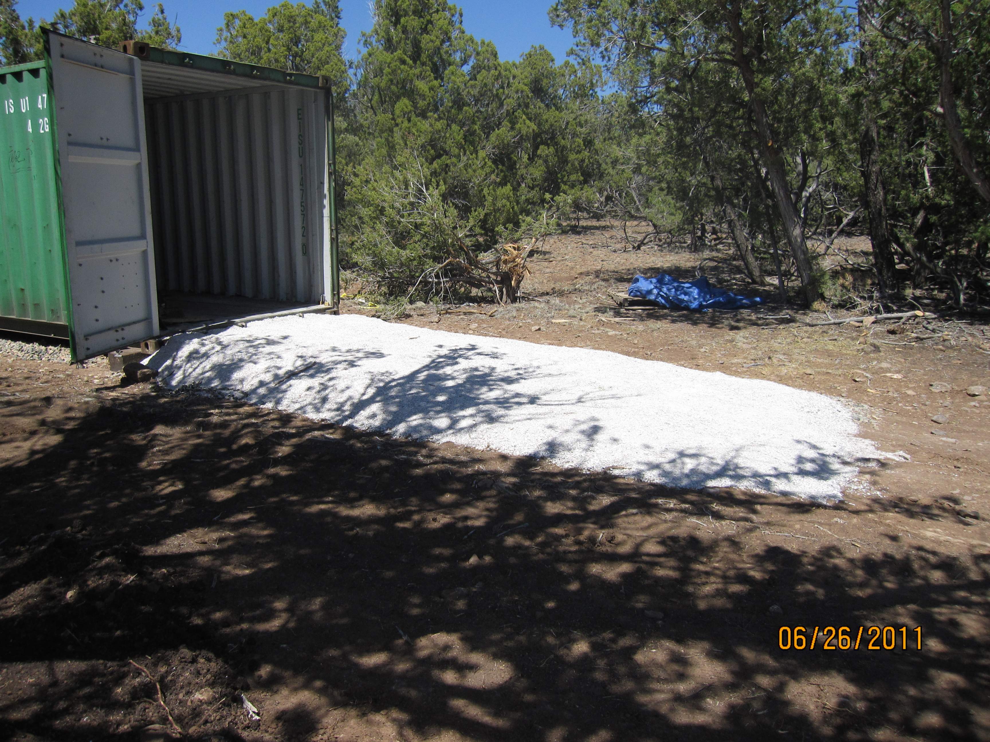

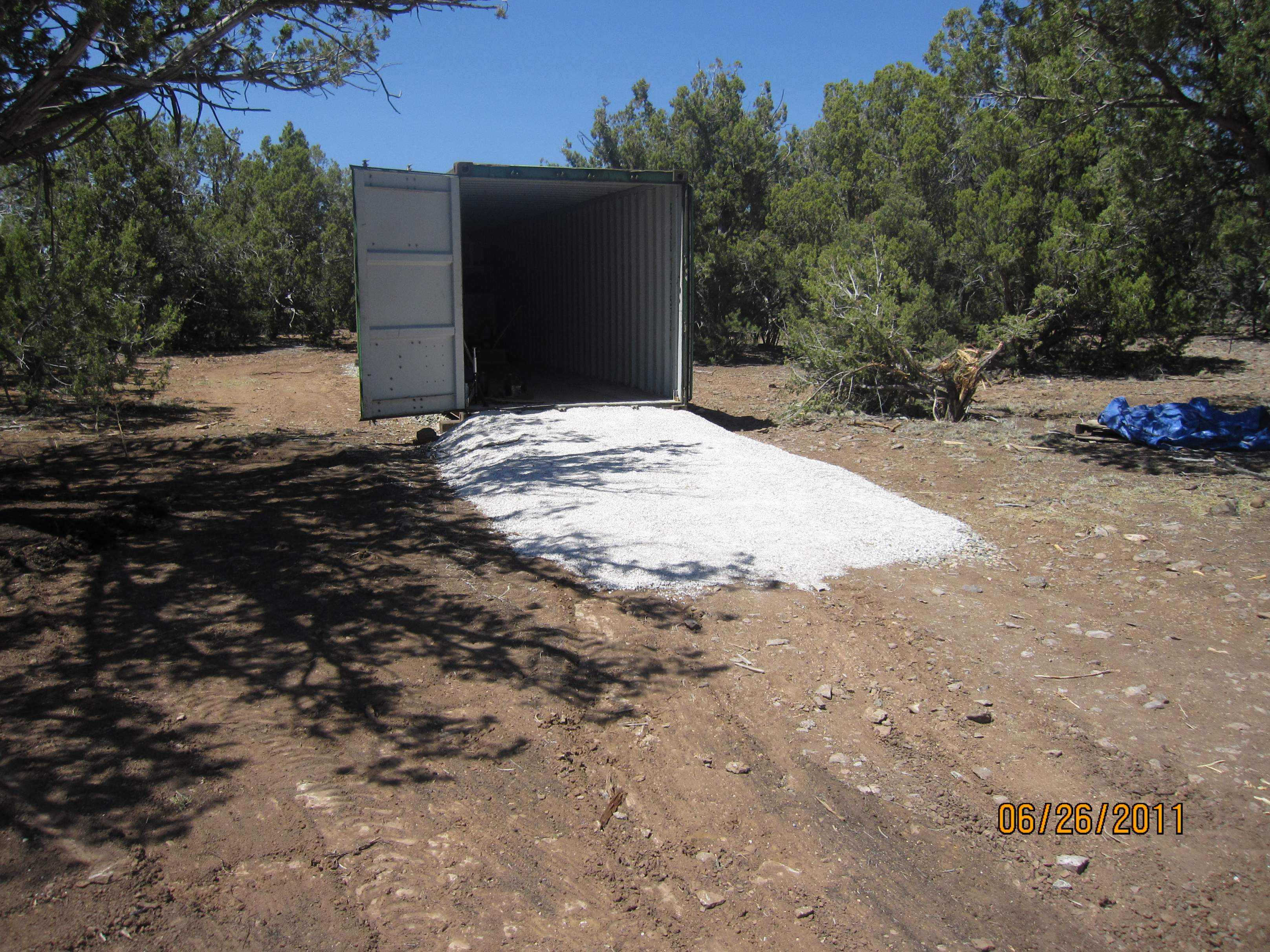

One weekend when I was hauling chat, I decided I needed a better ramp to get up into my 40 foot container. About 4 ton of chat does very well. And after it got rained on it got very hard. I like it. No more dragging the scraper when going in and out or banging the bucket when the front wheels drop off the edge.

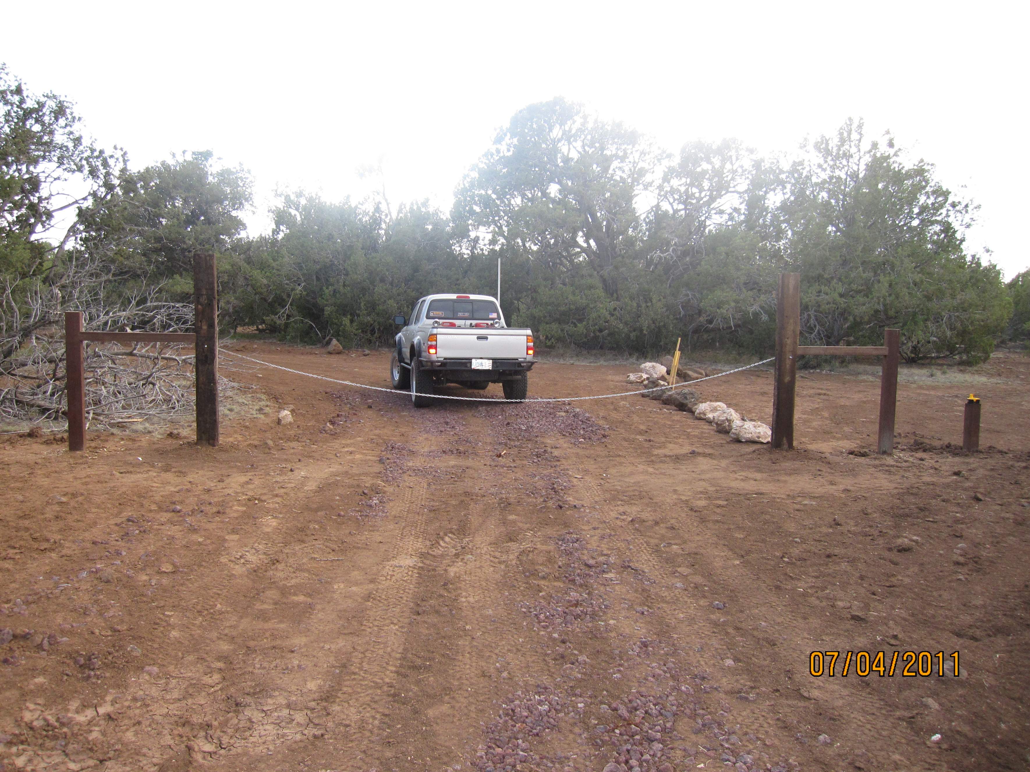

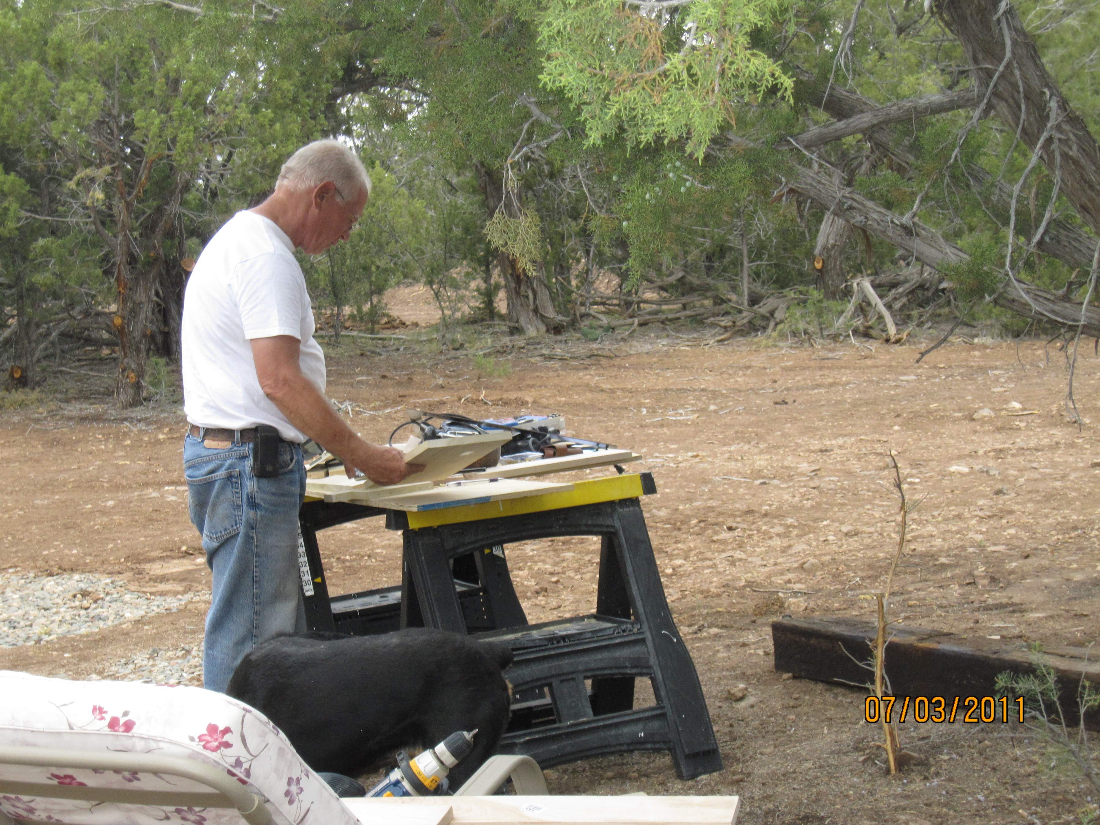

This past weekend was one for woodworking. I made several items for inside the trailer (shelf for DVD player, coat rack, etc.) and then I made the holders for the gate at the end of the drive. I put a couple of RR ties in the ground and braced them with 4 X 6's. I just have a chain between them now, but I plan to put up two 10 ft gates. I buried the RR ties and the 4 X 6's to a depth of 24 inches. I hope that is enough to prevent lifting by frost. It was all the farther I could get my post hole digger to go.

24" is plenty from a frost perspective up at the Ranch. Our average frost depth is only about 6". All of the piers for our cabin and porch and shed are around 2 - 2-1/2 ft deep. They haven't moved in the 7 or 8 years they have been in place. My water lines are 1-1/2' to 2' deep, and have never frozen.

What you call chat looks like recycled concrete road base that i can buy here. That stuff is pretty useful. I need to get a truckload before the summer is out to fill in some soft spots in our driveway.

The "chat" is a byproduct of the limestone quarry after they make the good stuff for the concrete companies. It is great for driveways.

Thanks. That's good to know. This time of year the ground is hard as rock. If I do need to set them deeper, it will have to be in March.

Yep, your chat sounds similar to the recycled concrete road base I have available to me.
