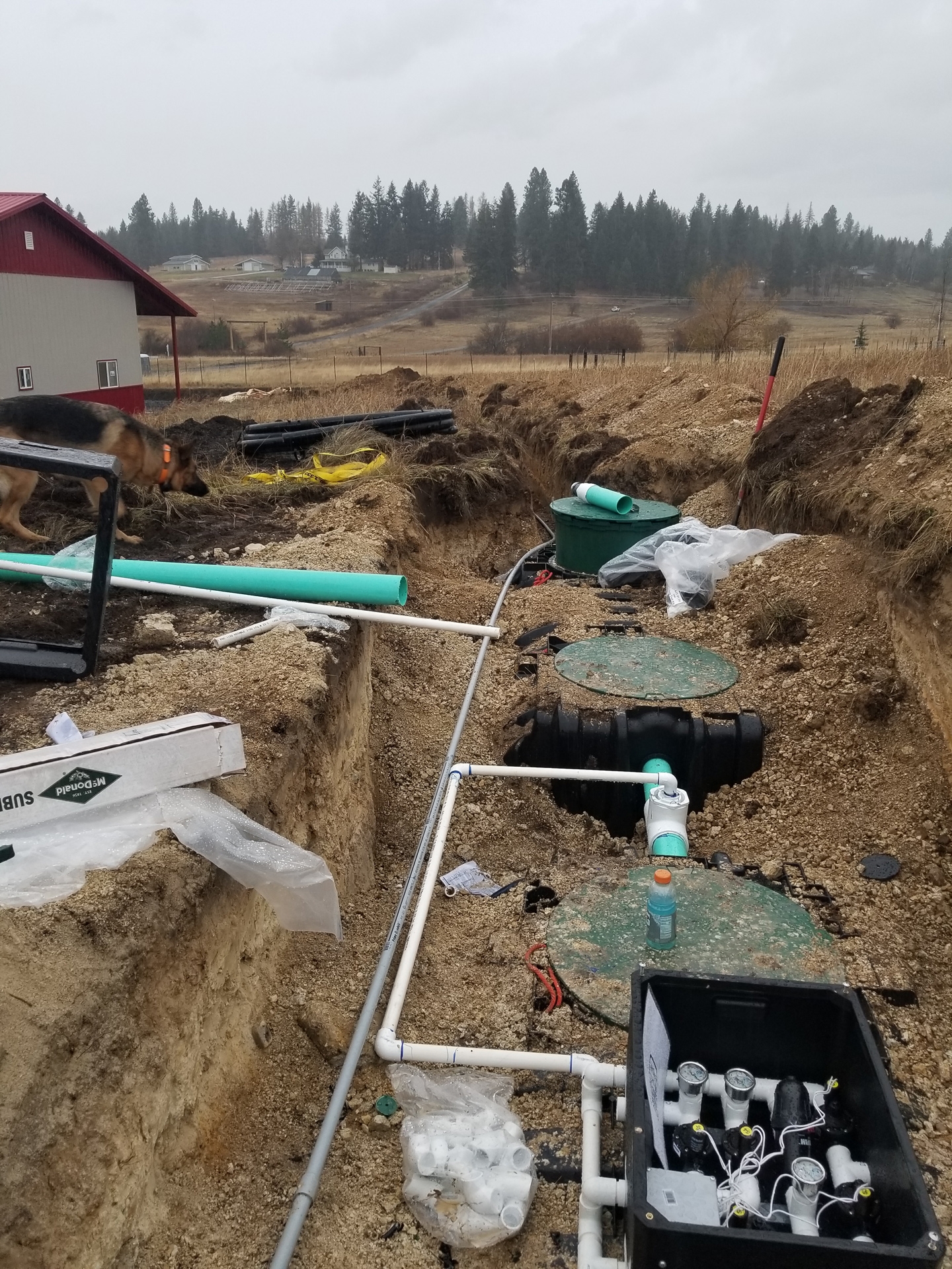

i do the electrical for a guy that installs very intricate systems to use on lake front property. some consist of 3 x 1000 gallon tanks and sand filters. plus positive pressure drip systems. the control side sucks
Yikes! My septic controller looks like this...
