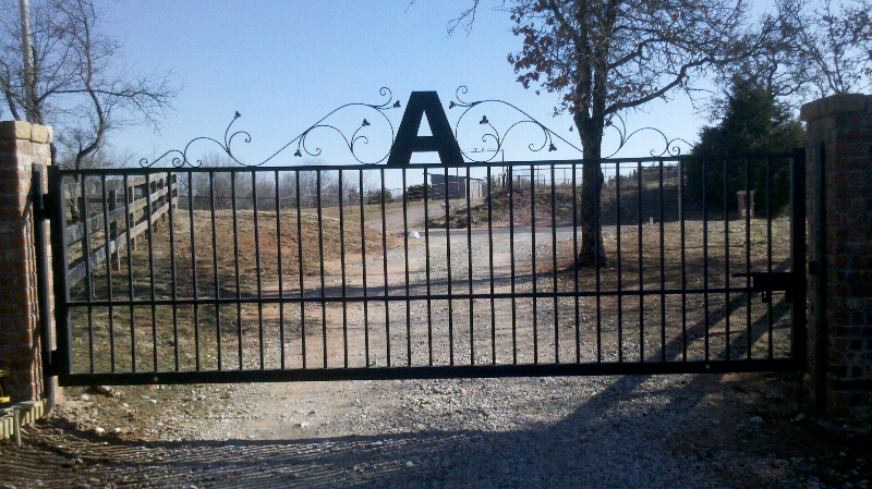

Sooner or later im going to install an automatic opener on the gate i built. Its 14' and about 500#, but opens very smoothy. I dont want a piston opener. I plan on installing a pad mount unit also, but too many other expenses right now. \
Some day ill get around to installing it.View attachment 306064
Neat gate! You do that yourself?
/ Automatic Gate Opener #27
Oops! Sometimes it pays to read the text, no just gawk at the pictures.
yup...built it a few years ago. Had to make and install a 1/4" thick 5" x5" post and have it powder coated white to match the vinyl fence and still be able to hold the gate up without a wheel or a torsion wire. The gate swings freely.

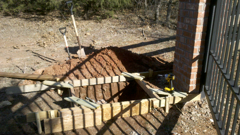

Got the forms built and in place. Now ready to mix concrete tomorrow for the pad. Got a buddy that might stop by to help for a while. Heres a shot of my gate and my progress. You can see "little mans" shovel that i got him. We used his other one in our flower beds, that was until i backed over it with the tractor and bent it in two.

The pad will be at least 24"x28"x16"+ deep. Ive thought about mounting the keypad to that tree along side the drive, but im not sold on that yet.
We are required to have a KnoxLock on the outside for emergency personnel entrance. Ive heard stories where a house burned b/c a resident didnt pay their annual dues to the local fire district. The FD still came out to the fire (to keep it from burning the neighbor's house down.) I would think if you didnt follow code and get a permit and your house burned b/c the FD didnt put it out, your homeowners insurance might be a bit P.O.'d....
I don't know what soil type you have at your place but I would make the pad significantly deeper than 16". In fact I would drill a hole below frost line under it and use few rebars to anchor the pad to it.
My gate is light "farm gate" hinged on about 10-12" post that goes 5 feet in ground and the opener turned the post small angle with every opening or closing. I had to anchor the post to the next post to stop it.
Wish you success with your project.
