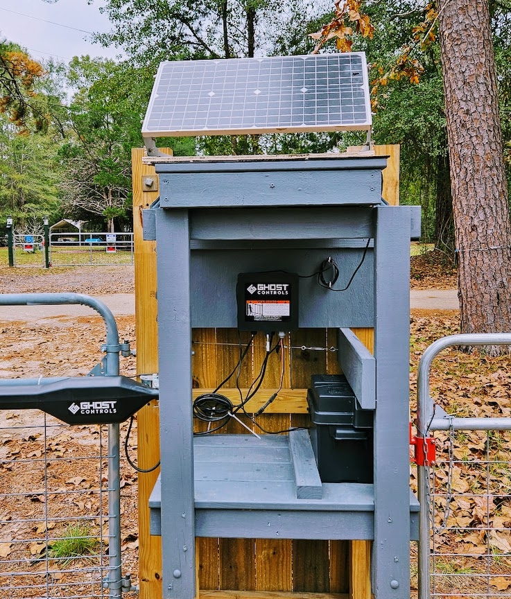

The battery for my automatic gate opener is a 12-volt Duralast 24MS-DL Marine Starting Battery. It has been in service over six months and has never needed to be charged even though the gate is operated several times every day. In other words, everything about my Ghost Controls opener has been extremely satisfactory.
Today, I decided to check the state of charge since we have not seen sunshine for about a week. The battery seems just fine but the state of charge as indicated by the output voltage is what I don't understand as it is over 14 Volts. See photo.

Water gets into the battery box thru the vents. Going to make a roof over it as it is partially exposed to the elements. See

To me, I wouldn't be too concerned, however, I would either unplug solar panel or throw a towel over it (cover completely). Open & close gate a few times with just battery not being charged. The higher voltage apparently is because the charge exceeds the intermittent gate motor load. Even cloudy panel is still charging some.
Just looking at pictures to me it's a nice set-up but maybe a little overkill...the solar panel & battery exceeds use time cycles.
Me, as an electronic technician, I would probably try a temporary experiment like a 12 volt landscape light or two, especially with a photocell (dusk/dawn). That gives a 1 or 2 amp load on battery.
