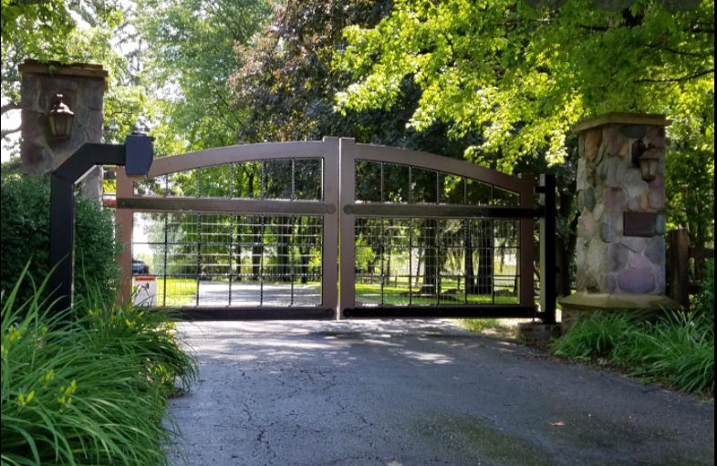

I want to add an automatic entry gate. Two 7' bi-parting gates, outward swing. 14' width totall. One exit loop, and an entry keypad on a gooseneck. I will probably have two rock columns to the outside of each gate post, but might instead do a rock wall.
My asphalt driveway has been removed, so now is the time for any additional prep. I've run hi/lo voltage conduit to each post, and lo voltage conduit to the loop and entry keypad. I will also excavate the holes for posts, columns, and entry keypad.
Regarding the gates, my question is whether installing the posts, columns, gates, swing-arms, etc. for an automatic gate is a DIY type project I should tackle. I've watched videos from gatedepot.com. They look self explanatory but it also seems there are many ways for something to get out of tolerance or go haywire. I'm not sure if I should contract with a fence/gate company instead. All of them here are backed up weeks or months just to come out and give me a quote.
Have you installed your own automatic gate, or hired someone, and what was your experience?

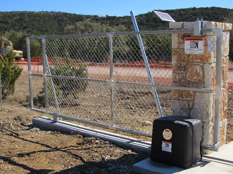

Other than a swing arm type of gate, a sliding gate works just as nice. Basically a motor with a rubberized friction wheel. For a Tarter or Behum Country gate in my first post, the top tube with a mounted extension would work.

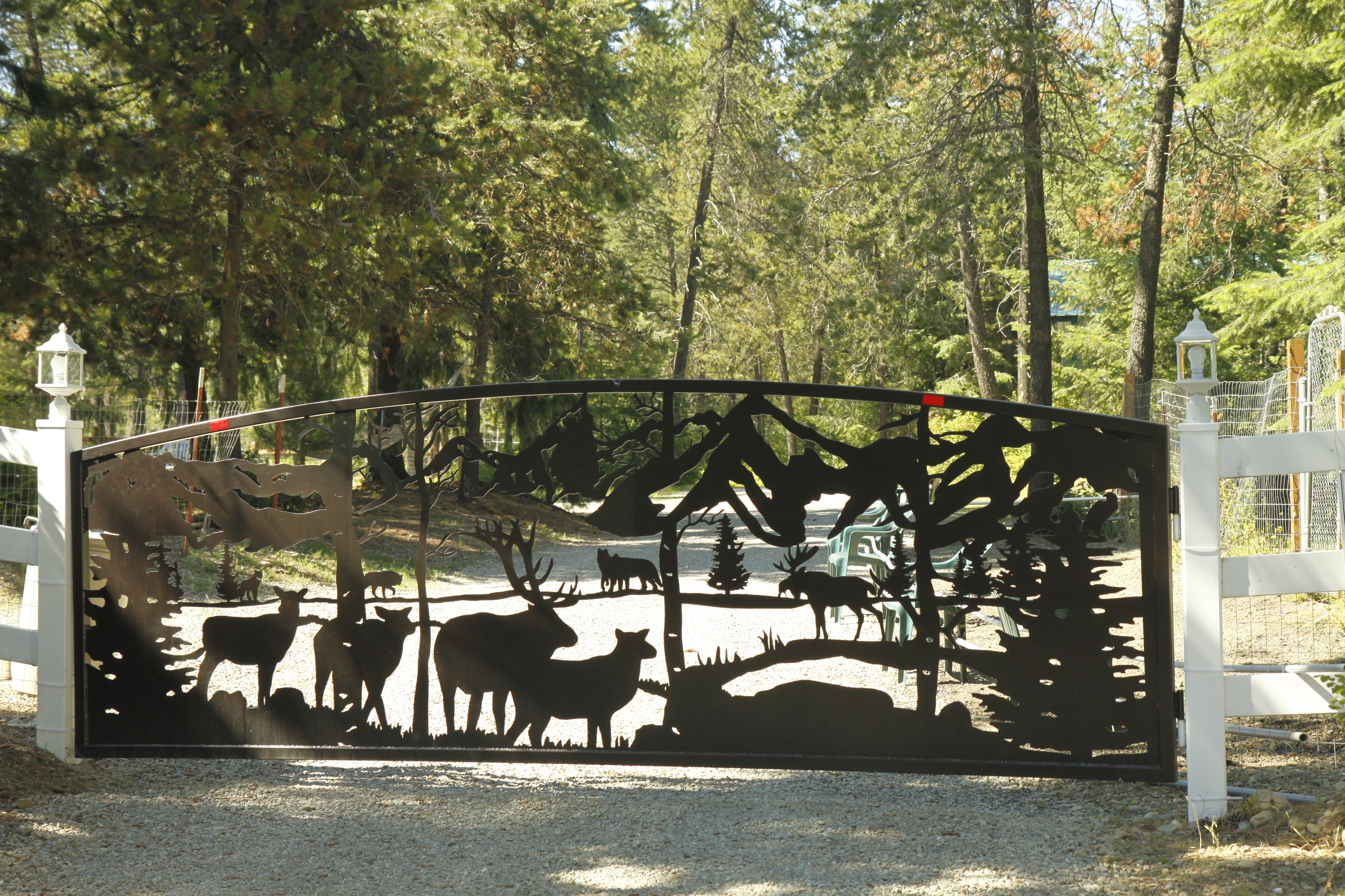

Here is a pix of the type of gate I want to install, but maybe a little different style.

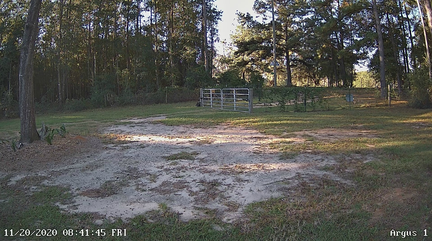

About 5 years ago I did a pair of 10' farm gates with Mighty Mule openers. I set 6/7 round posts from Tractor Supply and tamped dry concrete mix around them. Haven't had any sagging but if I did the hinges could be adjusted to compensate. Make sure and get your gates and measure carefully before setting the posts. Farm gates are not actually the width they are sold as. The measurement includes the hinges. The easiest way to do it is lay the gates on the ground where you want them then set the posts.
Mine are run on a 12V lawn tractor battery with a 30W solar panel. I put wireless keypads on the outside and inside. Since you are doing outswing you need to set your keypad post far enough out to have room for the gates to open. I originally tried the aluminum keypad post sold by MM but it was flimsy so I switched to plain old 4x4s for the keypads. My outside keypad post is set just far enough to allow someone to pull up to it and be out of the road. My inner keypad post is a good 20 feet from the gates since they are inswing.
I set my gates far enough in to pull my truck and trailer in out of the road so I won't block anyone while they open.
