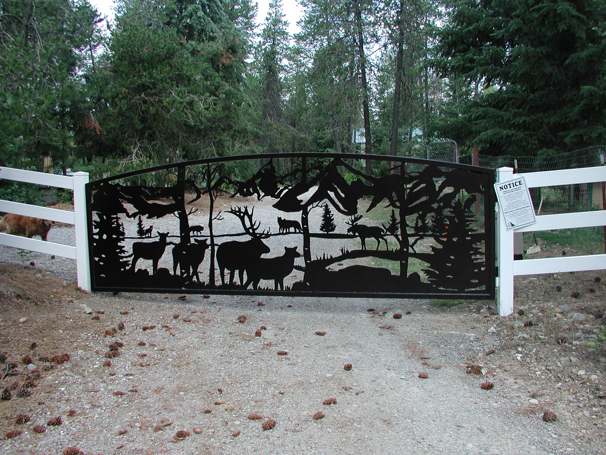

Sooner or later im going to install an automatic opener on the gate i built. Its 14' and about 500#, but opens very smoothy. I dont want a piston opener. I plan on installing a pad mount unit also, but too many other expenses right now. \
Some day ill get around to installing it.View attachment 306064
Neat gate! You do that yourself?

Oops! Sometimes it pays to read the text, no just gawk at the pictures.
yup...built it a few years ago. Had to make and install a 1/4" thick 5" x5" post and have it powder coated white to match the vinyl fence and still be able to hold the gate up without a wheel or a torsion wire. The gate swings freely.

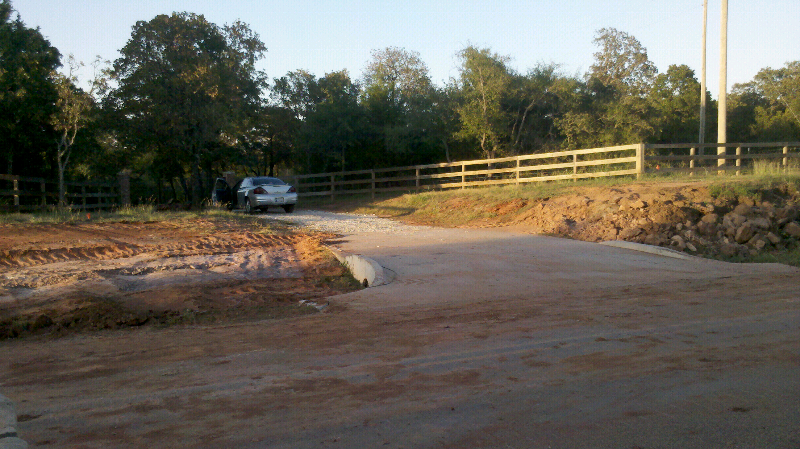

Got the forms built and in place. Now ready to mix concrete tomorrow for the pad. Got a buddy that might stop by to help for a while. Heres a shot of my gate and my progress. You can see "little mans" shovel that i got him. We used his other one in our flower beds, that was until i backed over it with the tractor and bent it in two.

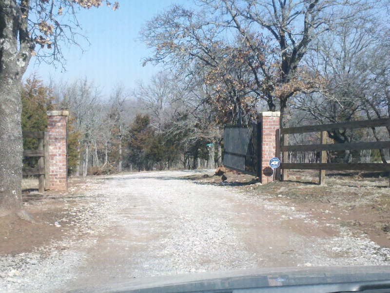

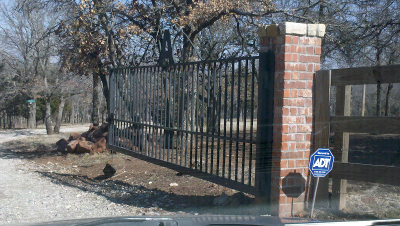

Finally got the opener installed. My wife bawked about the cost initially, but sometimes you just know deep down that she will like it. I havent heard a single complaint since the install. Plus we sleep just a bit more peacefully at night. I thought the solar panel was a bit large at 24"x24" but its necessary to charge the 24V system. I figured a strategically placed bush can all but make it disappear.
