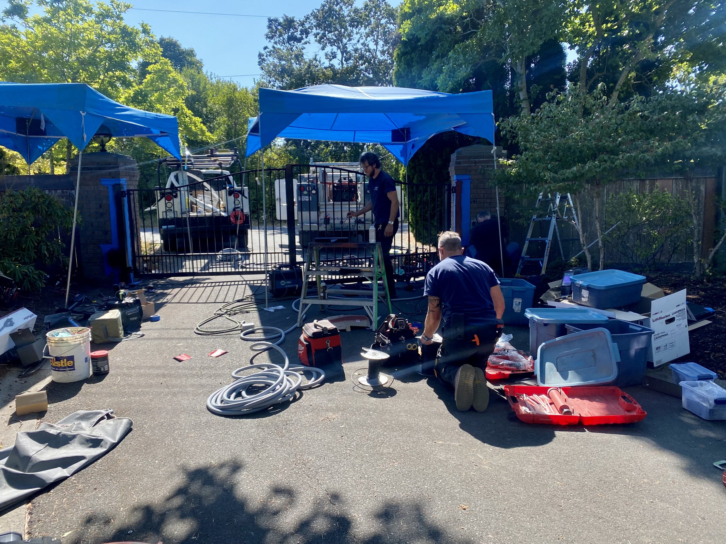

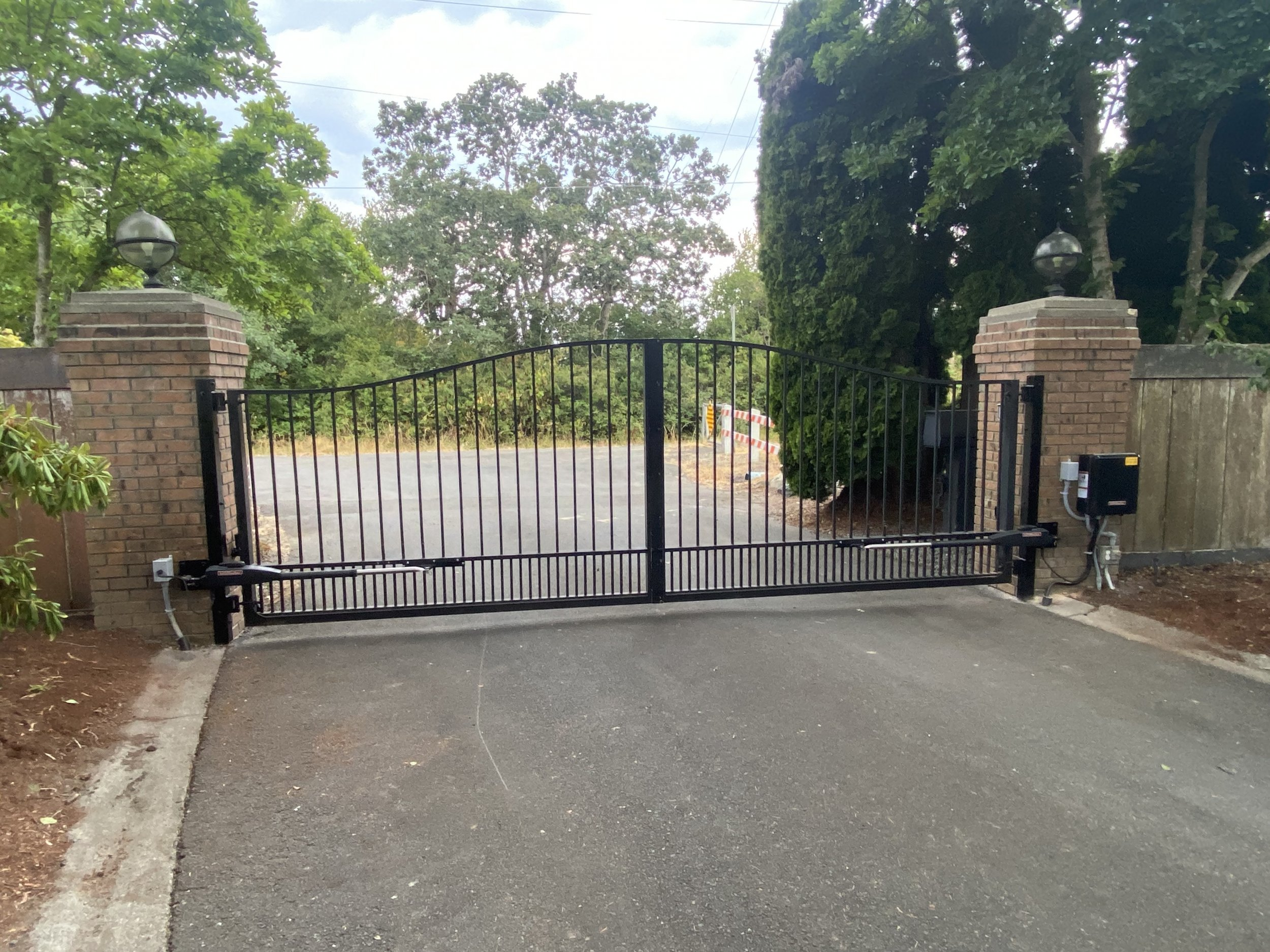

I had my gate opener system replaced today. The European BFT system lasted 27 years so I can't complain.
Went with LiftMaster LA400 screw drives.
Could have gone with the heavier duty 500 series but my gates are well balanced lightweight aluminum.
In progress. 3 guys, 3 trucks all day.....

3 good guys all day.....i could nearly wire a small house. Must have been a bigger project than just swapping an opener.

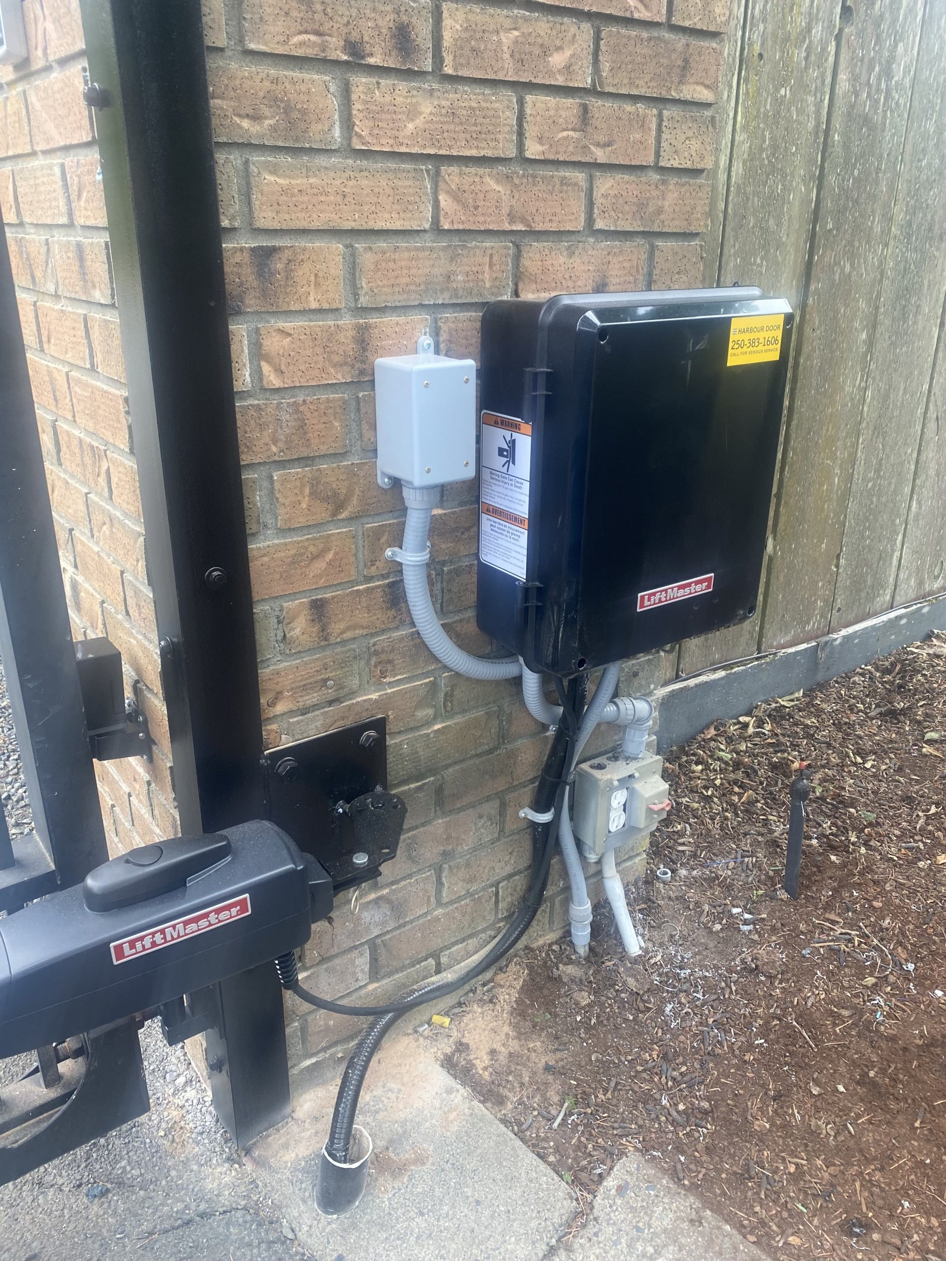

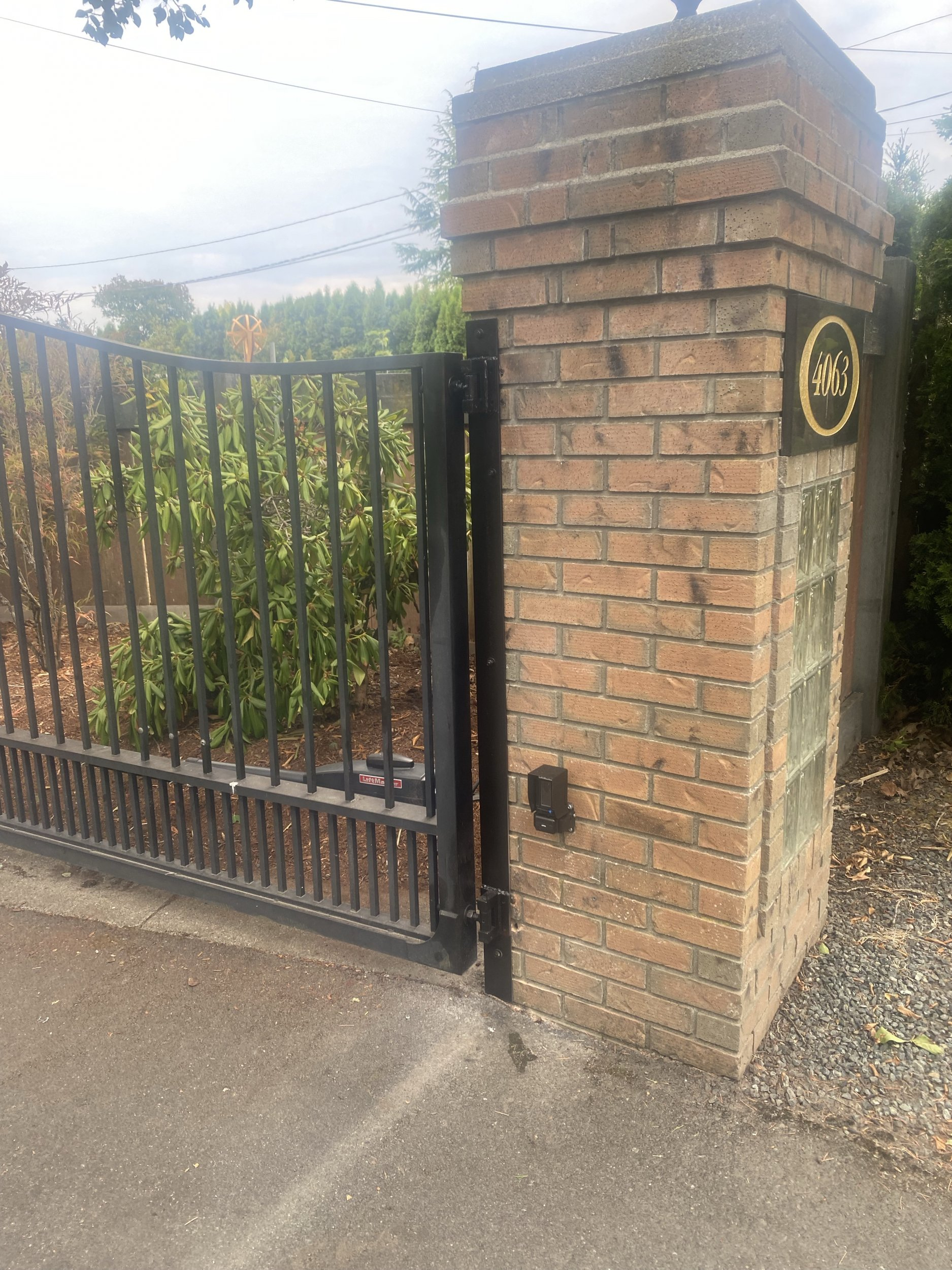

   / Automatic entry gates - DIY #30
The retrofit took longer than the original install.

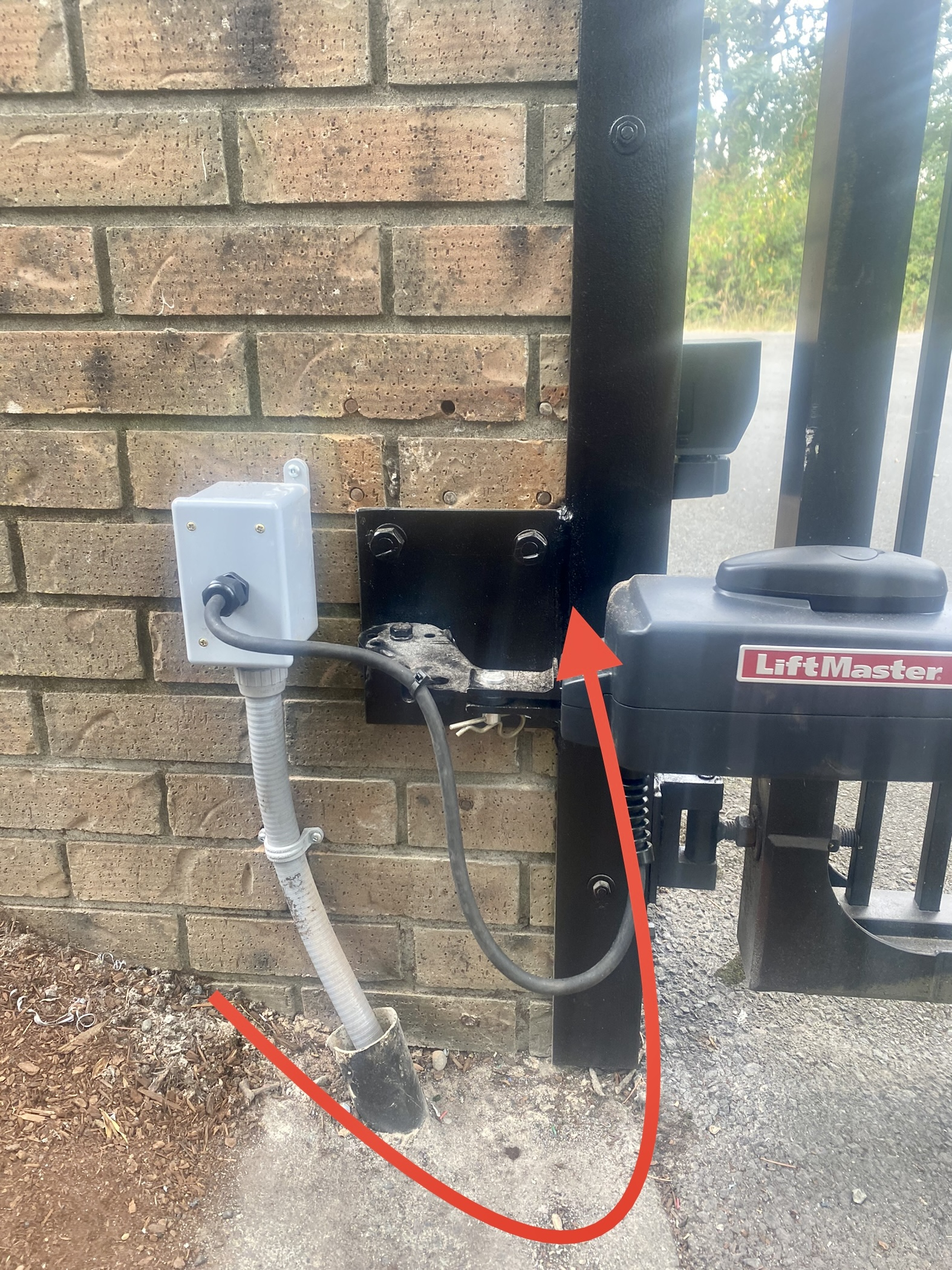

The original "probe" to open the gate for vehicles leaving was upgraded to a magnetic loop for longer reliability
Arrow shows location of removed probe...
After all the old gear was removed.....
New brackets were fabricated and welded...
The wireless keypad was changed to hardwired to provide more functions and the infrared sensors were upgraded to hardwiring both sides which provided internal heaters to eliminate the fogging of lenses due to condensation
New receiver and control box
