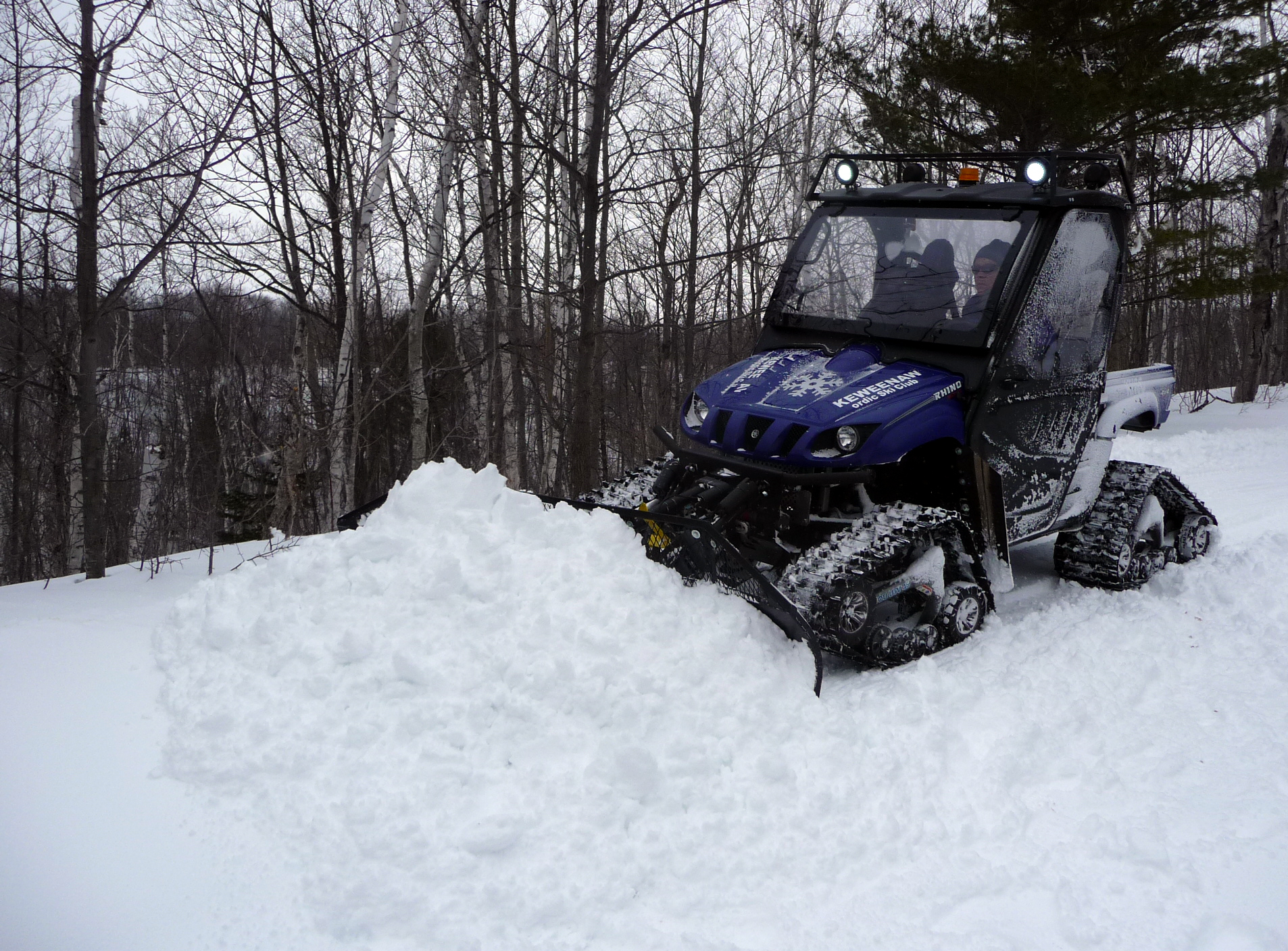

I can't comment on most machines but the yamaha's we ran had limited slip. When you got stuck, they'd all spin. They also had a rear lock, but we never used it. Seems the can-am Defender had a similar setup. This is a grizzly seen below. Good machines but under powered for our needs..

/ ATV advice #75
Correct. My Defender has what Bombardier calls a "Visco-lok" limited slip in the front. Works pretty well but the guys who really put the Defender through hell (mudding, rock climbing, etc.) change them out for a true mechanical locker.

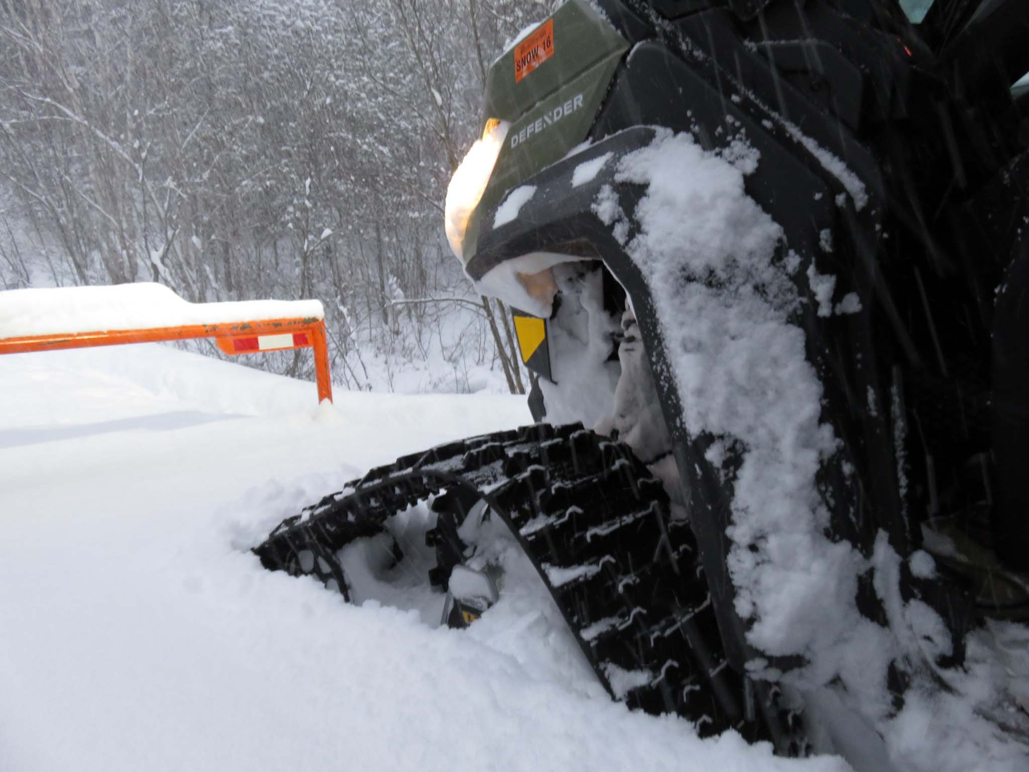

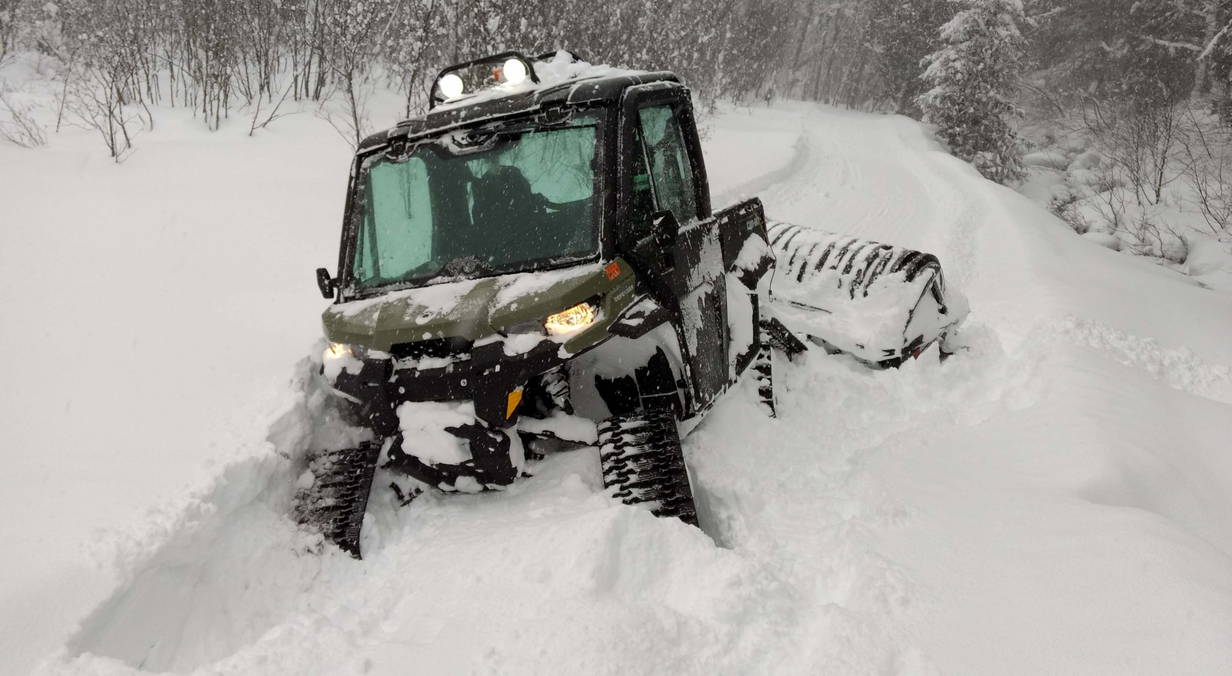

/ ATV advice #76
We did get our defender stuck. Top photo is a "ops!" by me. The company was happy enough with it after 5 years, they got another. We do work them hard and had no grief with its CV drive*.. Another good machine. In the bottom photo, the snow was nearly three feet deep.
*changed the drive belt yearly.

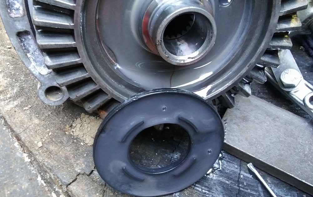

I don’t know for all 4x4 ATVs but am not aware of any with a limited slip front.
Well, don't take my word for it. Go look at the parts diagrams, which are free on the internet. I doubt that any 4x4 ATV does not have limited-slip diff in the front. They rarely fail, so most folks will never see the actual mechanism.
This LSD photo is from a Can-Am Outlander 400 4x4. Spider gears not shown.
/ ATV advice #78
Yamaha Grizzly 700 doesn't. It's open or locked (Electronically via handlebar switch). I actually think most are this way unless there is no switch to engage the locker.
