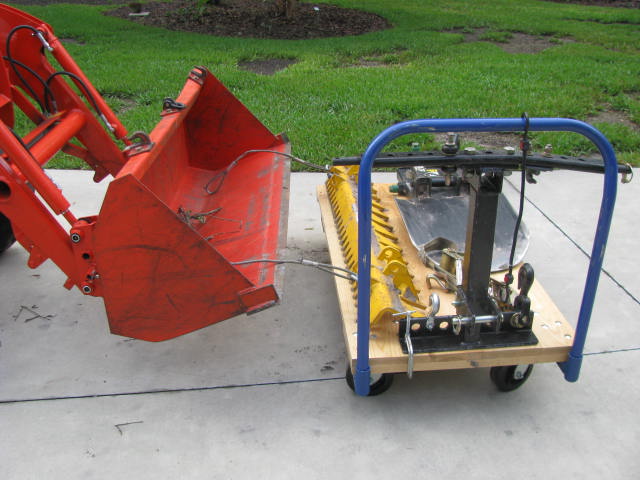

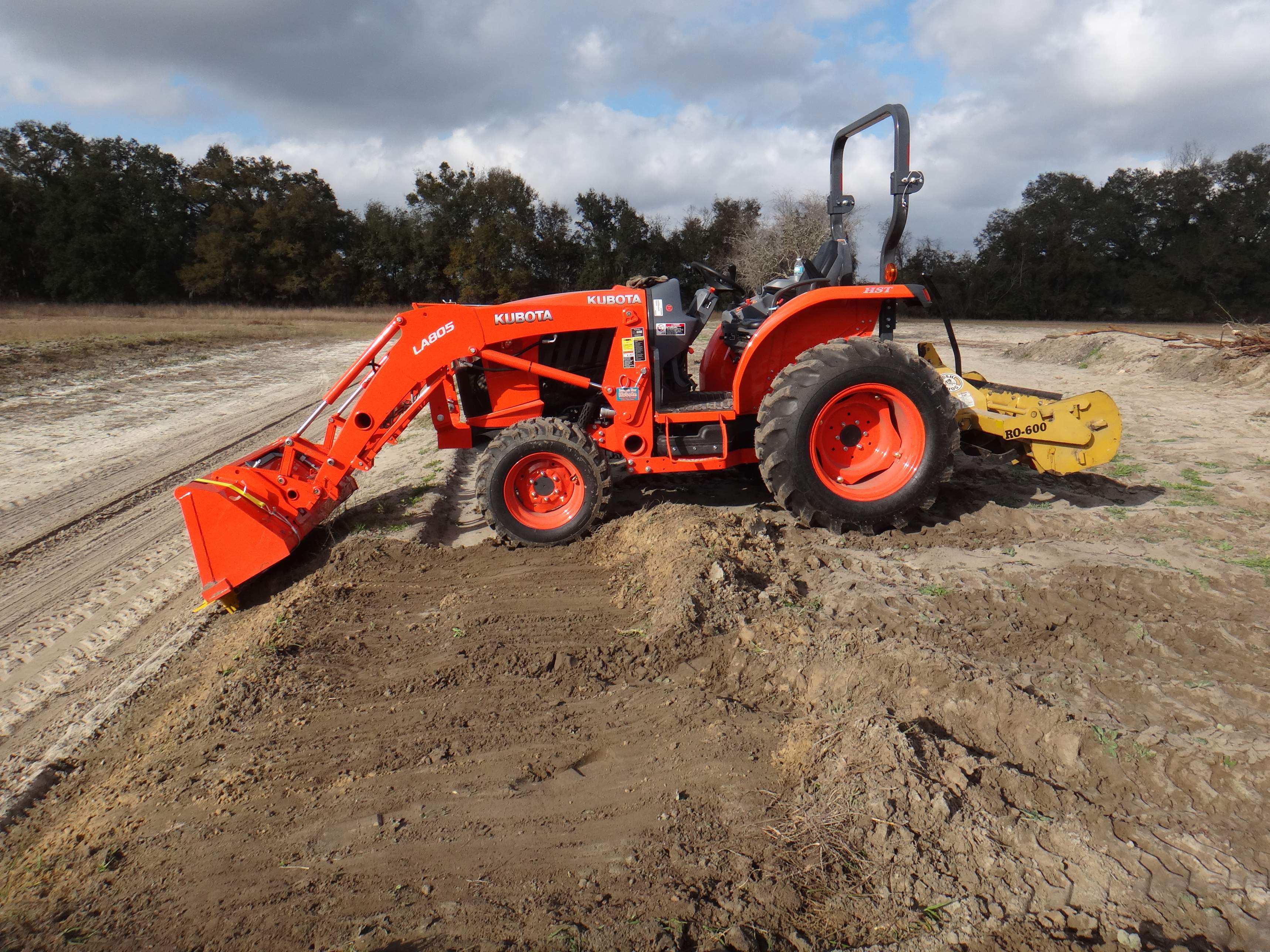

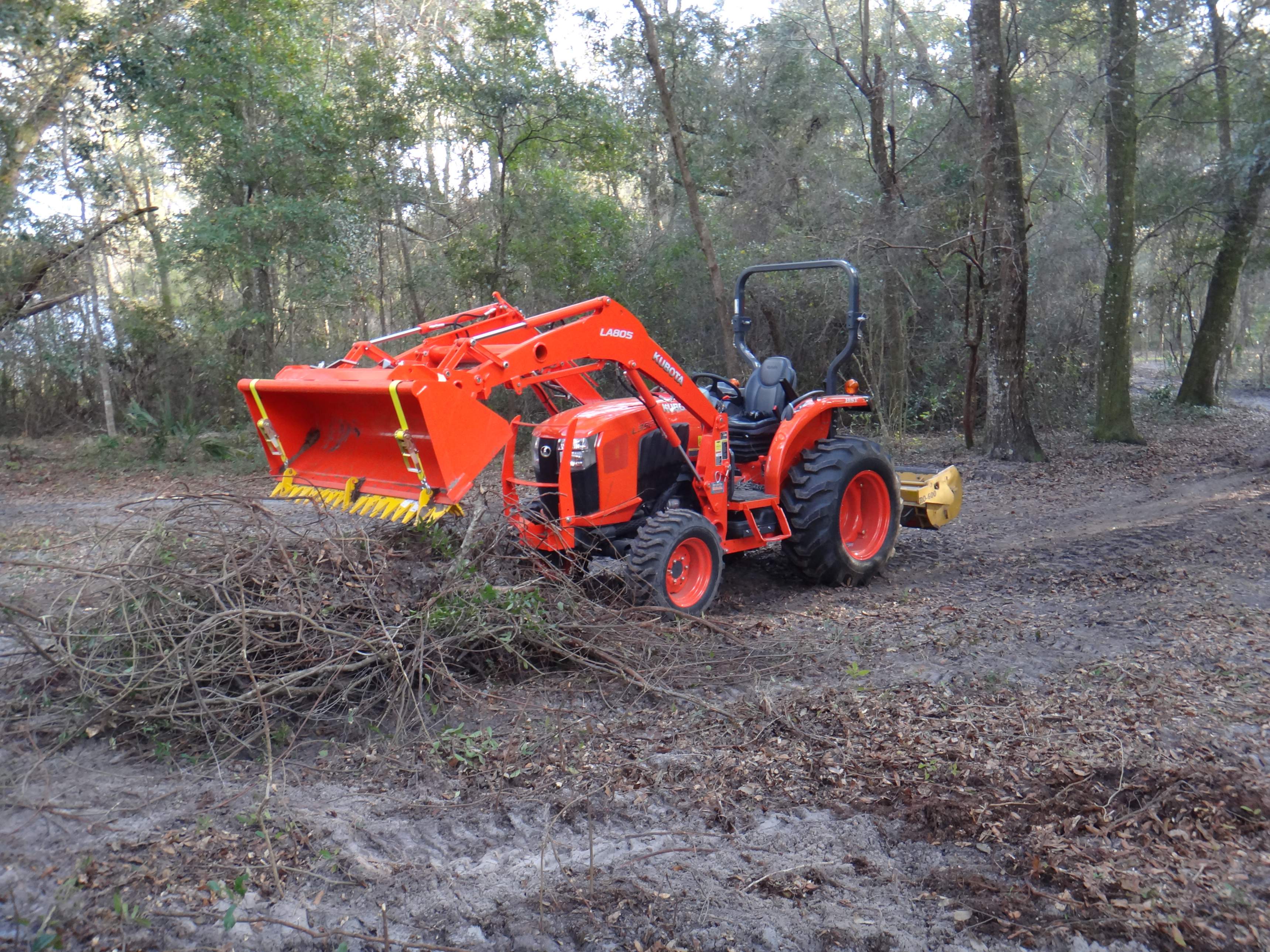

For one acre you do not NEED more than 25-hp. Before moving up from 25-hp, which is the divide, above which engines must have costly Tier IV emissions controls, consider a heavier 25-hp tractor. It is hard for newbies to understand how tractor weight is as important as tractor horsepower, but it is.
So, besides the Kubota BX and B series, consider the new "cheater" Kubota L-2501, which has 25-hp on a 2,600 pound frame.
I need an FEL, BH, Roto-tiler, Manure Spreader, Box Blade, Pallet Forks, Utility Blade w/hydraulic actuation ideally(for snow removal).
Almost all new 25-hp tractors you look at will have an FEL, HST transmission and R-4 industrial tires. To me, a Ratchet Rake bucket attachment is an indispensable force multiplier for 25-hp tractors. Invaluable for tearing out brush, pushing over 3" young trees, great for piling brush. Also pretty good for light grading and fair for garden prep. You buy the Ratchet Rake from the T-B-N store.
Box Blade and FEL would satisfy many for snow removal you described. Small rear blades do not come with hydraulic control capability. I have posted for this myself but no one knows of a vender.
A 25-hp tractor can power a 48" or 54" PTO powered roto-tiller fine. Depending on your soil, you could perhaps make do with a Potato Plow followed by the Ratchet Rake.
Expand on your need for a $5,000 Backhoe and a manure spreader on ONE acre.
Pallet forks normally attach to the bucket on 25-hp tractors. Cantileevered so far forward, leverage is against you and the load you can lift more that 30" - 36" is quite lmited. SSQA (Skid Steer Quick Attach) pallet forks mount directly on the FEL arms (after bucket is taken off) so lift is considerably increased but I do not think you can get SSQA on the tractors you have mentioned. The manufactures worry about liability from tractor rollovers.
Where are you going to keep this equipment where neither your wife nor your neighbors are going to be peeved at the sight? Related to your equipment list, what is your budget? You have spent $45,000 already.

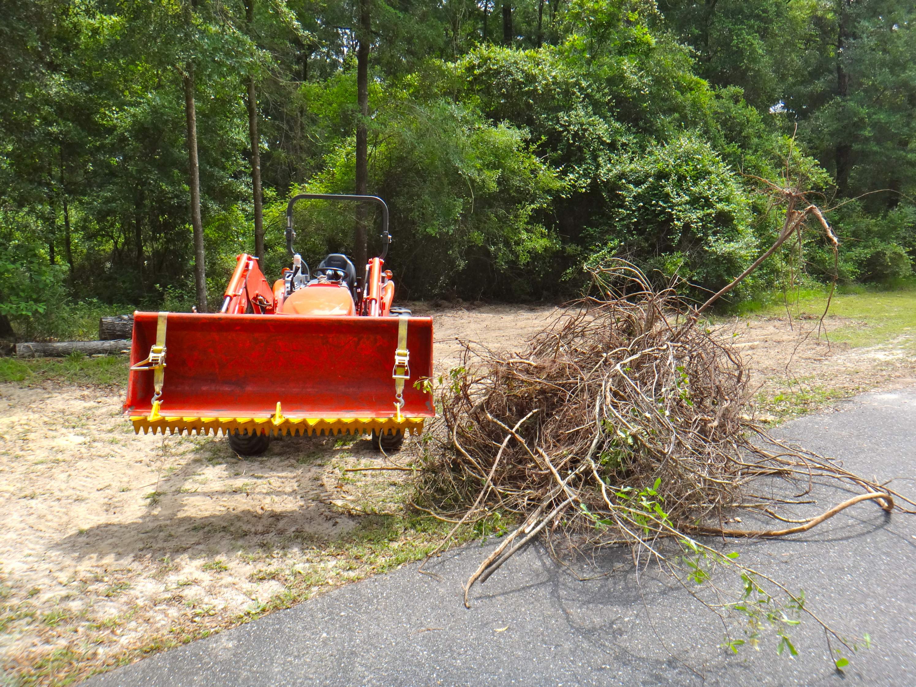

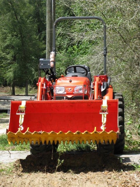

Regarding the BACKHOE, my rational for it is the amount of landscaping that I will be doing around the property.
Planting trees, irrigation lines, retaining walls, slab for a greenhouse, footings for fence and gate, to name a few.
A Bucket Spade is very fine for planting trees. How many trees will you plant on ONE acre? You need full sun on the garden or you will not harvest enough produce to sell.
For irrigation lines a Potato Plow or a Subsoiler will do fine, with just a little hand shovel work. How many meters of irrigation line will you install on ONE acre?
For your slab(s) a heavy-for-your-tractor Box Blade is what most would use, in preference to a Backhoe. Maybe a Ratchet Rake and possibly a Tooth Bar digging attachment for your FEL bucket as supplements. In some circumstances, some would use the roto-tiller to loosen slab soil. ('Piranha' brand tooth bars receive rave reviews here.)
PIRANHA TOOTH BAR ON YOUTUBE: https://www.youtube.com/results?search_query=piranha+tooth+bar
Footings for a fence and gate you can be done handily with an FEL bucket with a Tooth Bar attachment. How many gate footings will you install on ONE acre?
