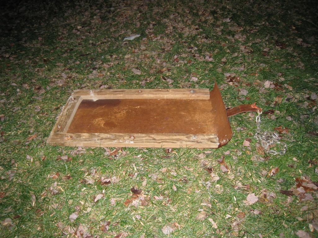

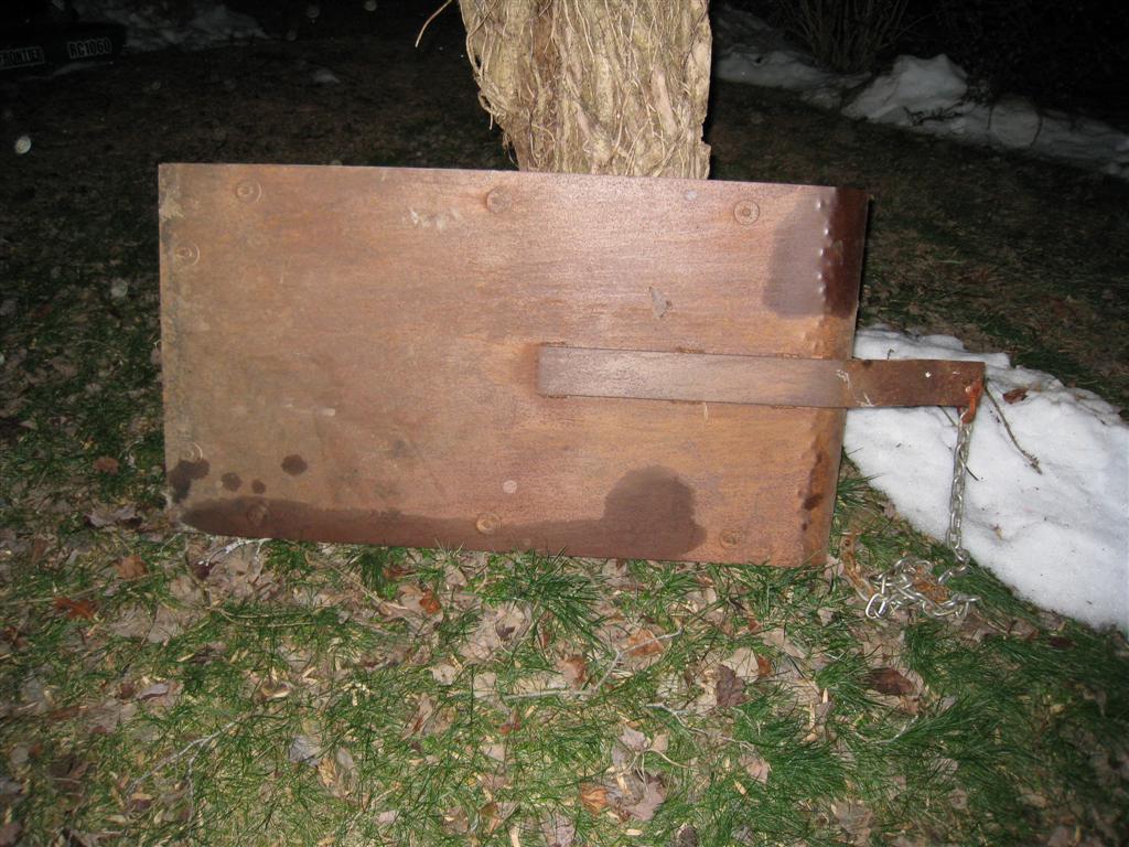

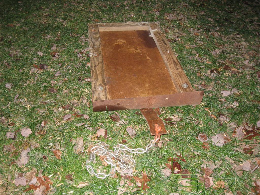

A stone boat sounds like the ticket. Would like to make one out of wood ,but have never seen one . As far as the size and what to use -like 2x10s or what? I'll have to find a pic. of one to see how to do it, thanks!
I used a stone boat before I bought a tractor with FEL. It was very effective in moving large heavy stones. I would roll heavy rocks on to it using a pry bar and would pull the boat with my JD1010 dozer.
I found this book: The Art And Craft of Stonescaping: Setting & Stacking Stone very helpful in explaining technics on moving and setting stones.

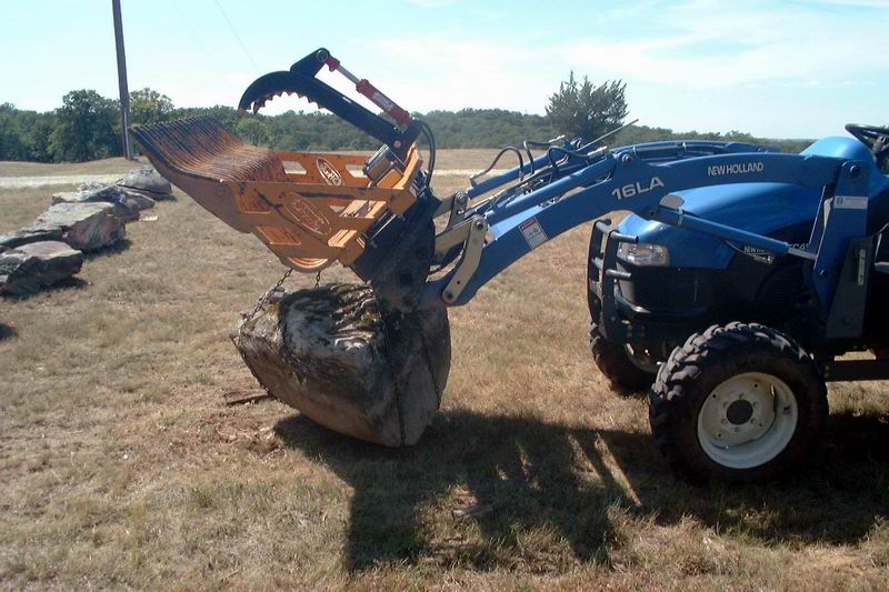

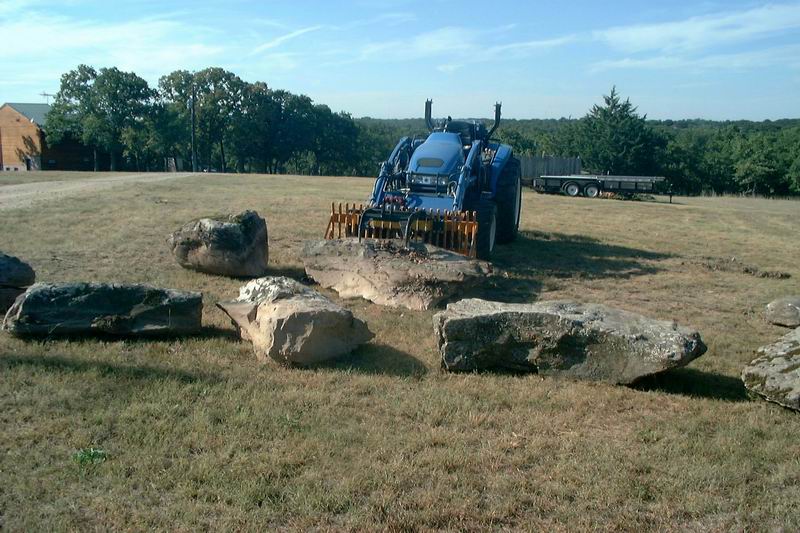

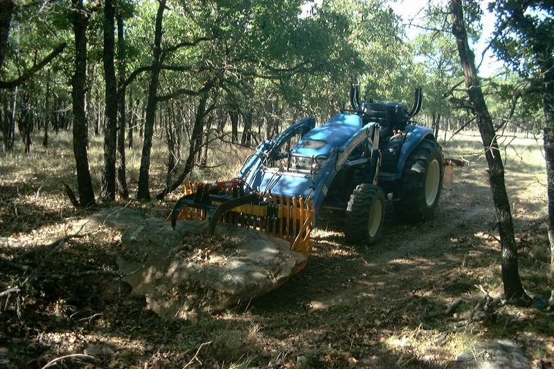

My "stoneboat" is very expensive, but effective. Even so, I've sure had some rocks that humiliated me and my tractor. Here are some photos of one of the largest I've moved any great distance, from the woods to my rock garden. It was 6' wide and over a foot thick.
Also, in the last two pictures, I show how I tried to lift one rock with a chain from my rock bucket. In the first picture, I had the chain wrapped around the front of the bucket tines and my loader couldn't lift the stone. In the second picture, I moved the chain back toward my QA adapter and that made the stone managable. My rock bucket and grapple weigh about 750 lb, so I could easily have lifted the rock if I had removed the grapple, but I like a challenge.;):eek:
Ok..the heck with the stone boat..get what jinman has! That rock bucket is awesome!
