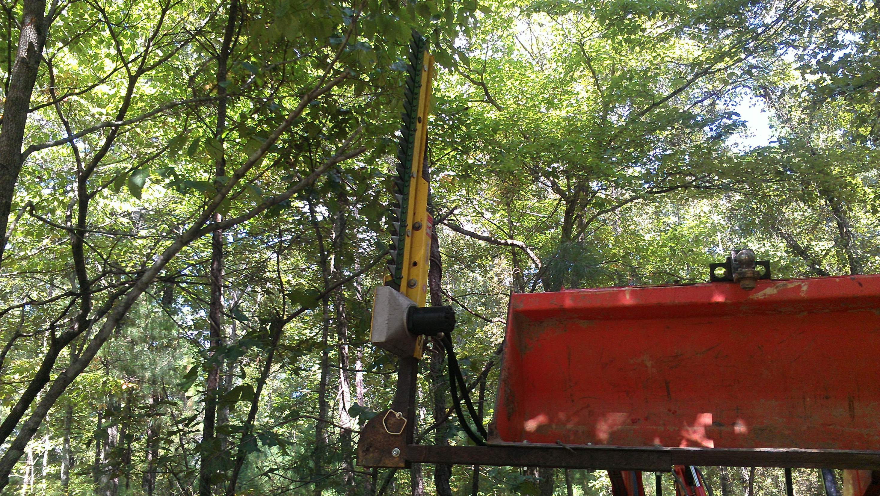

how about a hydraulic powered sickle bar this is an old picture but you get the idea.
