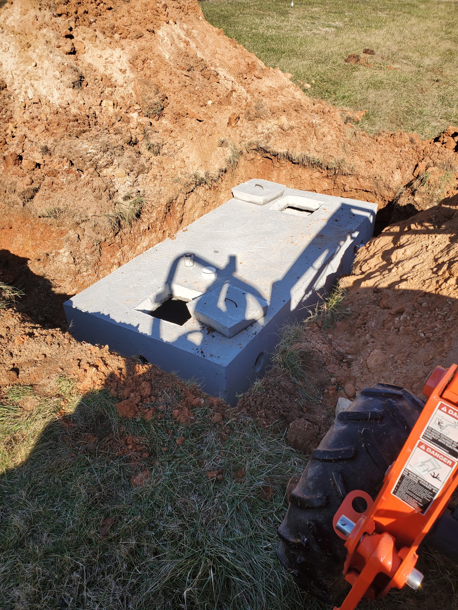

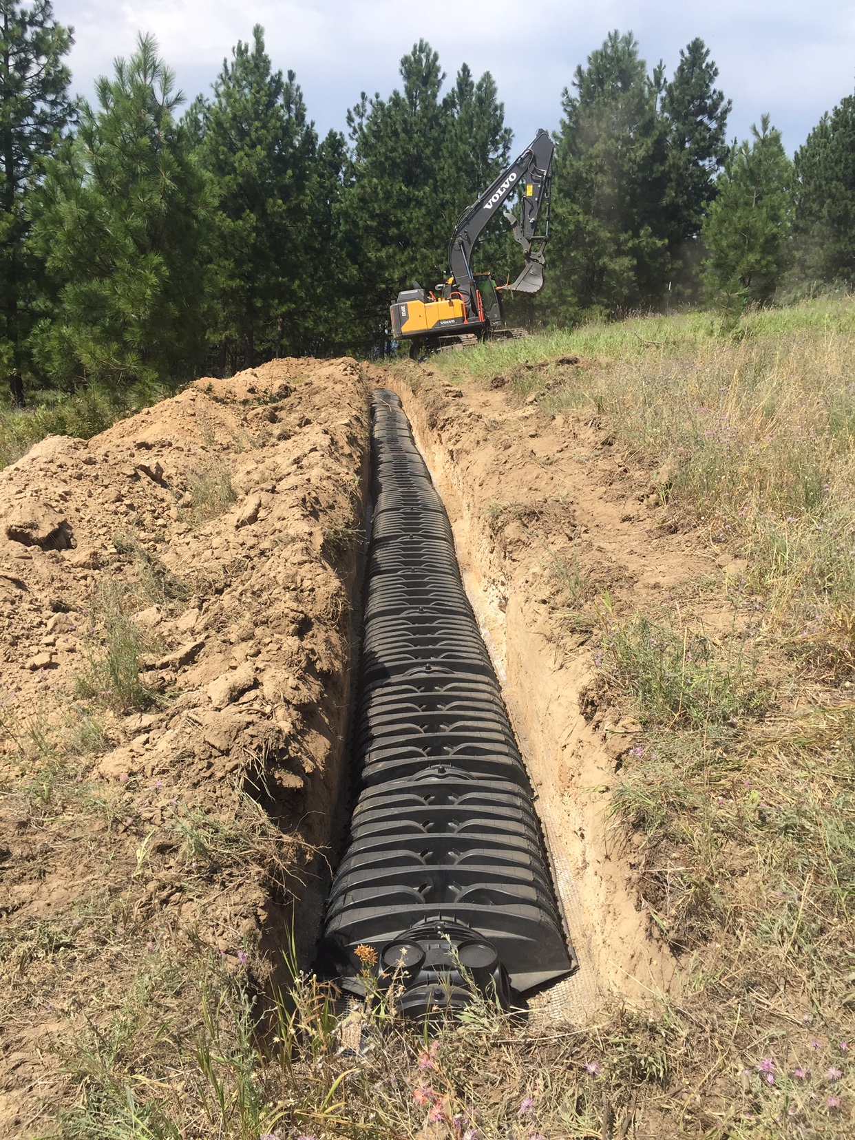

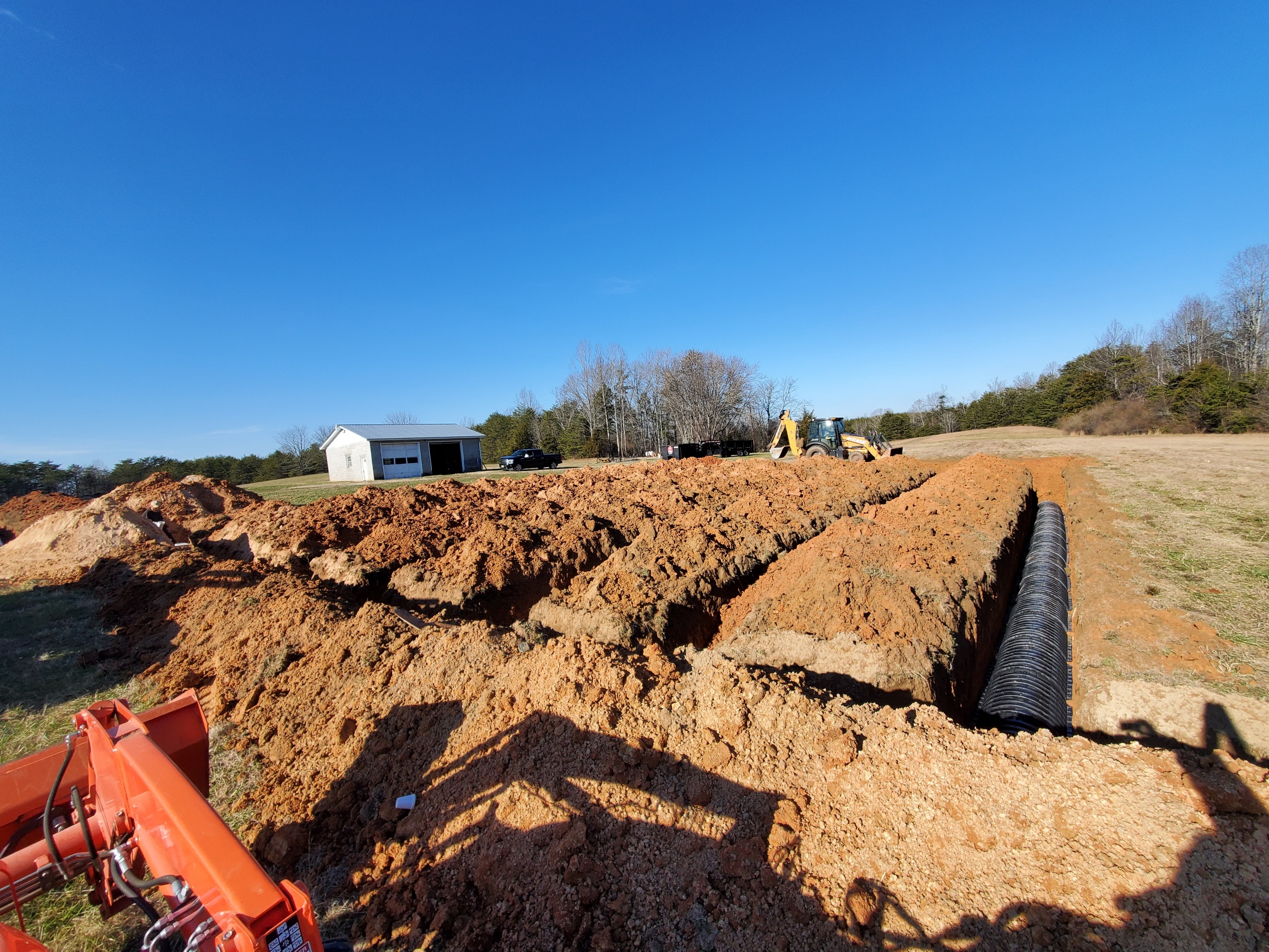

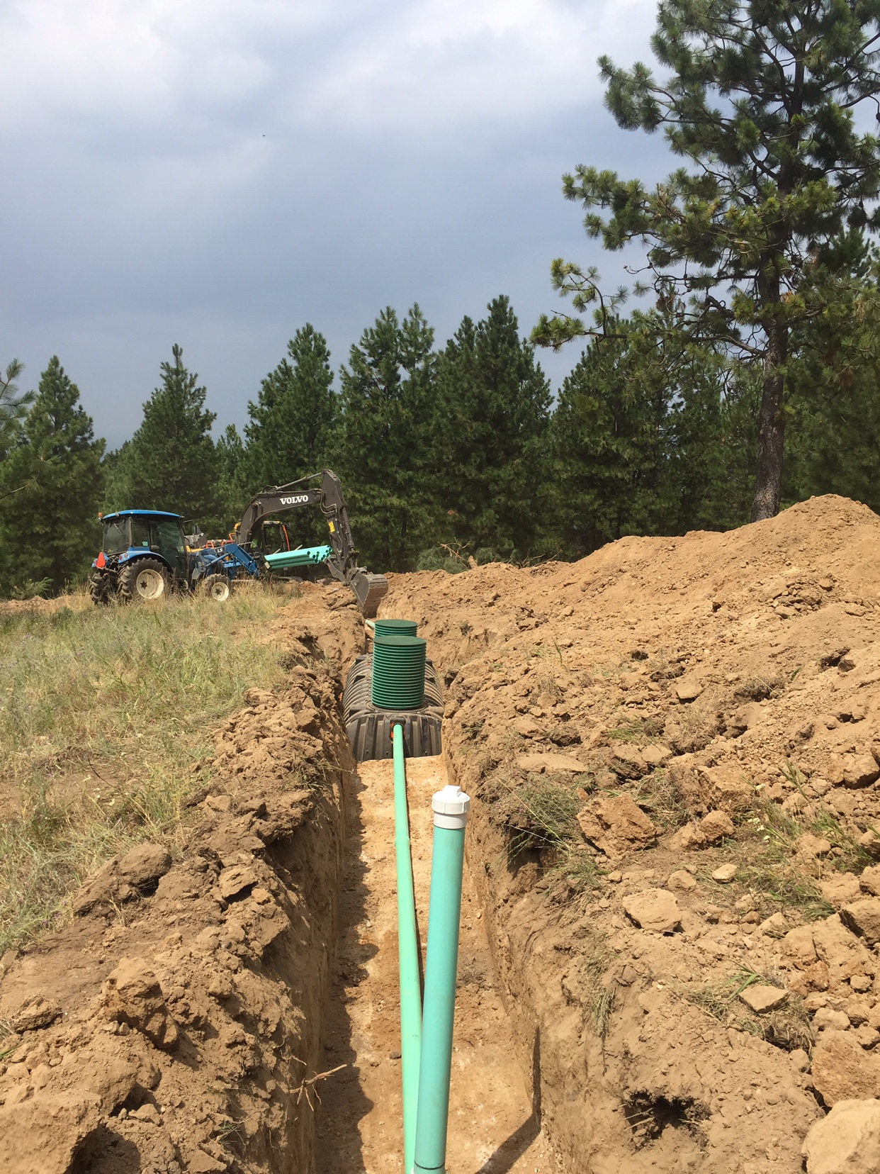

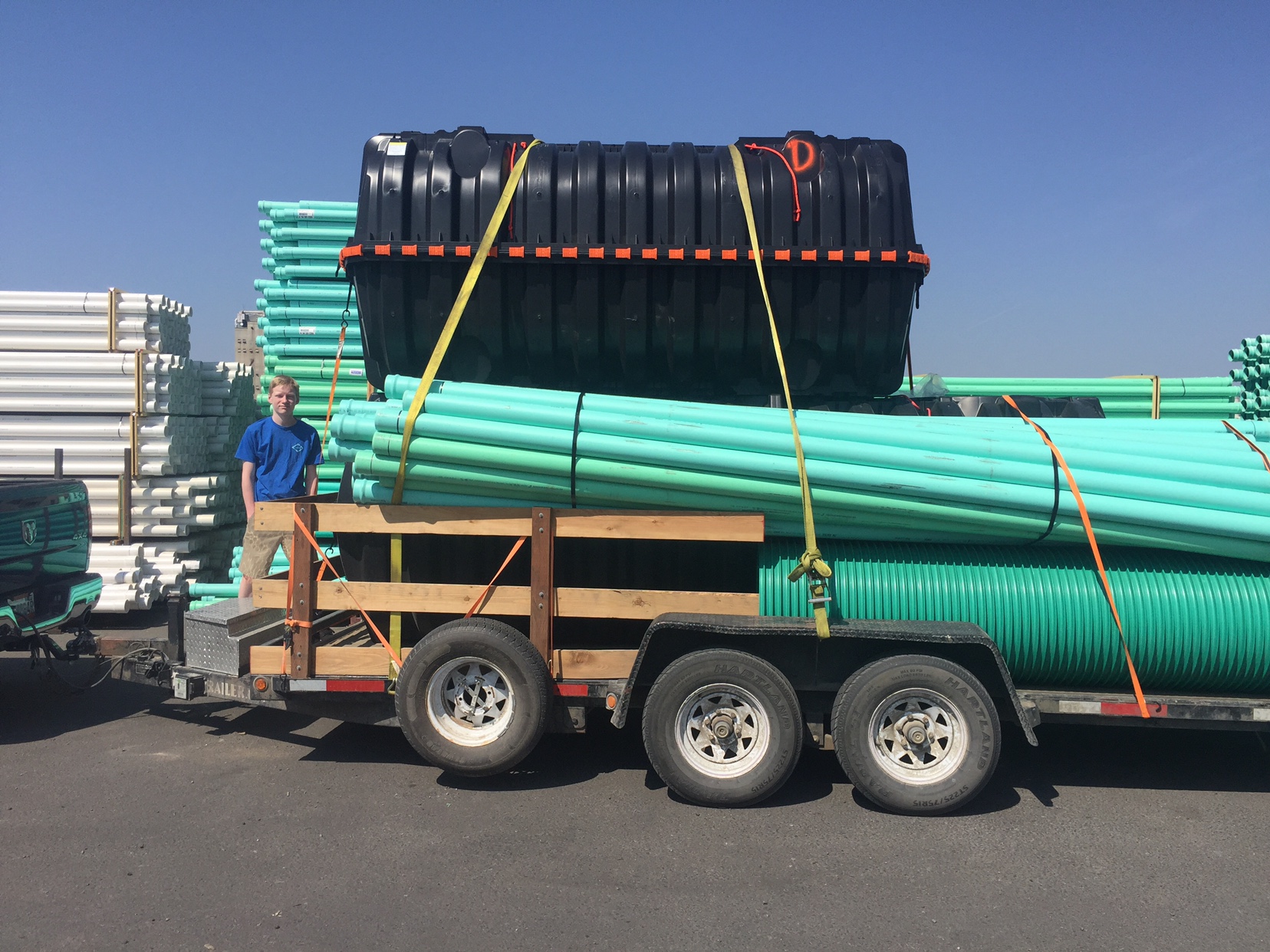

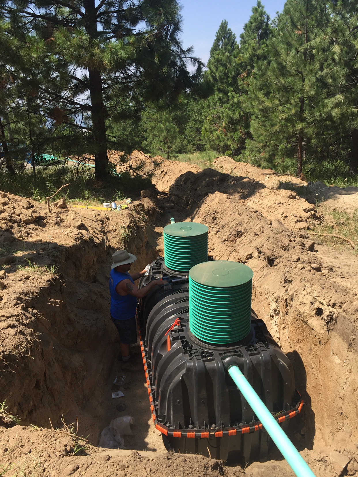

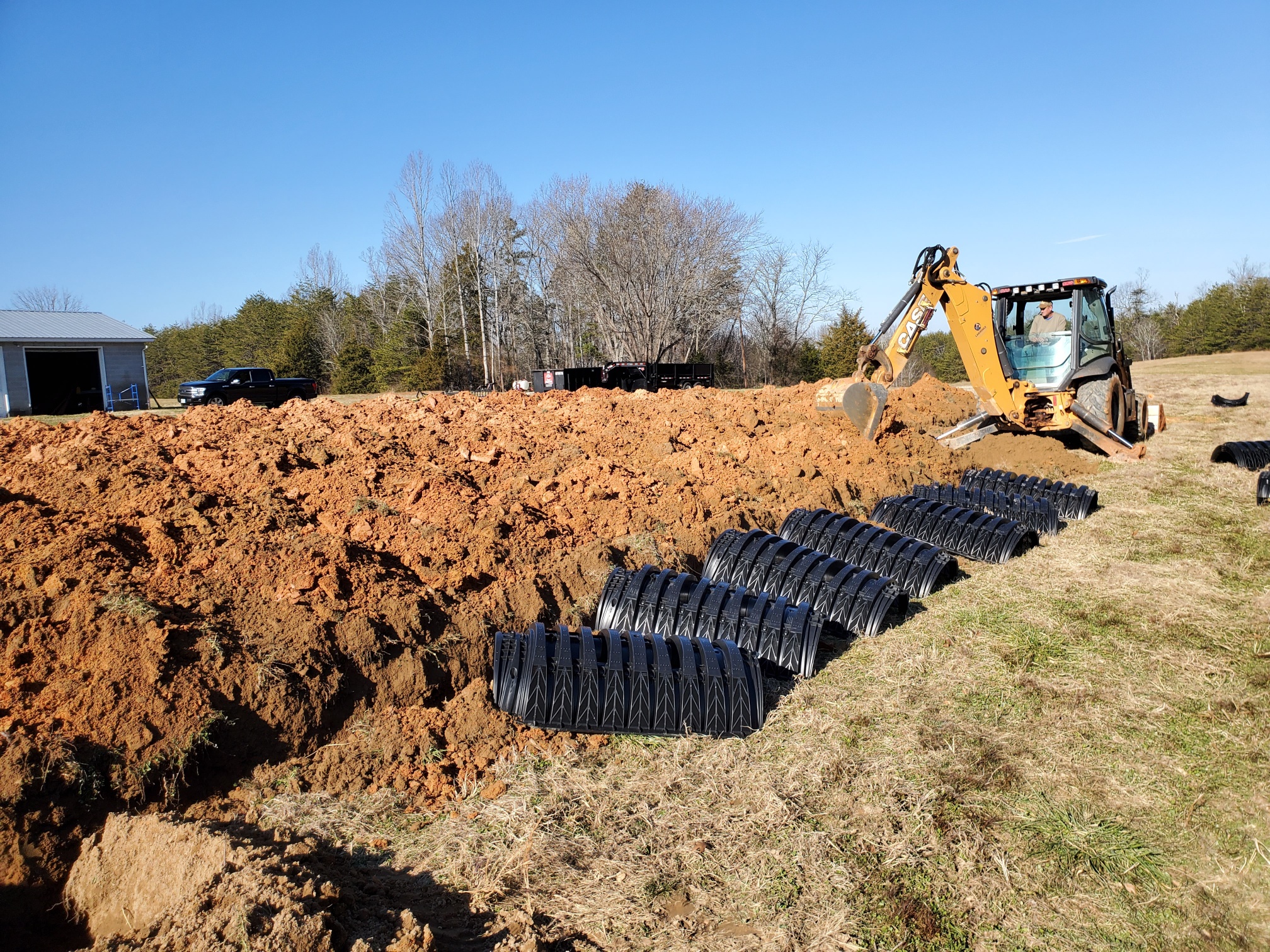

I did my septic system about 2 years ago. Called around and got prices first, ranging from $8500 down to the lowest at $6500. Called the state environmental dept and found that for $100, you can take a simple test and get a permit. That $100 also includes 3 on site inspections. My total costs for 1000 gal tank, all the pipe, and all the stone was $1800. Our soil is sandy loam, not a rock to be had.... for a 3 BR house, only needed 200' of laterals 4' deep x 2' wide.
The specs will vary greatly from region to region, state to state, and even county to county. It was a no-brainer for me... just due to the cost savings...
if you can do it...go for it. The guys i know that do this work have dump trucks, trailers, excavators, insurance, etc to pay for. plus laborers, gravel delivery and usually less than good working environments....especially when having to repair failed systems.
personally, the guy i work with knows not to bother calling me for old systems. i wont work on any old, failing systems. not enough money in the world.
