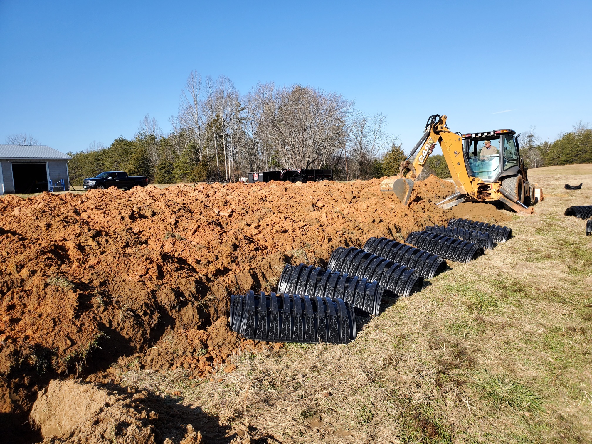

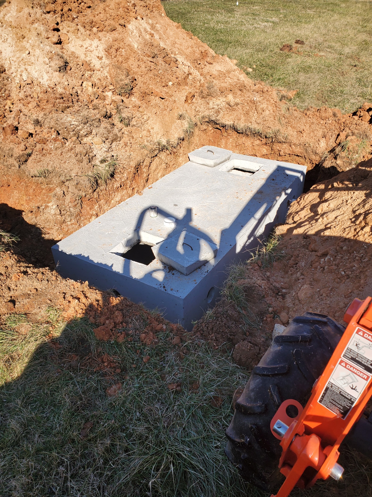

I just had a new conventional system installed at my farmhouse we are renovating. 1500 gal tank, (4+ bedrooms), used the infiltrators... took one day with a three man crew who does this everyday and for 60 years. $4900 bucks installed. 5 lines, 80 ft long, 9 ft apart, 54 inches deep. Tank was 1k, the infiltrators were 2k for 100 of them, misc pipe and fittings another 500 bucks. Not a huge profit margin. Old man was 77 and his two sons 55 and 41 ... his backhoe is new in 2019 and cost $108 grand. He tries to install 3 to 5 a week, averages 3.5; all added up he makes a good living. BTW, we had to have an engineer design, inspect, and sign off on the system. Permit was $750 bucks which includes the well permit; that is going in in two weeks.
OP's Florida soil will likely perk much better than what appears to be clay mix soil shown in your pix.
2019 cost of that Case TLB.... without a thumb.... was $108K ???

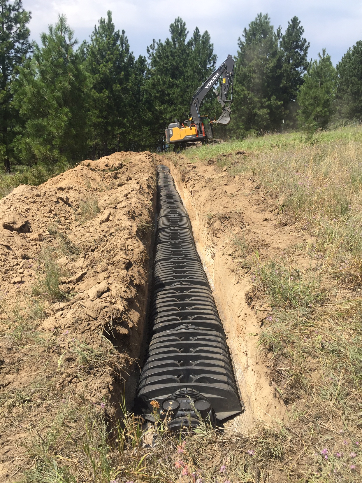

In my county a soil evaluation and septic design by a licensed septic design engineer is required in order to obtain a permit from the health district. An approved installer is also strongly recommended (but I don’t think is necessarily required).
I did the install on my system with the assistance and supervision of a good friend who happens to be an approved installer.
Laterals (5x100’), tight line (~500’), 2 plastic dual chamber tanks-1 1000 gallon, 1 1500 gallon, distribution box and low profile infiltrators. Entire install (less backfilling) completed in one weekend with 2 guys.
Used my buddies Volvo excavator rather than my 580E-excavator was much quicker and really the better tool for this size of job.
