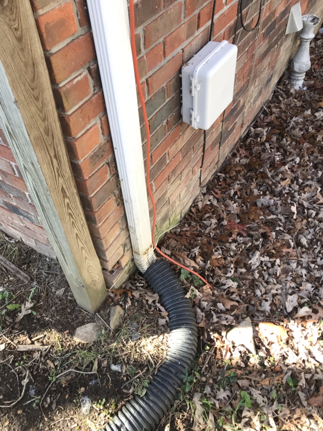

Well most homeowners do electrical work like this so it is fair that it痴 for the most part forbidden. View attachment 682034View attachment 682035
you would never believe the junk ive see after nearly 40 years of electrical service. from one entire cabin wired in lamp cord (2 wire electrical light fixture cord wired inside walls), screw in 240 volt hot wire.jpg

you would never believe the junk ive see after nearly 40 years of electrical service. from one entire cabin wired in lamp cord (2 wire electrical light fixture cord wired inside walls),View attachment 682044
A buddy of mine bought a house years ago that had small workshop wired with orange extension cords held in place with bent nails.

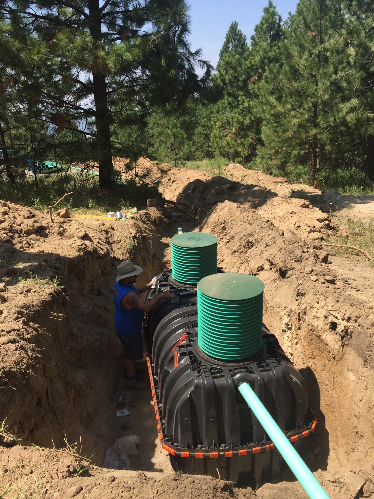

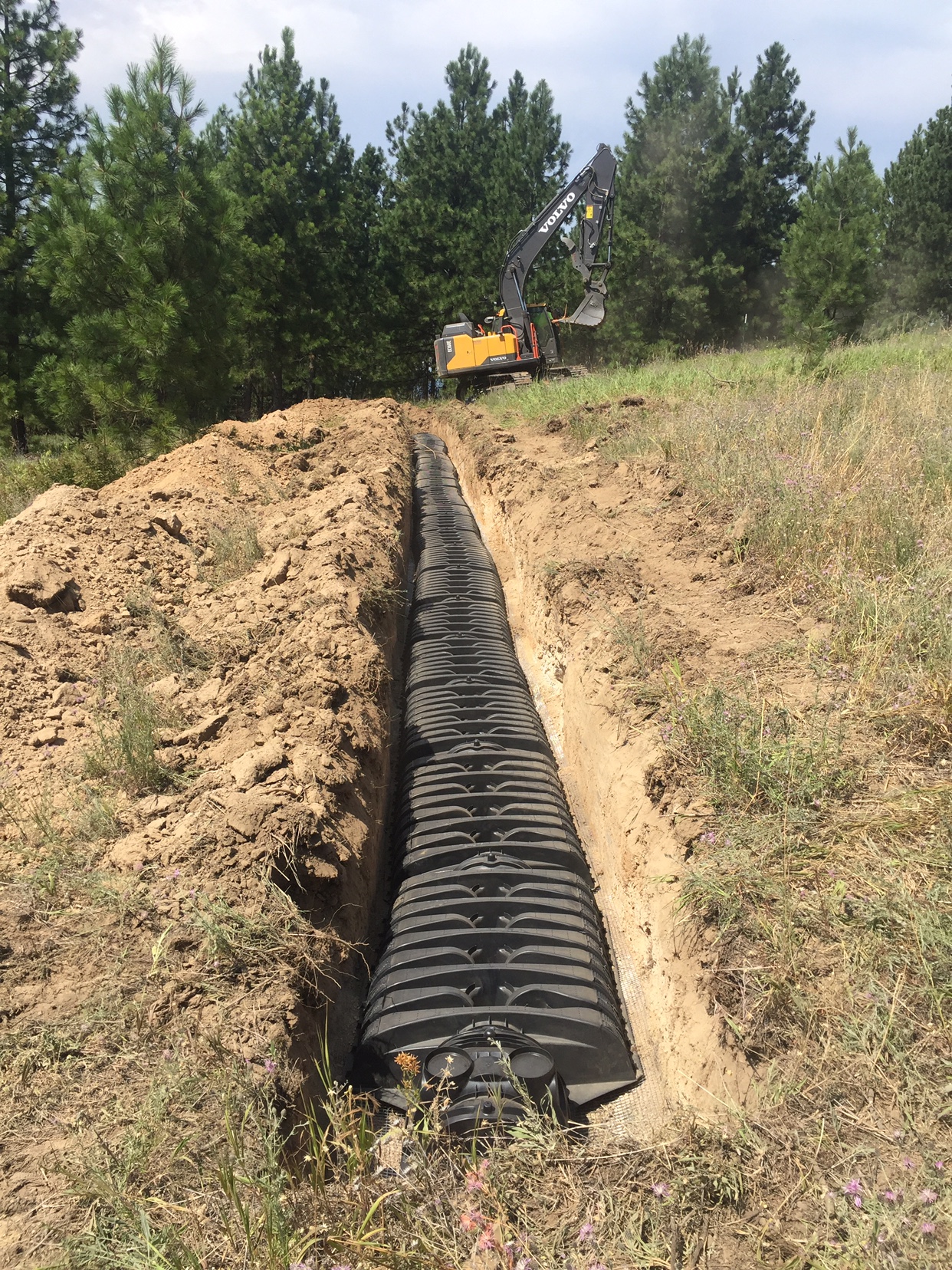

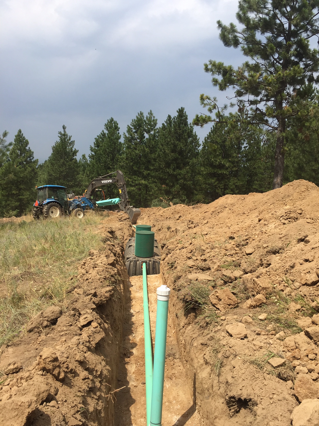

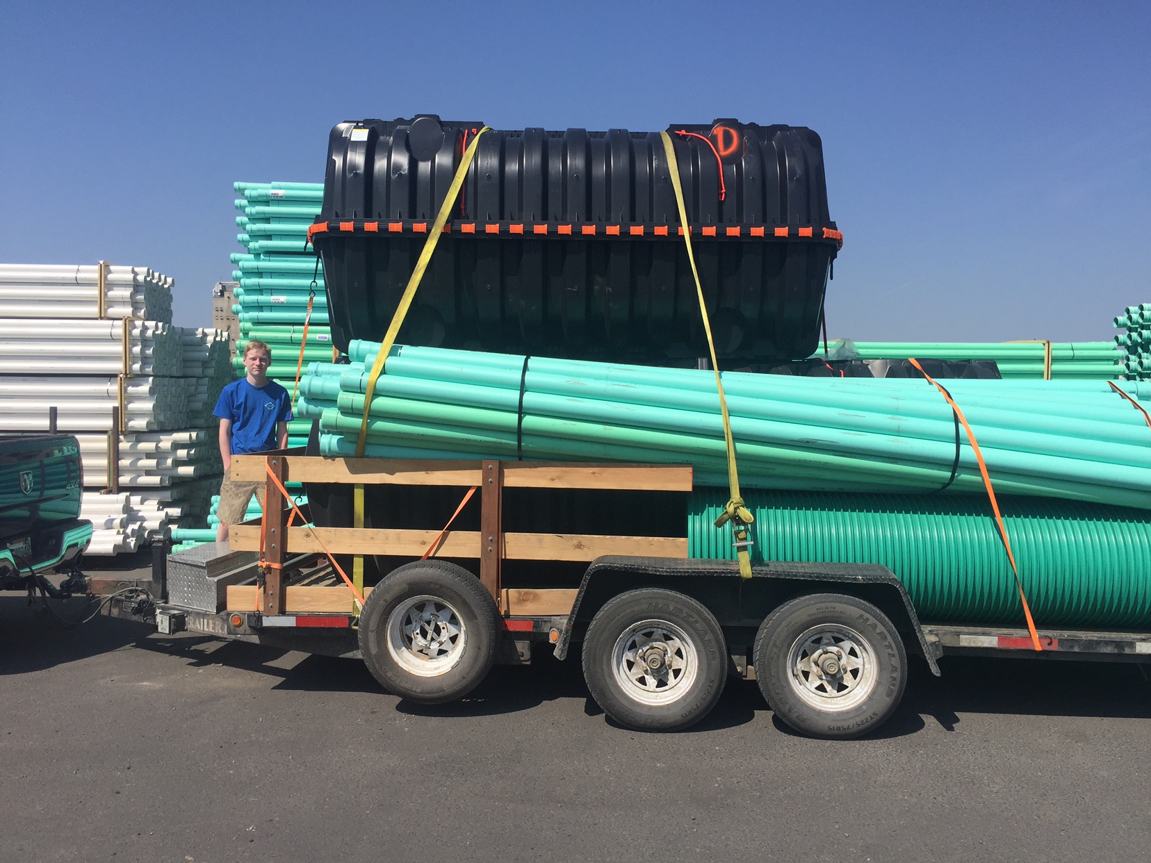

In my county a soil evaluation and septic design by a licensed septic design engineer is required in order to obtain a permit from the health district. An approved installer is also strongly recommended (but I don稚 think is necessarily required).
I did the install on my system with the assistance and supervision of a good friend who happens to be an approved installer.
Laterals (5x100?, tight line (~500?, 2 plastic dual chamber tanks-1 1000 gallon, 1 1500 gallon, distribution box and low profile infiltrators. Entire install (less backfilling) completed in one weekend with 2 guys.
Used my buddies Volvo excavator rather than my 580E-excavator was much quicker and really the better tool for this size of job.
View attachment 682038View attachment 682039View attachment 682040View attachment 682041
not too far from you in N. Idaho. similar systems used here for most people. A homeowner can do their own work, but the system needs approval in advance from health district. The entire basic gravity system is very simple to install, but the ones i usually work on are very complicated systems with pre-filter tanks, dosing and recirculating tanks, and 1 or 2 computer control modules to control the entire mess.20201106_135935.jpg 20201105_142842.jpg 20201105_133706.jpg

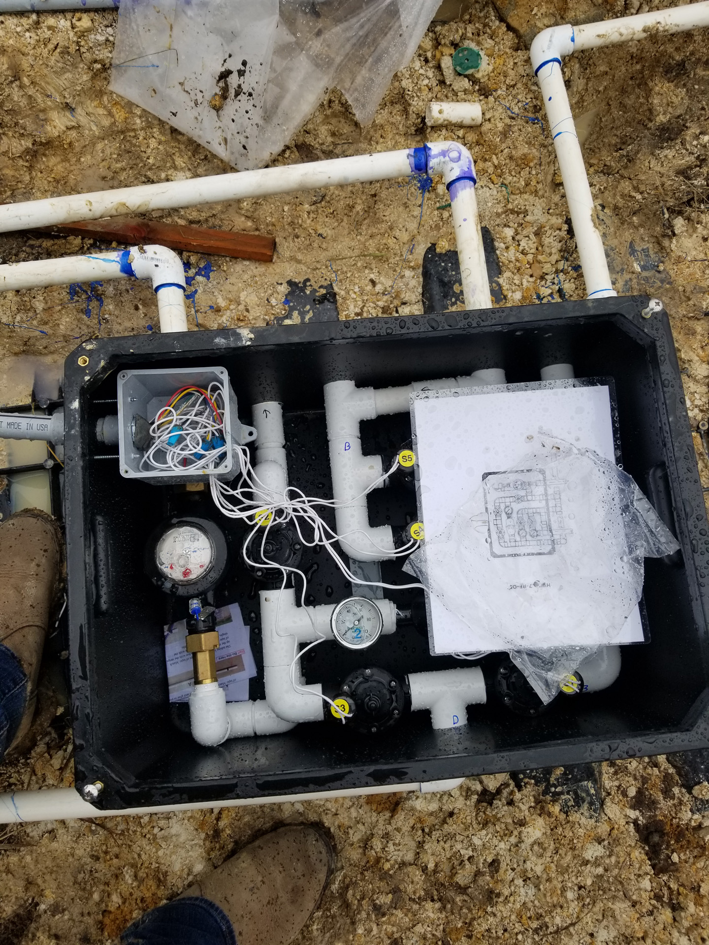

I was very happy to get a pure gravity system approved-I have a more than passing familiarity with the highly complex, computerized dosing drip systems as that was what was spec’d for our lake lot ( to the tune of around $60k)- which is why we didn’t develop it beyond the weekend cabin with holding tank.
My next door neighbor (couple of thousand feet away) just had his site evaluated and is going to need a sand pile system as his soil coverage and slopes precluded a gravity system like what I installed.
hope hes rich.
it seams lately every system i work on is high tech. i think all the good properties with easy septic availability have been developed, and all thats left are the old lots that no one ever wanted to build on cause of problems like this.
Extension cord you say. Yea that stuff is rated for direct burial. IMG_9259.JPG

Extension cord you say. Yea that stuff is rated for direct burial. View attachment 682049
funny thing is, ive seen regular romex direct buried. you would not think it would last, but ive seen stuff years old still working powering up a chicken coop or some such thing.
this is one reason the State of Idaho has outlawed a homeowner from doing ANY underground work on their own property. they can wire their own house, but cant install the wire between house and meter, or house and shop. they simply got tired of homeowners installing a 50 amp circuit in romex 10/3 placed 6" under the ground (ive seen it done).
