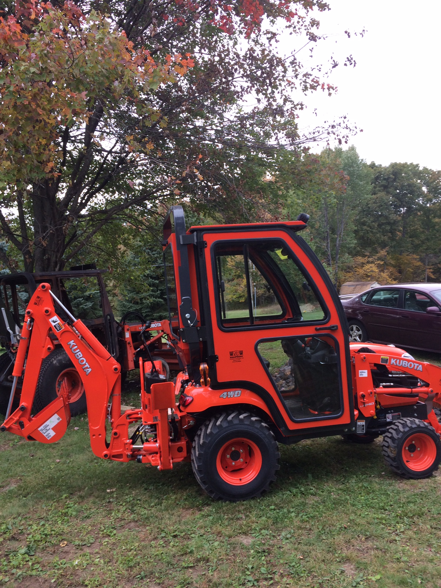

The backhoe itself does. The subframe has never been an issue - I’ll have to take a closer once my tractor is fully back together. The subframe is mainly two rails running from the loader posts back to the rear axle. I’ve never noticed them hung up on anything, and the paint is still in fairly good shape on them. I have dragged the belly pan a couple of times (once when I unexpectedly hit some deep mud), but that’s something I added, not part of the subframe.
Talk about dragging the belly...

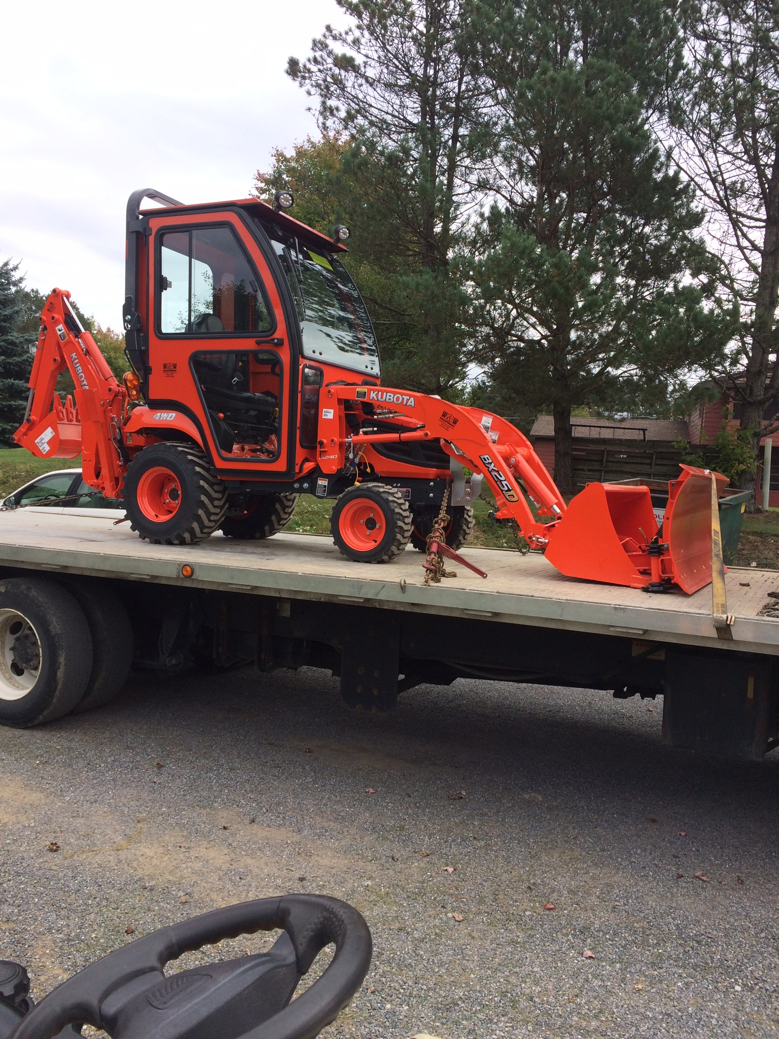

I drove my new 3560 HSTC cab off the lot and loaded it on a trailer furnished (reluctantly) by the dealership. I had mentioned to the salesperson that the bottom of the backhoe would definitely hit the ground taking it up the ramp driving forward. He said "ahh it doesn't matter, every backhoe I've seen is torn up on the bottom from this".
Little did I realize (nor did he, that backing the tractor would still get it on the trailer, without tearing up the bottom of the Backhoe.
My thought looking back is it wasn't his machine nor his $52,500 so he didn't care, and wouldn't help point me in the right direction for the same reason.
Customer service... I understand it's difficult, but gee whiz!

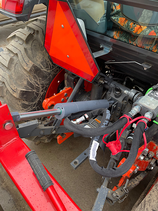

That's design and ergonomics built together. Awesome to be able to leave the lower arms in the tractor. I did a video here on trying to mount the BH92 Backhoe on the Kubota 3560... just NO clearance at all with the 3 point left on.
Additionally, I've found that a top&tilt option for the Kubota isn't offered if you have a backhoe subframe. Again clearance issued prevent this. You would think that instead of designing a subframe, and then finding that other upgrade or additional offered updates to the hydraulic functionality are hindered by its design, that Kubota would have done a contentious design taking into consideration all they need to.
You can do the top just not the tilt w/ BH. My dealer takes the OEM TnT Kit and sells just the T.
   / Anybody using a backhoe attachment on their CUT? #103
Is it the hydraulic remotes or the side link cylinder itself that interferes with the backhoe subframe? I can't really see what would interfere in that picture. Looking at the left sidelink lift arm, it looks as though you could just substitute a hydraulic cylinder there. Or is the upper attach point for the backhoe too close to it?
It does look crowded enough that you would have to take the lift arms off when installing the backhoe.
