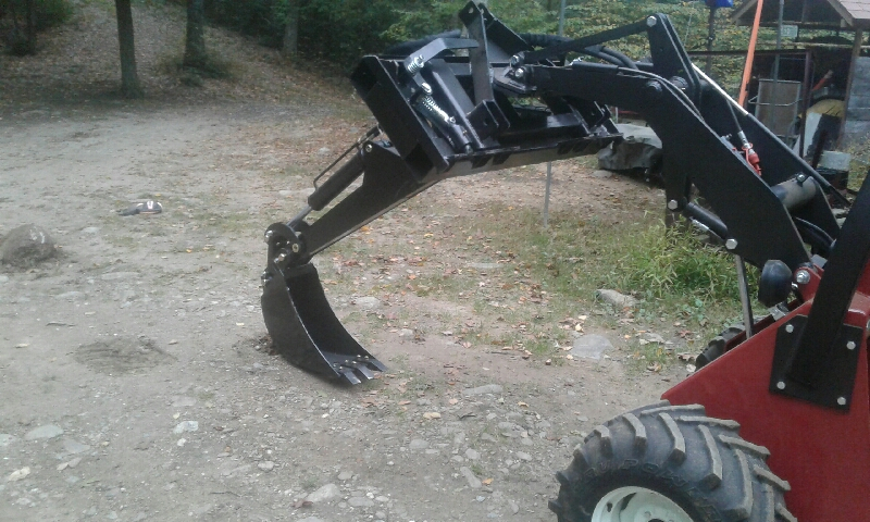

I now have at least one more question. And some observations too. When using the Case 580 it is not very easy to turn the seat around. So when moving the machine short distances I usually use the hoe for this task. The hoe will pick up the rear wheels so even side to side movements are possible and I have done it often. But more than one person here has said I will need to climb off the hoe and back onto the tractor to move it every three feet. Why would this need to be done?
I have looked at the linkage for the Power Shift and have determined that I could, without too much trouble, hook up a shifter so I could go forward or backward while sitting in the backhoe seat. Since the Power Shift doesn't require clutching it would be sorta like using the shuttle shift on the Case.
Since I would be using a sub frame with the little hoe would it still be dangerous to the tractor to lift the rear and shift it sideways like I do with the Case? I did crawl under the tractor to see how a sub frame would fit because there is already the FEL frame. Using cardboard and cutting it to fit around stuff I can see that I can make a sub frame that will work and bolt into the existing channel frame at the front of the tractor and clamp around the rear axle housing. There are even a set of grooves on each side of the rear axle housings that appear to be there for just this purpose.
Most of the rocks I will need to pick up weigh less than 200 pounds so as long as the thumb will allow that I would be pretty happy. For heavier rocks I would still use the bucket as I do now.
I do understand that the little hoe will not dig like the Case but I don't expect it to. If the Case wasn't so big I would just use it for everything. And I could just rent a mini excavator except the nearest rental place is about 60 miles from me and I would need it delivered. Living on an island can have its drawbacks.
I'm gonna keep reading this thread before I make a purchase. Like I said I have looked for someone who would want to trade my big Case for a smaller machine. And I'll keep looking for that option too. If I could trade it for a mini excavator with a thumb I would be very happy. But that's not gonna happen.

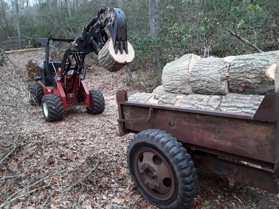

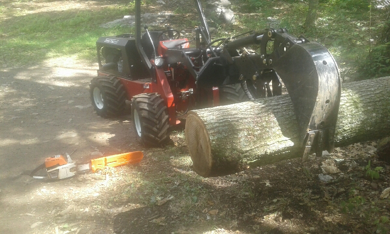

I have done a lot of work with the Case. I bought it to install my septic system even though I had never sat on a backhoe and had never done any septic work. The machine has done a ton of work for me but It really sits idle almost all of the time. I use my YM2310 with the FEL for much of the work I used to do with the Case. The bucket doesn't hold as near as much but the much smaller size of the machine makes it so much easier to use around the place now that it is pretty much developed. I would use the Case more if the backhoe wasn't attached but I am not going to attempt removing the backhoe.
So even though the Yanmar is smaller and so can't carry as much the small size makes it possible to get into smaller spaces and I don't need to constantly worry about where the backhoe is. With the Case I am constantly looking back to make sure the hoe doesn't hit something and I use my hands to press the boom swinging pedals to swing the hoe out of the way quite often. It seems like there is always a car or a truck or a tree or a bench or whatever that needs to be missed.
I do love the old Case though, it has done a LOT of work for me. Besides the septic it has put in ditches, dug big holes for rock disposal, put in a road and re-habbed another, buried my neighbor's horse, etc.
Eric
