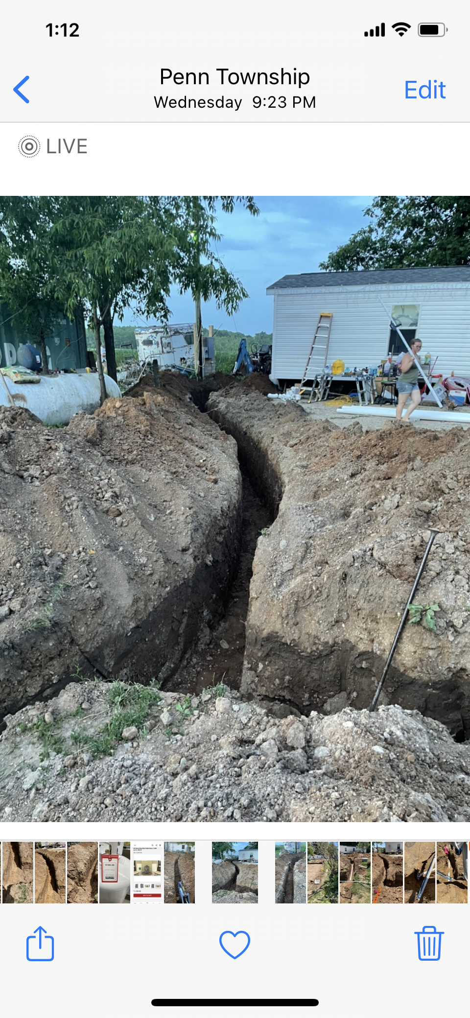

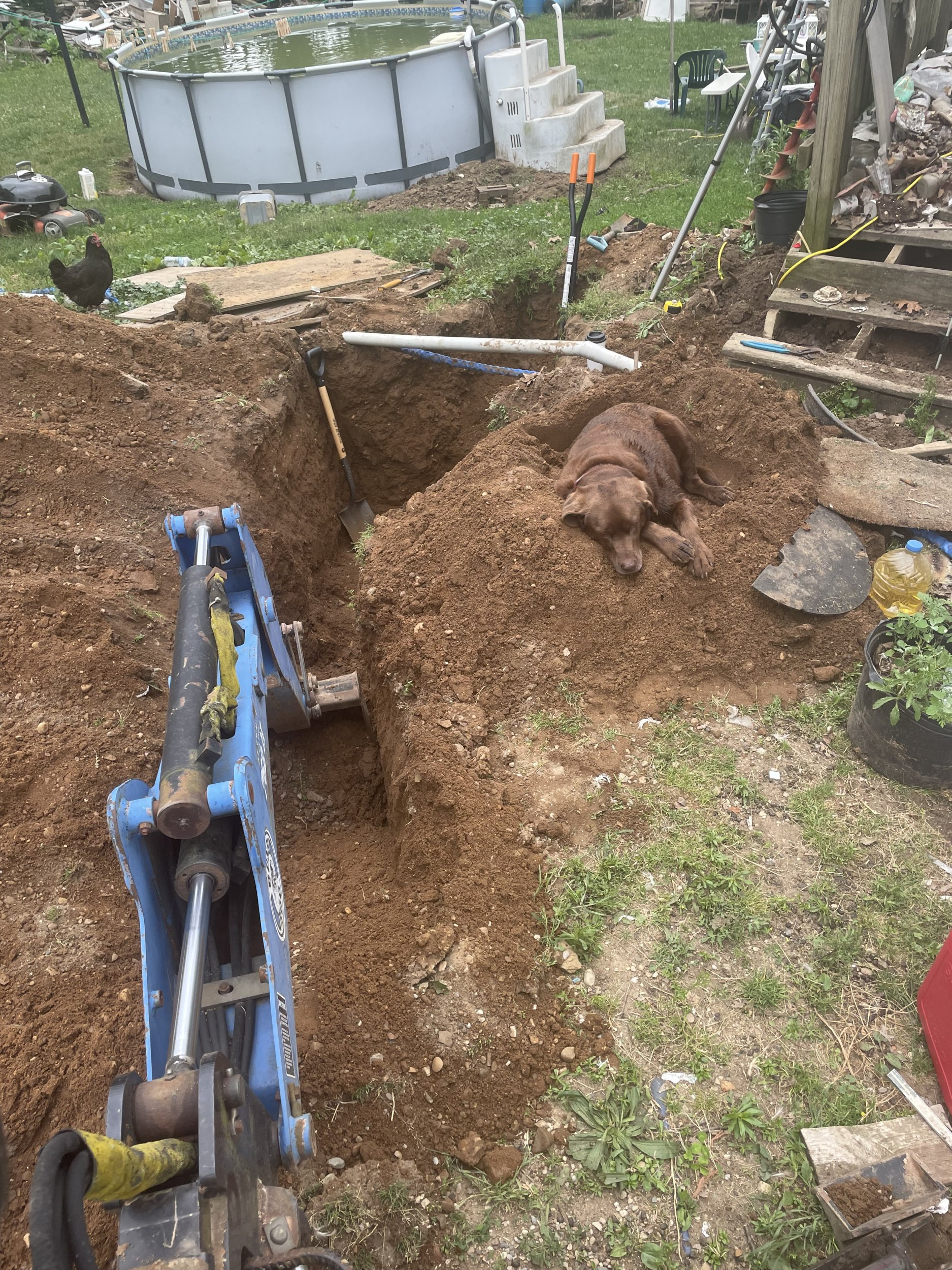

I have a 1960’s International 404 with a loader. I bought a Bush Hog BH with a NH subframe, modified the mounts to fit my tractor and built a 3 pt power pack. I dug a 32’ x 50’ foundation for my new house. Later I trenched and backfilled over 120’ of sewer and electric conduit from 36” to 54” deep in an afternoon. Mostly it runs at idle and has all the power I’ve needed. I have a 20” bucket but a 9” is the standard issue size with options to 36”?? (I bought it sitting beside the road for $2500 and about $1000 for power pack.) Don’t like not having 3pt access but wouldn’t give up BH! Just haven’t taken time to unhook it and replace 3pt arms.
