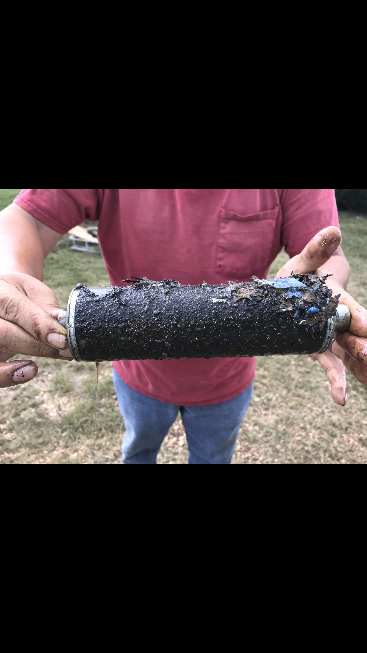

#53
Well thought I would update on this headache I’ve had on this tractor for a long time finally solved the problem 20666314-B6C0-4BF1-972E-F3C7048B53F9.png
/ Another John Deere 1050 hydraulic problem. #54
Thanks for that update. Hope all is working ok now. Been a tough row-to-hoe for you.
