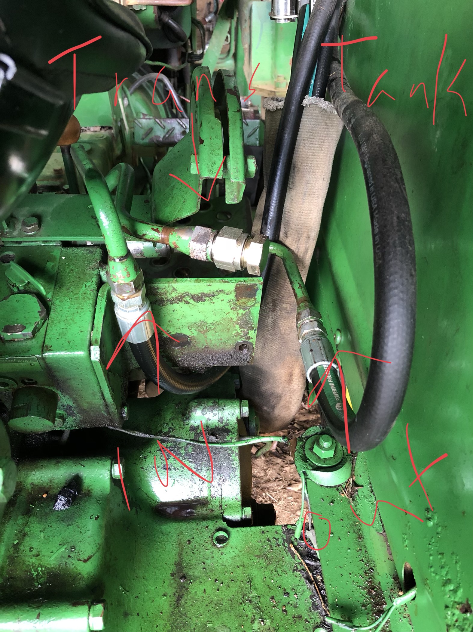

Ok so I was having a heck of a time tryin to figure out how to hook up my joystick controller on my JD 1050 with jD fel. But I finally got it it was the pby plug missing an o ring. Now I haven稚 ran it much maybe a couple of hours since the fix. Well about a week or so ago I started bush hogging and notice that the bush hog when I tried to lift it up it wouldn稚 move neither would the front end loader so I cut the tractor off and look around and can稚 visually see anything. Crank it again and nothing I had to leave it in the field over night came back the next day and the bush hog would lift and so would the fel very slow on both of them but they lifted enough for me to bring it home. So today I went out and try to figure out was going on so I cranked the tractor and it did the same thing I could hear the pump so I let it run for a while went behind the house about 50 yards and bush hogged and when I went to raise the bush hog nothing again. I think it痴 only working when it痴 cold and once it gets hot it quits working. I知 at a lost please help. Thanks for all the input.

Can you post a photo of how you attached hoses to tractor to supply oil for FEL valve? Did tractor come with scv?
/ Another John Deere 1050 hydraulic problem.

Question.. did you have a reason to connect it this way, or was it by trial and error?
Sounds like some restriction isn't allowing the hyd. fluid to flow, thus heating the oil and then failing to work.
Puzzles me what the capped/plugged line is supposed to go to..
More pics of where these lines go to might help with answers.

My 2240 already had a loader when I bought it but, the old 2 lever valve was bad. I replaced it with a joystick type. It does not use the power beyond port and is setup closed center. The pressure line is teed into the hard line going to the lift box and rear remote. The out line is plumbed into the filter housing. I think it's a kit that be bought from JD.

That’s how it’s hooked up right now. This tractor had the old style 2 lever control and was replaced with a joystick. I feel like I’m still missing something. It’s driving me crazy.

And the three point hitch worked before you added the loader? Does it have power steering? The plugged line shouldn't be plugged. Ill look and make a diagram tomorrow.
Am I right that I'm only seeing six lines going into the valve block? There should be seven: spool one +(2 lines) spool two = (2 lines) supple, return and power beyond.

The power beyond is the plug on the left side that you can’t really see. It’s plugged Up now.

I need to see how the lines are suppose to be hooked up to the joystick. And coming from where on the tractor
/ Another John Deere 1050 hydraulic problem. #19
Got it. I have a 950 with a loader mounted valve like you have. It's at my widowed mothers ranchette, but depending on forgetfullmess, I'll make you a diagram of how mine is piped. I should be able to subtract the PS power divider from my diagram.
