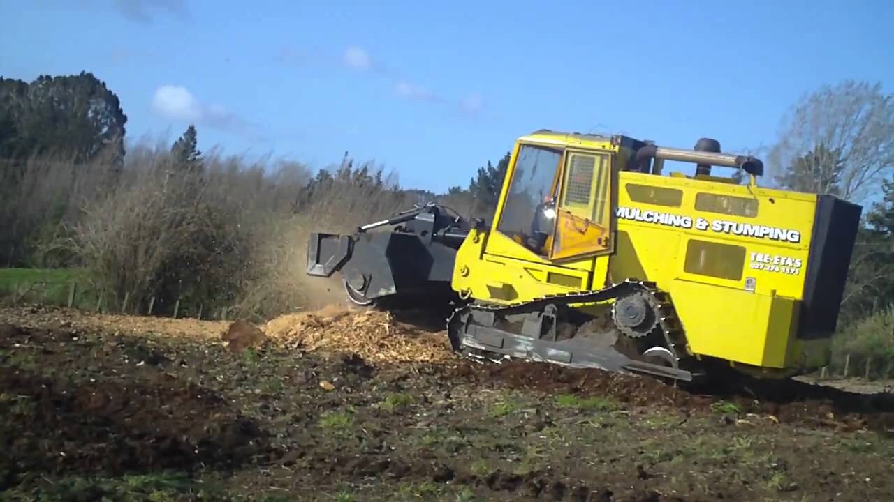

If your interested in alternatives, a stumpgrinder would be an excellent choice here. Those stumps would be quickly ground away with a PTO stumpgrinder and anything more than 30hp or so at the PTO. The difference between stumpgrinding and digging the stumps out has many benefits:
Less chance of soil erosion, bringing up rocks, and losing organic material
Considerably less time in the vast majority of cases (unless using a really large sized excavator)
exponentially less cleanup/"mess" by grinding vs. removal.
I have both, a PTO stumpgrinder, and a 43k lb excavator. I still grind my stumps unless there is reason for complete removal (building a structure over the site, excavating out material to make new grade etc.)
