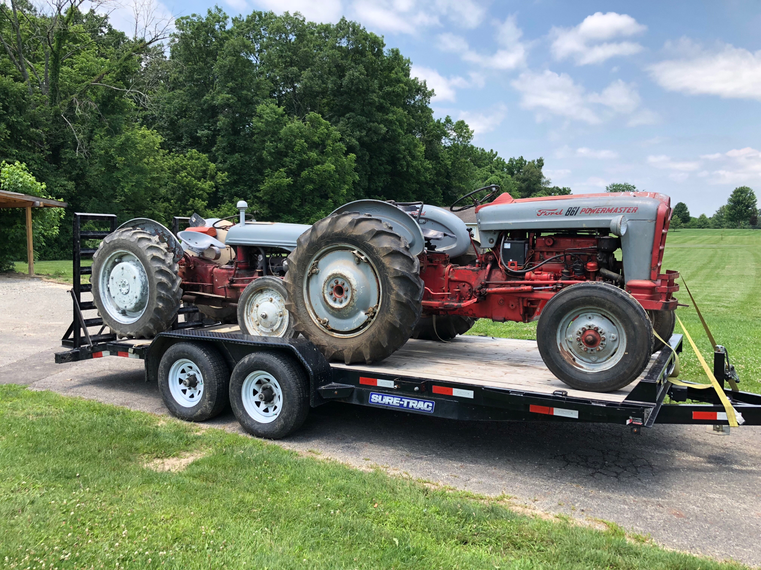

Then a 8n or smaller yet cheap tractor can handle all the driveway maintenance. 2n, 8n and 9n’s can be bought for $1500-$2000.
On a JD 110 the backhoe still comes off and you can put 3pt back on if needed.
Those old ford tractors are fun to scoot around on, that’s a 62hp 861 Powermaster in front of a 2n. I like driving the 2n around more lol.
