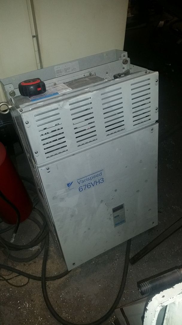

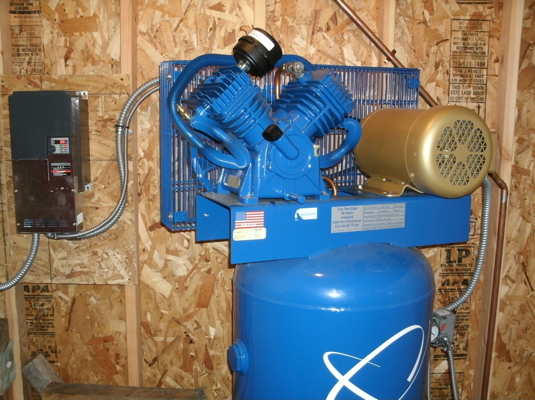

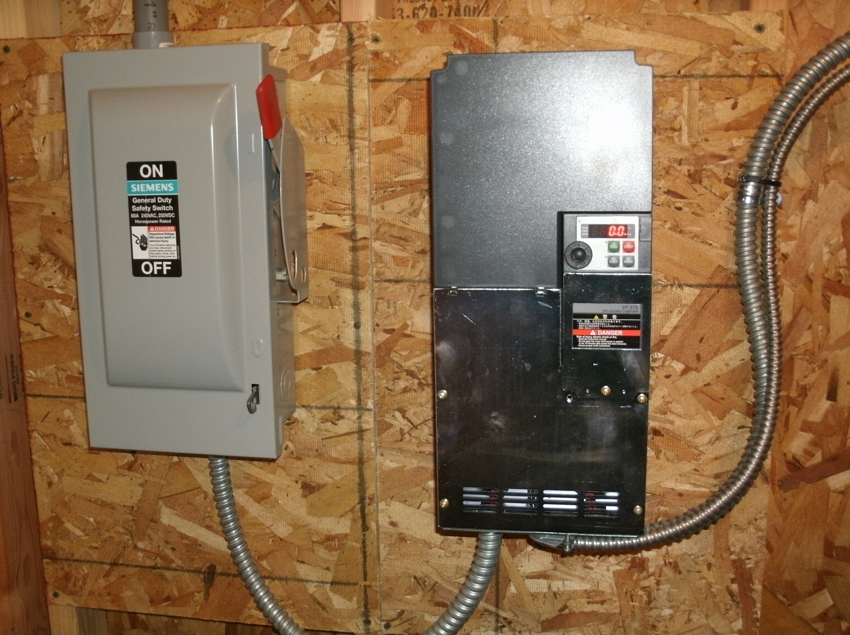

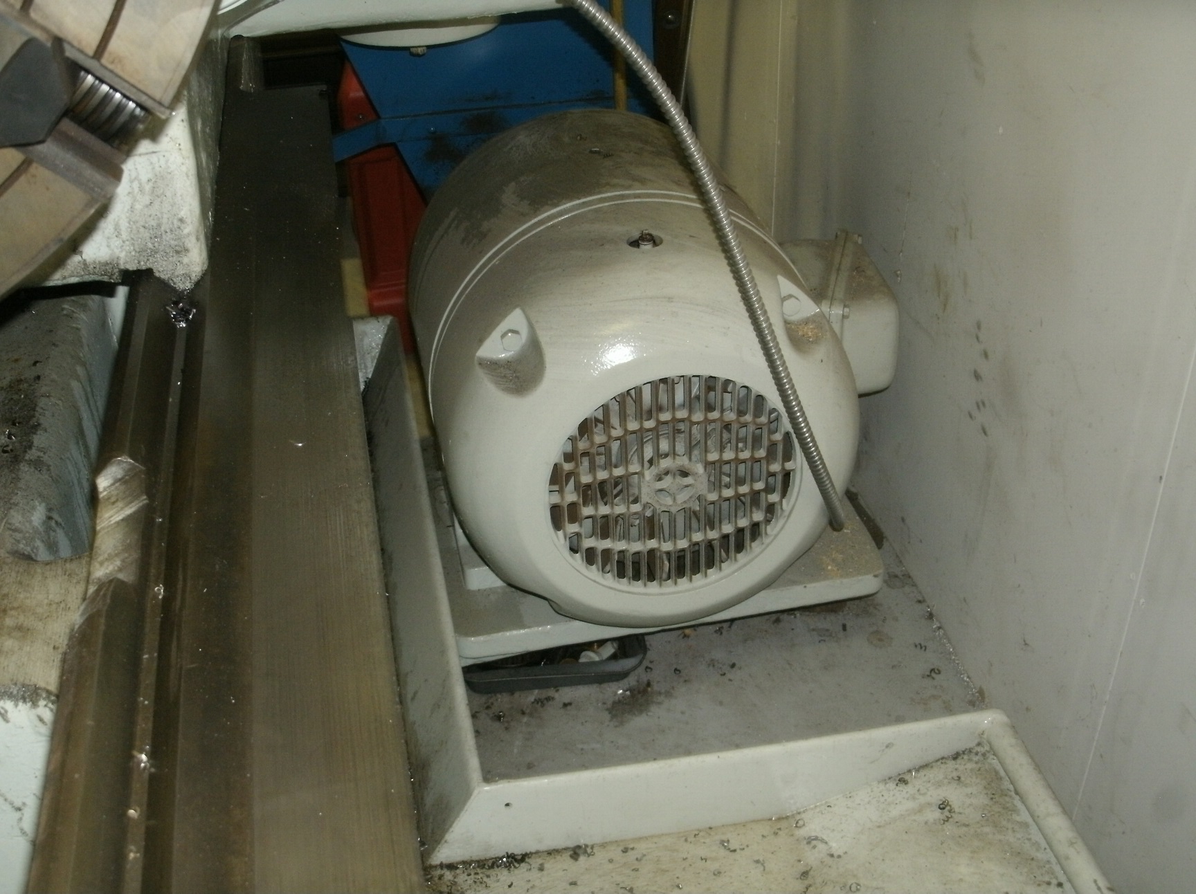

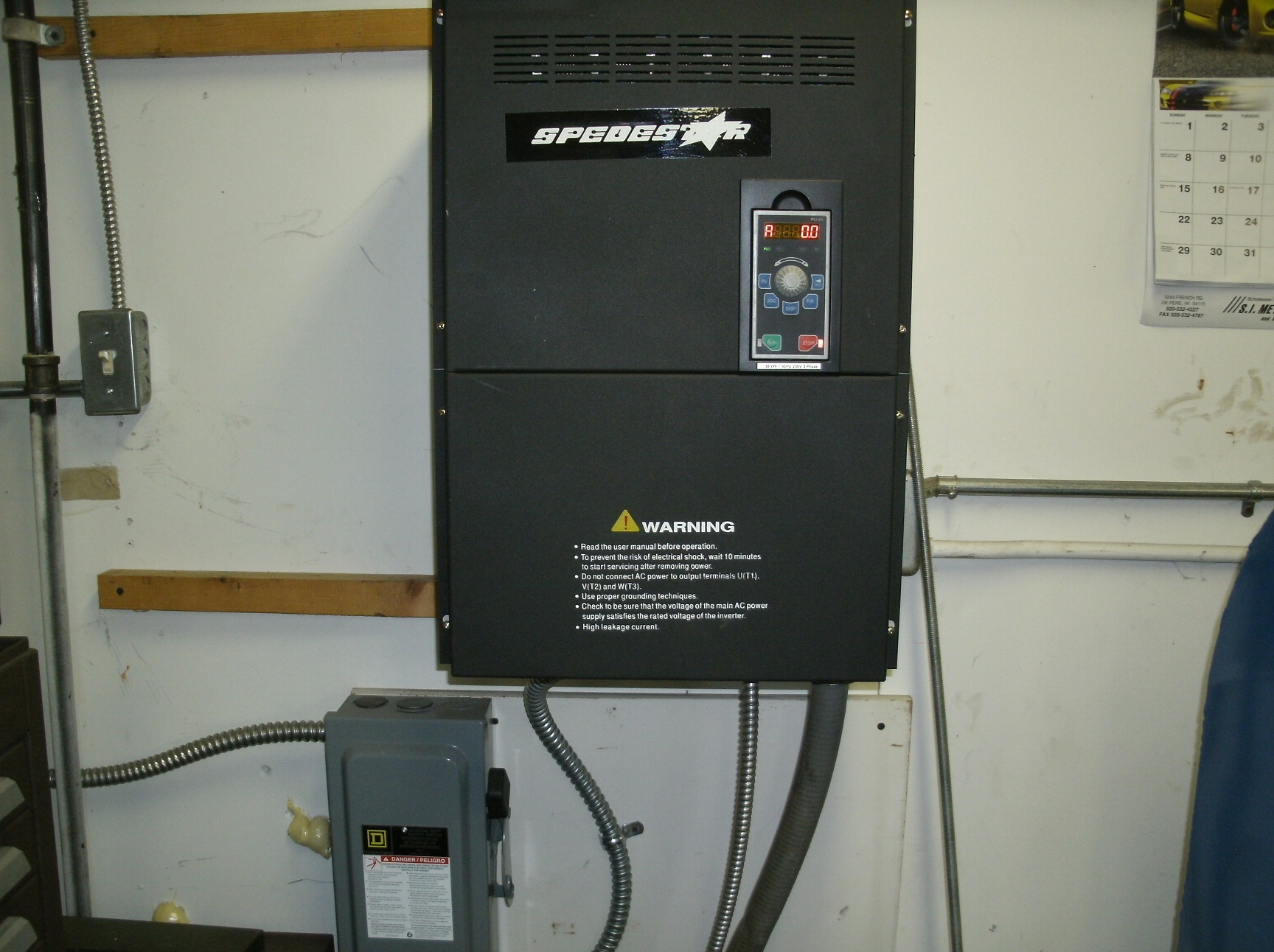

Yup. Your VFD is bigger than my VFD! But the message we're both trying to get across is don't be intimidated by 3ph motors. The first two pictures are my 40hp VFD running my 20hp motor for my lathe. The third and fourth is the 15hp VFD for my compressor which I installed a 7.5hp motor and larger pulley to get some more cfm. Don't worry, I consulted the manual before the upgrade to make sure the rpm was OK.

I got my 40hp electric motor as NOS for $350. Someone sized it too small so it was no longer returnable. :D I only needed about 26hp, but 40 was cheaper than 30. Running a 24hp load on a 40hp motor doesn't even begin to work it, so you get better efficiency there too.
It's not voodoo. VFD's are the way to go on small machinery. I have 3 of them directly running my Mill, lathe, and surface grinder. A surplus vfd will cost less than a new 1ph motor, and will result in lower electric bills in the long term. One is cheap now, the other is free down the road. ;)
