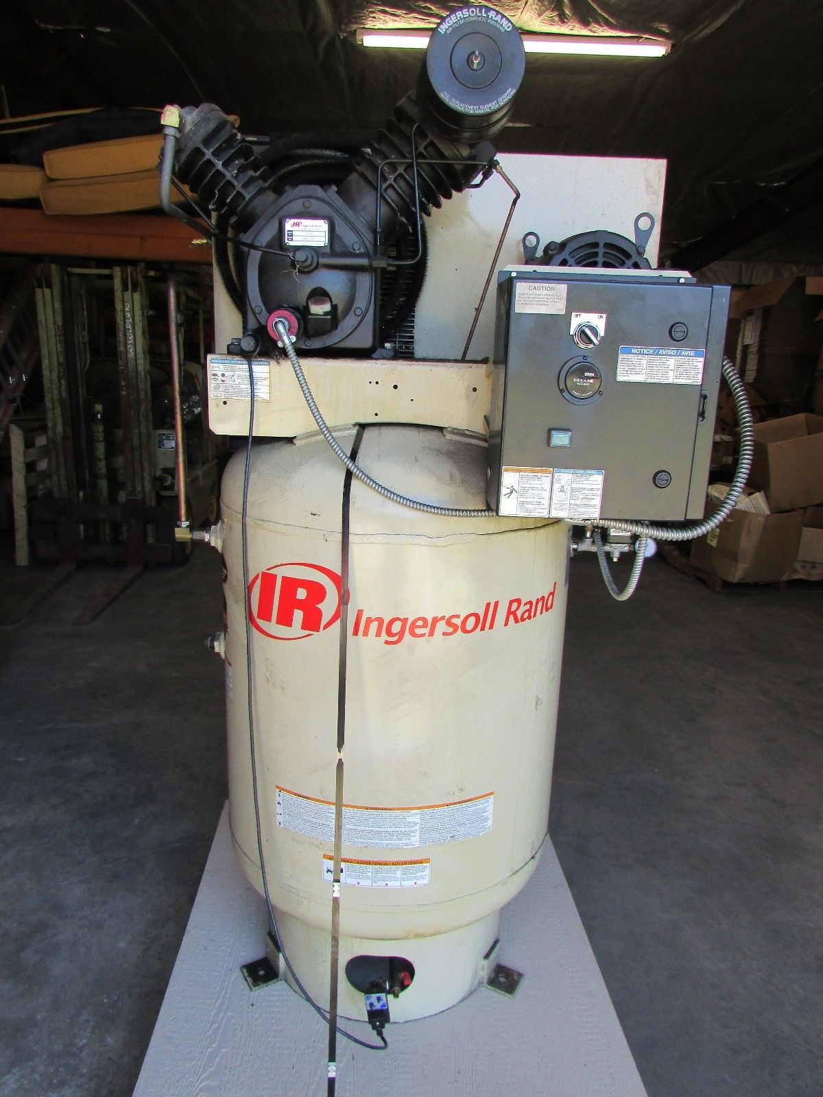

I told myself I would just buy a new compressor and not have another project on my hands, but I didn't listen to myself when I came across this.
it's currently 3phase so I will need new motor, pulley, and starter relay. I have some (limited, but enough) experience with motor/pulley work, but the starter/relay thing is new for me. I will likely be installing a 5ph 230v single phase, although 7.5 might be possible. Suggestions on where/what to buy. Can I buy a 7.5 relay, and use it with a 5hp, or do they have to be size matched (I do understand that I can not use a 5hp switch, on a 7.5 motor....). I see some 'no name' items on flea bay, and I am a little worried about them. Oh and Happy new year to all! To save some replies: the writing (one of the 30 labels) on inside of the relay box state it is only rated for 3hp on 230v single phase, so I can not SAFELY use it...

You can use a 3 phase contactor on a single phase motor. What you need to look at is how many volts the coil needs. Not familiar with that compressor, if you can take a pic of the contactor would help. But I am betting it don't need changed.
And what HP motor is the 3 phase in it now? Before sending a good chunk of money on a new motor, I'd buy a VFD. It would be alot simpler and quicker to set it up vs doing a motor/puller swap

Have you opened the weatherhead on the motor? If there are more than four wires you may have a multi-volt motor and can simply rewire the motor to 230v single phase. Multi-volt motors are common in industry.
If multi-volt there should be a wiring diagram inside the weather head detailing the wiring configuration.
/ air compressor magnetic starter/relay single phase #7
No need to open the cover usually, there will be a diagram on the outside showing the two configurations, as well as the nameplate being stamped something like 230/460 or 208-230/460 or something along those lines.
HOWEVER, if it is a 3 phase motor, it is a 3 phase motor. You cant run a 3-phase motor (EVEN wired for low voltage 230) on single phase 230 power without a phase convertor.
So you can still re-wire it to 230/340v, but you still need to feed it with 3 legs of power and not the 2 that come from single phase

I will review the replies as I can. (thank you all..so much) but to refresh/restate some info. I bought the compressor (have not yet been able to run it) with a 10hp 3phase motor installed (wired for 460). I have not issues keeping the current motor installed if I can buy a product (VFD, or otherwise) that would allow me to run the current motor from a 50a 230 single phase power source. The link that someone provided (thank you) had a price of over 700$.
