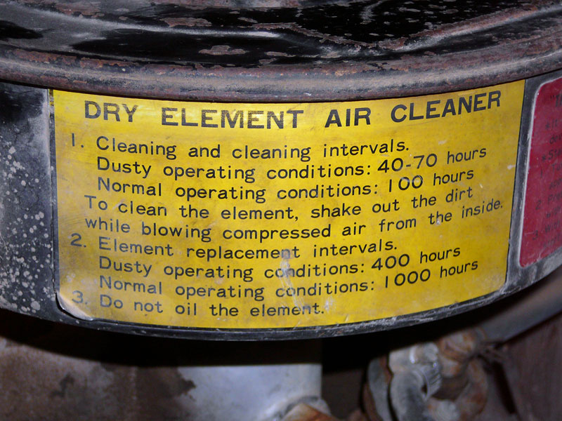

...after reading on here that the original yanmar filters were a washable cloth.
My US YM240 has a decal on the filter housing showing instructions for cleaning and reusing the element; with 1000 hour replacement interval. They must mean the mythical and unobtainable fabric/wire wool element.
Long ago I posted that photo uh - elsewhere. Mark777 (a Yanmar restorer) replied "Hmmm, thats interesting. I'm wondering if Yanmar is referencing the permanent wire wool and fabric, washable elements that you only occasionally see on a very few models? I can't think of one supplier that still has, or can acquire those any longer."
And later, Mark said the cleanable filter (after cleaning) weighs twice as much as a pleated filter so it is easy to tell them apart.

My US YM240 has a decal on the filter housing showing instructions for washing the re-usable element.
But I've never seen a washable cloth filter element, only the common pleated paper style.
Well maybe i was wrong about the construction. I am not sure what the original was made of. Mine does have the yanmar logo on it though. Maybe i was thinking of washable cloth because thats what the automotive ones are made of, like a cotton gause i beleive.
I know i did read that hoye was cloth filter media though.
Could you post a pic of the decal or just paraphrase the washing instructions?

Oops, sorry, I revised my post (above) to better match the photo I just added to it. I didn't notice there was already a reply to my initial text!
