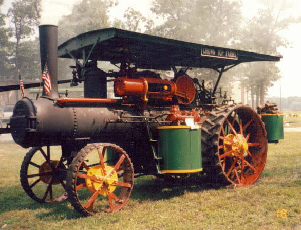

Somehow I doubt my YM2000 will outwork that steam tractor for plowing fields! :laughing:
I know using an inertia dyno isn't going to give me comparable numbers to a PTO measurement. I was just curious if anybody has experimented with them in general.
Well it may not out work it but I bet you get more H2O mpg than that machine!!!! :D
