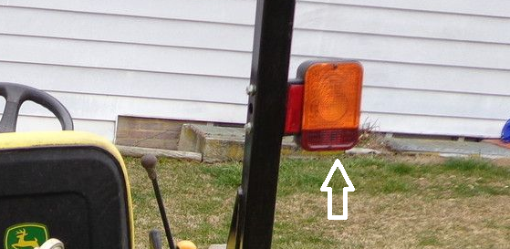

Ok, so I did some research last night and discovered that there is indeed a tail light on my 2305; a small affair located on the bottom side of the hazzard lights. This red light stays on (solid) whenever the headlights are on. I will check on the purple wire tonight to see which one is the better option. Either way, I don't think I'll need to add a fuse to the line since both of these should be fused aleady. If people are interested I'll post some before/after pics with this as well as details as to how I did it and what the results were.
Tail Light:
