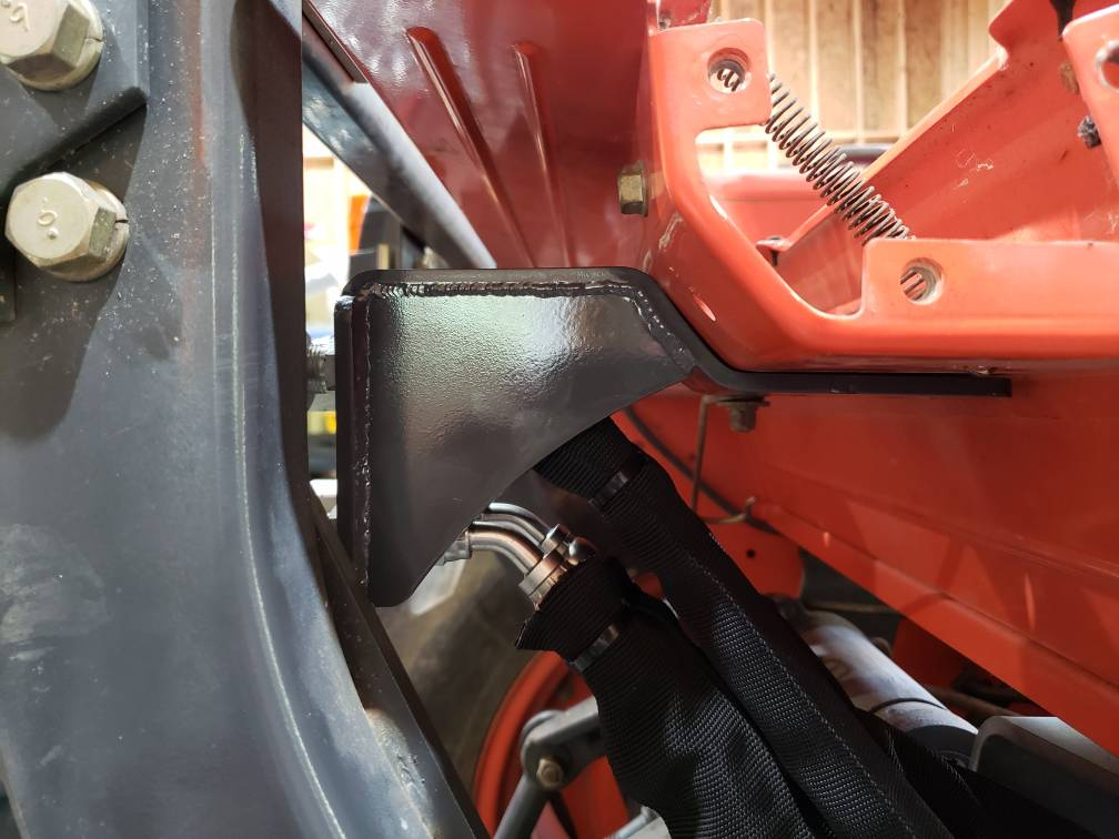

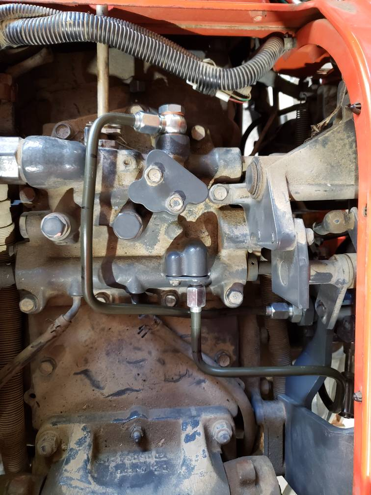

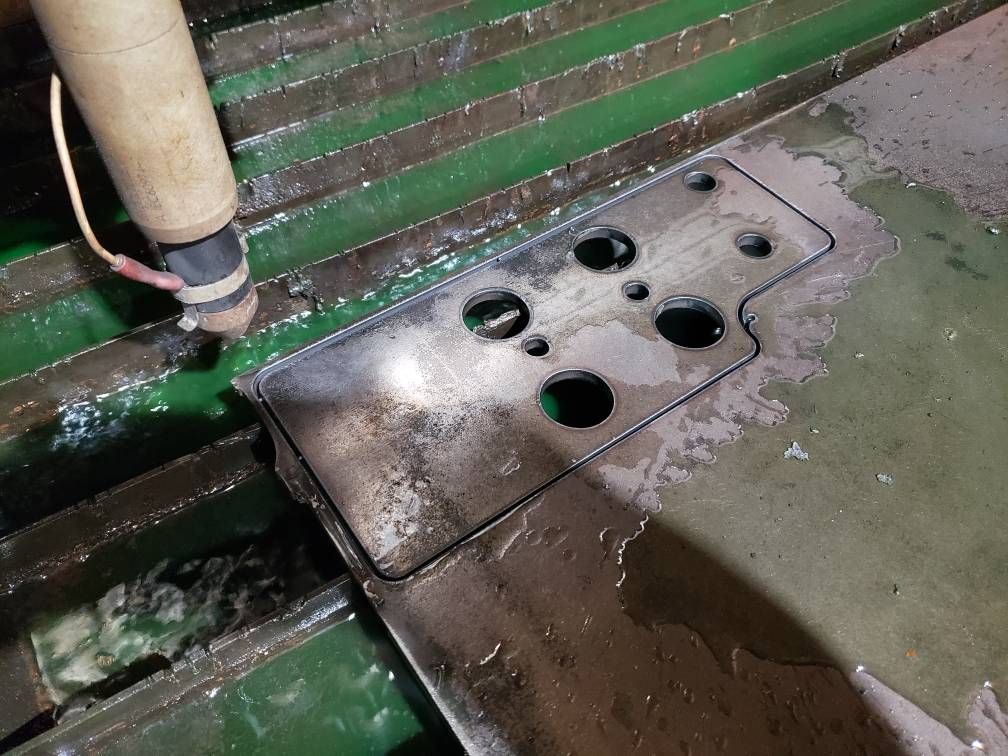

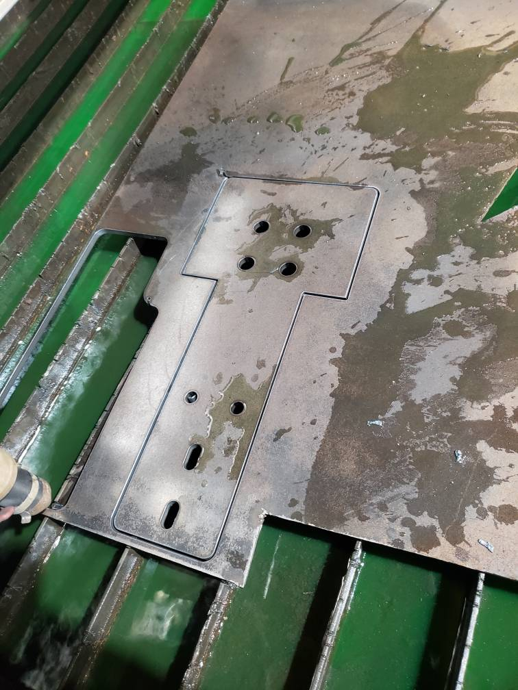

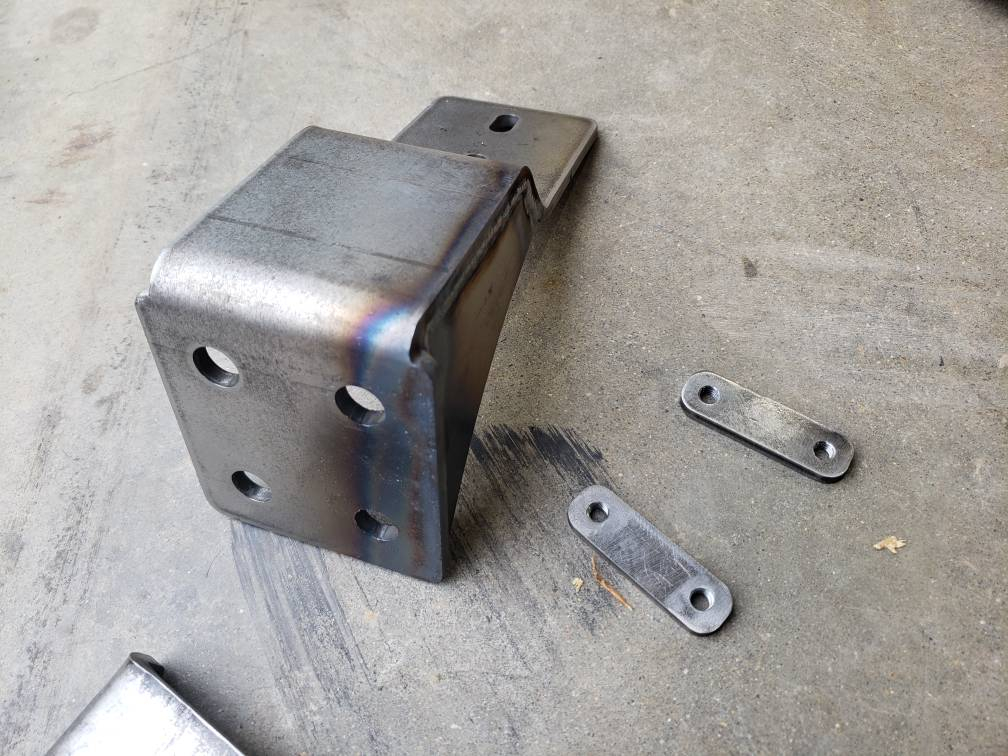

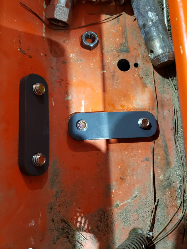

Made some good progress over the past couple days. Was able to make up some hard lines for to finish the tractor side up.

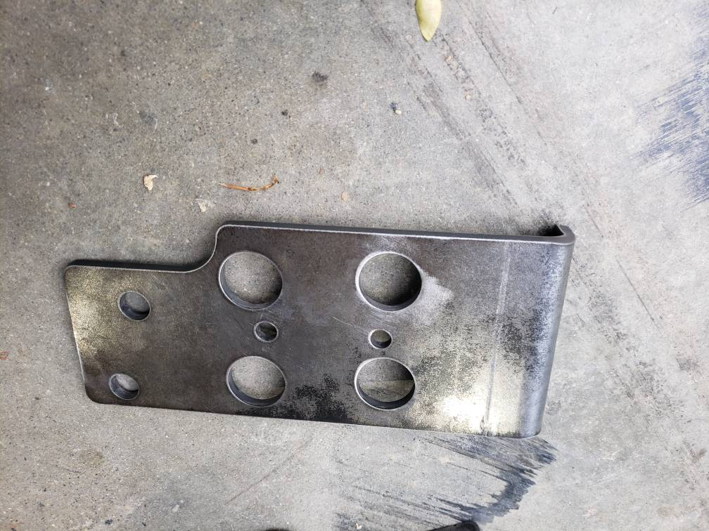

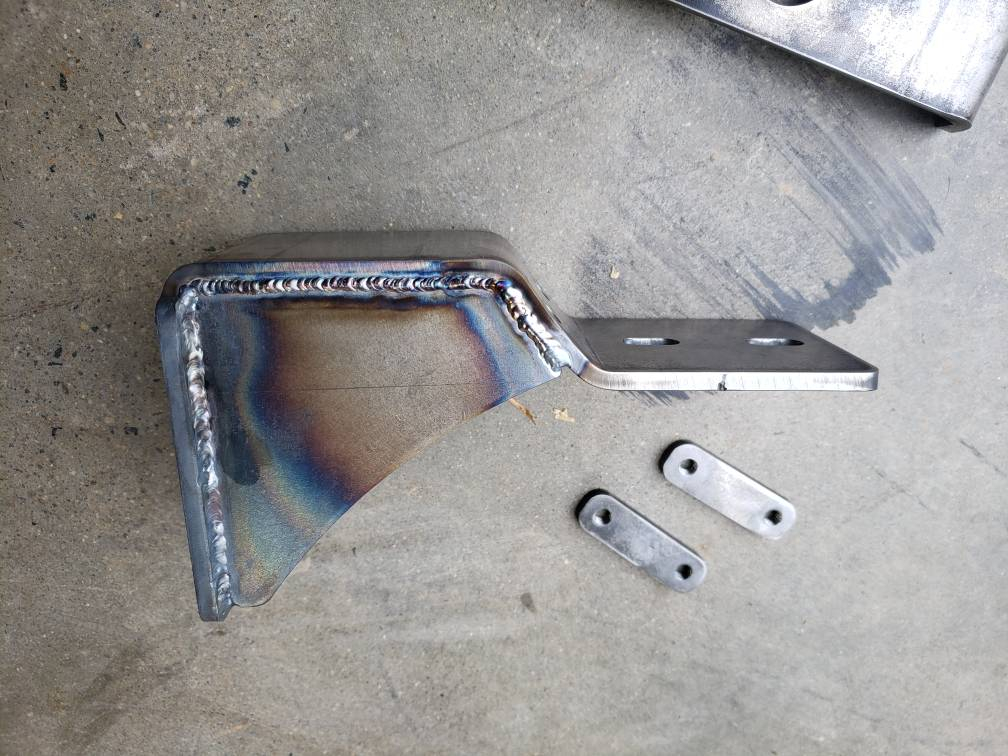

Cut out end bent up the mounting plate for the QC's. Turned out pretty decent I think and is very sturdy. (The picture of it cut out was of a rejected design but I forgot to get one of the final version before I bent it).
Also made up some threaded backers for mounting it.
You might have noticed that the other bracket only has 4 holes for 3 remotes, well the reason is I'm running a diverter valve so I can have 4 remotes total. This is the mount for the diverter.
   / Adding rear remotes to a Kubota L3240
#17

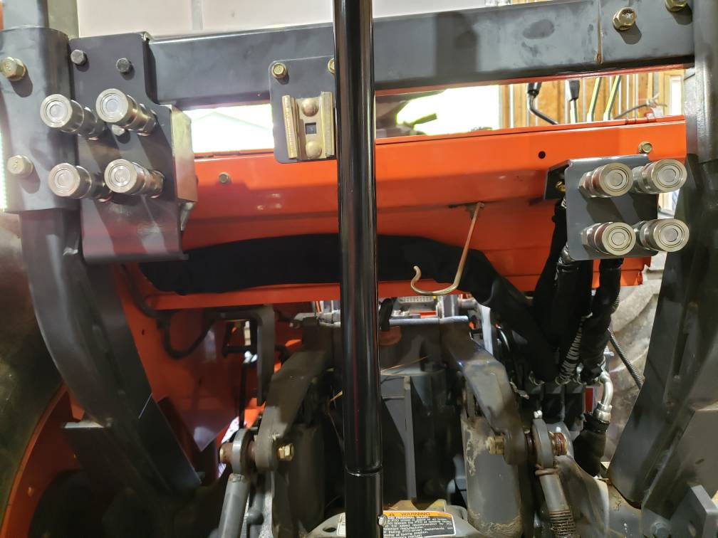

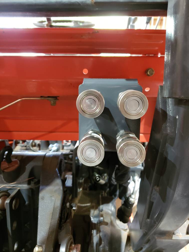

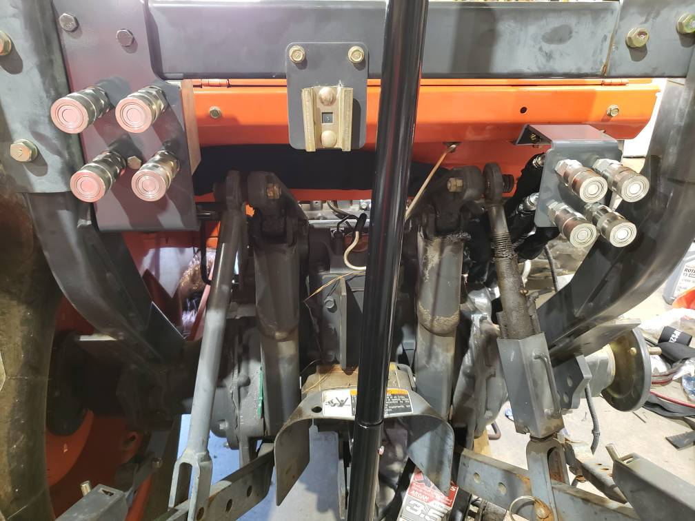

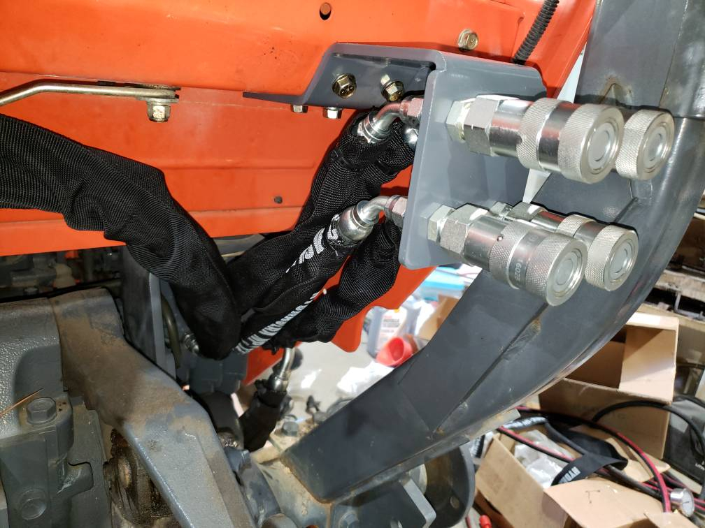

Got the brackets painted and everything mounted up and connected.
Pretty happy with how the main remotes sit.
Made up all the hoses to connect everything. Really love having a hose crimper!

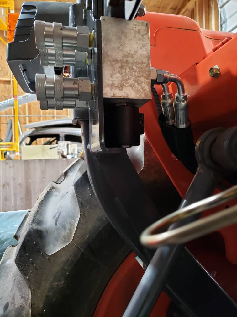

Diverter all mounted up, still need to be wired and waiting on some longer hardware to mount it (didn't have any M12x1.25x70 bolts). I think the bracket should provide enough protection for the solinoids.
The diverter sticks out a little more then I like but I dont think it'll be a problem, its going to have the T-n-T mounted to it pretty much all the time anyways.
Now I need to make up some lines for the top link and the rotary broom, then modify the fitting for the flail mower so I can use the 3/8 QC fittings (currently they are 1/2).
Looking forward to being able to use the tractor again, next up is adding the diverters for the 3rd function and SSQA!
