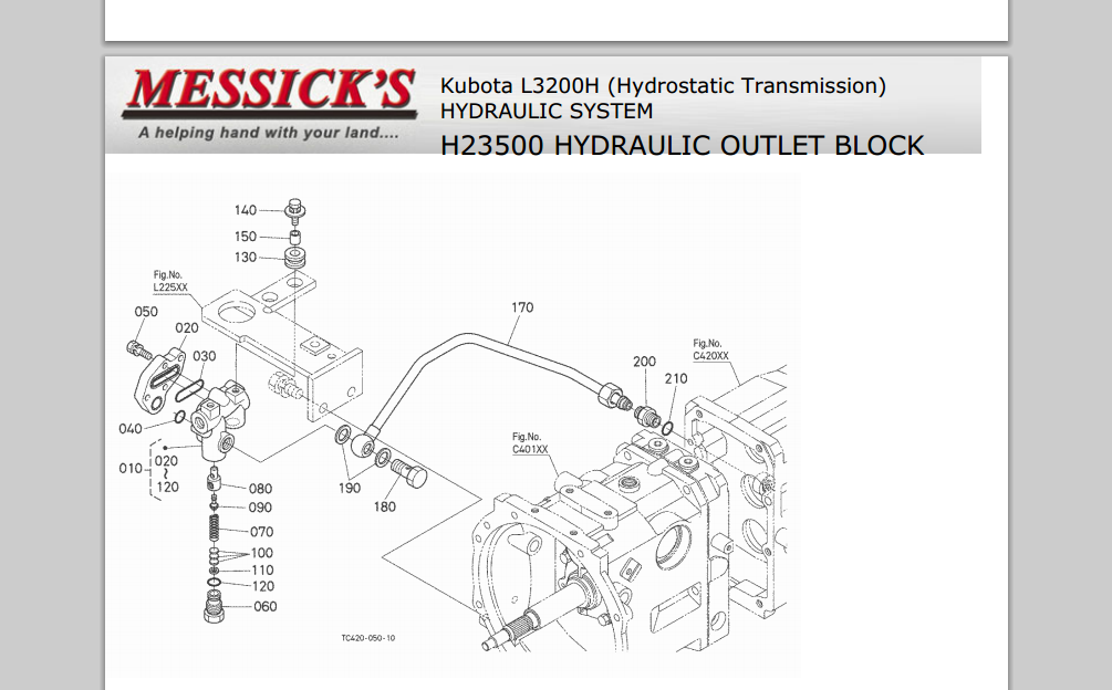

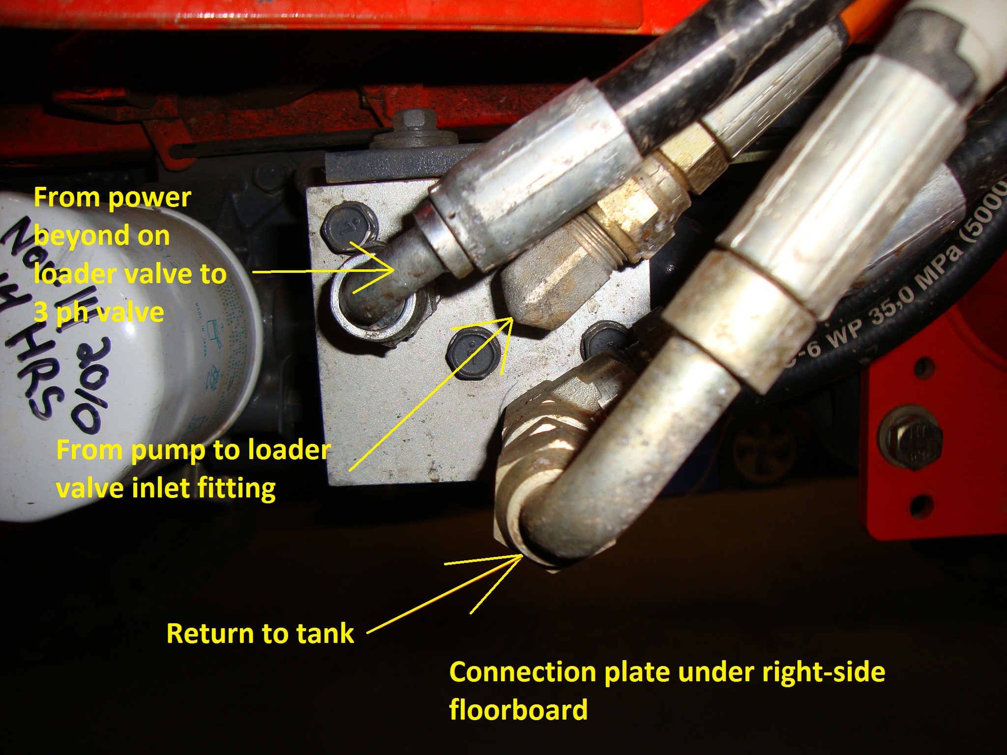

This picture is not mine, it's from someone here on TBN, can't remember who. See if your loader hooks up like this. If so you don't need to cut any hard lines.

I believe your hyd block is different.
That hyd block appears to use flow/pressure in from pump , a PB line from FEL, and an OUT line.
The original hyd blk was only used to pass fluid to the 3pt.
The hyd block adapter modifies the original path to go from pump to FEL, back to hyd blk, then to 3pt.
If there is a hard line between the hyd blk and the 3pt, you will have to cut it to insert the remote valve unless you can find some adapters for a banjo fitting.

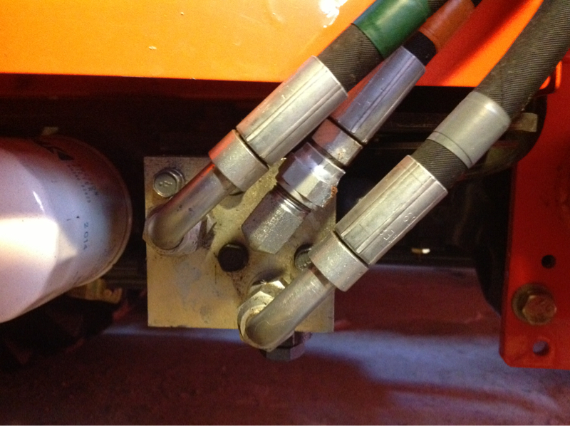

Referencing the pic of the hyd block, you could remove the PB line from the FEL and add a new line to the IN port of the new valve.
The PB from the new valve would connect to the hyd block.
The OUT line can connect to any return hose to tank.
No cutting necessary.
First pic is just to show the hyd blk without the adapter added.
Similar pic shows details.

The PB from the new valve should return to the hyd block if it looks like the picture.
FEL out line is going to tank if the adapter blk looks like the last pic I posted.
The OUT or return lines can all be teed together.
Will have to see your pic of hyd blk to advise more.
If you have to cut and swage, it is not difficult at all.

I talked with the hyd tech at a Kubota dealership, and the last picture in post #13 is what your adapter should look like.
It is actually a matter of choice.
If you cut, you will have two fittings and three short hoses.
If you use the PB from the FEL, you will have two longer hoses and fittings, and a short hose to a tank line.
