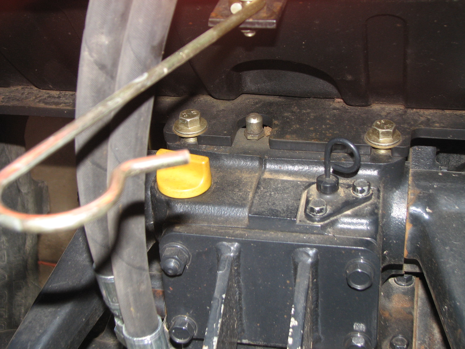

I am not trying to confuse you, however i can understand if my confusion is rubbing off. The prince valve in the picture you attached is the OEM FEL valve.
I am glad to hear you say that is a relief valve port, as i could not figure out what it was. I had thought it might be a pb port.
I am installing a separate 3 stack valve for use with rear remotes, and i have not installed any of the hoses for it. It is merely mounted to the tractor awaiting hookup.

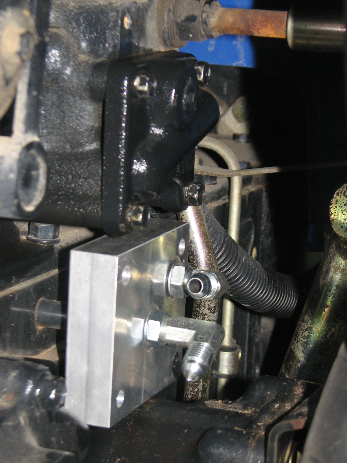

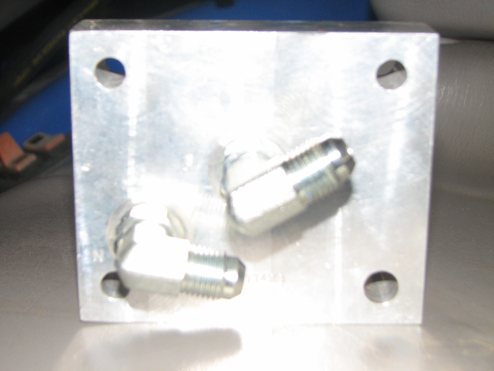

Below the pictures will show the changes I have made since I read some of your other post. I plan on replacing the black cover with the aluminum block. I reinstalled the PB port and will connect a hose to it and send it to the aluminum hyd. block pictured. The "pressure in" I plan on also hooking up at the aluminum hyd block (center most connection) and connecting to the "in" port of the stack valve. The "out" as I now understand needs to return to tank. So i was thinking instead of cutting the piping on my tractor i would replace the yellow fill cap with a sae 12 oring to 1/2 Jic fitting.
Please correct me if I am wrong in my assumptions or plans.

What is the purpose of the hyd block with the two ports and fittings.
If I were to add the blue remote valve, I would find the line where the PB line goes into the side of the tractor for the 3pt, and insert the remote valve in series with the PB flow.
The blue valve needs a PB adapter to feed the 3pt IN port on the side of the tractor.

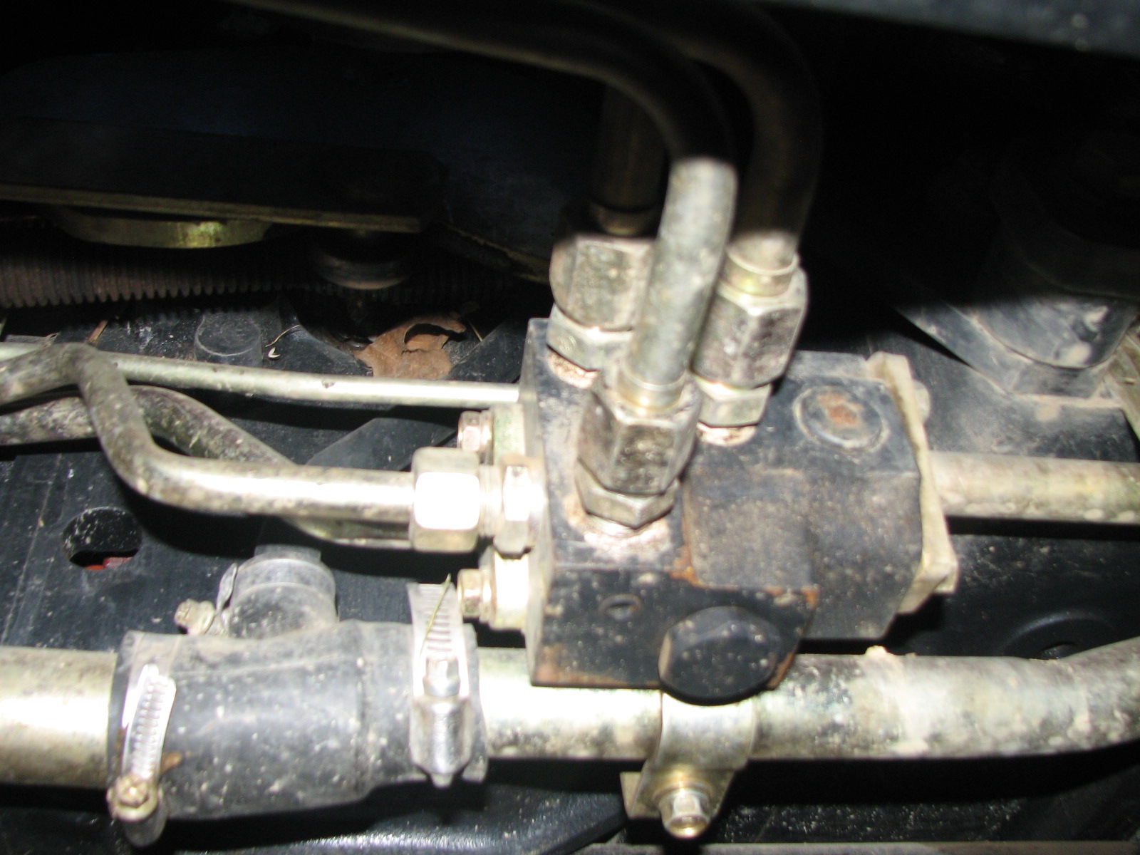

Do you not have a hyd block where the pump flow goes into it and the output goes to the loader valve? First post, third picture.
It also has the tractor relief on it.

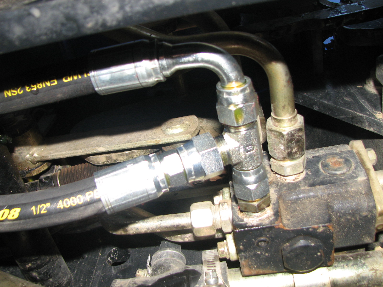

Thanks Farmerford, thought I was in left field there for a while. I now understand the importance of returning the fluid to tank below the fluid level. I wanted to avoid cutting the oem pipes but looks like thats what I need to do. So, I have identified the #8 port on the diagram below as the "path to the reservoir". The picture below shows the bottom pipe that I will cut. I will cut the pipe and install a tee. Am I correct that these are called flareless bite type tees?
J_J I had purchased the two port block thinking that if it was sufficient for a BH attachment , then it would be good enough for a my remotes. I now think that it is as long as I use a third "out" port. If not I would run the risk of blowing out the low pressure port if/when 3pt hitch exceeded 500PSI.
I understand now how you where explaining to use the Manifold Block Power Beyond. I do want to limit the amount of alteration to original equipment and I have already committed a fair amount of money to using the rear remote block. If I were not so far along, your method would probably be my preferred method. Thanks for the info and guidance.

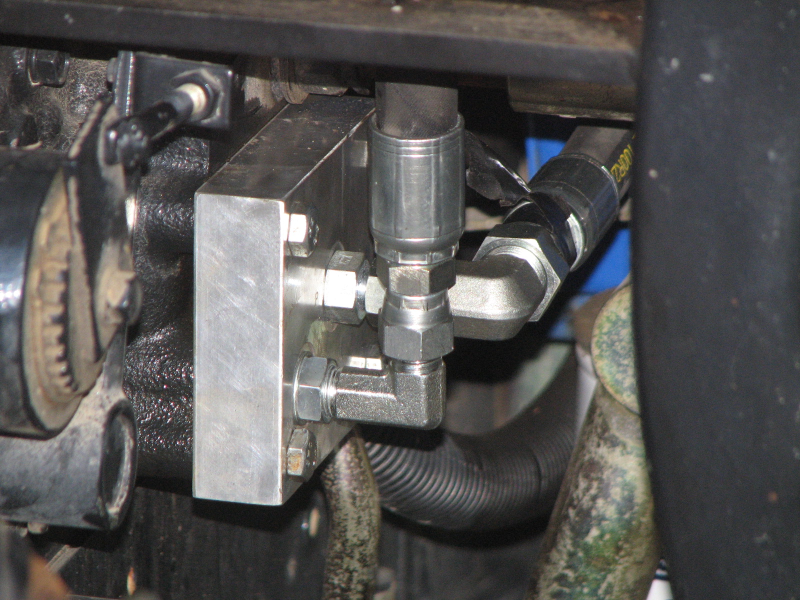

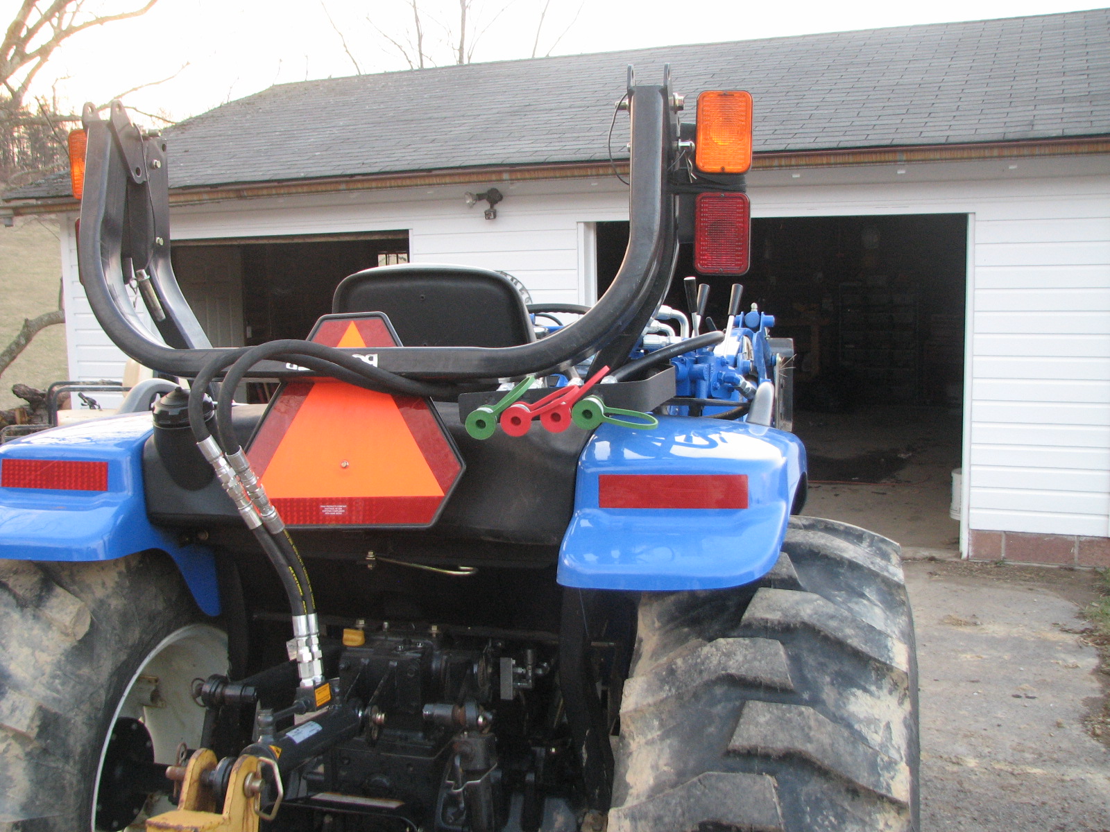

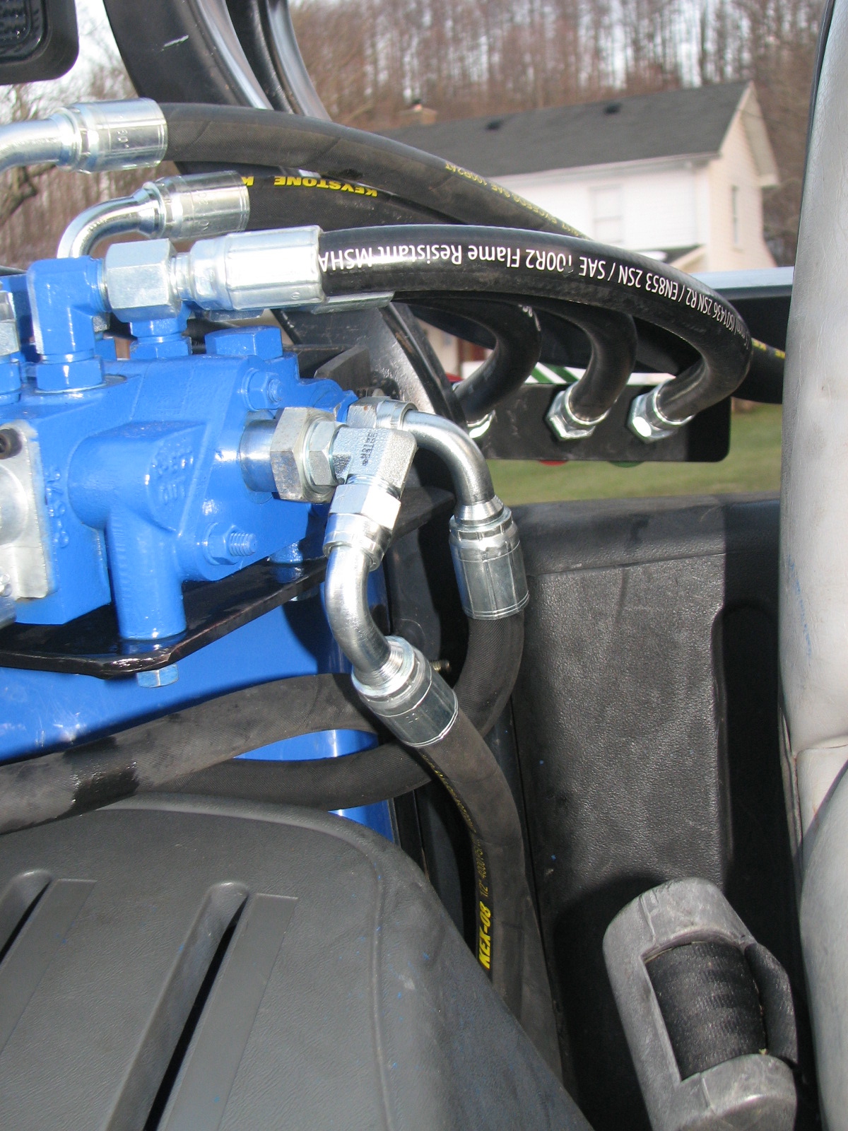

IMG_0301.JPGDecided to take off the return to tank line from the FEL and use a run tee to connect the new valve return line.

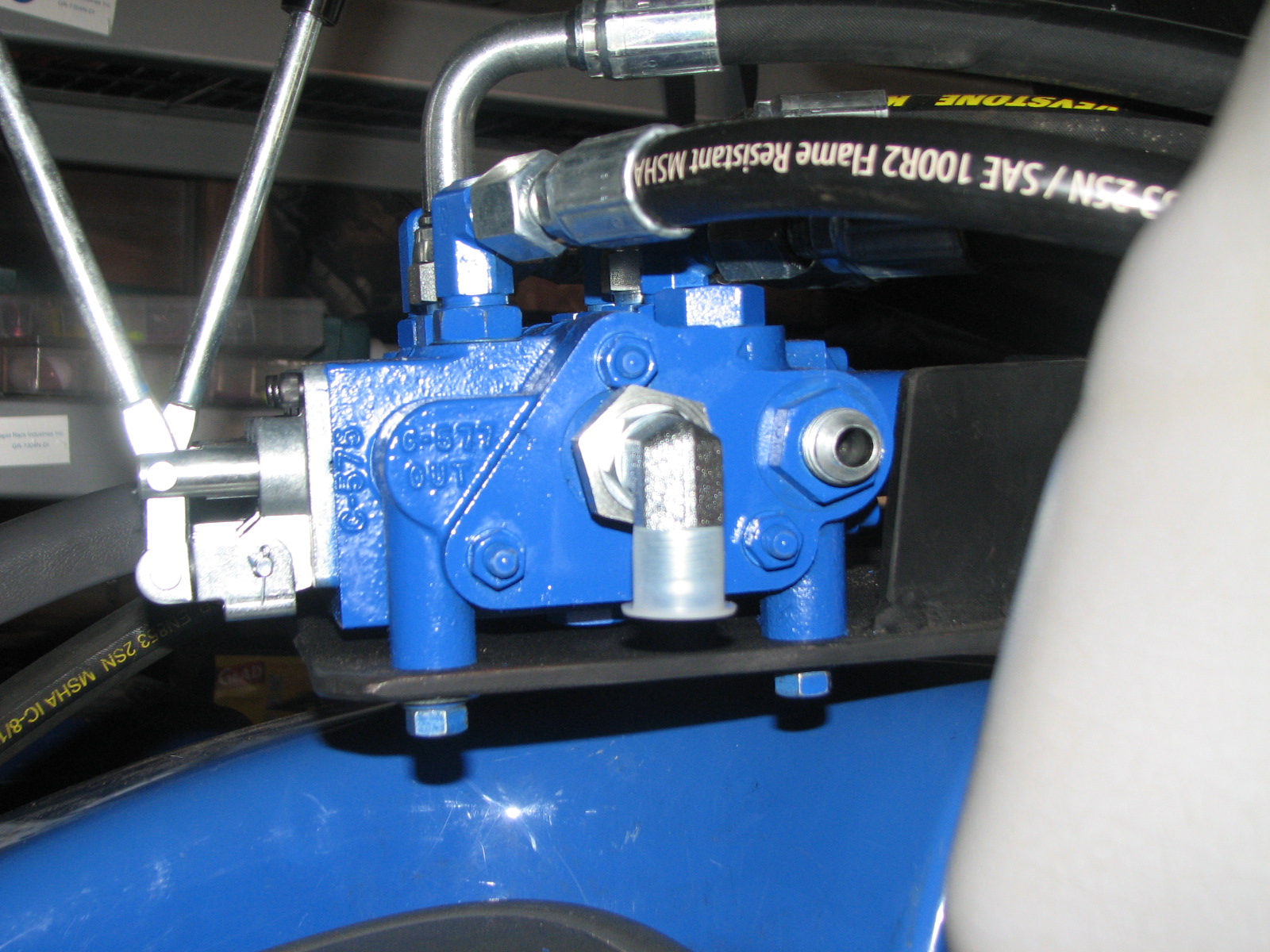

IMG_0305.JPG Installed the new block and hoses
IMG_0303.JPG Helper for Quality Control
IMG_0307.JPG New top link and QD's
Thanks for the help
My buddy and I can now start building the log splitter.
