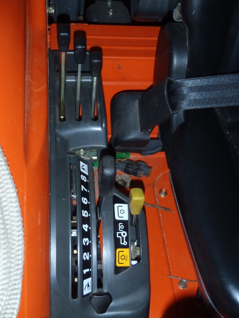

After trying a few places I finally got the teeny tiny hitch pins to complete the job and button it up:
Katz's, in Glastonbury, had them.
It's an old, family, hardware store that has an extensive fastener aisle.
Now I'm waiting patiently for Brian's TnT kit to arrive, but I think he said 4 to 6 weeks so it's going to be a while.

TnT kit from Fit Rite arrived, yesterday.
Everything looks good - outstanding packaging job.
I have never received anything by freight that was so well protected.
Would have made it through the Samsonite Gorilla test without a scratch.
Should get to installation on Saturday.

TnT installed with any problems.
Good directions and everything fit.
Used them with the rear fork attachment to move pallets of split fire wood.
What a difference!
