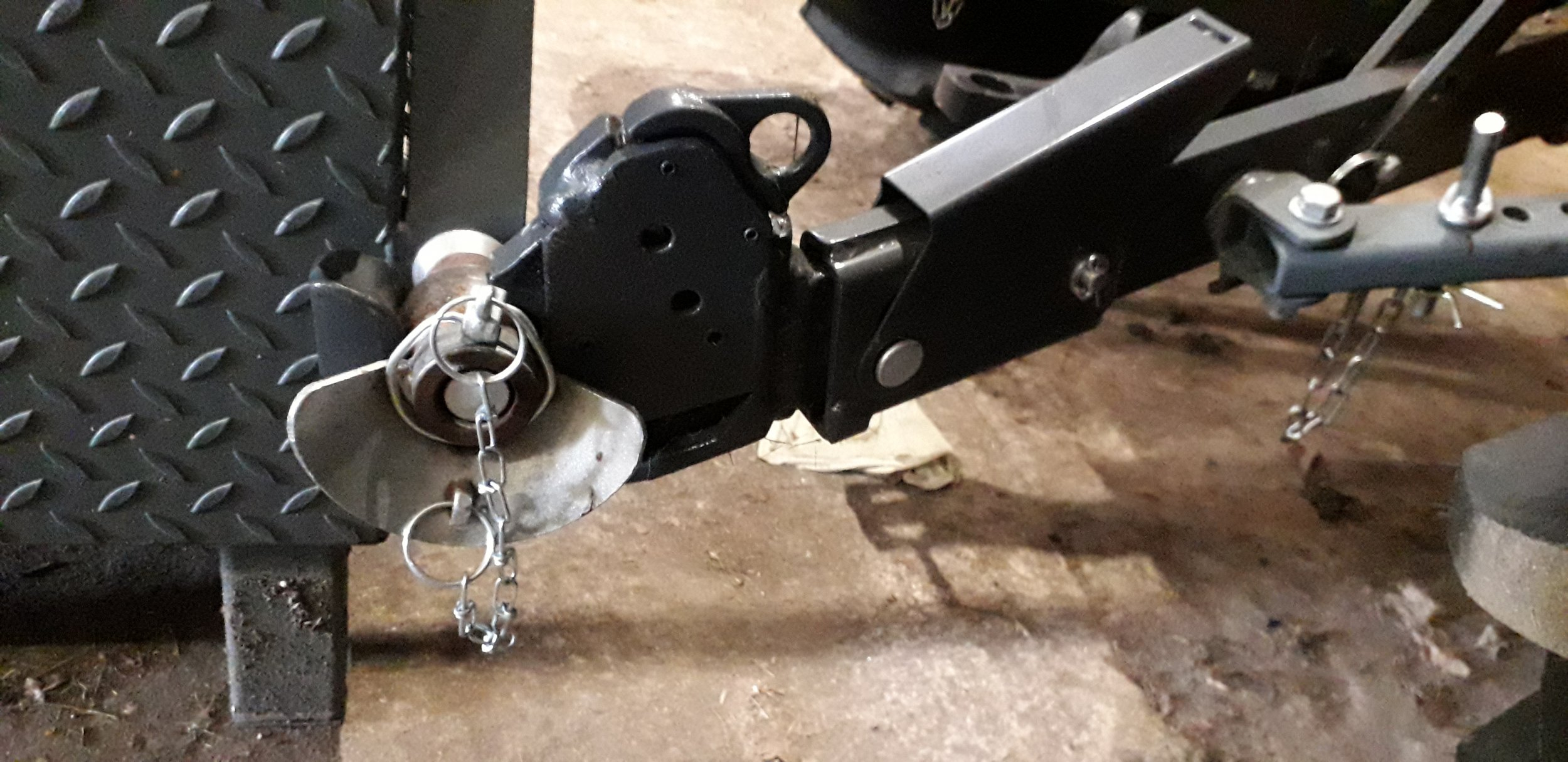

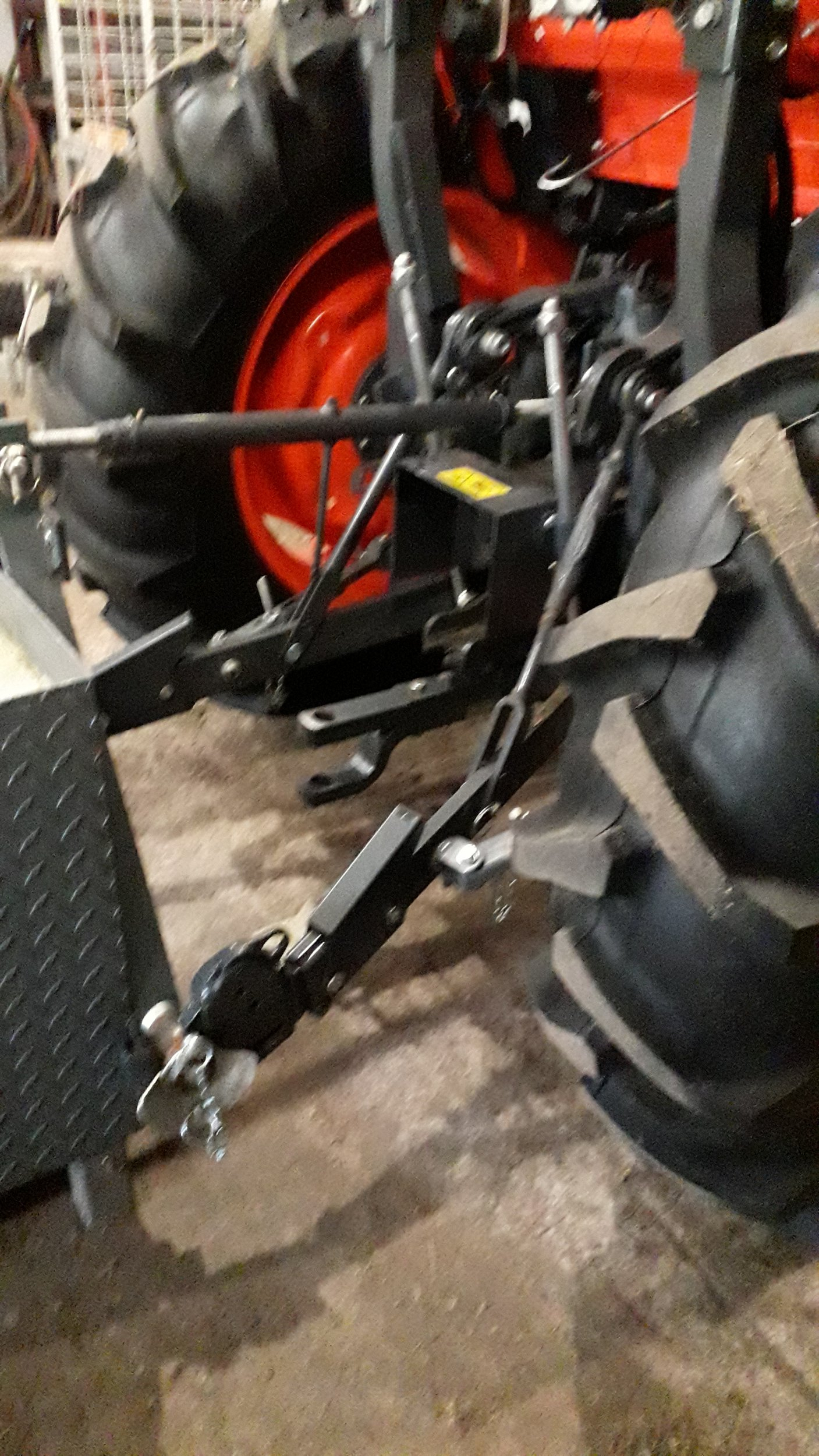

I just saw this thread, sorry for the late response. I added these euro style hooks and balls almost 2 years ago now. They are AMAZING!! I didn't go through Brian, but did speak with him about the project. In the end, I went with Agristoreusa. I did a video about it. Makes hooking and unhooking a breeze, and they are robust! I could not be happier with them. I wish every tractor came with them, would make life so much easier on so many people. But I don't think that will happen anytime soon in the US.

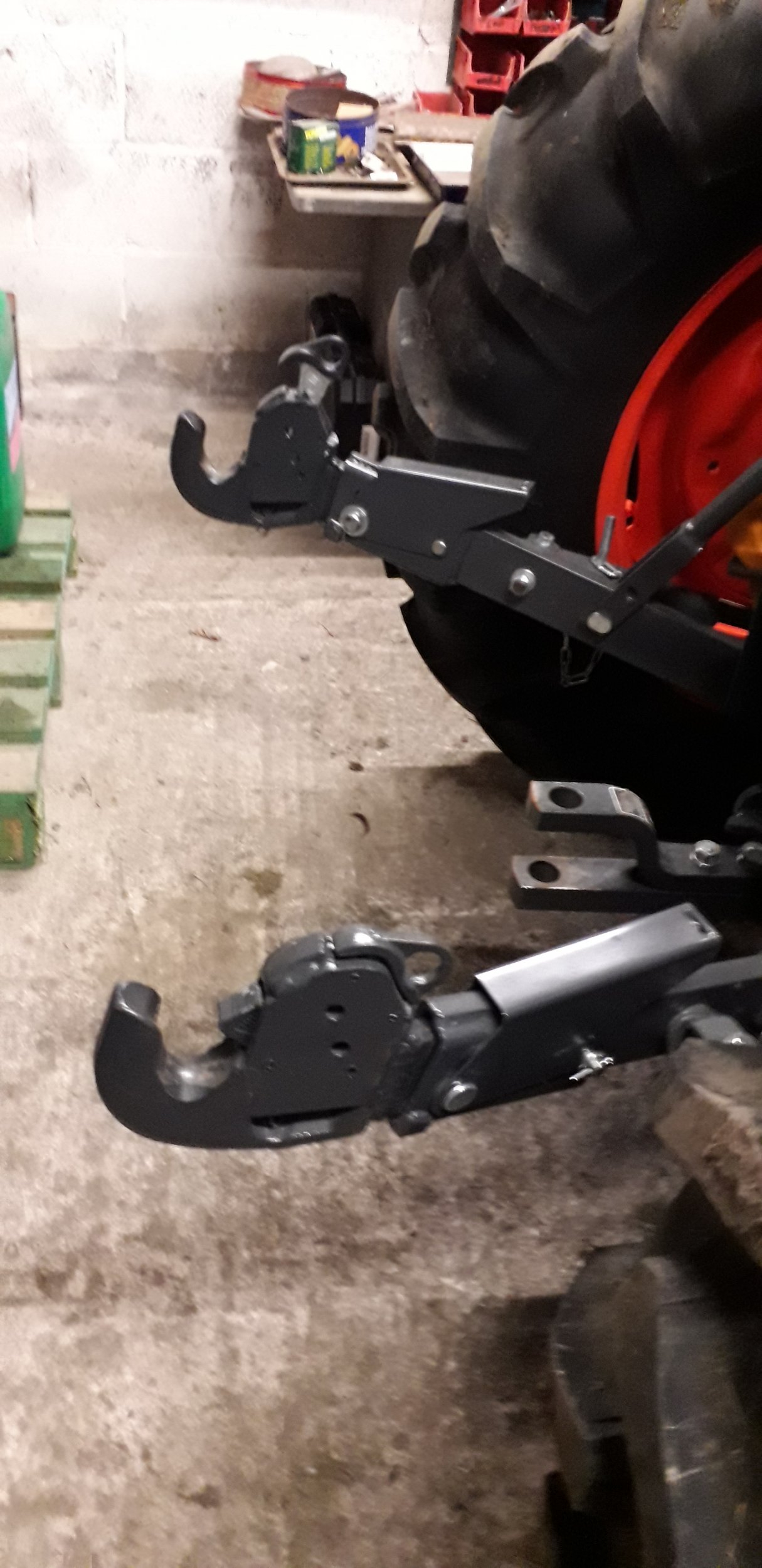

So you need some of these. For your tractor you could go with either the straight cat 1 hooks or the cat 1-2 hooks.
Then it is also nice to have a top link to go along with the lower hooks.
Like ptsg mentioned, you can do the fabrication, or ship the extendable ends to me for fabrication.

This is what the 3 most common sizes start out like.
Then you cut off the existing ball swivel on either the fixed draft arm or on an extendable end.
Does not matter, it works with both types of ends.
In other parts of the world these are available from the factories as either std or optional pieces.
This is not the case for North America.

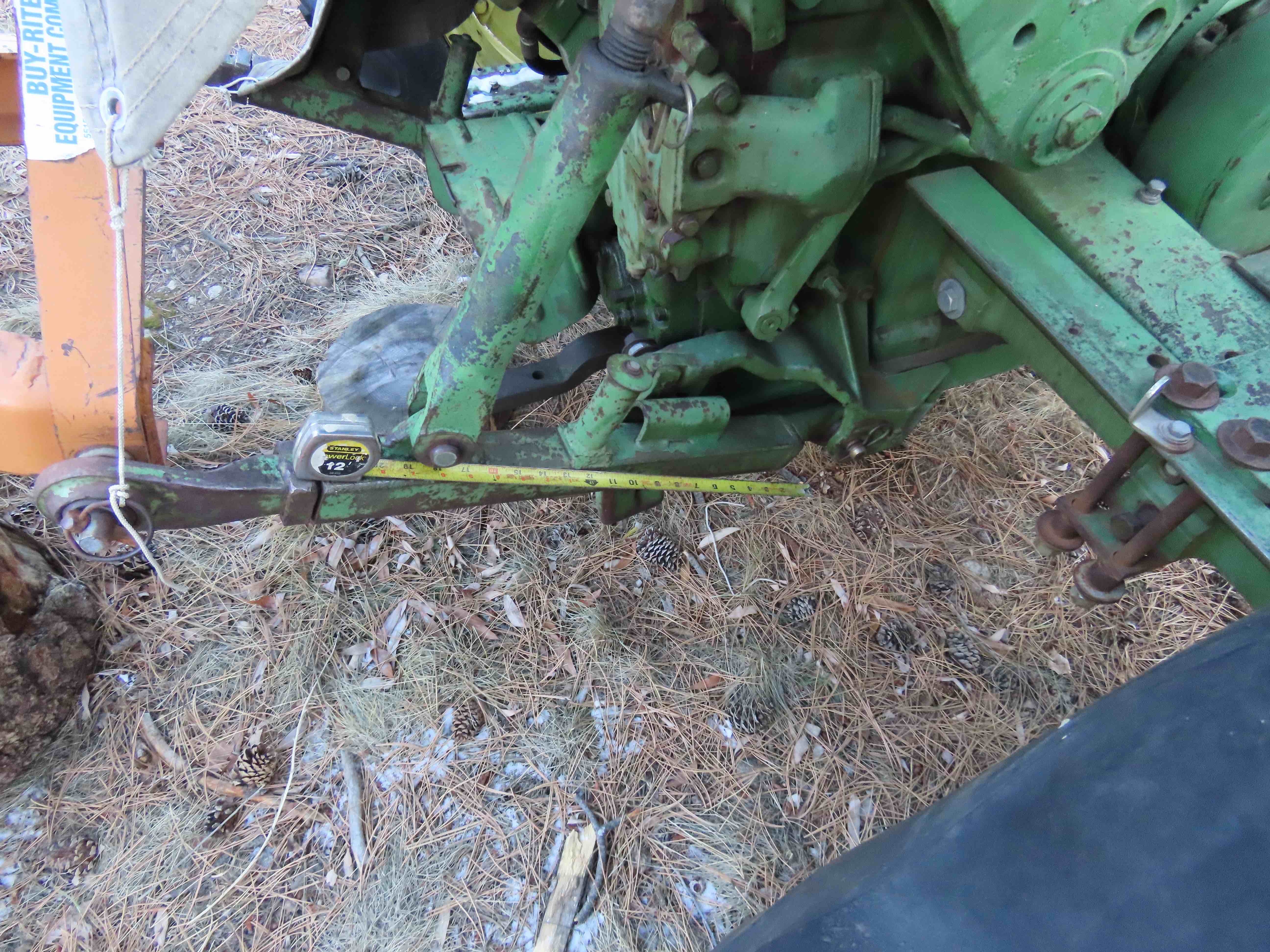

Has anyone besides rScotty ever seen lower arms that extend a foot ? The farthest I have ever seen is 3 1/2 inches
/ Adding euro three point hooks #60
Here's a photo on the JD lower draft link . I'm not going to take the implement off, but it is obvious how long the telescoping lower draft link is. The internal telescoping part is a solid 1.5" square bar that extends the length of that tube up to the weld down at the tip of the tape.
Usable length is closer to two feet than one, but it gets shakey after about 20" of extension.
