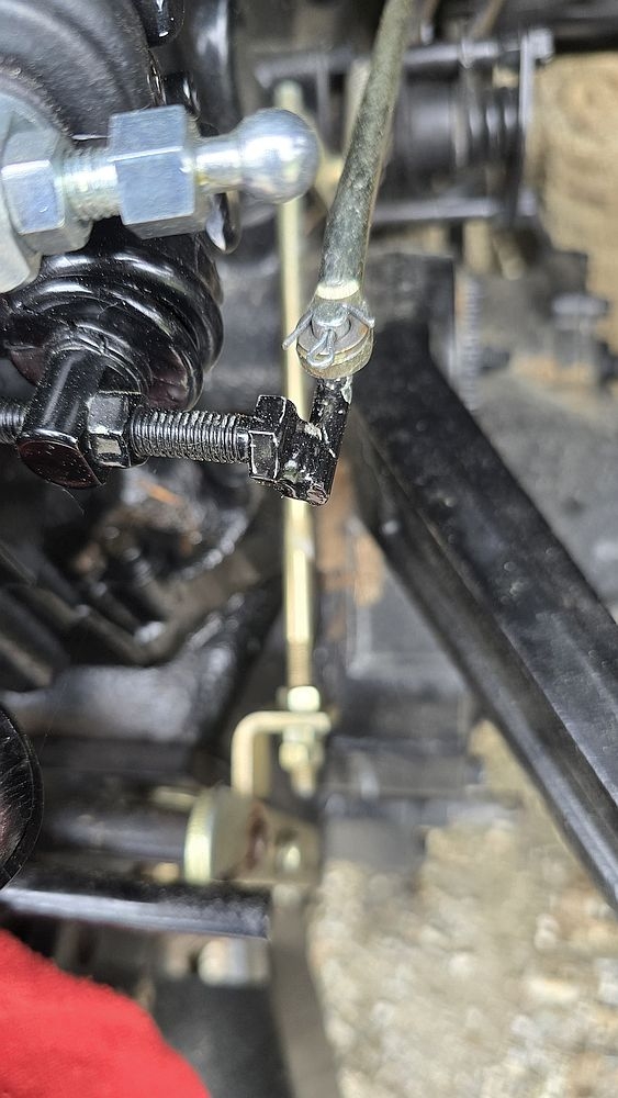

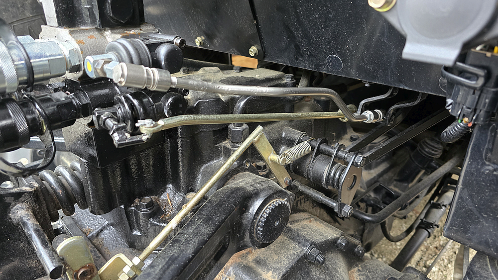

pics. Lower remote is hooked up. new remote lever just to the right
Here's the goober setup from the factory. Ball shank from new valve above.

You could get a link with a threaded stud and remove the existing ball, or use a through hole ball joint with bolt and nuts if you can't find a matching one.
That "factory" setup looks a bit janky to me!

Here's what I ordered, along with a 455mm rod. I can uncouple and attach the shank at the lever end to hook on the ball and do the same at the valve end, or just thread the stud into the valve. The link is actually going to be a bit long, so I can put a couple bends in it to clear the 1st lever travel and line up with the valve. Just like the original rod they sent that was 4" too short.
/ Parts source for rear remote links?
Success. The McMaster Balls were a little more egg-shaped, but they clipped on the Mahindra balls just fine. A little bending to line things up, and the very unenjoyable task of cutting threads on stainless steel to match length.
