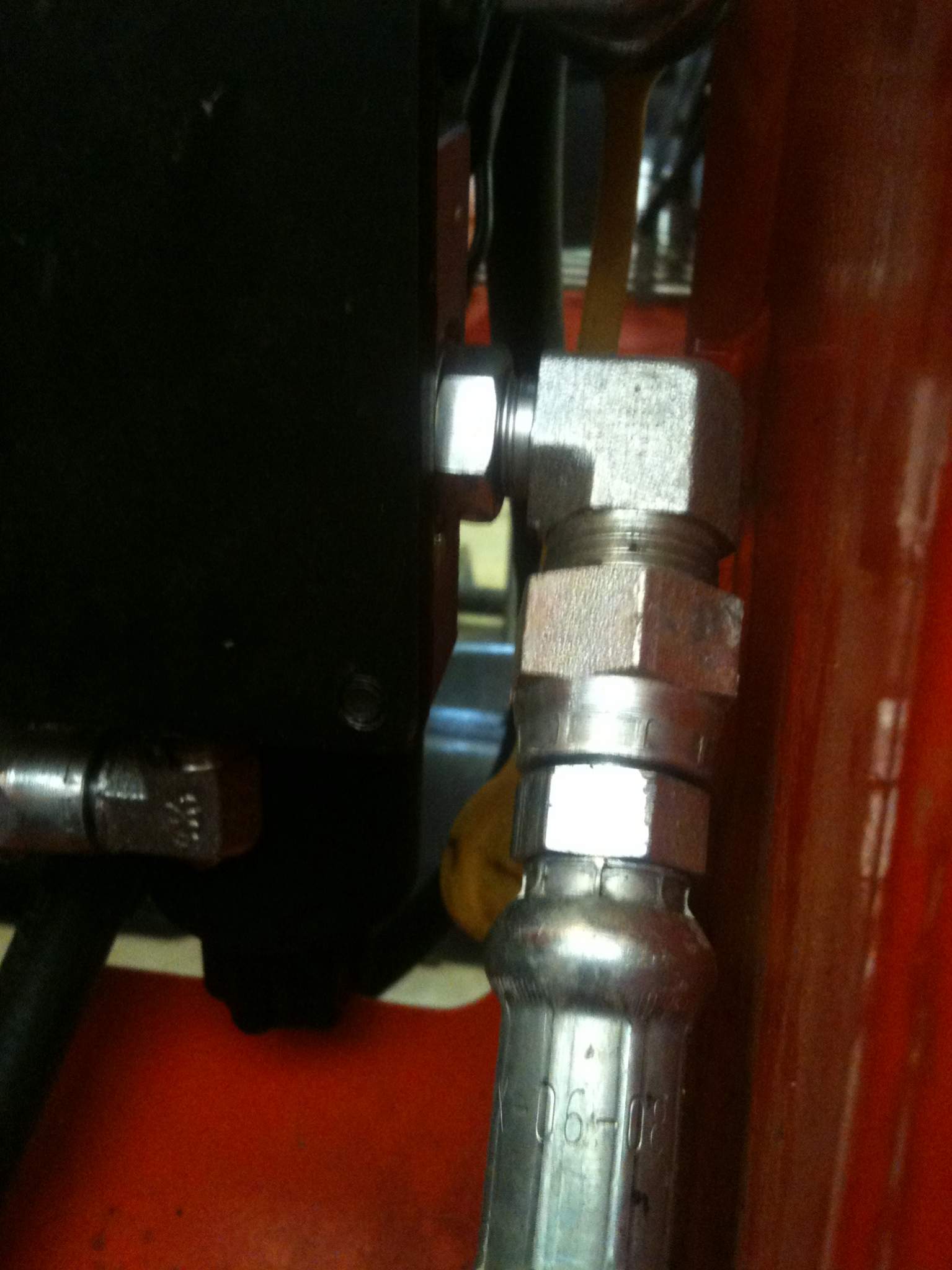

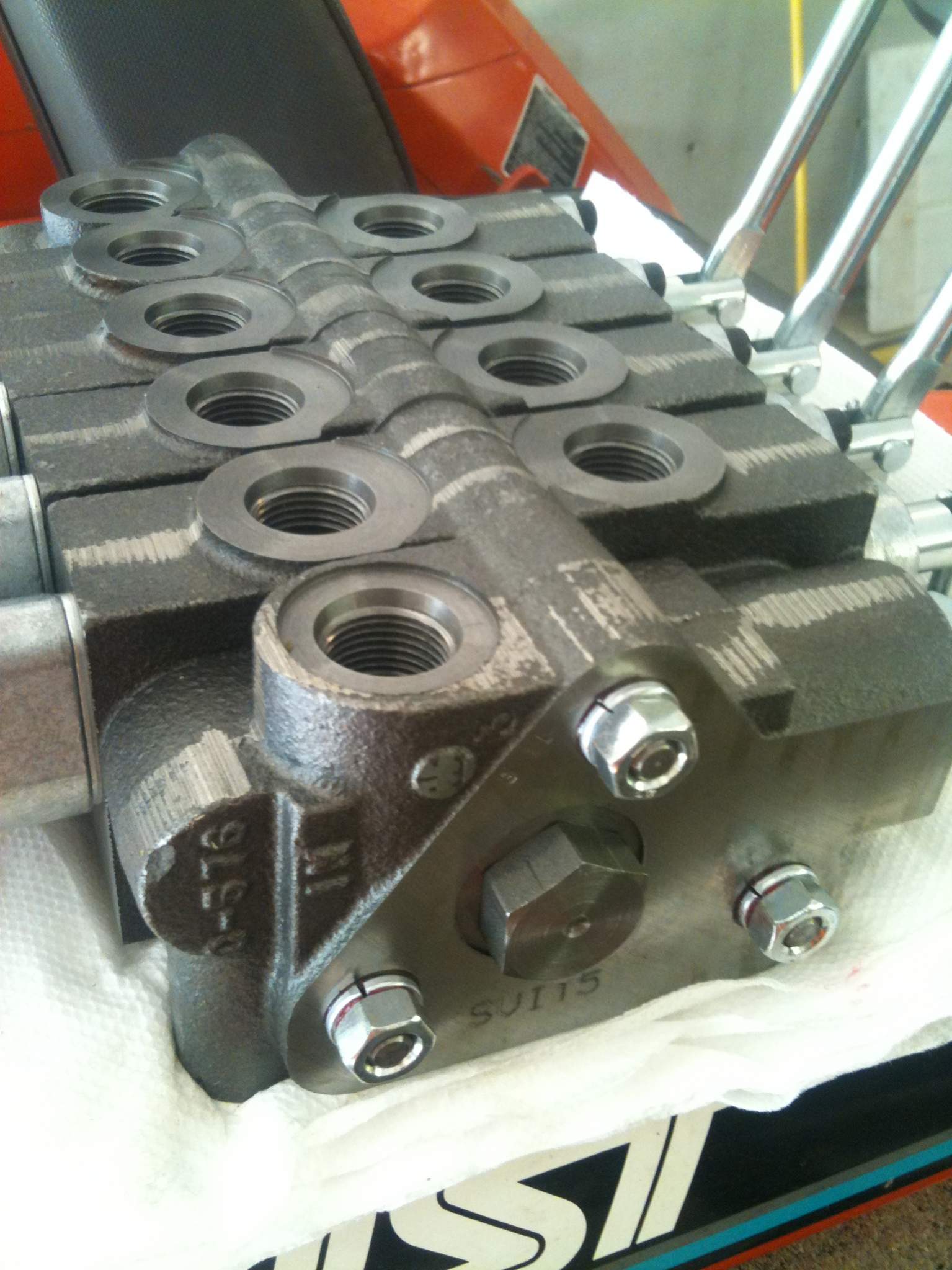

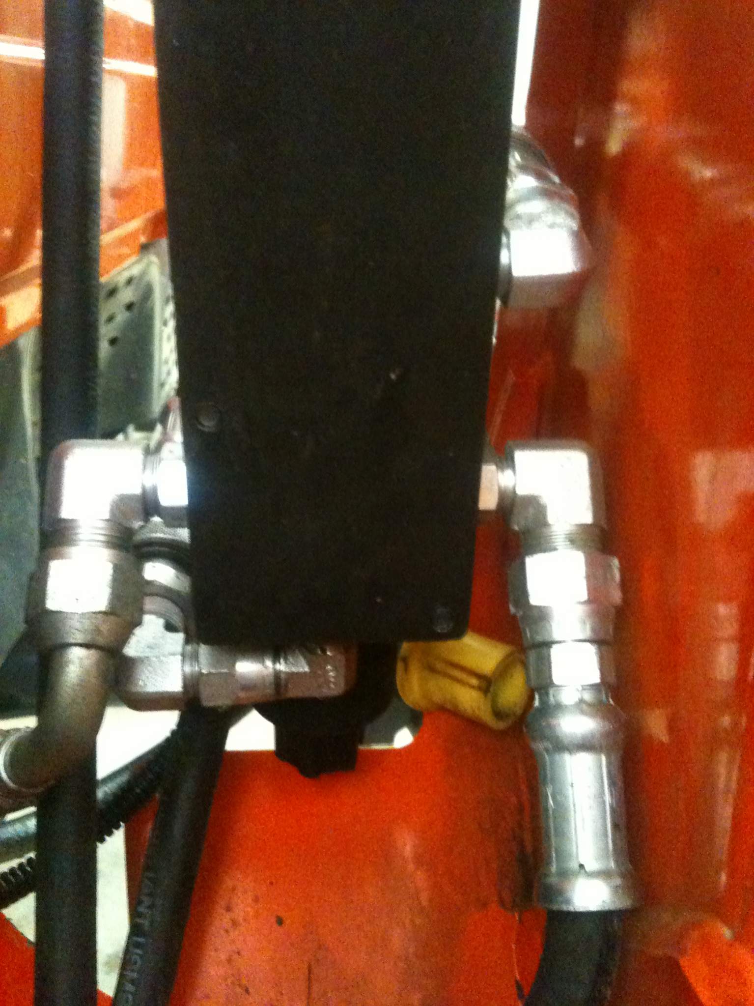

HOSE #1:
I measured out the lengths for the hose going from the power beyond of my 3rd function valve of my FEL to the "IN" of the new valve.
This hose will be coming from the right hose in the first pic (which is the backside of my WR LONG solenoid valve) to the "IN" port in the second pic.
EDIT: I added a better pic (3rd pic)
I'm not sure what to call these fittings when I order my new hose? I know the new valve "IN" port is an SAE 8 port, but is that what I specify to be on one end of the hose when I order it?
I'm not sure what type of fitting is on the other end though, the one that goes into my WR LONG solenoid valve? Can anyone tell what type of fitting it is just based on the first pic?

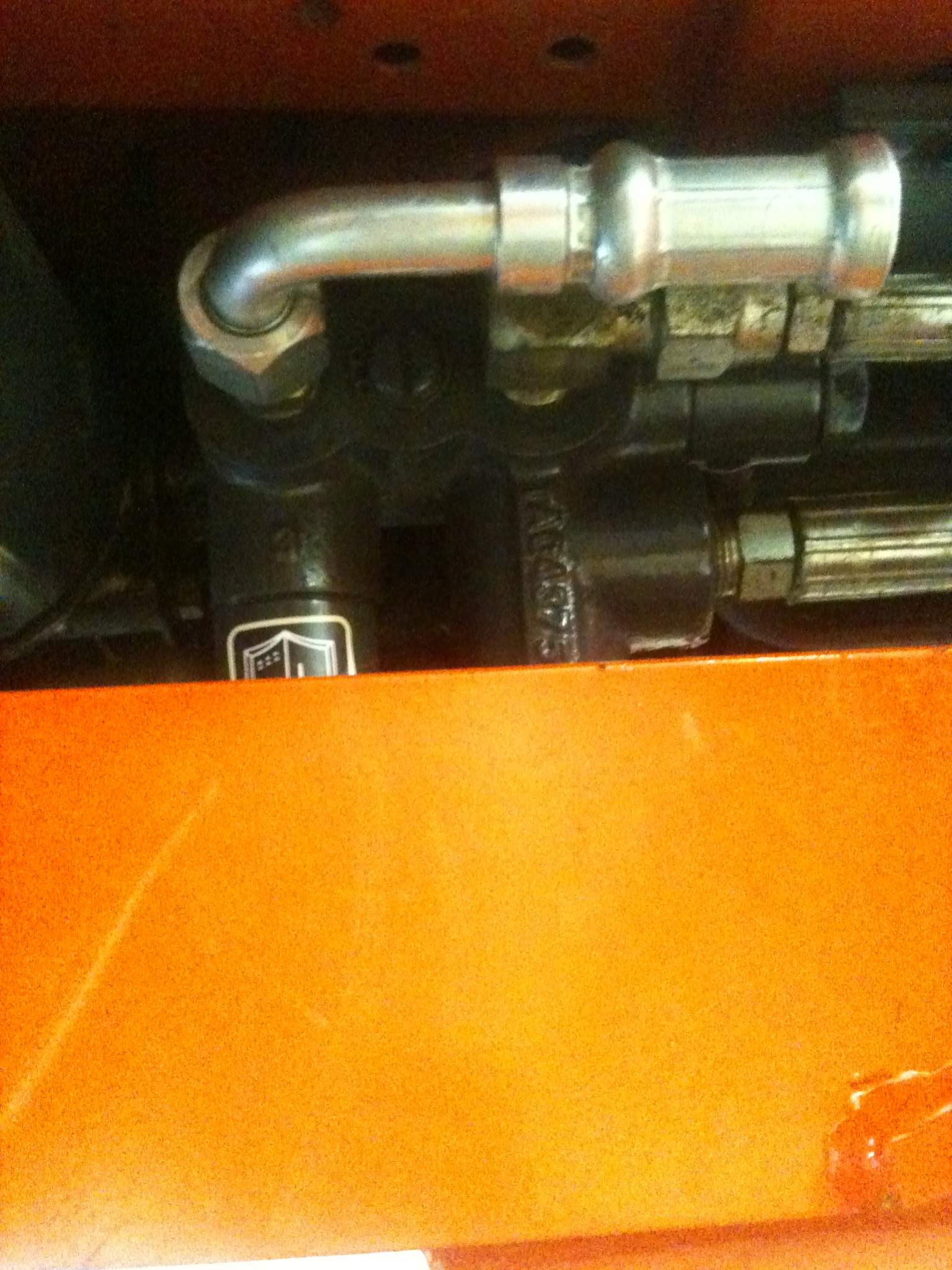

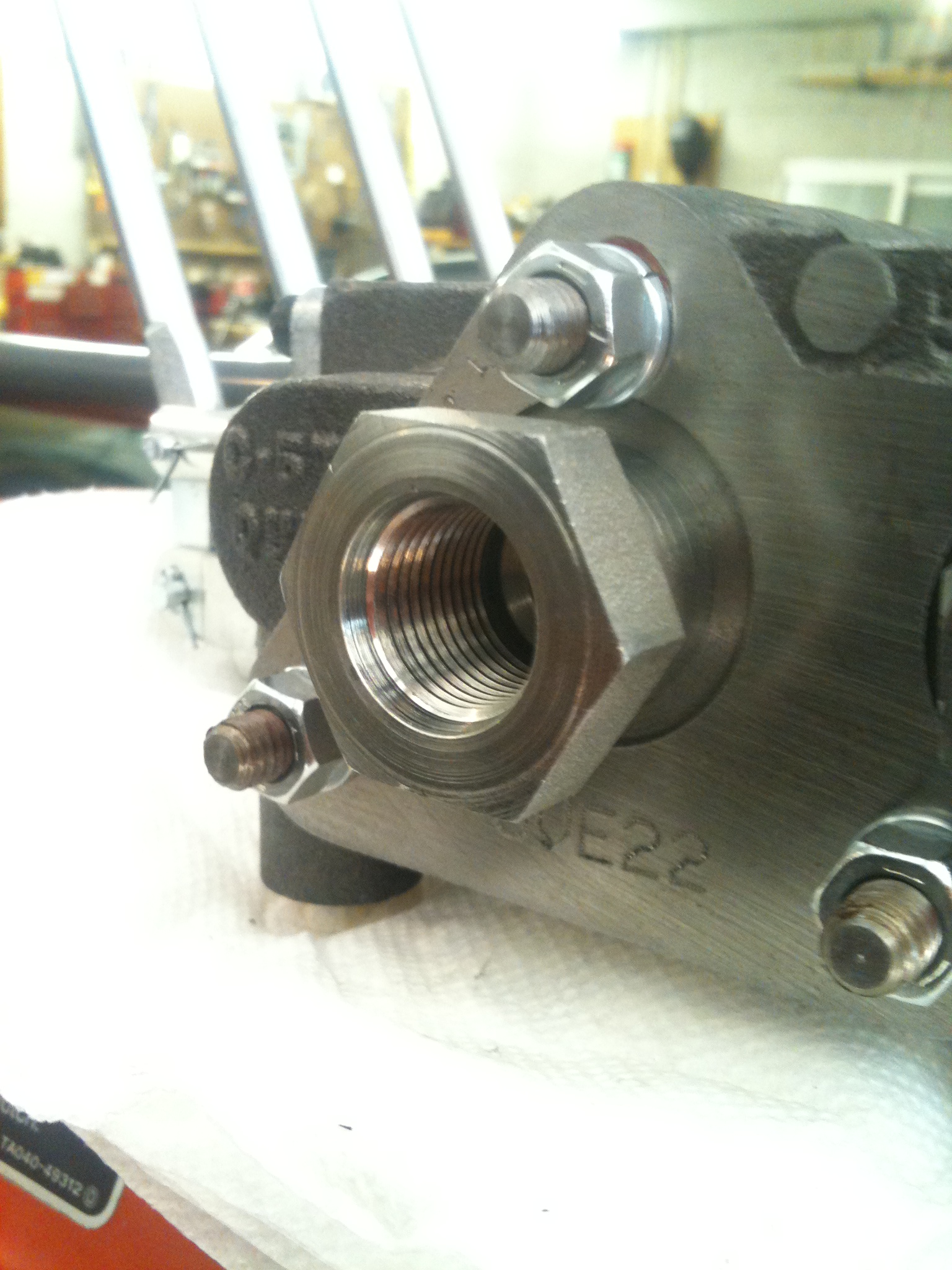

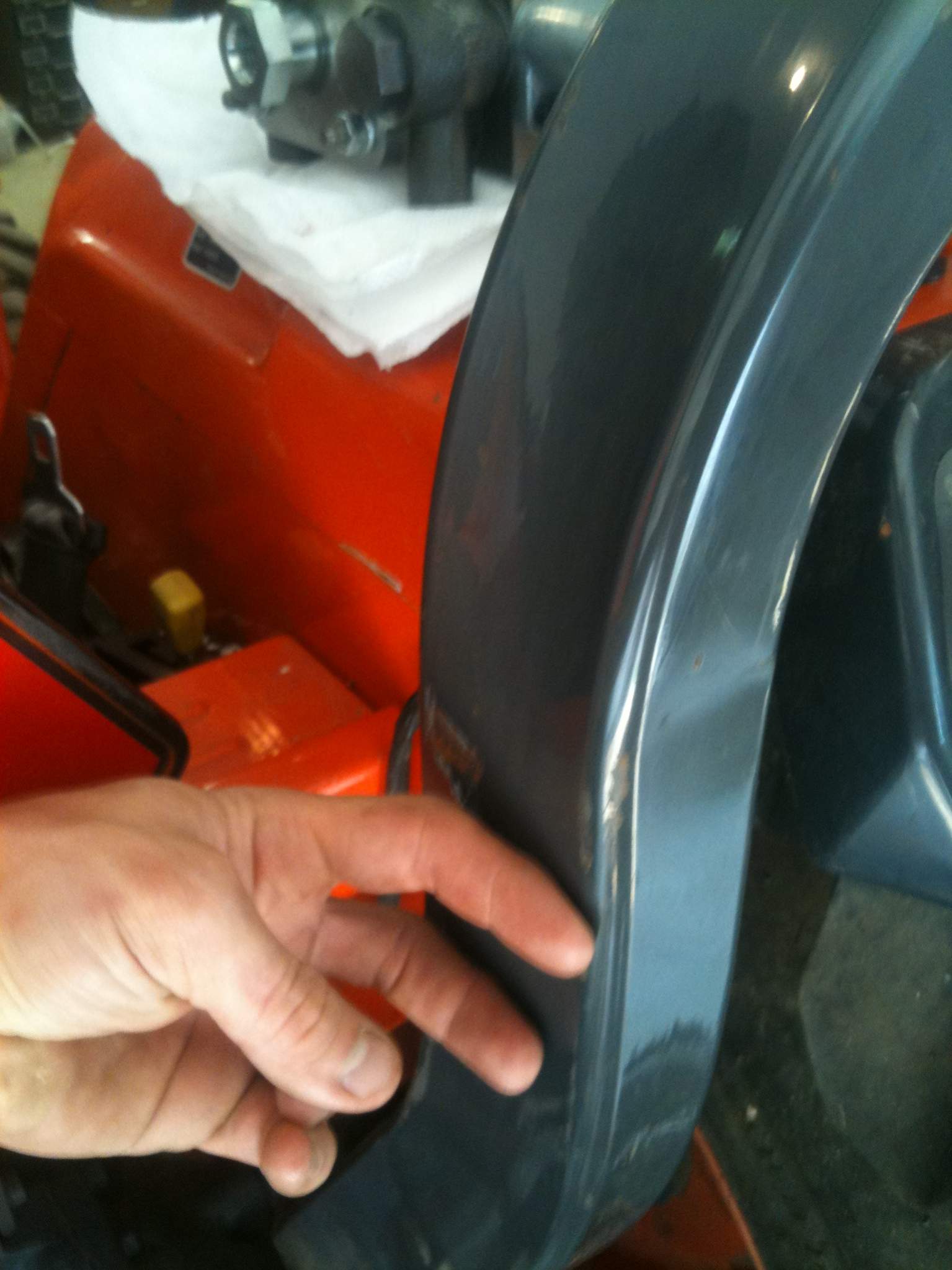

HOSE #2:
I measured this one out as well, and before I order it, I want to make sure I have the routing correct. Since this will be my PB circuit, I will come from the (1st pic) PB port (SAE 10 on this valve) to a QD fitting attached to my ROPS (my two fingers representing the mounting in the second pic). I will need a short piece of hose to complete the circuit when the log splitter is not attached. At least I understand that basic information. :D
Then I'll come from the PB QD fittings to the 3ph I believe??? This is where I'm not sure, I don't know which port to plumb this hose to in the third pic? I think it's the left port in the pic, which is where (currently) the PB from the FEL 3rd function valve is going to right now. (If my memory serves me correctly)
So I'm assuming I disconnect that hose, put it aside, and plumb my PB hose from my new valve, to that same port?

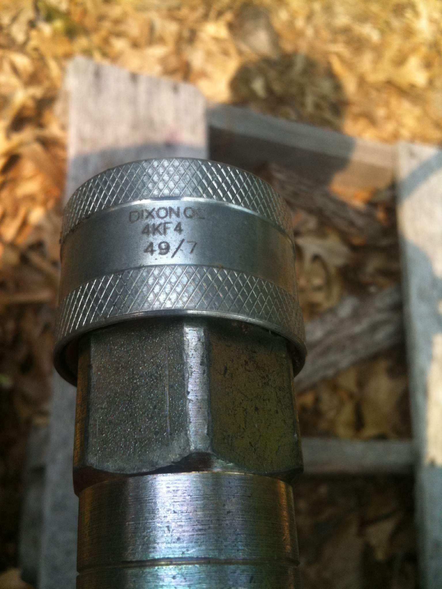

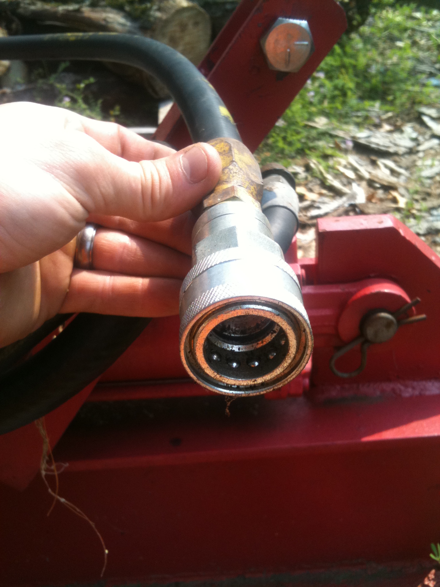

Question about the PB QD fittings....
Is there a 'standard' orientation for the fittings? For instance, I am going to mount the male QD in the PB house to be the 'supply' and I'll mount the female QD to be the 'return'
Is this standard? The reason I was going to do it this way, was because the supply hose for my log splitter has a female QD fitting, the return hose, doesn't have any fitting whatsoever, it's just an open hose that on the last tractor, we shoved into the reservoir. I want to add a fitting and do it right this time.
Regarding the QD fittings for the rear remotes, are all of the QD fittings supposed to be female QD?

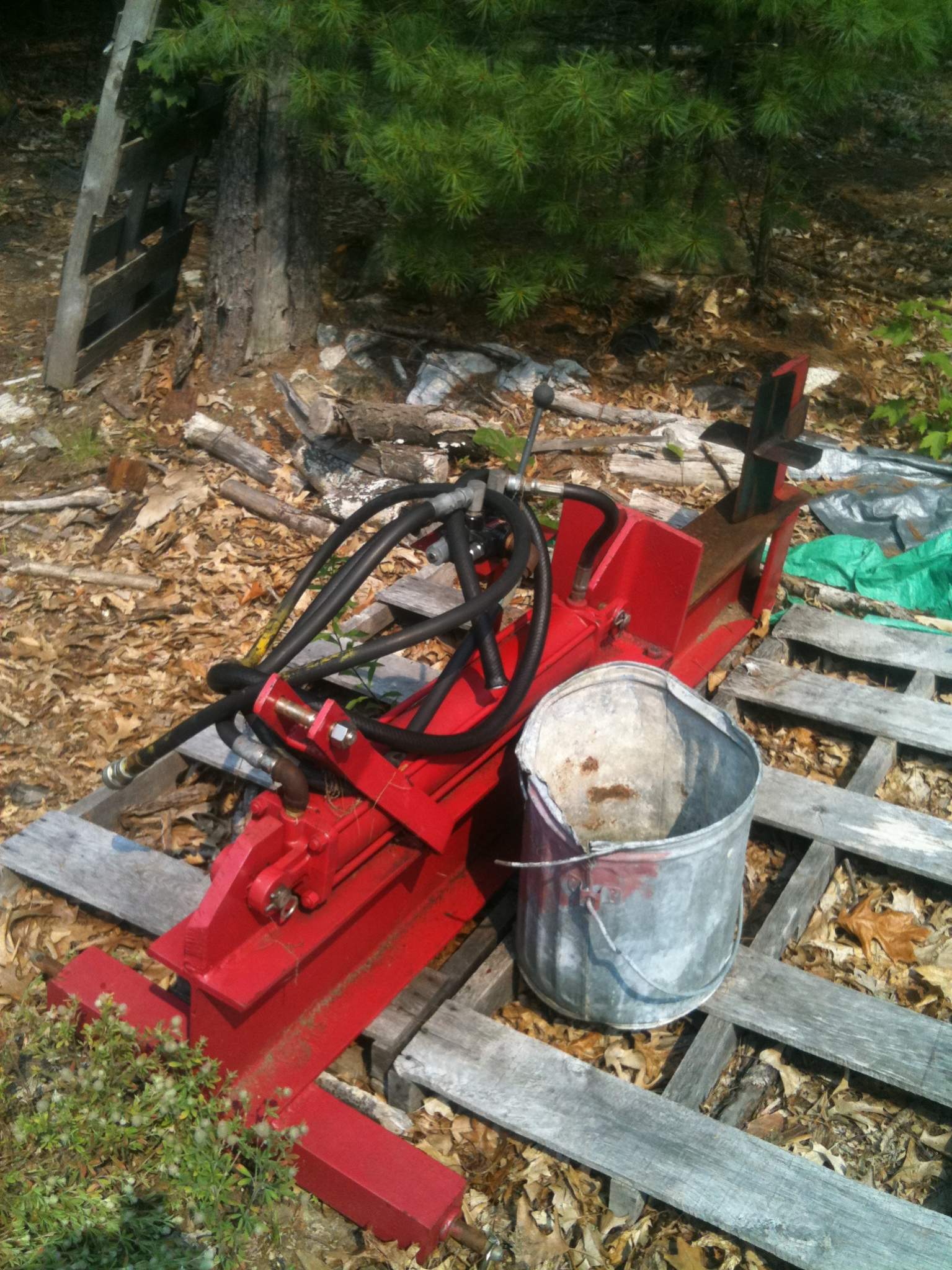

Here are a couple shots of the log splitter for reference. The hose is 1/2" Does that mean I need 1/2" QD fittings?

The system on the tractor is an open center system, and fluid needs to flow through all valves and back to tank unimpeded. Since that valve has a PB outlet, it is never a good idea to install a QD off of it. If you unplug a hose by mistake, something will burst. If it is not connected properly, same thing.

What you do after connecting the log splitter, and starting the engine, is then bungee one of the levers in a position to pass fluid to the IN port of the log splitter valve, which has it's own detent in the reverse position. You might be able to find a detent kit to hold the spool in say, fwd or rev. The OUT port of the log splitter valve comes back to the other work port. Make sure you know which work port on the detent valve will pass the pump fluid to the log splitter valve.
Use 1/2 in QD's, and mark them as pressure and return. Your QD's may be able to connect under pressure, check out the specs.
If you are using the 4 spool for the supply for the log splitter, you will not need the jumper hose. All the work ports on the 4 spool valve have no fluid going through them until you activate the levers.
The fluid goes in the IN port and exits the PB port to the next valve. The 4 levers determine which work ports have fluid. The OUT port will go to tank.
Your path should be something like this, Pump, FEL, new 4 spool valve, to 3pt.
Do not connect the log splitter to the PB port. The supply for your log splitter valve will come from the work port on one of the spools.

All ports SAE #8 (3/4-16 O-ring thread). except OUT port, SAE #10

It would only be common sense to set up the hyd path as I suggested. If the valves are set up correctly, there is no reason to install a QD in the PB line . It is not smart to do so. Once the flow path is set, as from pump to FEL, with a diverter in the FEL circuit, the PB out would connect to the new valve, and the PB out from the new valve would connect to the 3pt. Then install 8 QD on the back of the valve for the attachments, and not be concerned with the PB. The outlet of the new valve will provide the log splitter with the flow, and the whole setup will be neat and tidy. If it were mine, I would order the 3 pos detent, just for the log splitter. Your new valve will have relief on it, and should be set equal to or below the FEL PRV settings.
It is also not smart to be unplugging the 4 spool valve in and out of the hyd circuit using QD's.
The factory would never set up the remotes the way Kennyd suggested.
It is your machine and your parts, so use any advice you like.
