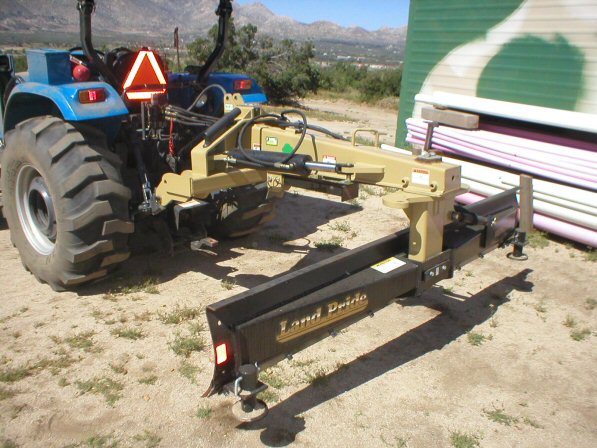

Don't laugh, on my bigger tractor, I'm going to add 2 more, so I will have 5 at the rear.:thumbsup: I'm only going to add a diverter valve on my smaller tractor, so it will only have 4.
What do I need them for? 2 for "TnT", 1 for angle on rear blade or landscape rake, 1 to offset the boom on rear blade or landscape rake. I could use the 5Th one to tilt the rear blade a lot, but I have found that tilting the rear blade with the tilt cylinder of the "TnT" is more than adequate. :thumbsup: You can see in the pictures that I had to not use the offset hydraulic. ( it sets in with my tools) At present I only use a hydraulic for angling the blade and have to manually set the boom when it needs to be offset. :ashamed: :(
