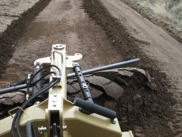

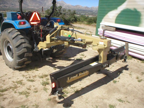

TEG....What is the needle valve used for? Do I need one of those?...
You use a needle valve to slow down the hydraulics... You can slow it down to a crawl... for accuracy and so it doesn't jerk the box blade around too fast. (got the idea from Kennyd) You don't have to have it, if you can feather speed with the valve, you'll be fine. I got the valves so it would be safer for my wife.

The needle valve sounds useful, is that something I could add inline down the road if I decided I wanted it?
The diverter vs. solenoid thing sounds like a purely personal choice. From what I've read on here (a LOT) some people prefer the rear hydraulics running forward and using the valve, some prefer the diverter, and some prefer the solenoid. My personal preference based on my own thoughts is that I would prefer the solenoid...but it's not an absolute must.
I operated a smaller tractor with grapple a couple months ago (granted for only 1 hour) and was moving logs around with it, it had the rear valve operating the grapple. I didn't like that setup even though I know I would have eventually gotten used to it.
