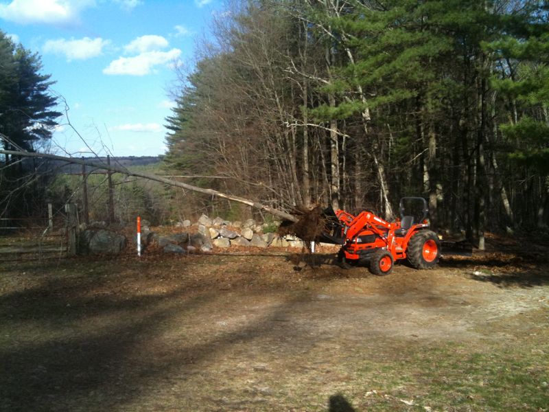

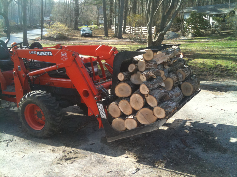

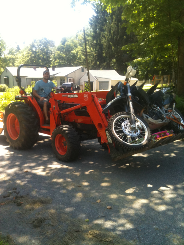

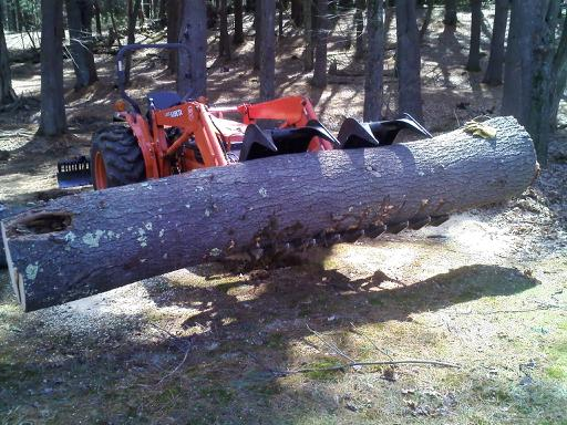

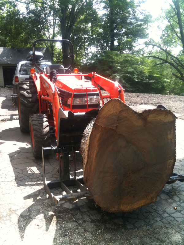

I guess it's time for an update, better late than never right? :laughing:
I ended up getting the WR Long grapple and 3rd function valve within about 2-3 weeks of ordering it. At the same time I picked up the grapple I also had my rear tires filled with Rimguard. It pays to shop around, I got prices from a few different dealerships and I got quotes around $7 a gallon, and then found Ahern Equipment in Spencer MA was only $4 a gallon :thumbsup:
The grapple itself has literally changed my life hahah. I can't say enough about how useful it has been for me. I'm not gonna go on and on about how much I like it but if anyone has any specific questions then feel free to ask.
I apologize for not taking pics of the installation of the 3rd function valve. It actually was remarkably simple and I think because of that, I really didn't think of stopping along the way and documenting what I did. I followed the included directions and if I remember correctly, it took me 2 hrs to install, that included welding the bracket to the cross bar of my FEL for the QD mount.
Overall I am extremely satisfied with the grapple, I can't say anything bad about it. I very rarely have my bucket on my FEL now.

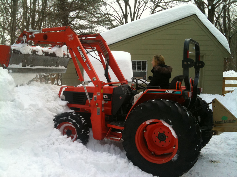

I will post a few pics of the grapple and me getting some use out of it. I also posted quite a few pics at this link: http://www.tractorbynet.com/forums/attachments/211635-grappling-fun-picture-thread.html
Feel free to add your own there as well!
I will have some more questions in the near future regarding the rest of this project, mostly some hydraulic hose questions and fittings questions.
Thanks again to everyone who has helped me along the way. I'll try to be better at documenting the valve addition for the top n tilt! :D

Here's a few pics...

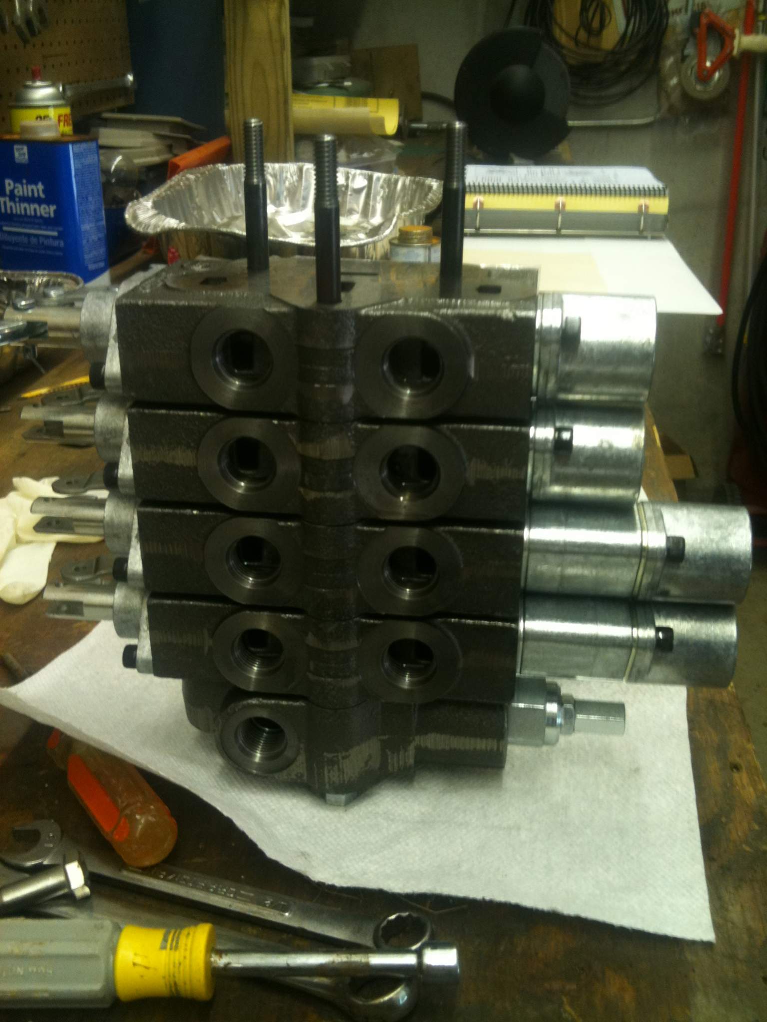

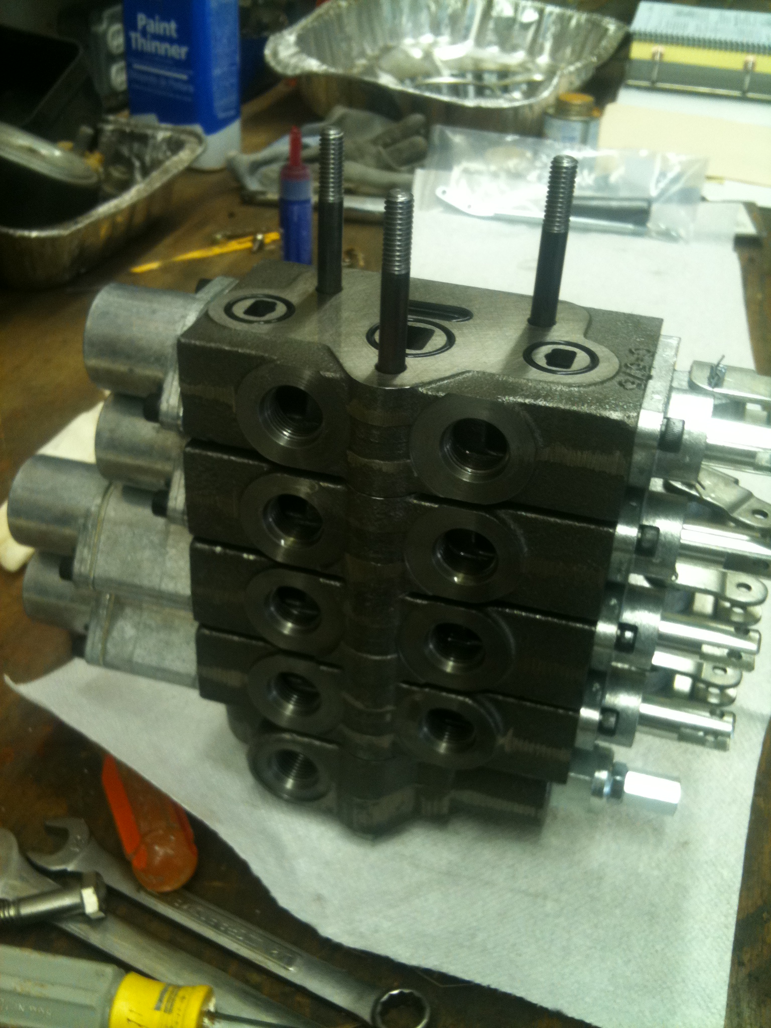

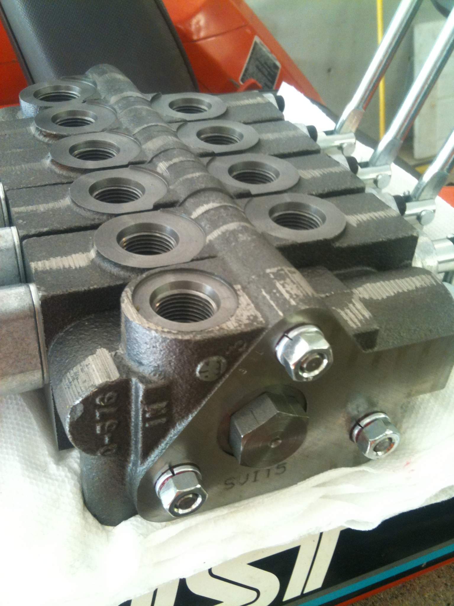

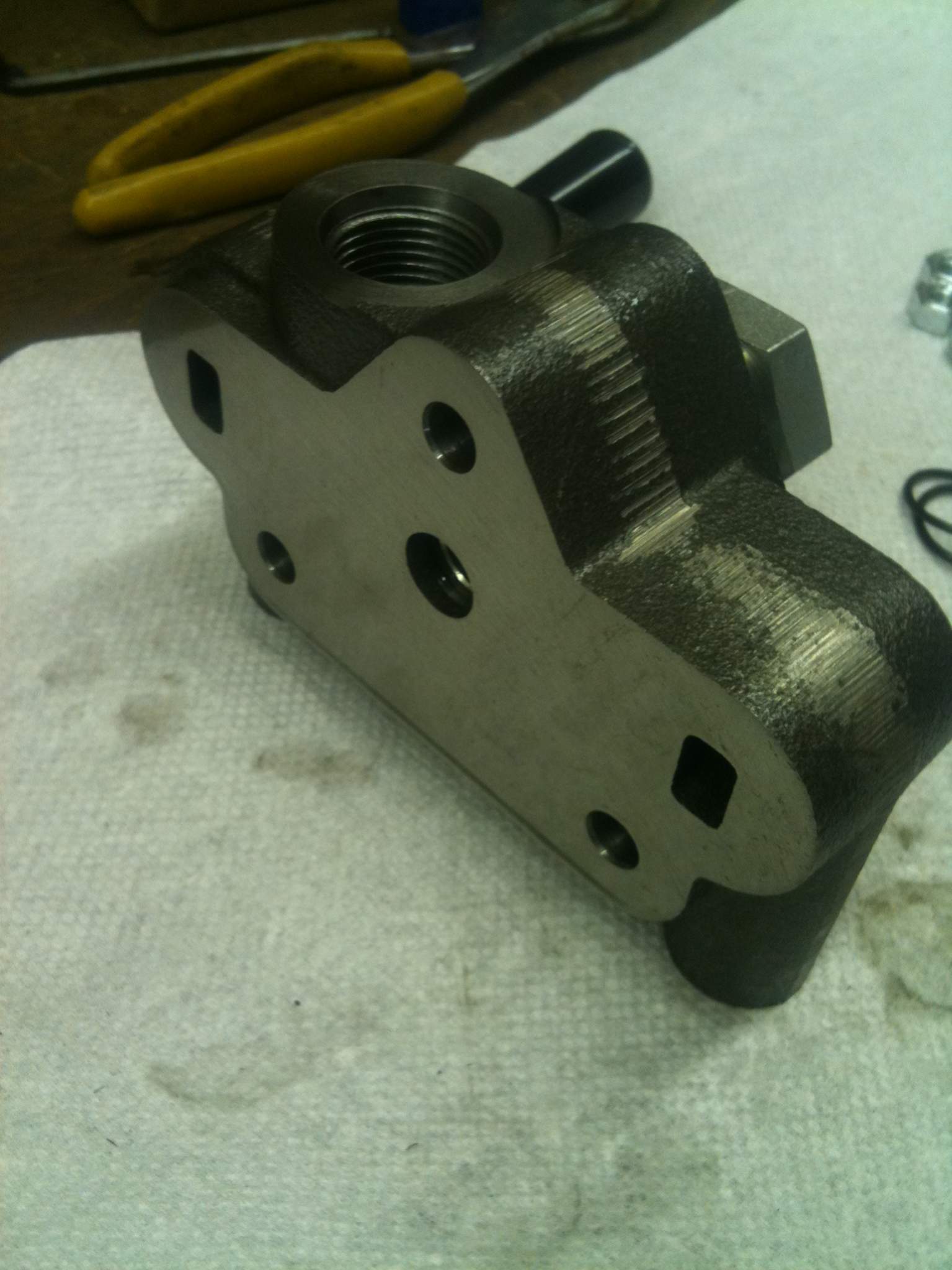

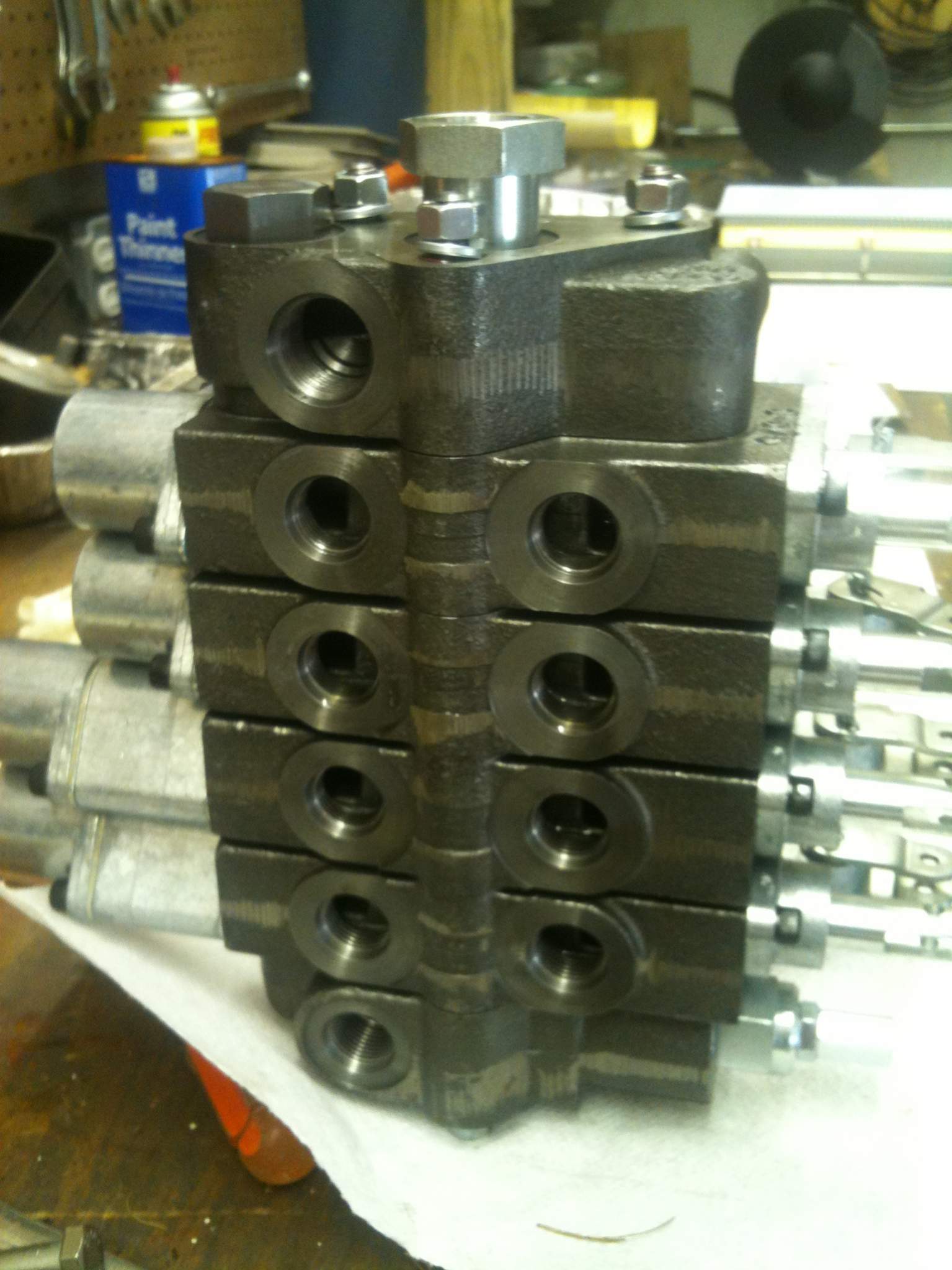

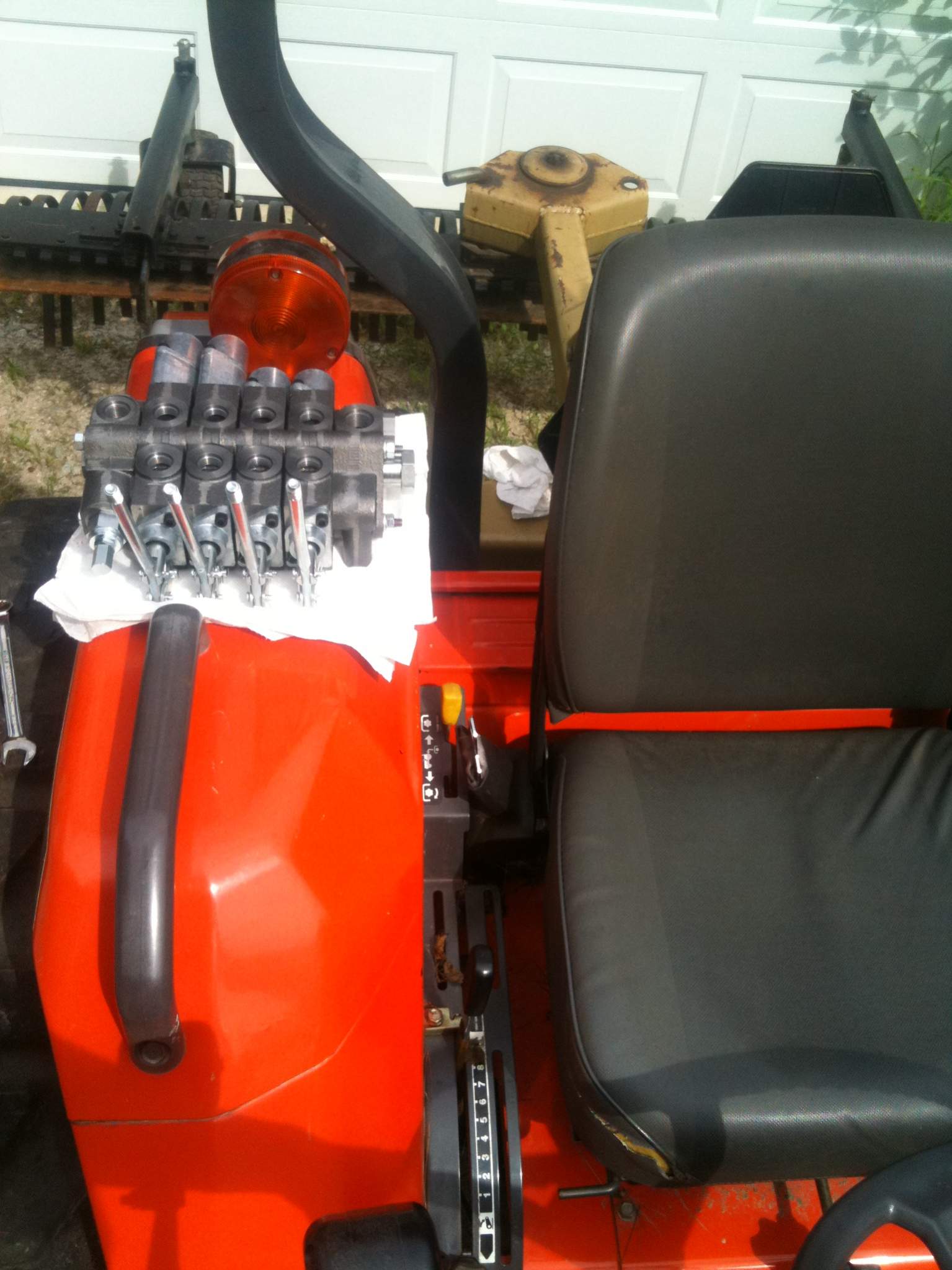

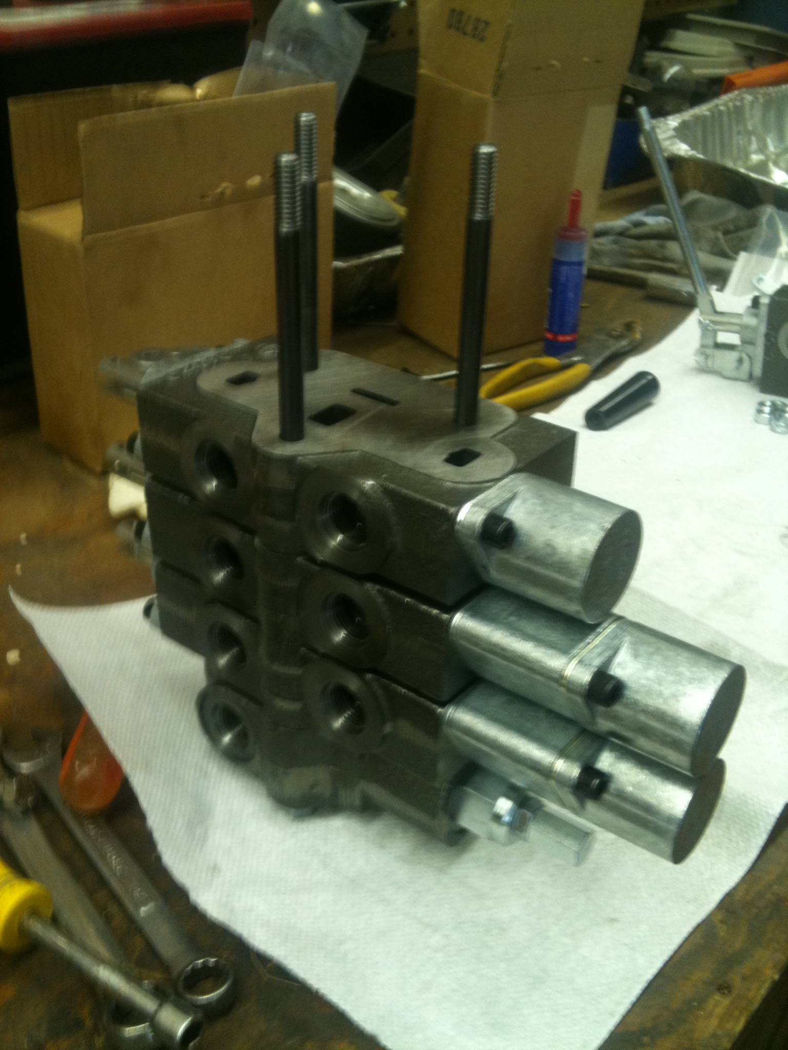

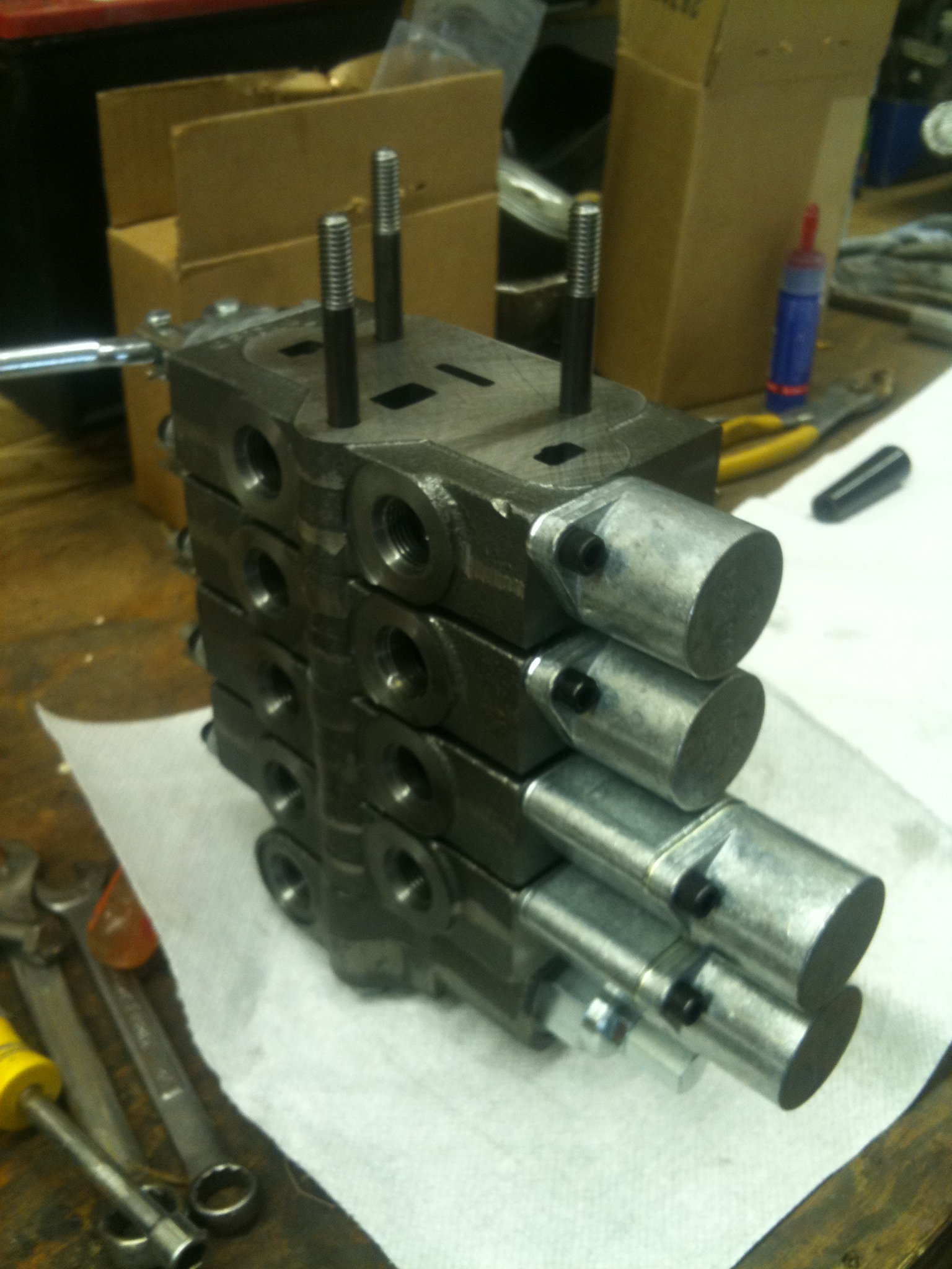

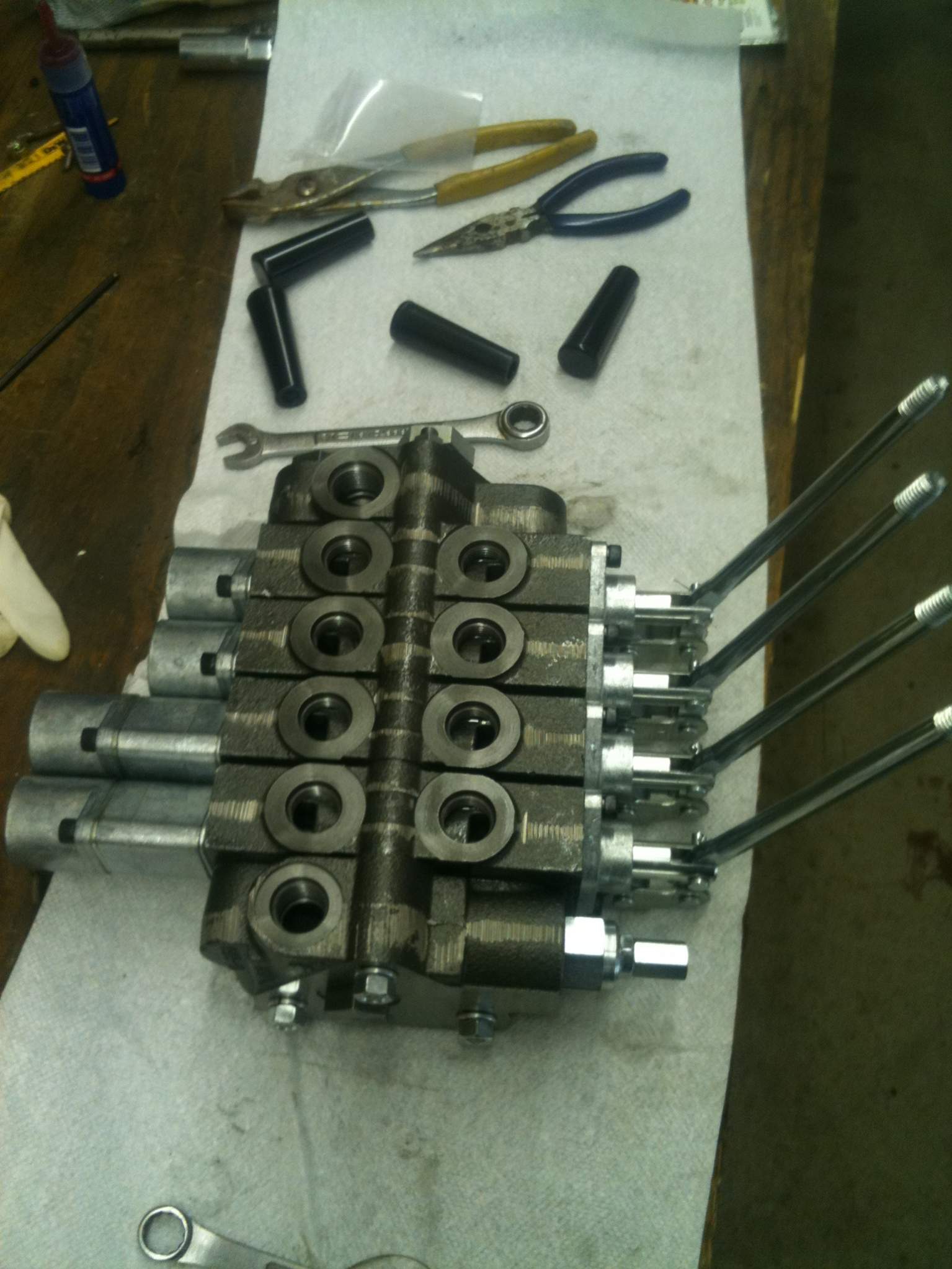

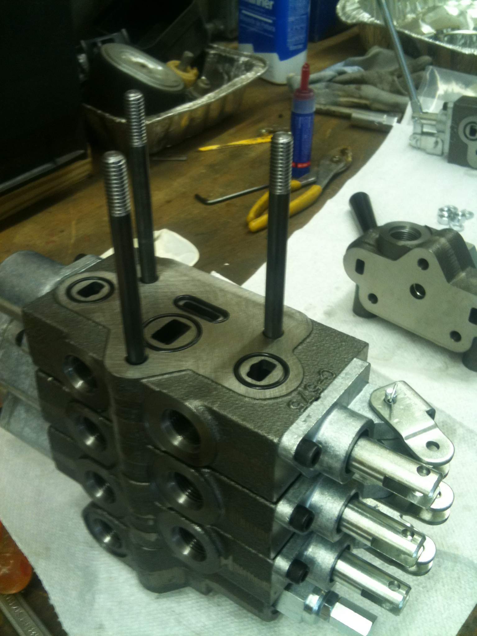

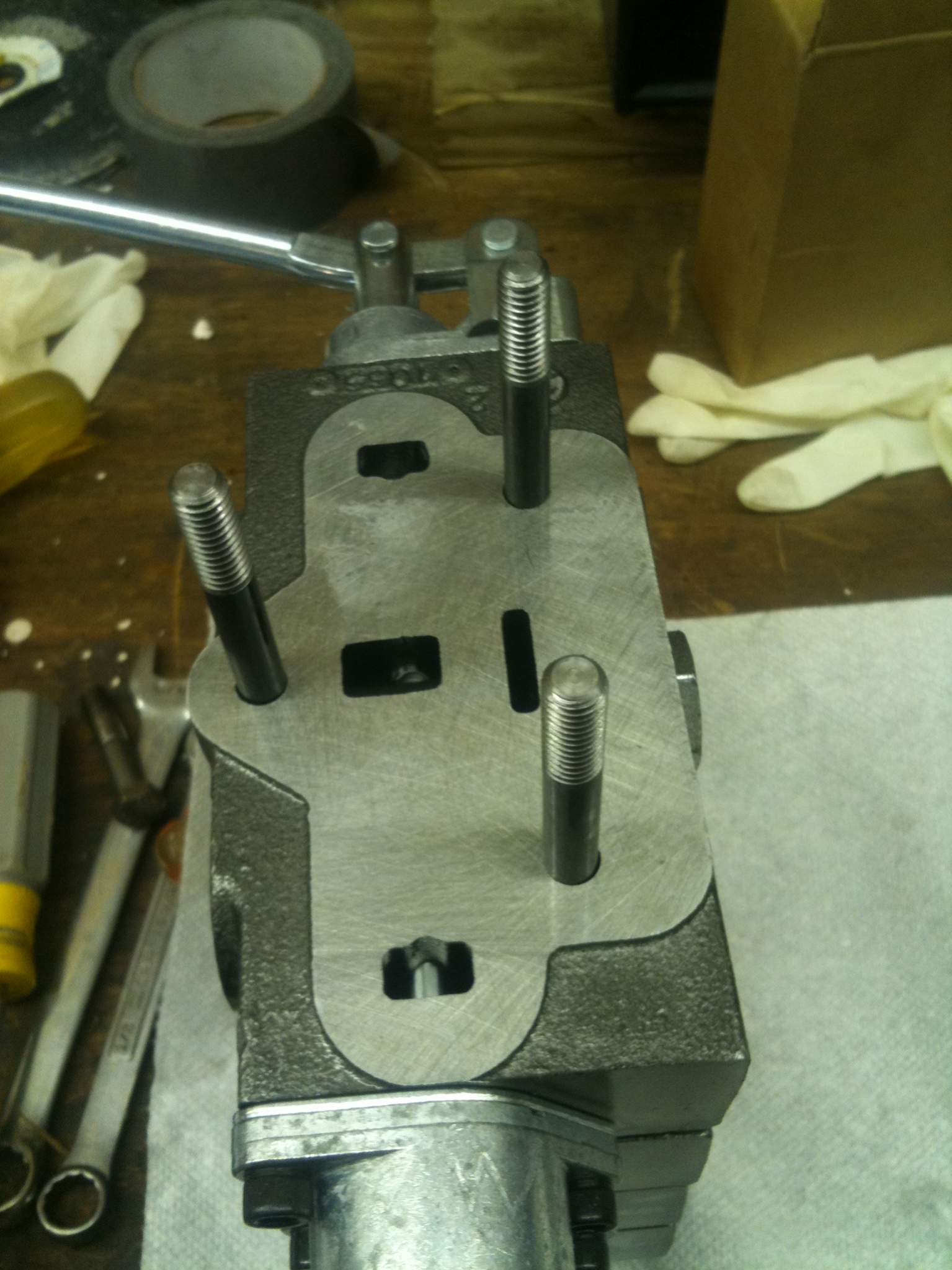

I decided to go with a stack valve for the hydraulics addition. I bought it from surplus center and got a 4 spool valve, I ordered 2 spools with a detented float postion, and 2 spring return to center spools.
It has a power beyond port which I'll use to run the log splitter.
https://www.surpluscenter.com/Item.asp?item=9SV-4-Y
I also bought a QD fitting, and a pressure gauge, so I could check my system pressure and adjust my relief valve setting if needed.
https://www.surpluscenter.com/Item.asp?item=21-1044

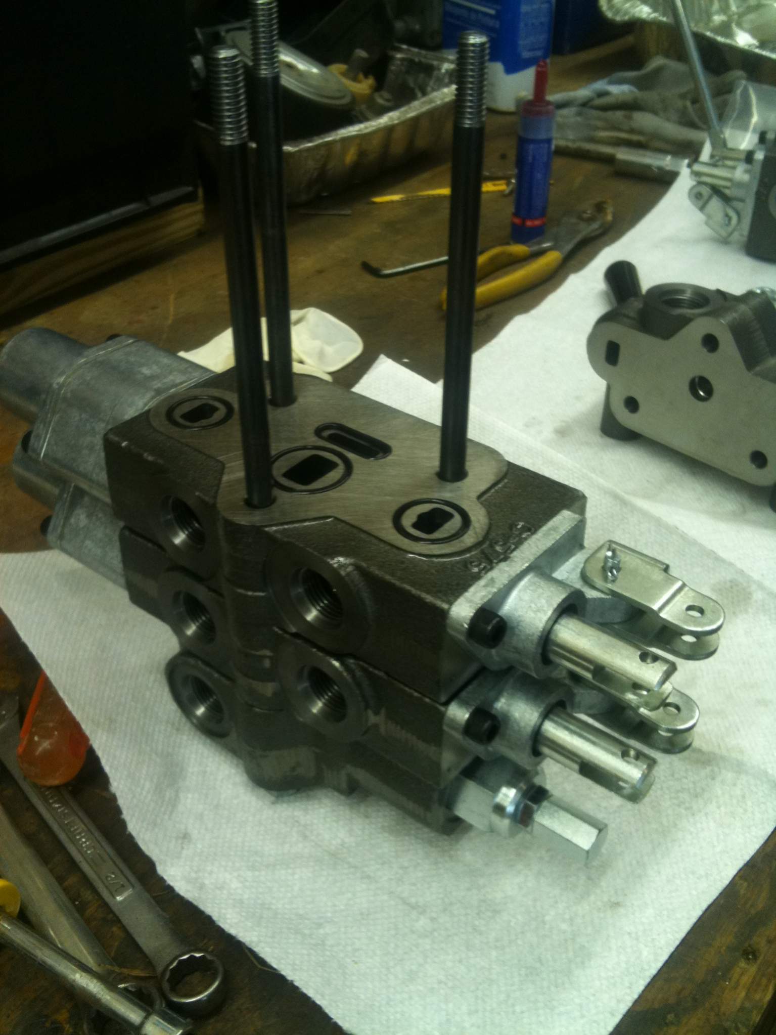

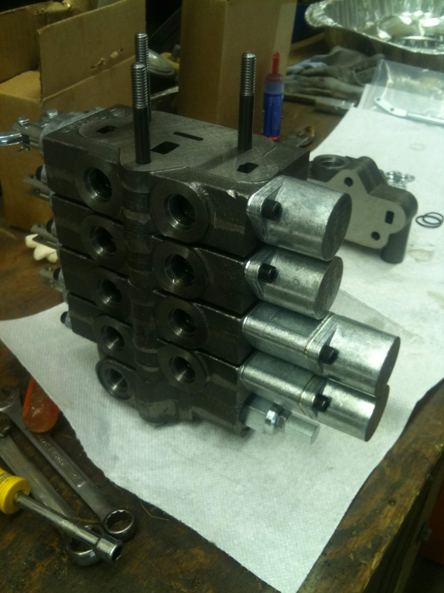

I don't know why I didn't realize this at the time, but I ordered the wrong size for both the QD and the gauge, both 1/4" :mad:
You'll notice in the series of pics I took, that I was so excited to get the valve together, that I started putting the spools on the wrong direction, and didn't notice until I got the last spool on, and there were no 'grooves' for the O Rings to fit in :laughing:
I took it back apart, easy enough, and assembled it in the correct order.
(Note: Don't open all the pics if you have a slow connection, they're basically all the same but just showing how I assembled the valve)

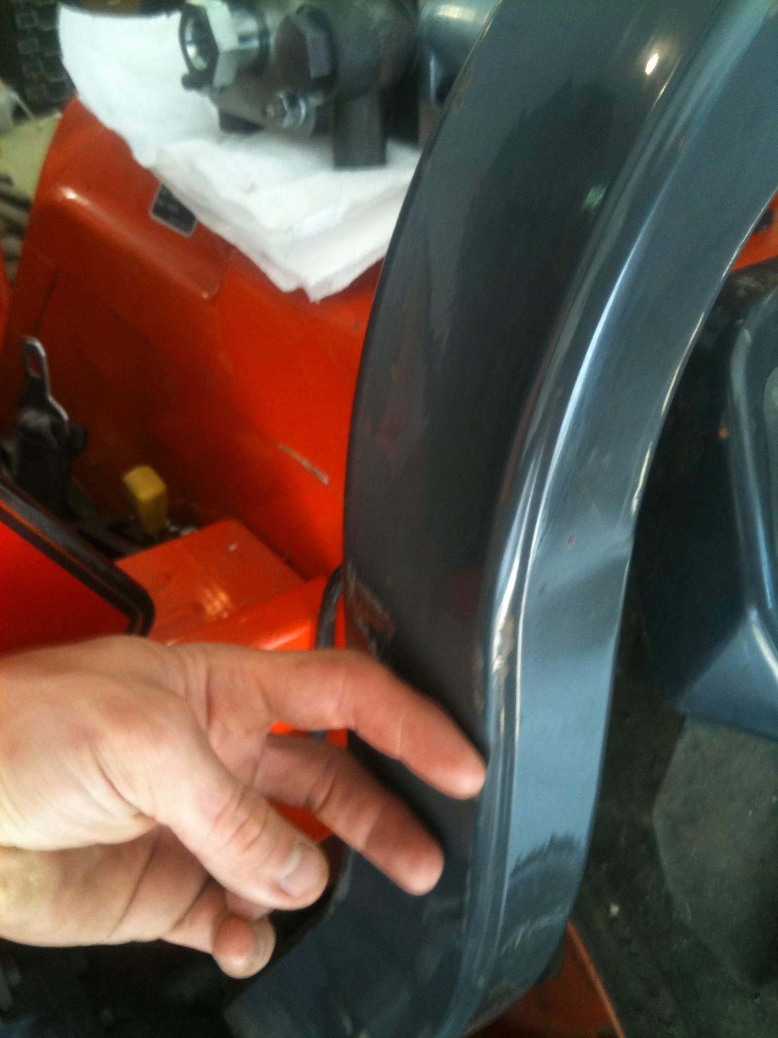

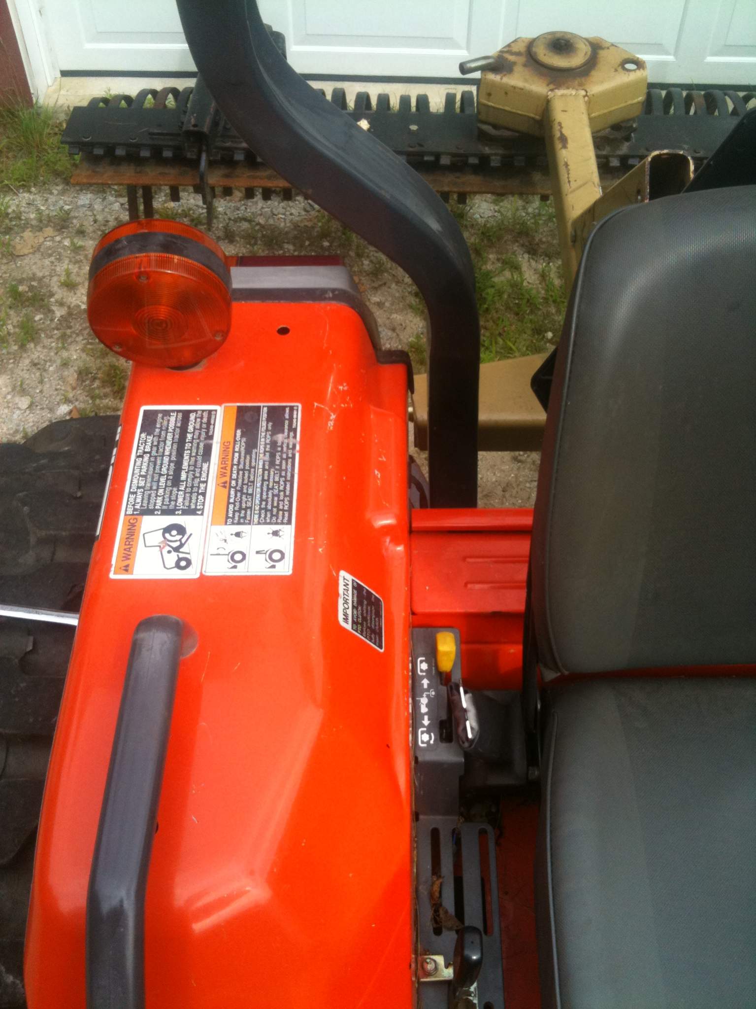

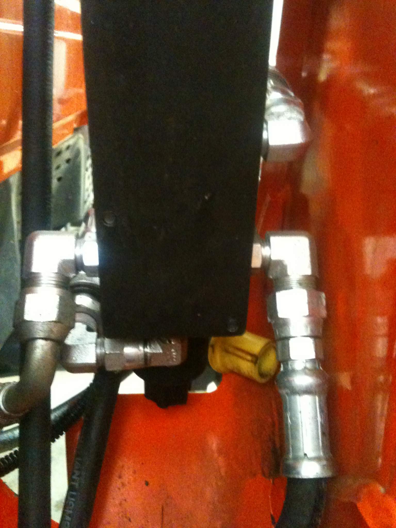

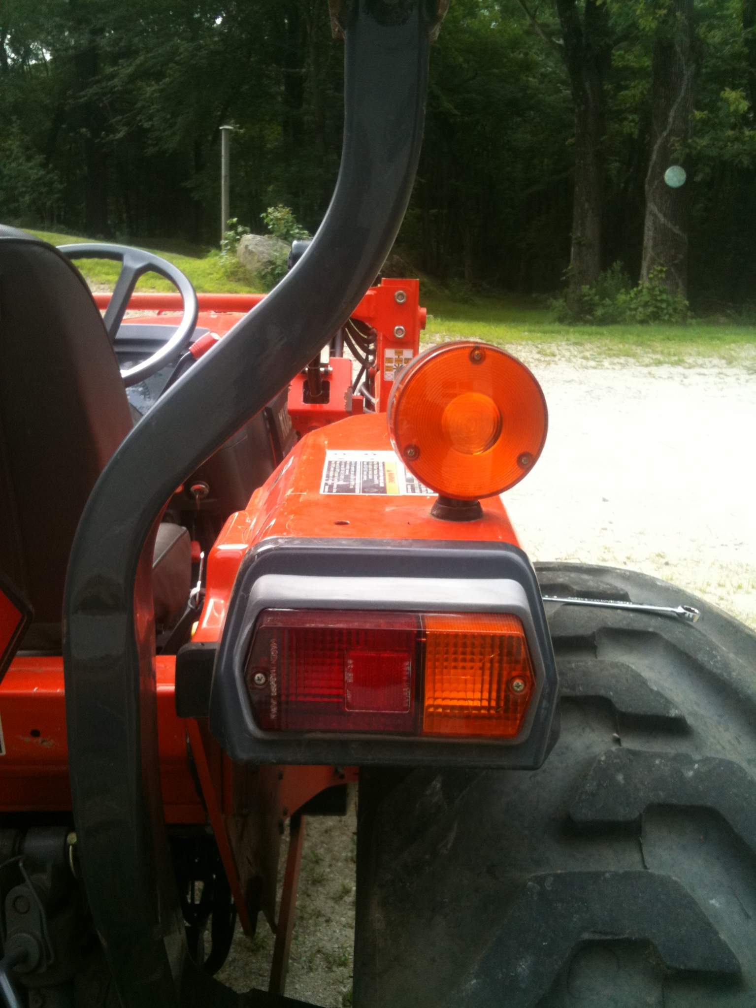

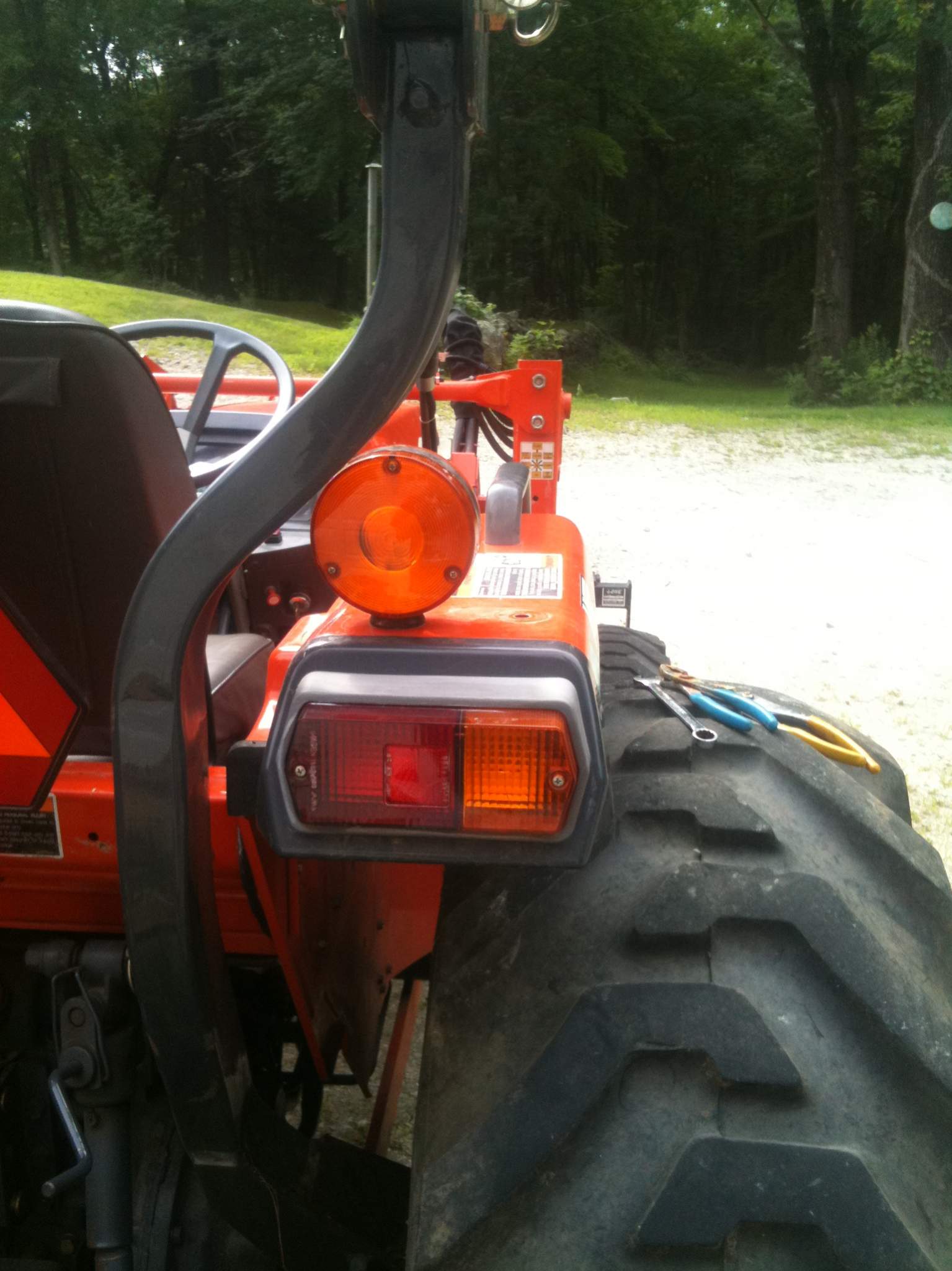

I decided I will mount the valve on the right rear fender, this wasn't all that difficult of a decision considering that the right rear fender is about the only possible place it will fit without much modification! :laughing:
The only thing that made it a little 'cramped' was the rear flasher, I disconnected it and moved it in a little closer to the ROPS where there was already a hole drilled for it, this hole was slightly further back than the one it was in before, and gave me just enough room to fit the valve :thumbsup:

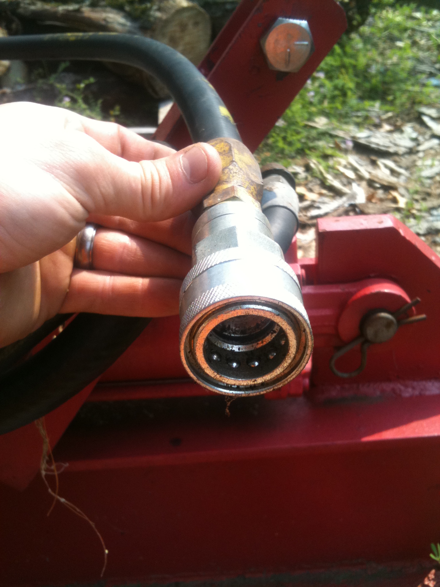

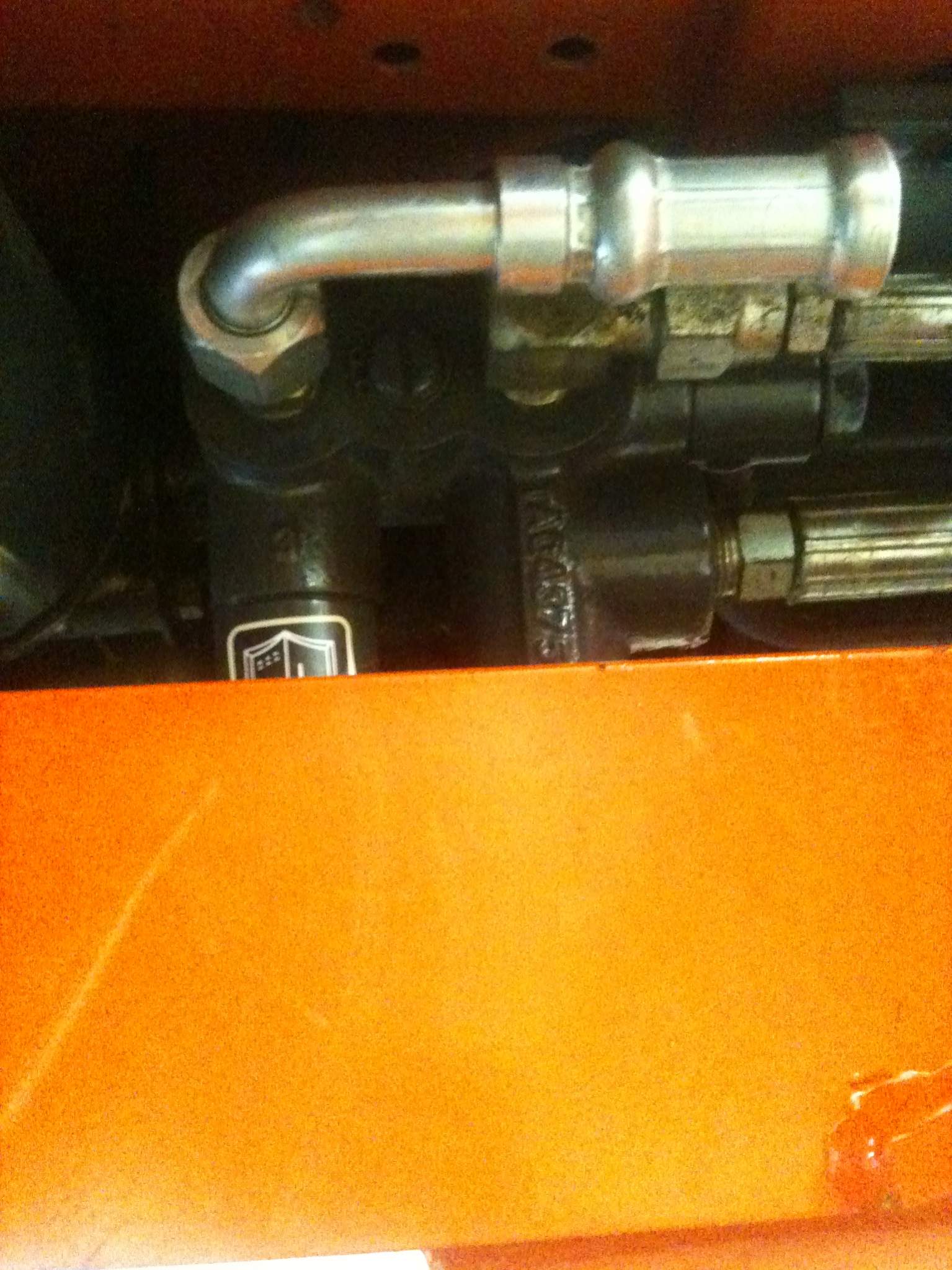

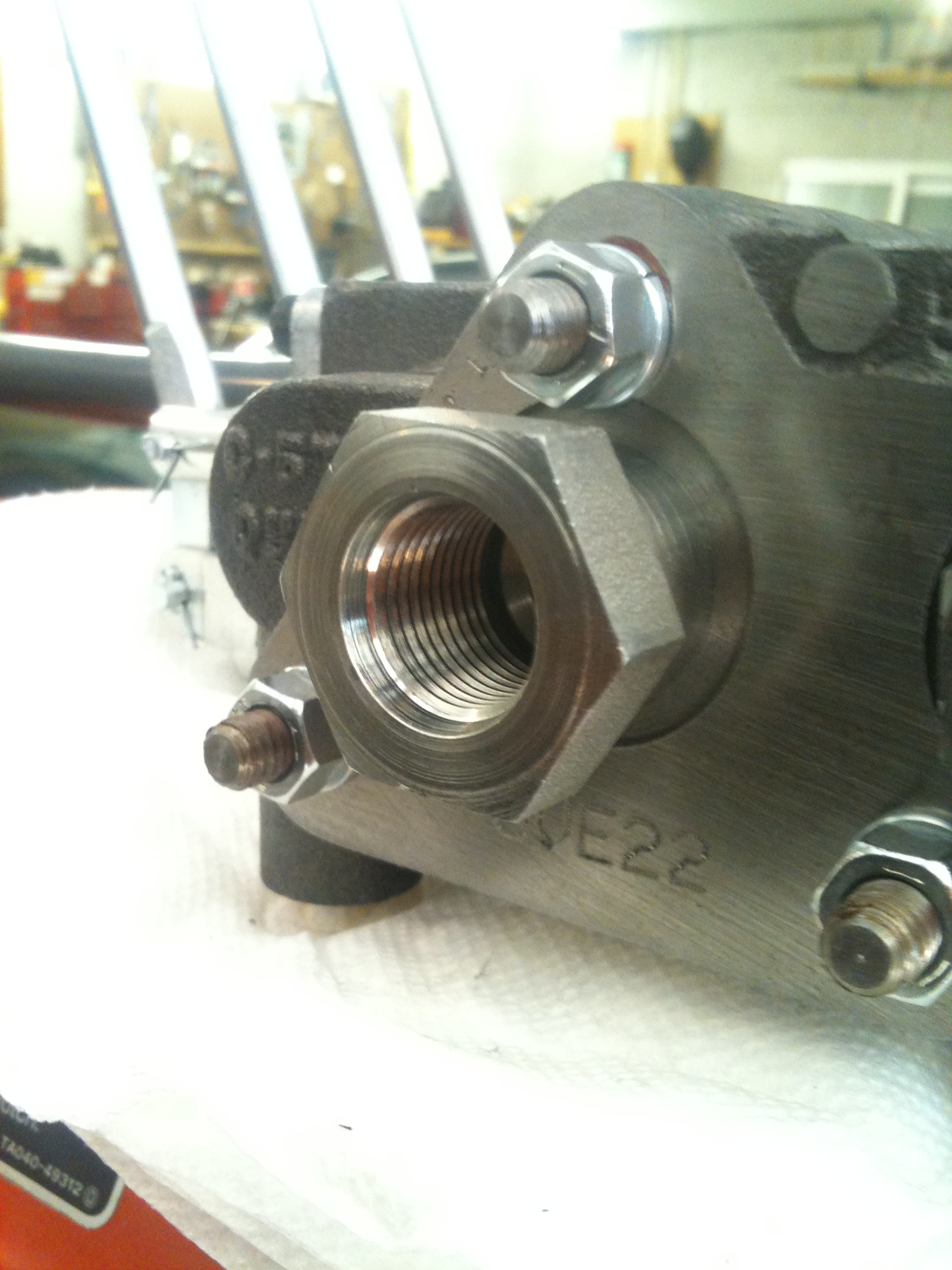

HOSE #1:
I measured out the lengths for the hose going from the power beyond of my 3rd function valve of my FEL to the "IN" of the new valve.
This hose will be coming from the right hose in the first pic (which is the backside of my WR LONG solenoid valve) to the "IN" port in the second pic.
EDIT: I added a better pic (3rd pic)
I'm not sure what to call these fittings when I order my new hose? I know the new valve "IN" port is an SAE 8 port, but is that what I specify to be on one end of the hose when I order it?
I'm not sure what type of fitting is on the other end though, the one that goes into my WR LONG solenoid valve? Can anyone tell what type of fitting it is just based on the first pic?

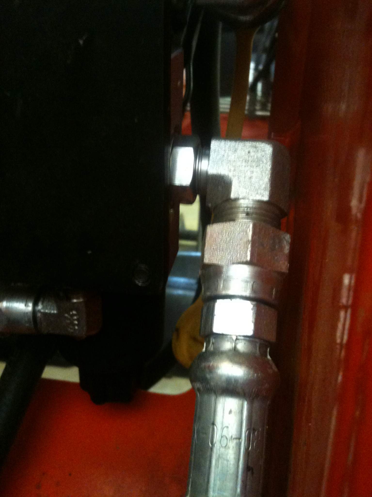

HOSE #2:
I measured this one out as well, and before I order it, I want to make sure I have the routing correct. Since this will be my PB circuit, I will come from the (1st pic) PB port (SAE 10 on this valve) to a QD fitting attached to my ROPS (my two fingers representing the mounting in the second pic). I will need a short piece of hose to complete the circuit when the log splitter is not attached. At least I understand that basic information. :D
Then I'll come from the PB QD fittings to the 3ph I believe??? This is where I'm not sure, I don't know which port to plumb this hose to in the third pic? I think it's the left port in the pic, which is where (currently) the PB from the FEL 3rd function valve is going to right now. (If my memory serves me correctly)
So I'm assuming I disconnect that hose, put it aside, and plumb my PB hose from my new valve, to that same port?

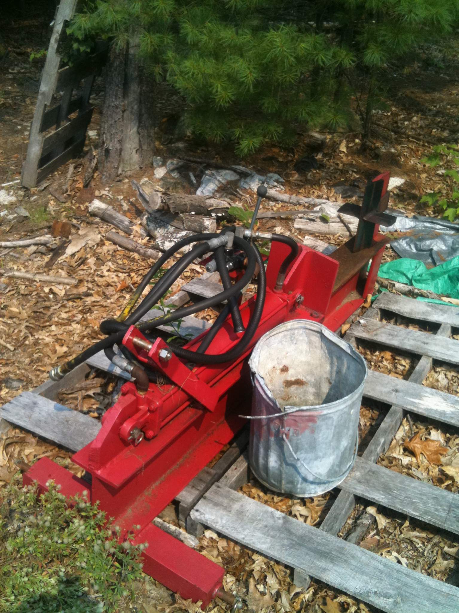

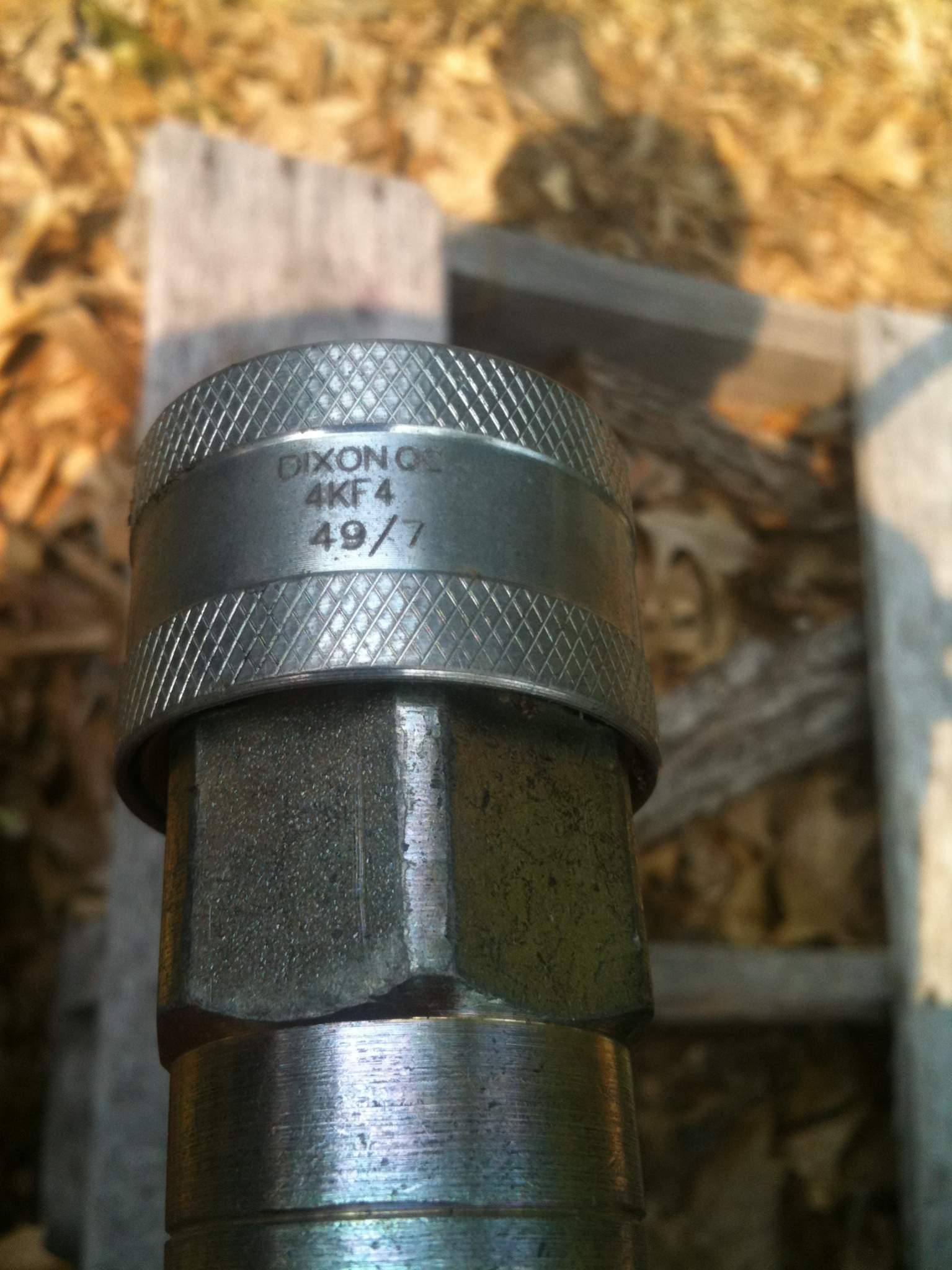

Question about the PB QD fittings....
Is there a 'standard' orientation for the fittings? For instance, I am going to mount the male QD in the PB house to be the 'supply' and I'll mount the female QD to be the 'return'
Is this standard? The reason I was going to do it this way, was because the supply hose for my log splitter has a female QD fitting, the return hose, doesn't have any fitting whatsoever, it's just an open hose that on the last tractor, we shoved into the reservoir. I want to add a fitting and do it right this time.
Regarding the QD fittings for the rear remotes, are all of the QD fittings supposed to be female QD?
Here are a couple shots of the log splitter for reference. The hose is 1/2" Does that mean I need 1/2" QD fittings?

Im planning on using the QD from the PB for my log splitter, as I understand it, I will have to turn off the tractor each time I disconnect/reconnect one of these fittings?
I rarely use the log splitter and don't believe I'll have a problem remembering to turn the tractor off when hooking it up. Of course I say this now, and most likely I'll end up with hydraulic fluid everywhere hahah
Since I've already bought the valve I think I have to stick to my original plan right?
I do have detent in two spools but it is for float. Is that different than a valve detent I would use to power a splitter?
/ Adding 3rd function valve, top link, side link, and one extra. How??? #56
What you do after connecting the log splitter, and starting the engine, is then bungee one of the levers in a position to pass fluid to the IN port of the log splitter valve, which has it's own detent in the reverse position. You might be able to find a detent kit to hold the spool in say, fwd or rev. The OUT port of the log splitter valve comes back to the other work port. Make sure you know which work port on the detent valve will pass the pump fluid to the log splitter valve.
Use 1/2 in QD's, and mark them as pressure and return. Your QD's may be able to connect under pressure, check out the specs.
If you are using the 4 spool for the supply for the log splitter, you will not need the jumper hose. All the work ports on the 4 spool valve have no fluid going through them until you activate the levers.
The fluid goes in the IN port and exits the PB port to the next valve. The 4 levers determine which work ports have fluid. The OUT port will go to tank.
Your path should be something like this, Pump, FEL, new 4 spool valve, to 3pt.
Do not connect the log splitter to the PB port. The supply for your log splitter valve will come from the work port on one of the spools.
A hyd test gage will help you set all this up.
