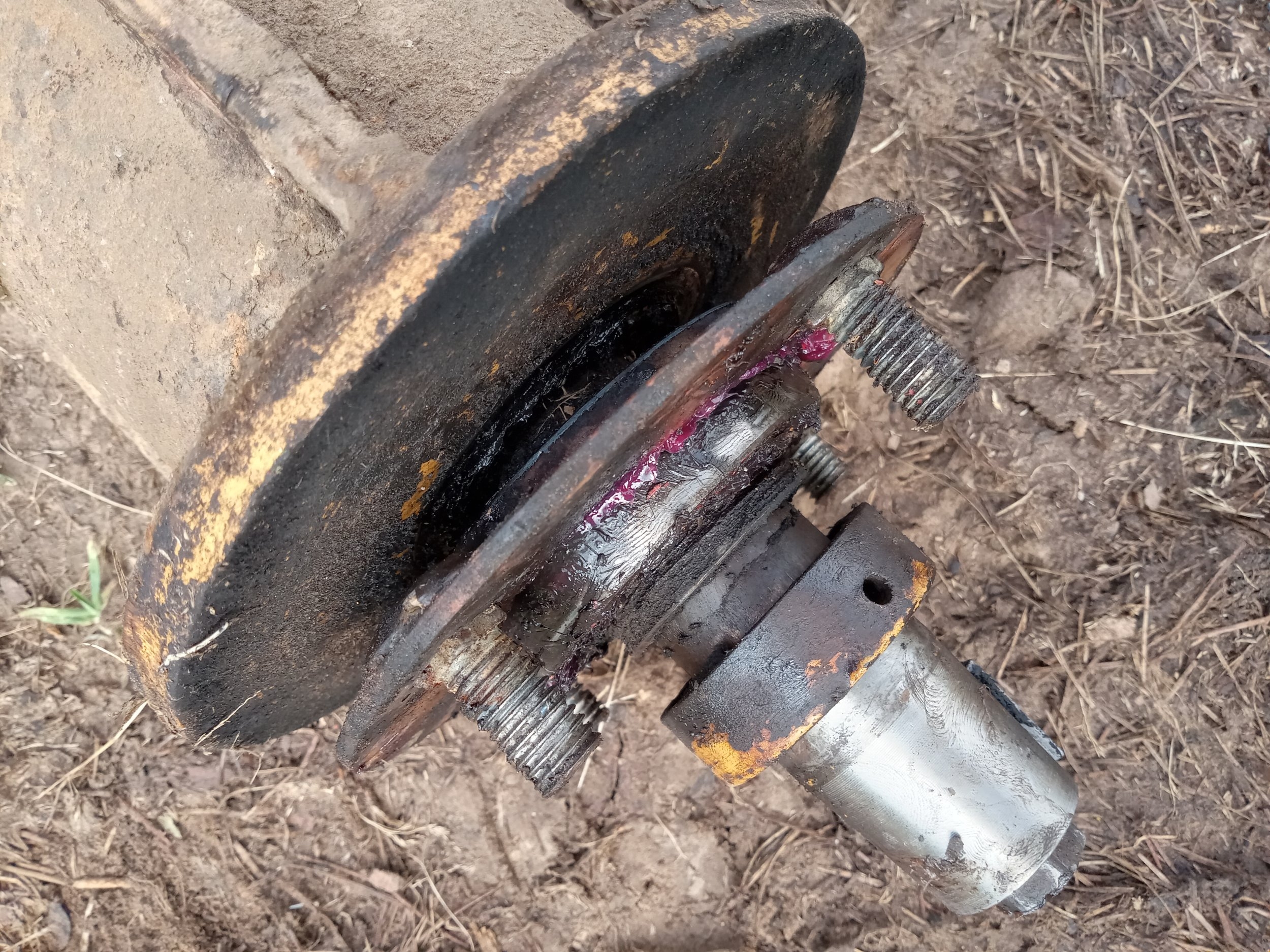

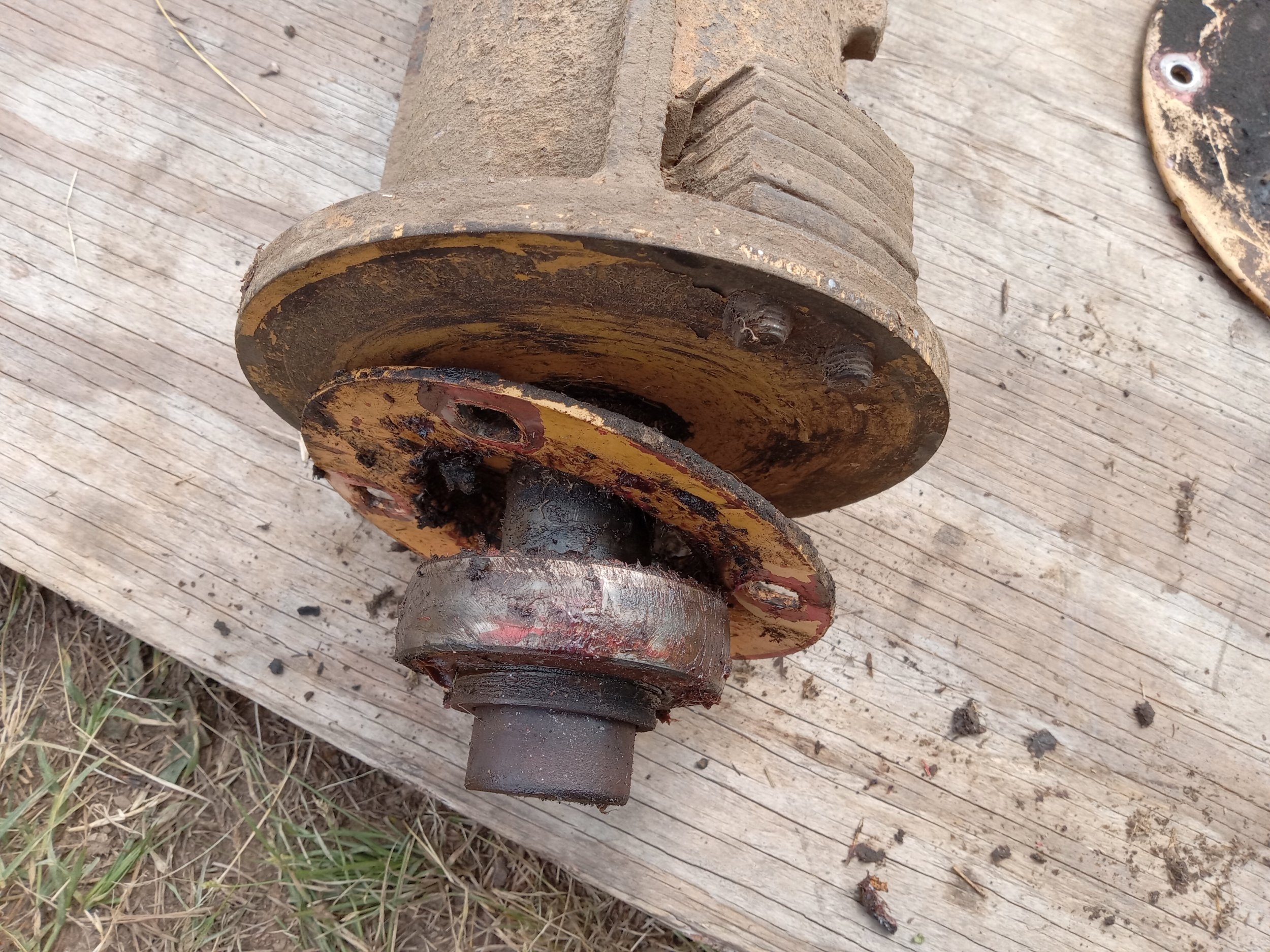

Yes there is a stack of weights. That one collor with the set screw was against the pulley.
   / 917 flail mower #12
Are you sure the rotor is not bent?
Also, we're the collars locked to the bearings?
   / 917 flail mower
#13
No collor was on the right side. On the drive side the collar was locked against the pulley kinda like someone just thew it together. I ordered another collor. As far as the cutter being bent I haven't seen anything wrong once I get the new berings I'll get the drive shaft shop to look at it
