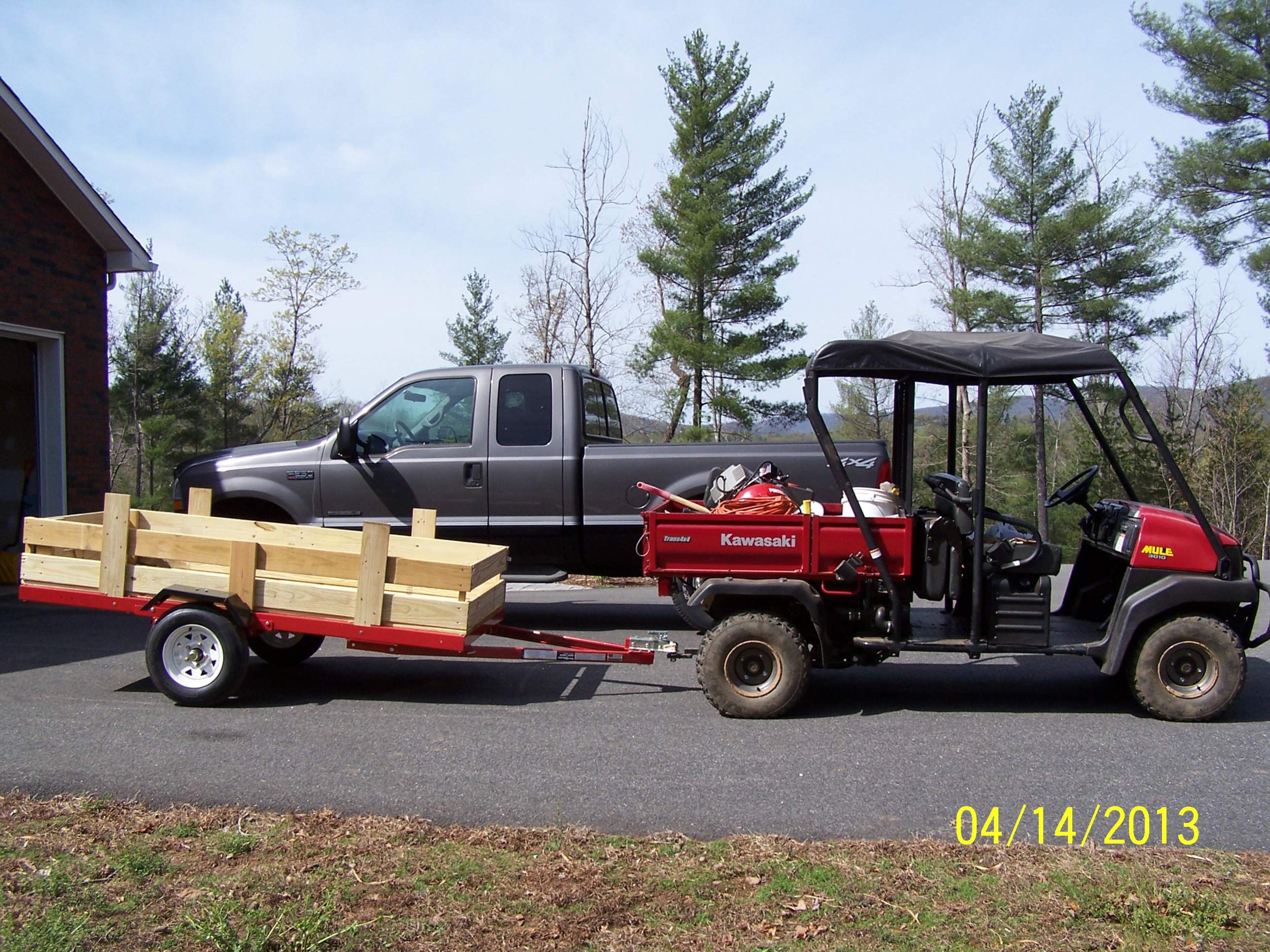

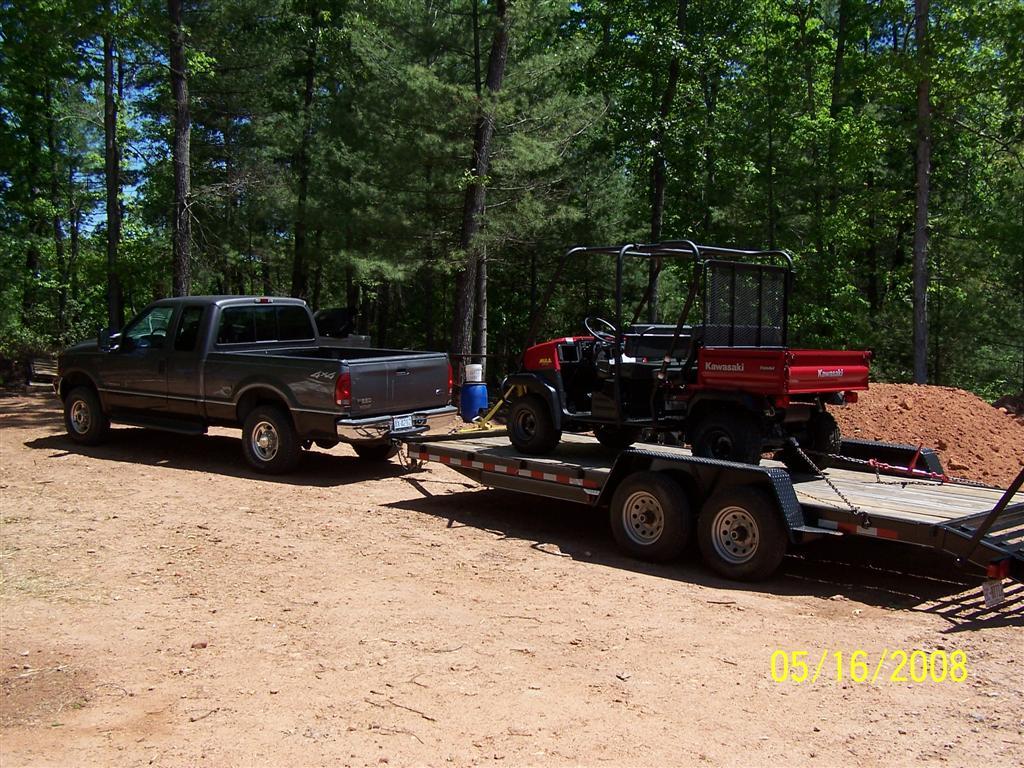

Back in '04 I bought my '99 F350 with 7.3, I think it had around 40k miles on it when I bought it, if I remember correctly.
After a few years, my father started realizing how much nicer it was to plow his parking lot contracts with my heavy diesel truck and 9' plow vs his older half ton and 8' plow. He slowly started "stealing" my truck from me, it took a few years, but I eventually officially sold it to him a couple years ago.
Here is what it looked like for the first few years that I owned it...
Then a few pics during the "transition years" of when my father was stealing it from me....
And what it looks like as of last week....
I mostly only use it now for towing the tractor when needed, and since we live so close together, we still sort of "share" the truck. If he ever wants to get rid of it, which I doubt he will, I'll buy it back from him. I keep thinking that someday when it's all rusted out, maybe I'll want to restore it. As much as I did love the truck when I owned it, I don't miss the harsh ride. I could barely drink a cup of coffee when driving that truck, without spilling the entire thing all over the place.
Here is a pic of it with around 3k lbs in the bed, it's the only time it looked pretty level.
