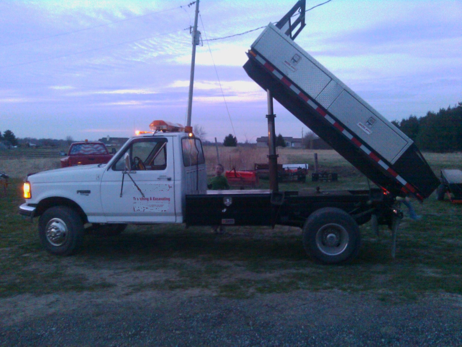

here is my F450 dump 115,000 miles only thing I have done to it was shorten the frame and put a 10' dump on it. No engine mods other than straight pipe or chips and will still out work most trucks.
I just don't use it much anymore. So I listed it in the for sale section.
