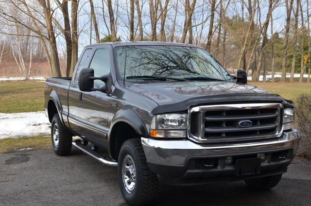

Here is my 2002 F250 that I purchased used about a year ago. It had about 81000 miles. I only added about 1000 miles in the last year. I use it for mostly for towing my JD110 TLB and general hauling of stuff from the hardware/lumber stores. Probably be my last truck.
View attachment 358986View attachment 358987View attachment 358988
/ 7.3 role call #99
That's a nice looking truck to be an 02. Wish mine had that few miles on it.
/ 7.3 role call #100
Very nice!
