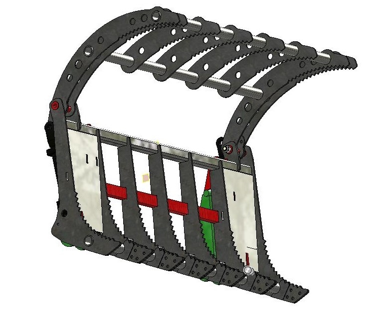

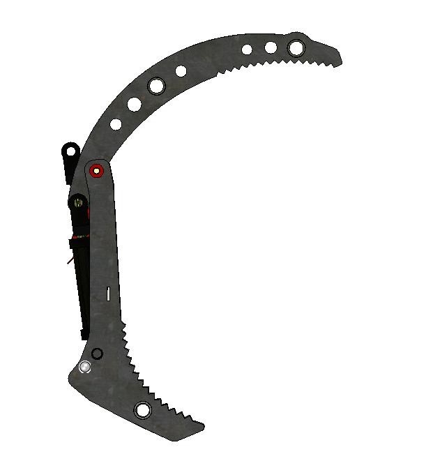

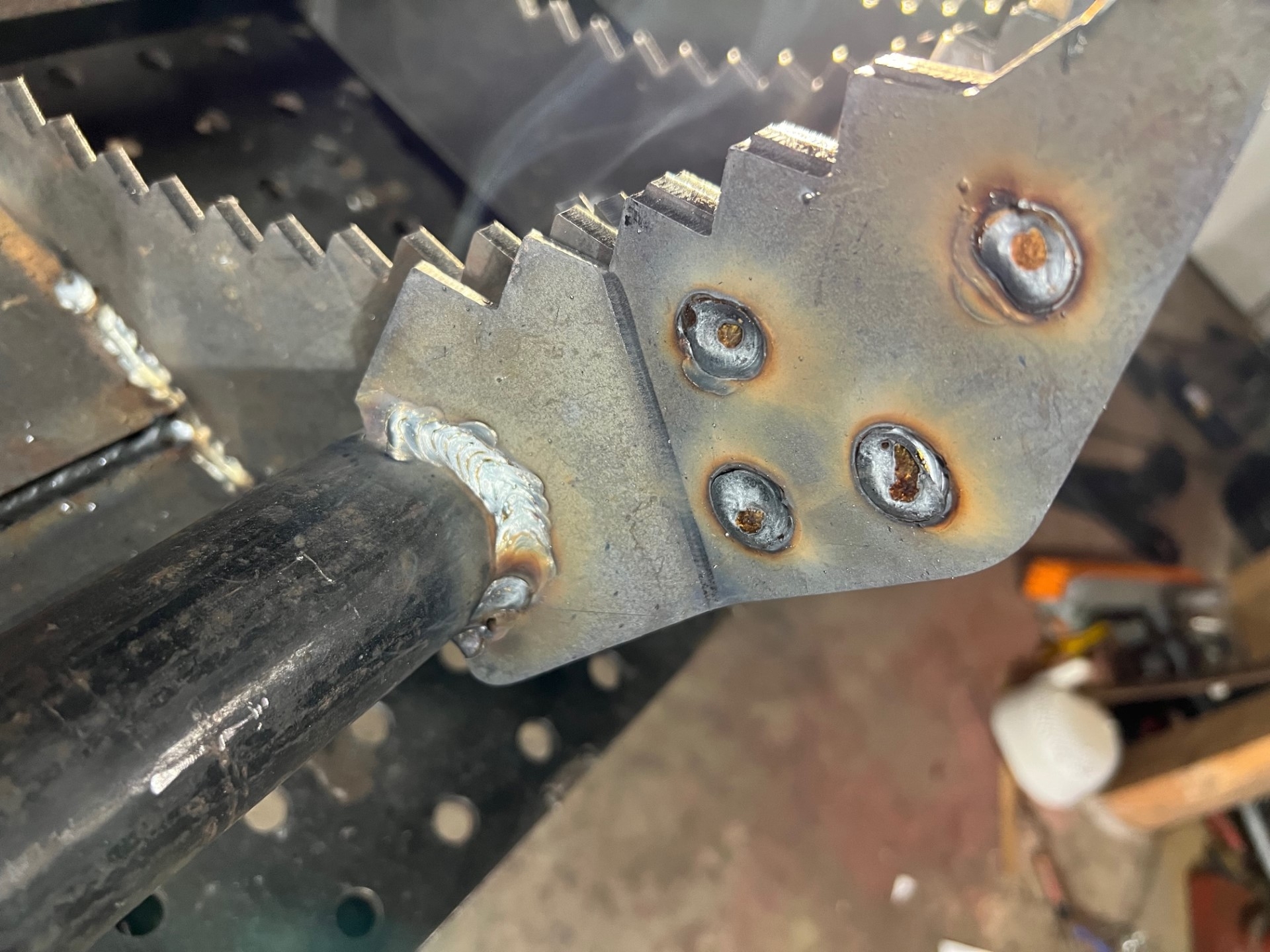

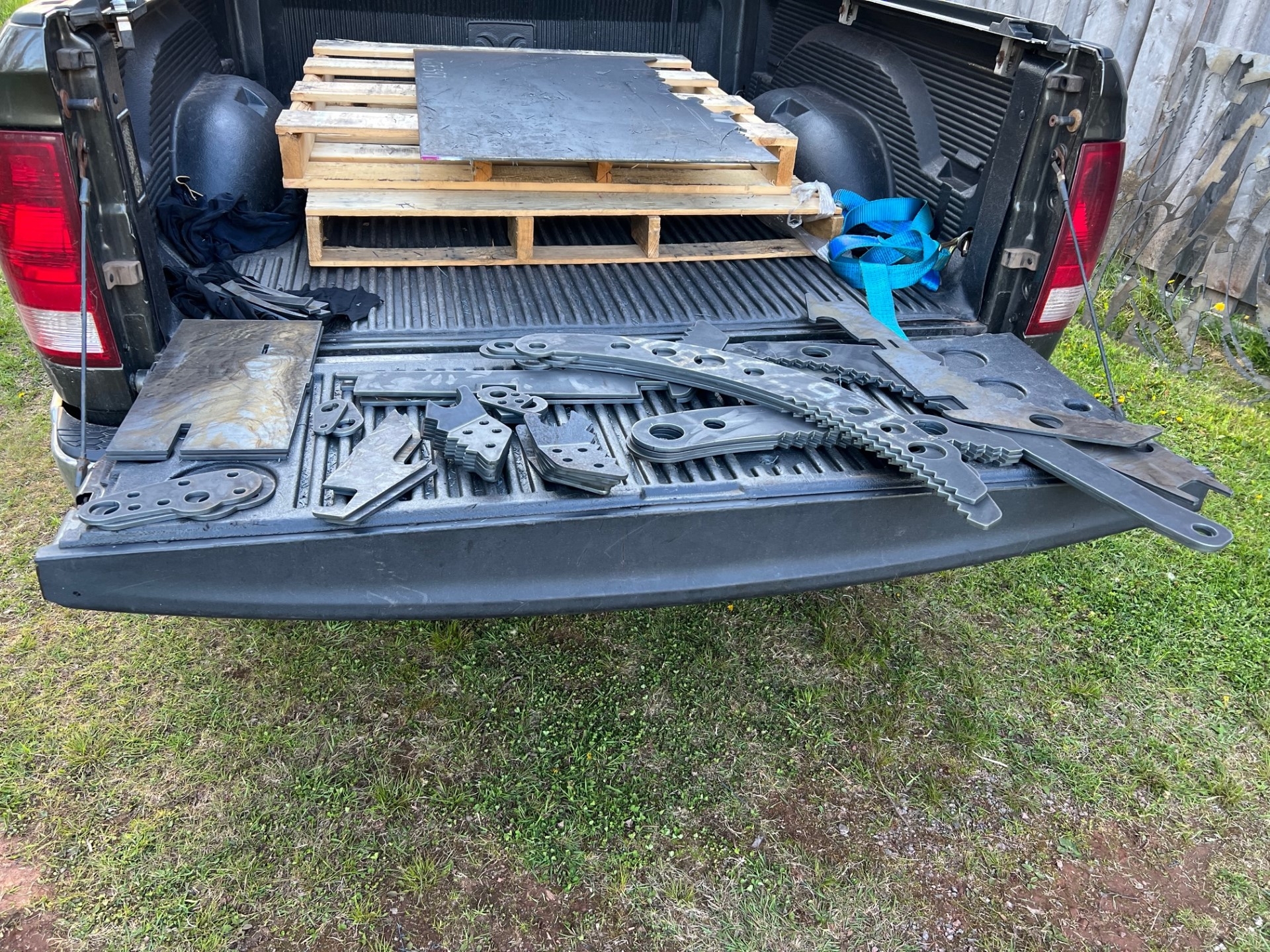

We had a pretty bad hurricane blow across our island last fall. My property sustained quite a lot of tree damage. Thought I could use tractor to help out with the clean up.
So I modeled up a grapple and had a buddy cut it out on his plasma table.
I'm sure it will be clear from where I drew my inspiration from (i.e. robbed, it looked like the best out there.)
I used 1/4 AR400F for the majority of it and spent a few hours this weekend and got the lower jaw mostly complete.

(y) very nice. Are you using bolts or pins and bushings on the pivot points?
/ 55" grapple build
I oversized all of the pivot locations on the plasma parts so I can so I can turn accurate bushings out 1144 stress proof.
I'll be using pins on the cylinder lugs and 3/4" grade 8 bolts on the hinge.

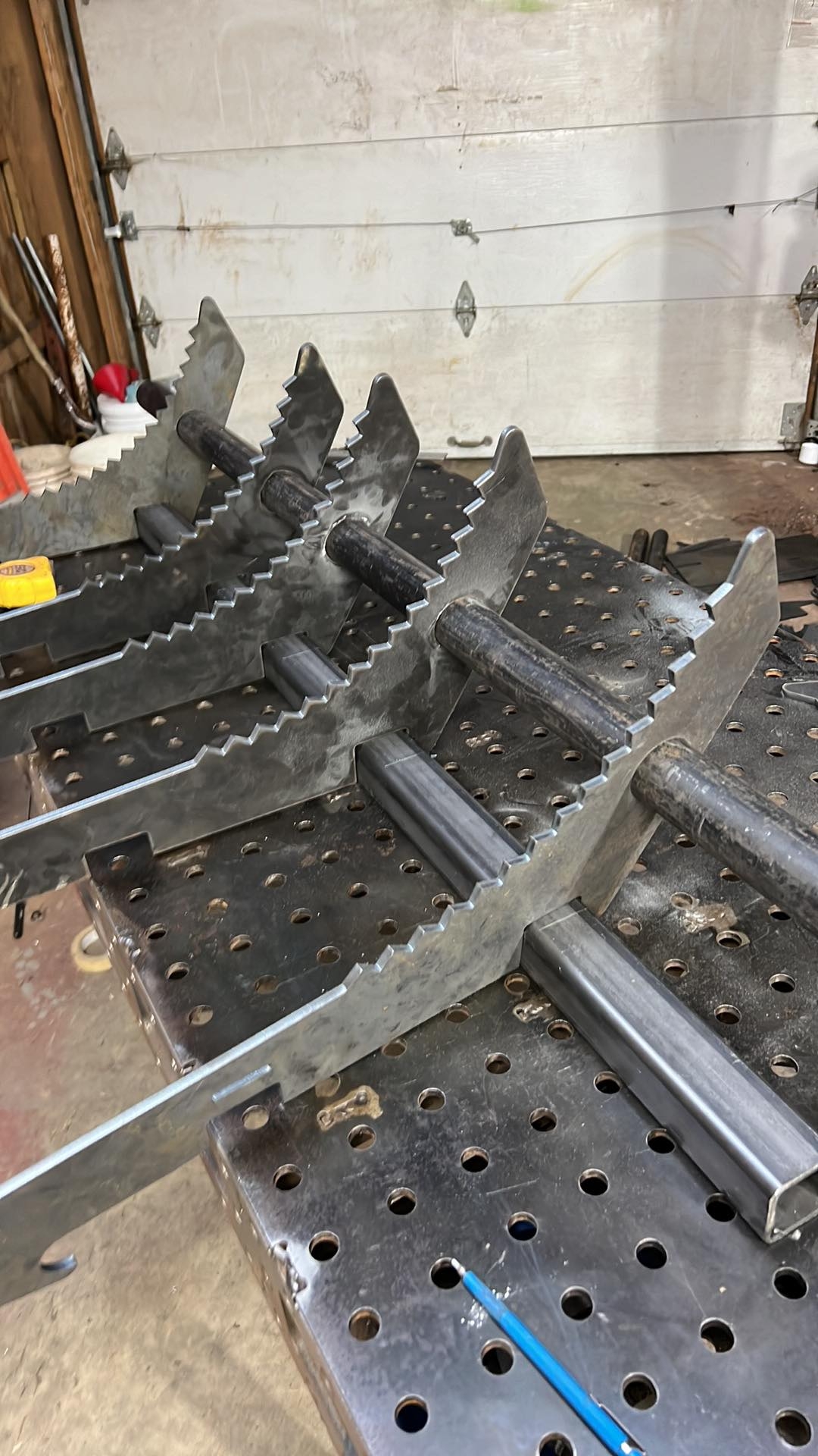

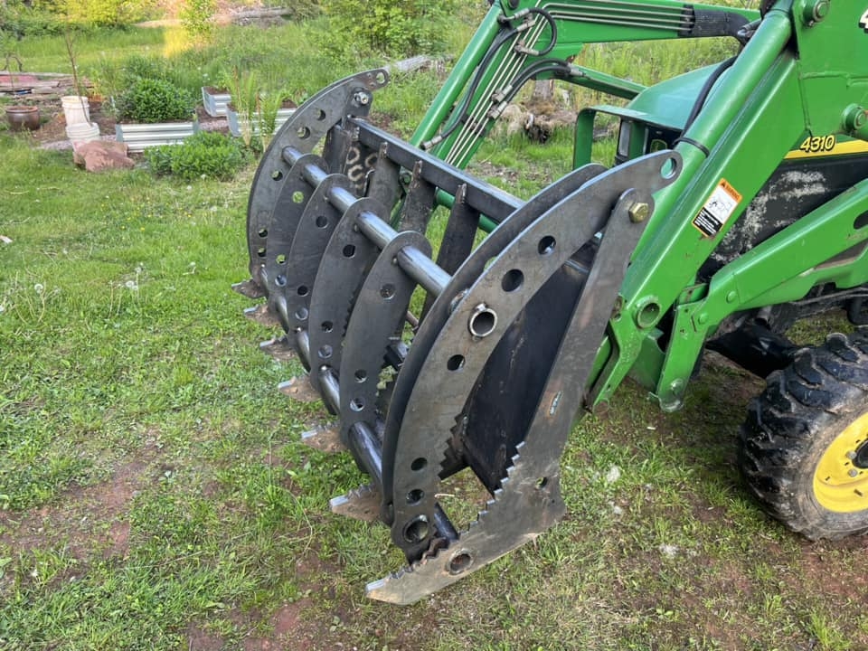

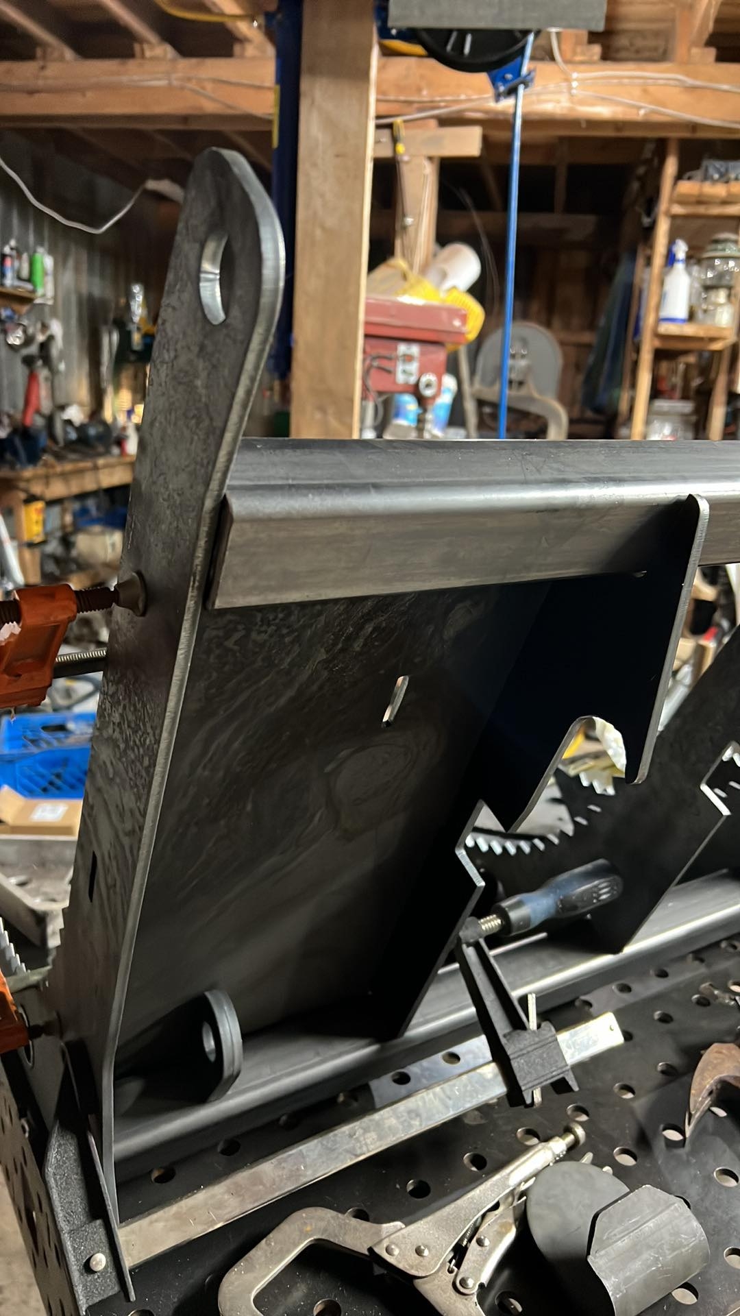

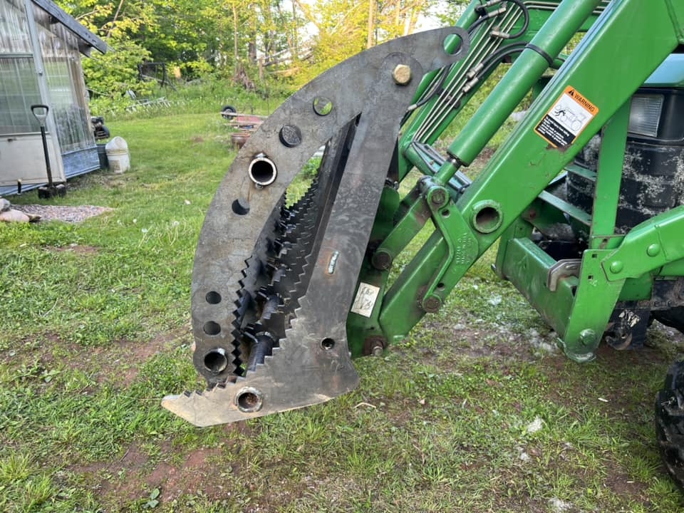

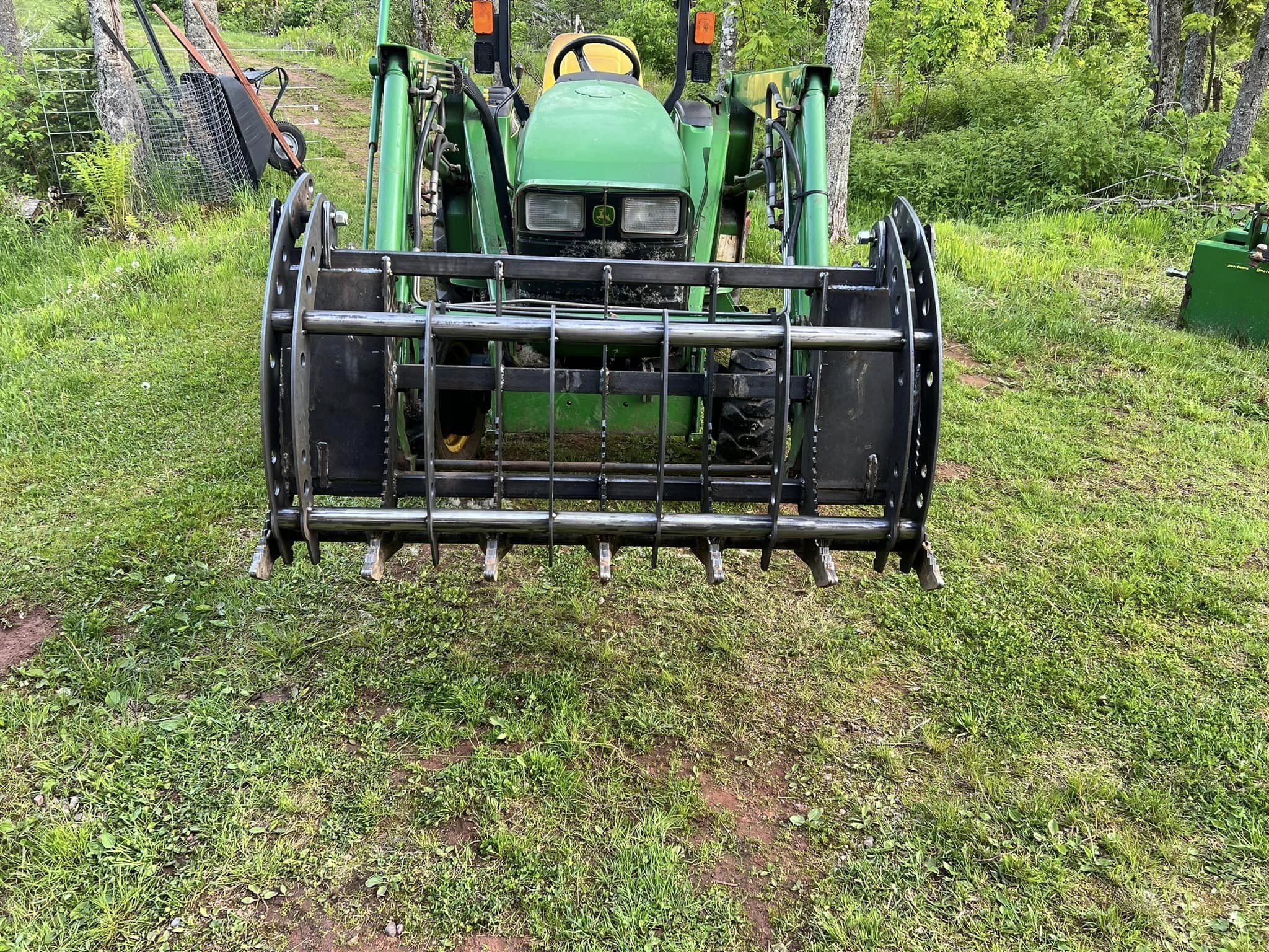

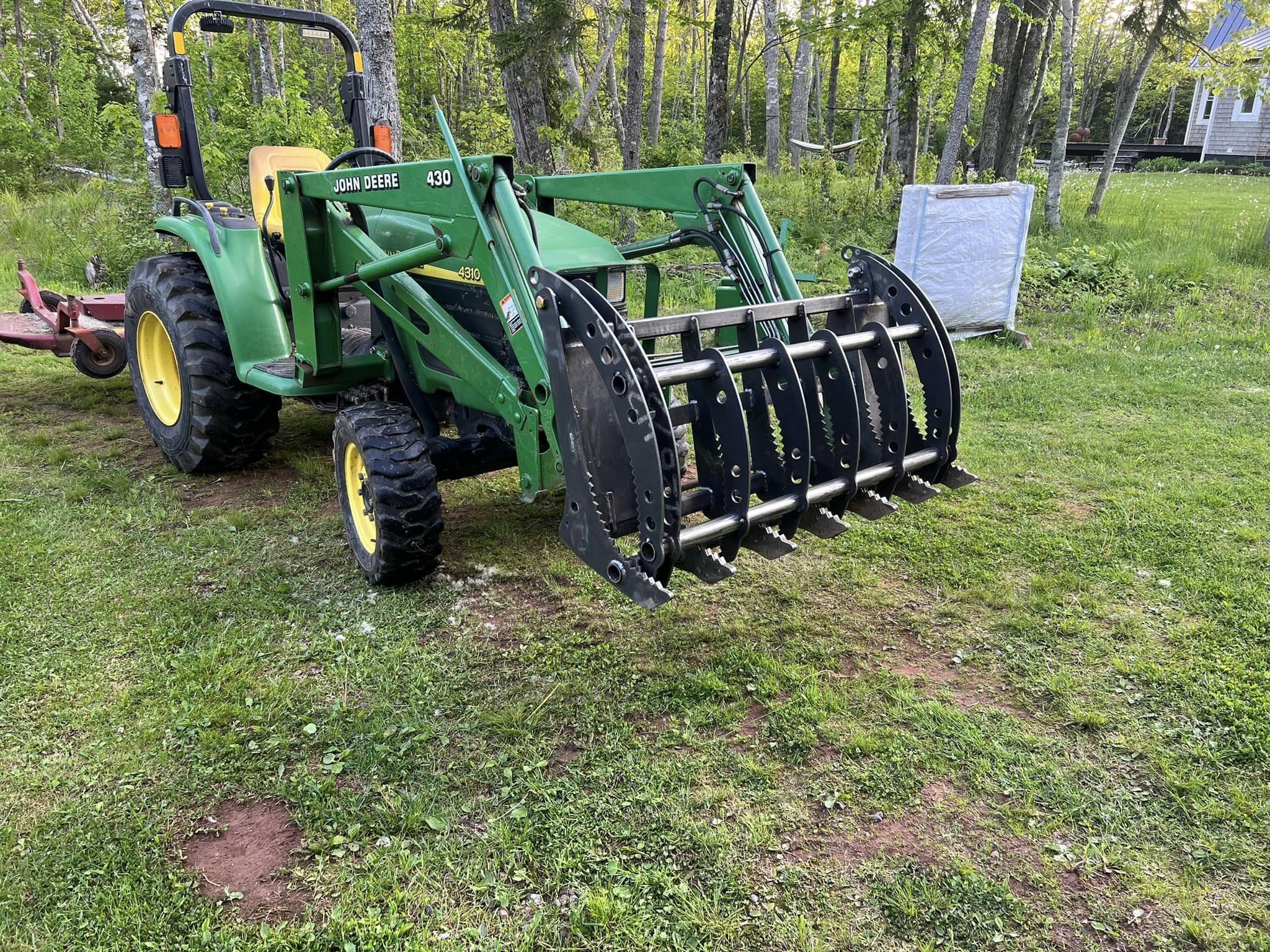

Put a little time on the grapple last weekend. still need a few gussets and finish welding.
Then install the diverter valve when it arrives.

/ 55" grapple build #5
Nice looking grapple.
What was your total cost to build?
/ 55" grapple build
Thanks tradosaurus, Pleasantly surprised at how well its coming out.
The AR400 was $900 and I've probably got 1/4 sheet left over. (oops I mean I have a stump bucket left over.)
Plasma cutting, my buddy did the for free.
Cylinders $200
Tube and sch80 pipe $140
Grade 8 bolts $6
I used some drops I had kicking around to turn bushings and pins.
6lb of wire and a small tank of c25 gas
$1021 (canadian) total so far.
That doesn't include the diverter valve and various hoses and fittings

Thank you for sharing. Lot of us try to modify, repair and innovate our equipment to meet our needs. Materials and fabrication equipment certainly has changed and improved attachments. Operating a tractor in the woods needs several modifications. Any special procedure for welding AR400?
/ 55" grapple build
#14
Not an expert by any means, but my understanding is that its pretty standard up to 1/2 thickness. These thinner plates can be welded at room temp without preheating. The biggest thing as far as I'm aware is you want the welds to cool slowly.

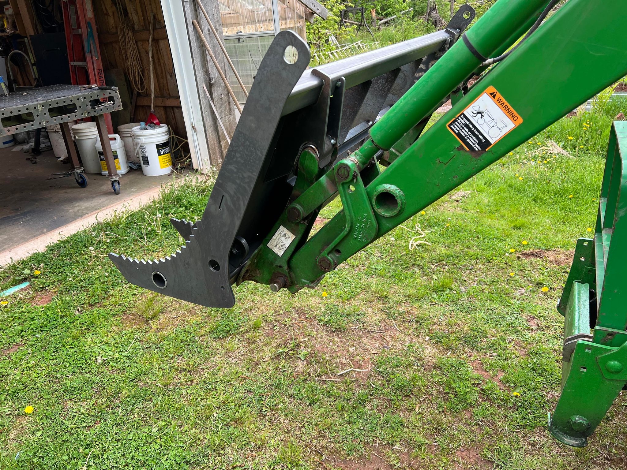

I used 1/4 AR400F for the majority of it and spent a few hours this weekend and got the lower jaw mostly complete. View attachment 804184
looks great so far. I am wondering why you didnt put any lightning holes in the lower jaws.
/ 55" grapple build
#16
Mostly oversight. As I was watching the parts being cut, I said to myself "I meant to put speed holes in those bottom tines."
