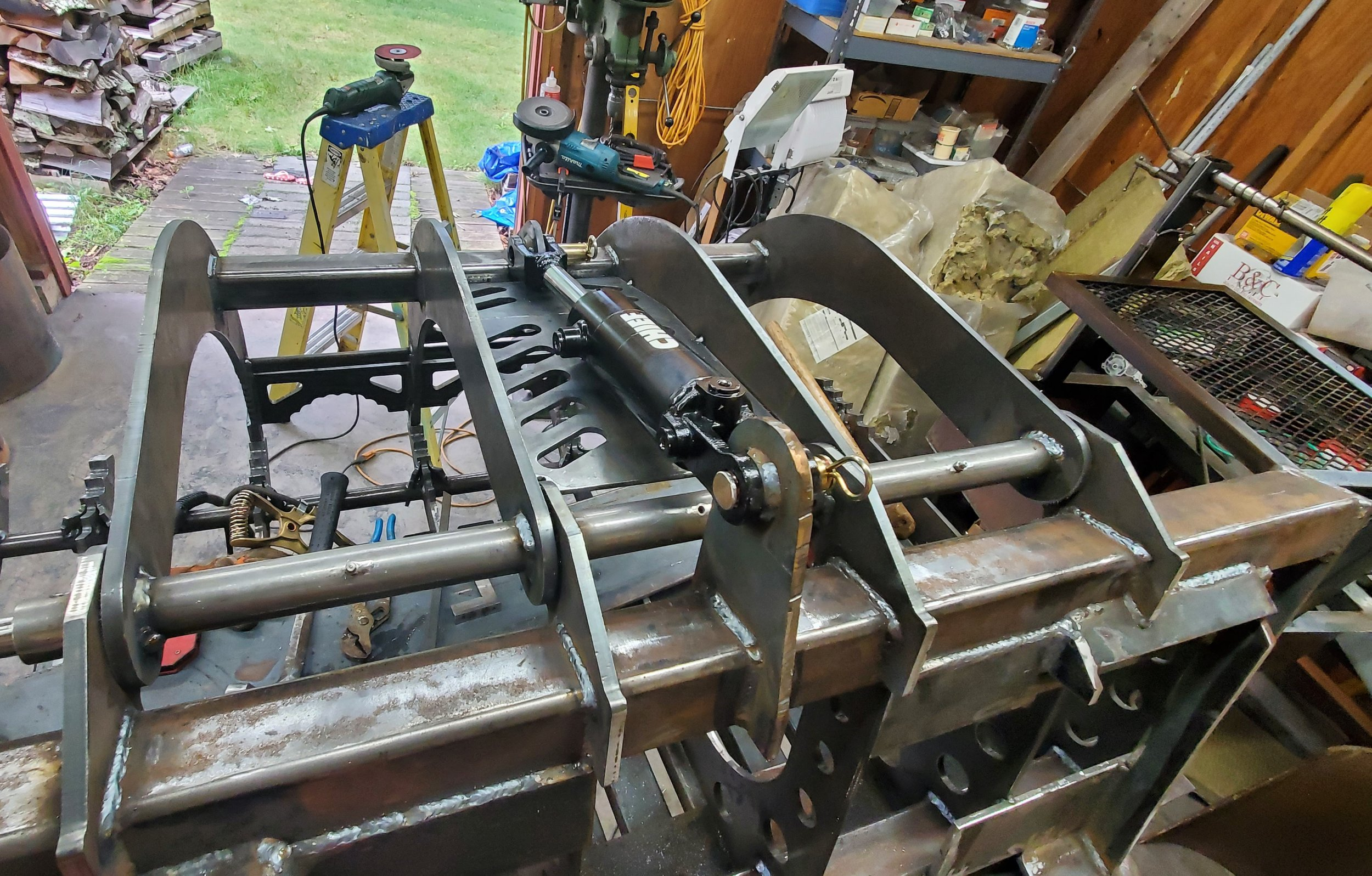

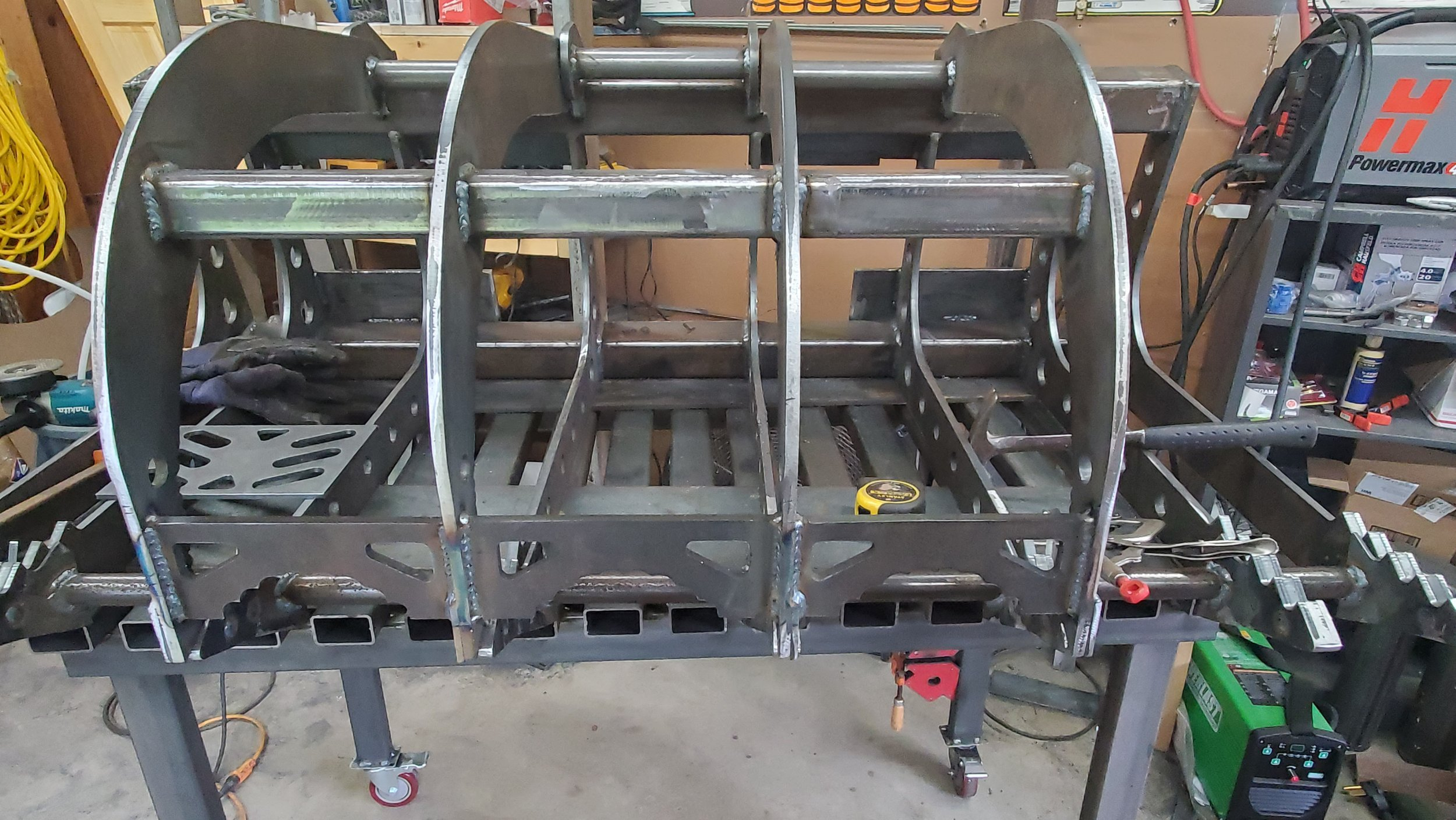

Table area grinder storage you will like. I hate changing from grinder wheel to abrasive wheel to cut off wheel to flap sand discs so I have 3 or 4 grinders always set up. They take up a fair amount of work area.
/ Compact Tractor Grapple Build
#23
Crazy fabrication skills man, looking good.
Thanks a lot. As long as I don't rush too much I do okay.
I've been using three grinders lately and it's just about right, but I could always use one more. I always find it difficult to spend time building stuff for the shop when I always have another project in the works.

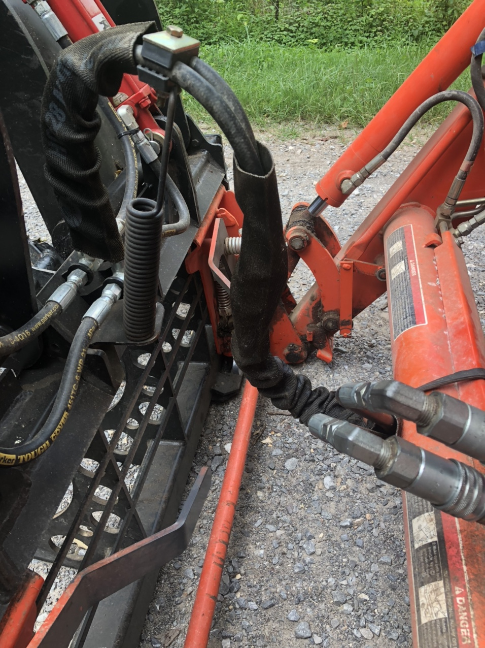

Spring for hydraulic line slack. Danuser Intimdator uses one too. Helps keep the lines from hooking on the ssqa levers and dragging the ground.
I really like that vertical spring idea. Seems like a better way to go compared with my horizontal ones.
gg
/ Compact Tractor Grapple Build #27
Yep, the vertical spring does it's job on the Tilt-Tach with the land plane:

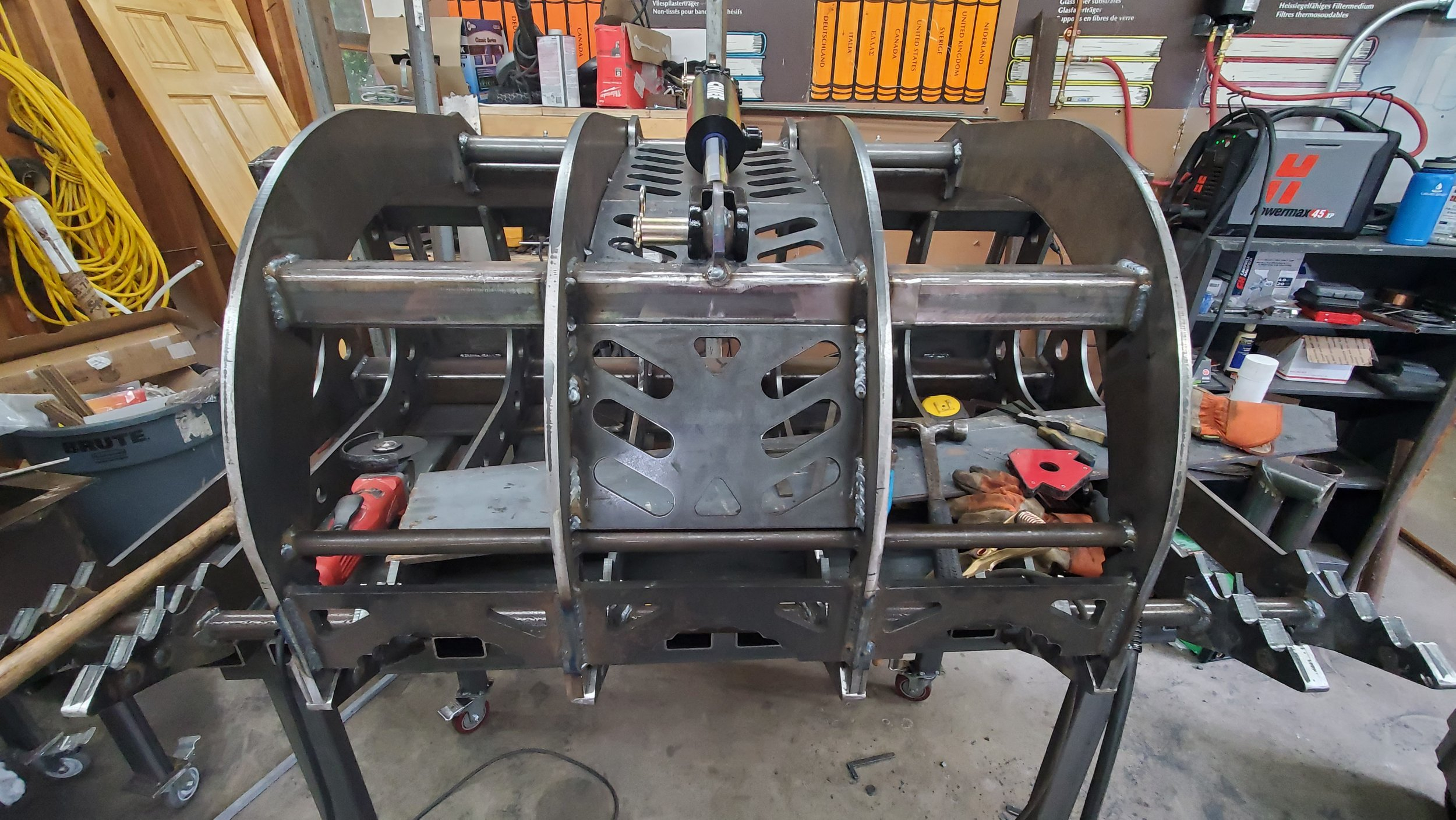

I was able to get some time in this weekend and finish painting the grapple. Epoxy primer and gloss acrylic enamel to finish, I couldn't find a low sheen finish that shipped quick enough. I hooked it up to test out but I wanted to give the paint a couple of days to dry before I put it to work. I'll snap some more pics of the setup once I start using it. I also decided to add some bars in the center to hopefully avoid a direct hit to the grill from a stick. The hoses are 1/4" which help with slowing the speed of the top lid from slamming shut.
/ Compact Tractor Grapple Build #30
/ Compact Tractor Grapple Build #31
That’s a mighty fine looking grapple!
Like your branch bars. They help. Sticks are sneaky. It’s not if but when one will foil your grill. Grapples just increase the odds. Built 5 guards in fifty years with the last ones before I got damage. Fortunately the local scrapyard has good supply of stuff.

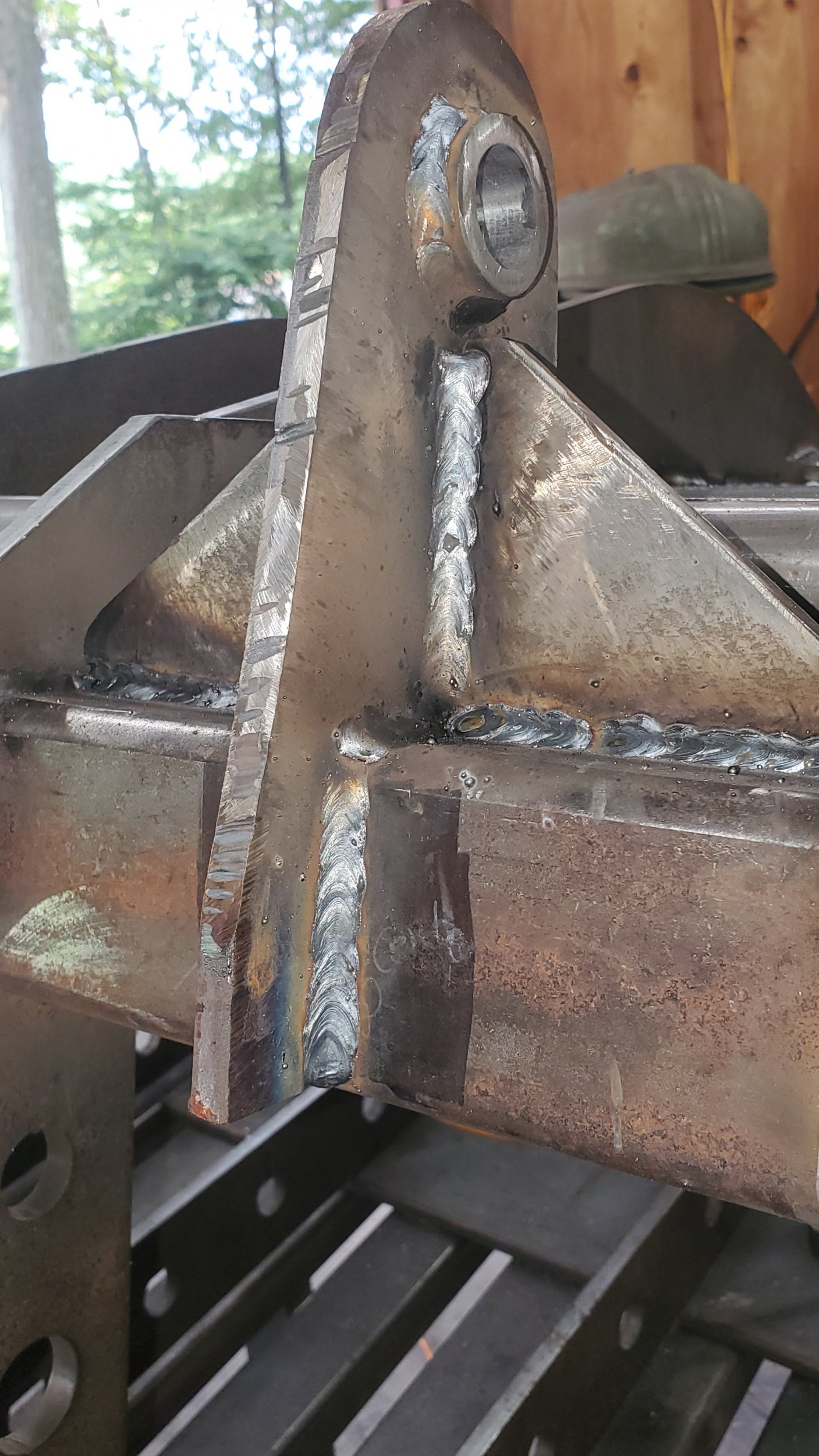

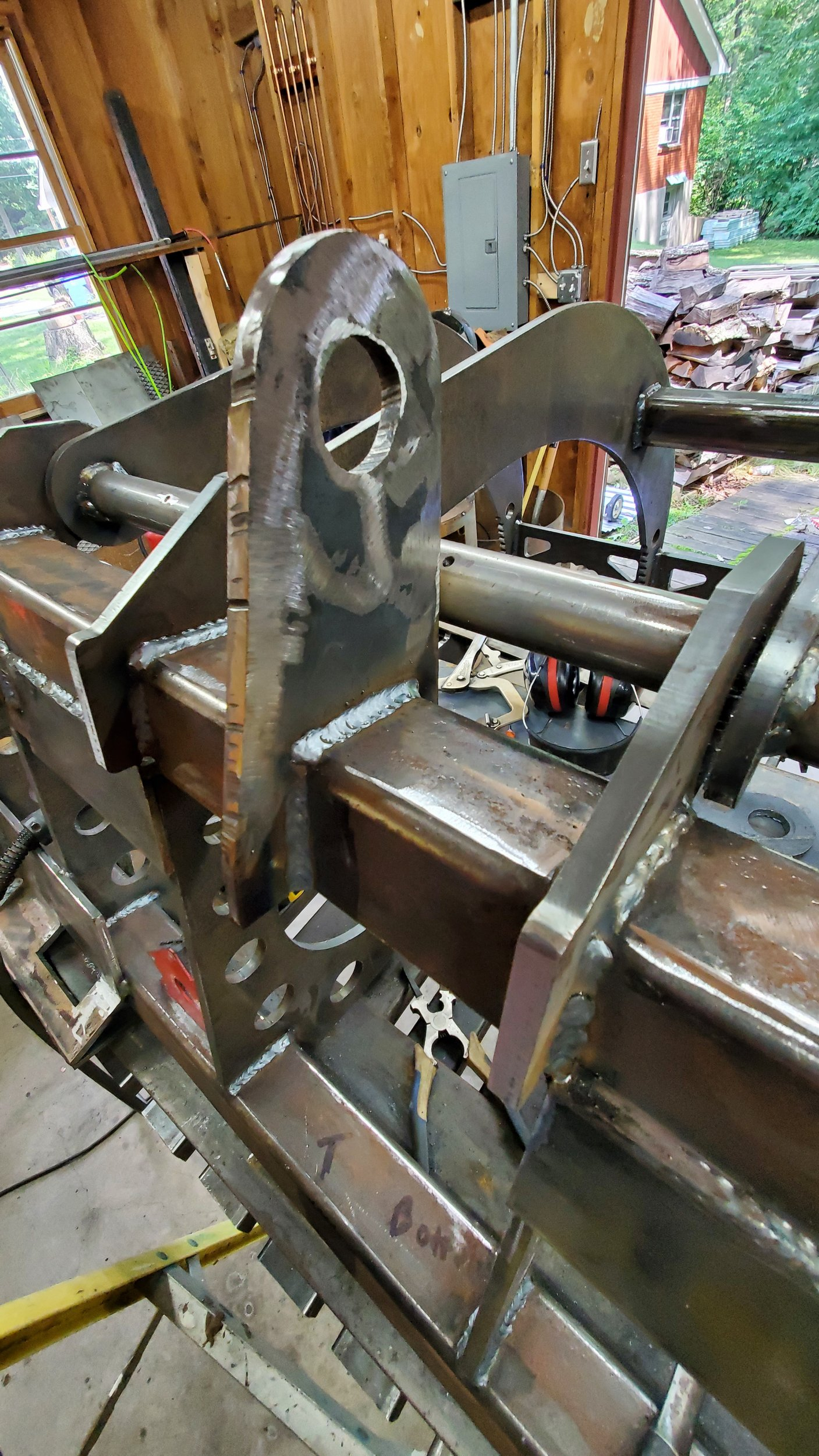

When I did the initial fit up of the ssqa it was tight as could be. I did run into an issue after I welded the side plate of the ssqa. The welds actually pushed the tractor bracket out, didn't allow it to sit flat completely at the bottom and I couldn't lock the pins in all the way. Before painting I ground the welds down to create a smooth corner and everything worked again, although one bracket is about 1/8-3/16" off the face. Let me find some pictures.
#37
This was the first go around on the ssqa fit up. Notice the upper portion of the bracket where it bends just before the triangular reinforced section is being pushed out by the steel plate. I notched the 1/4" steel plate to allow it to slide complete into the upper mount. Maybe this is causing some movement? I didn't notice any steel clanging or actual jiggling around while moving fast, just flex if that makes sense. I'll try shimming with something to rule that out, but it might just be the forward weight of the tines. If I travelled back and forth with the upper tines open it didn't seem to happen, maybe because there isn't as much forward weight.
Here's the final fit up, much tighter.
One last view from a different angle. I can't imagine there's any play in this.
I might just be crazy and this is my first grapple!
/ Compact Tractor Grapple Build #38
Looks like a prefect fit. Don't know what could be flexing.
/ Compact Tractor Grapple Build #40
Having trouble seeing one picture. Don’t understand the back plate notching of the top plate interference cause? That changes the common plane the top and bottom share? It looks like upper vertical plate on the grapple doesn’t come down enough to support the tractor side ssqa below the upper wedge.
On my many attachments there is some solid plate between top and bottom on the implement side that the tractor side is mated to. The wedges top and bottom forces are distributed thru these plate surfaces.
I don’t have the hands on advantage to tell if this is a problem or source of flex. Hard to see or explain. Could the top angle of top bar be a little off requiring the back plate notching?
Sorry I have more questions than solutions.
