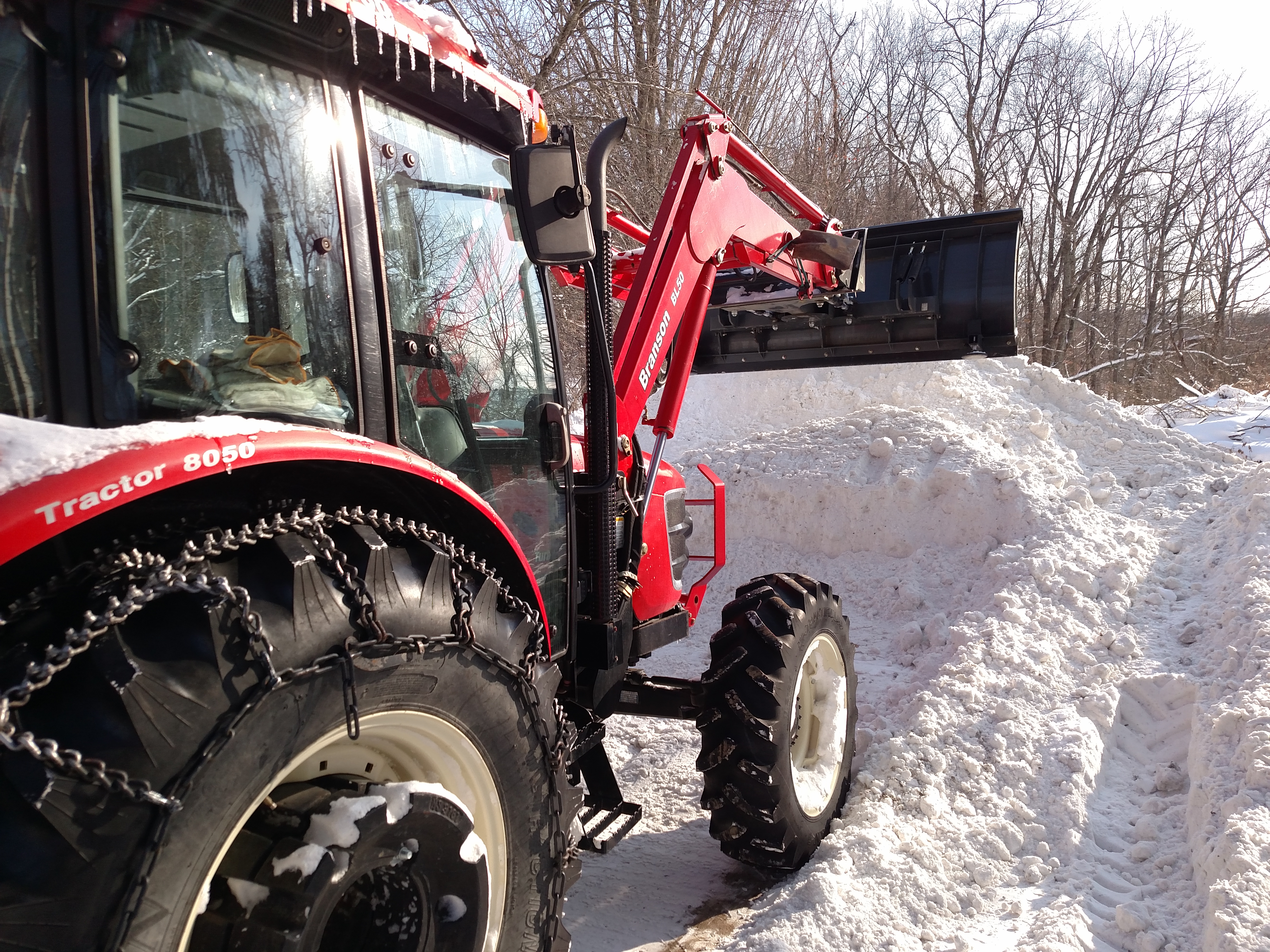

Chains that fit on the rear tire of a 4520r?
The fender looks to be toooooo close to the tire for chains to fit?
Help please?
Thank you😶

A lack of information here;
tire type and size and a few pictures.
Also the style of chain to be used and the speed it will be used at will all effect it.
100_4171.JPG View attachment snow bank 5 jan 18.jpg 100_4175.JPG 100_4174.JPG
if you travel slow clearances can be minimal the faster you go the more you need,
also this style of chain needs less then many others.

Size on side wall 16.9 x 24
Distance between tire tread and fender is 3/8”
Industrial tires

That certainly would not seem to be sufficient clearance for chains,
are your rims adjustable?
Is that to the fender lip or to the inside of the fender.
If it's to the inside can your rims be reversed to increase the clearance.
I had to move the rims from one side of the tractor to the other and space them out to have decent clearance on my 8050.

That is the lip, but it is in the center of the tire
No rim adjustments will fix that
My real alternative is to cut the lip off the fender.

Or talk to your dealer about swapping tire packages,
you have the largest R-4s for that series tractor they have two packages with smaller tires.
