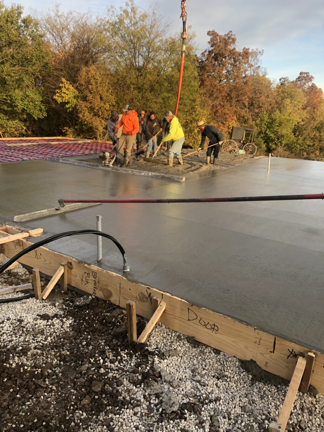

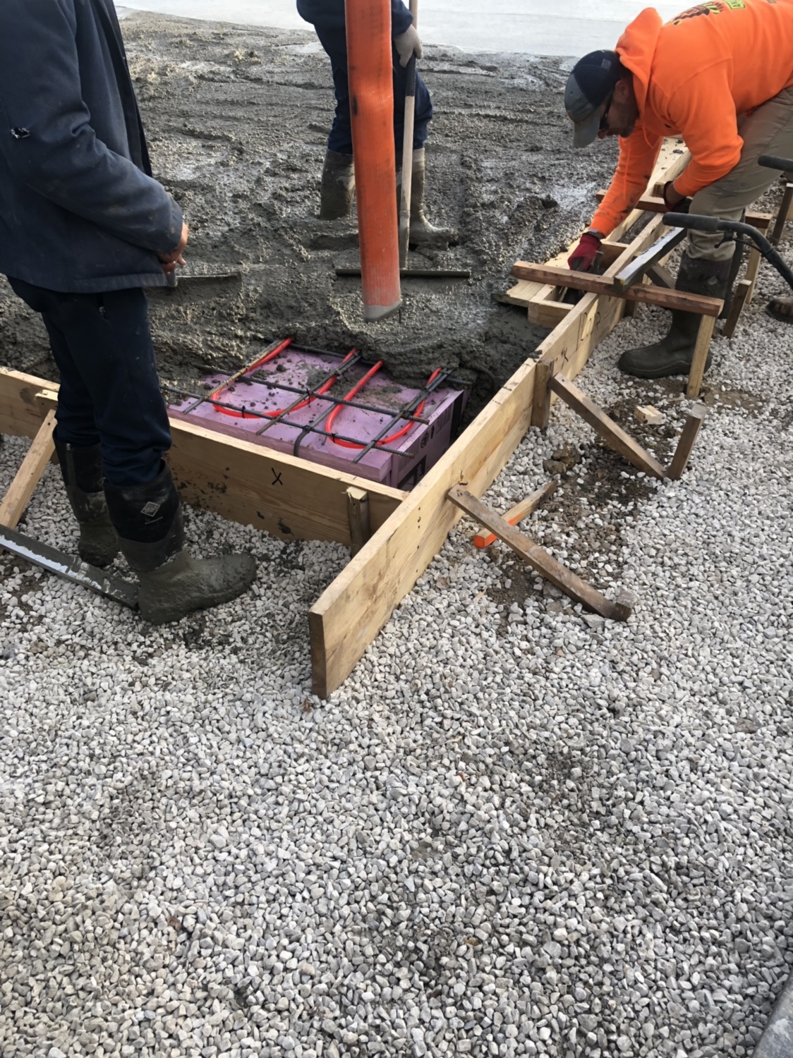

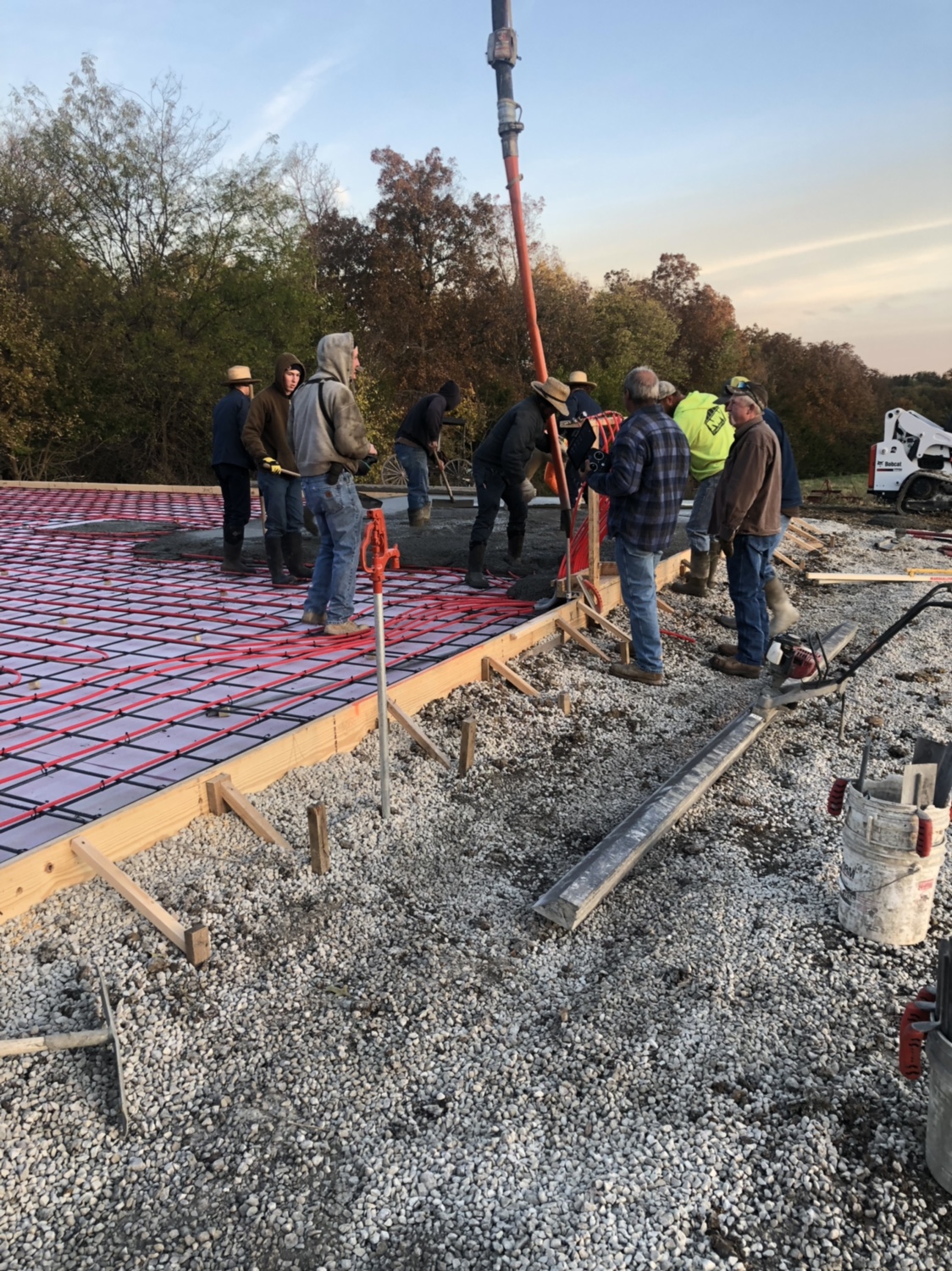

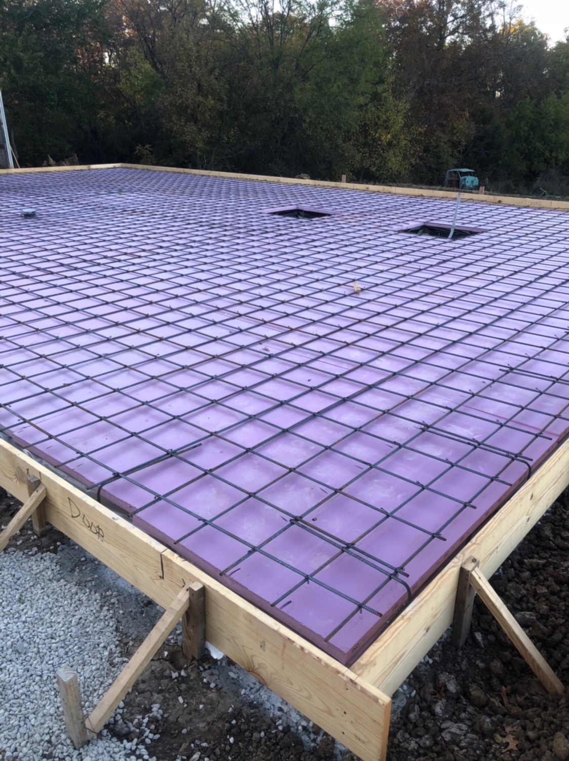

Eddie, I didn't measure, but the rebar looks to be every 12", 15" max. No way to work without stepping on it. Has the pex pipe fastened to it. For peace of mind the builder charges the pex with air and a gauge. Monitors it while they are pouring. Not sure he would do if the pressure dropped.

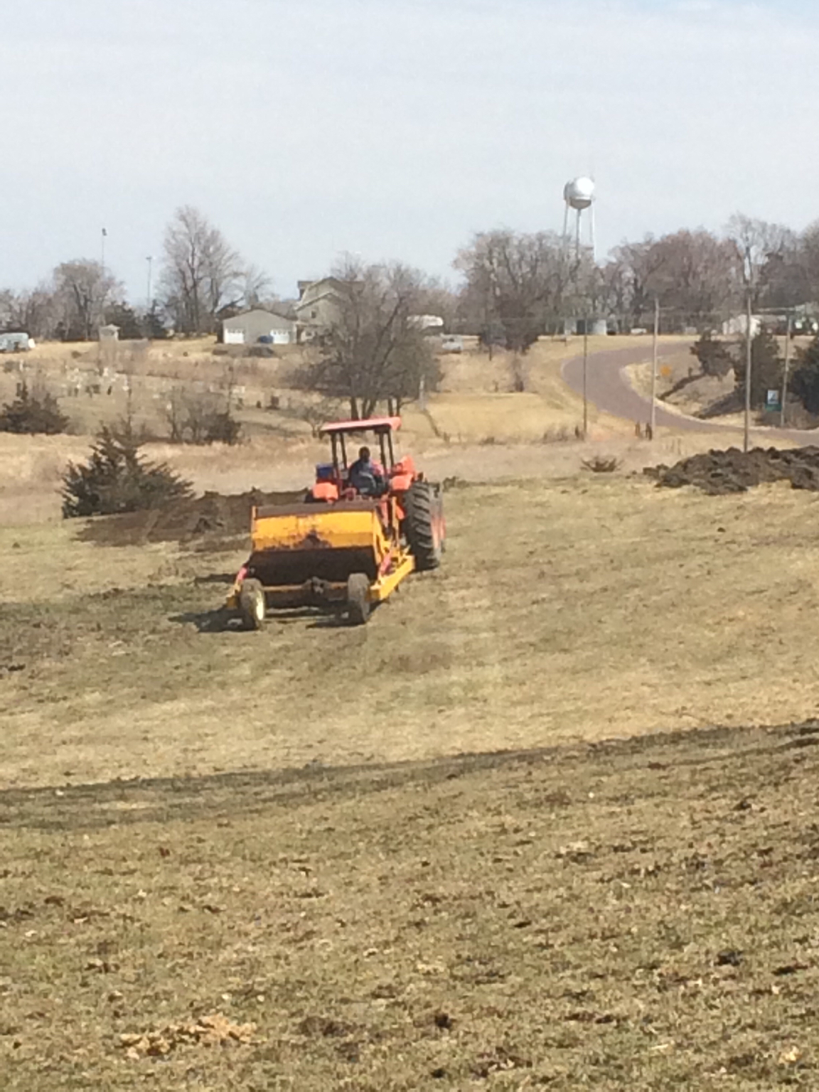

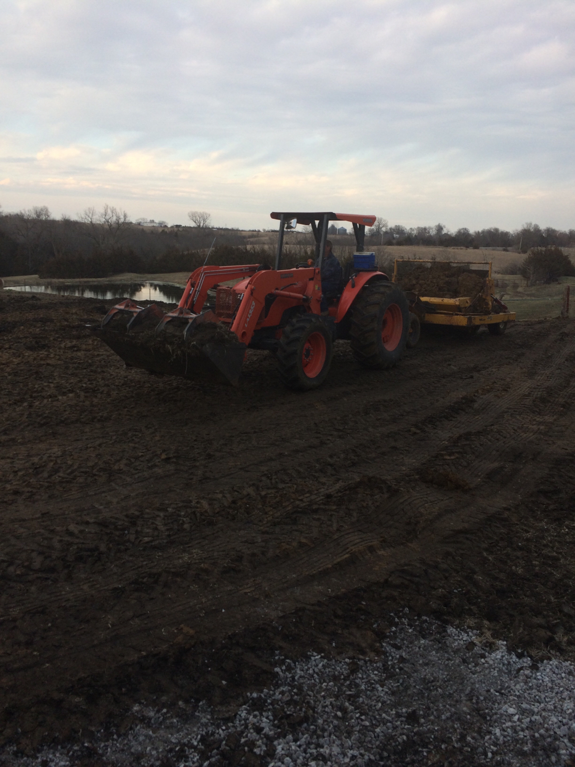

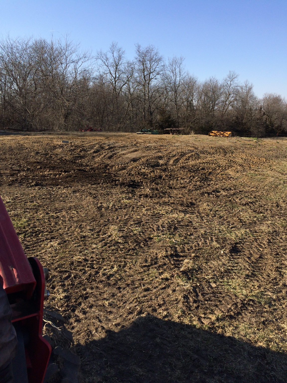

The original pad last March.

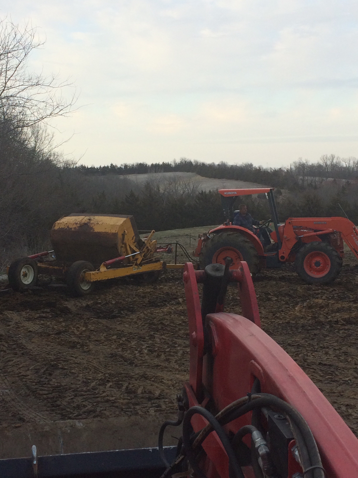

Ovrszd hauled a LOT of fill after the wife decided that she wanted to move the shop farther south than originally planned. I can't remember now how many scraper loads it was, but it was a BUNCH. I was the resident packer. Luckily, it had all summer to settle, and it ended up looking great when they did start on the shop.

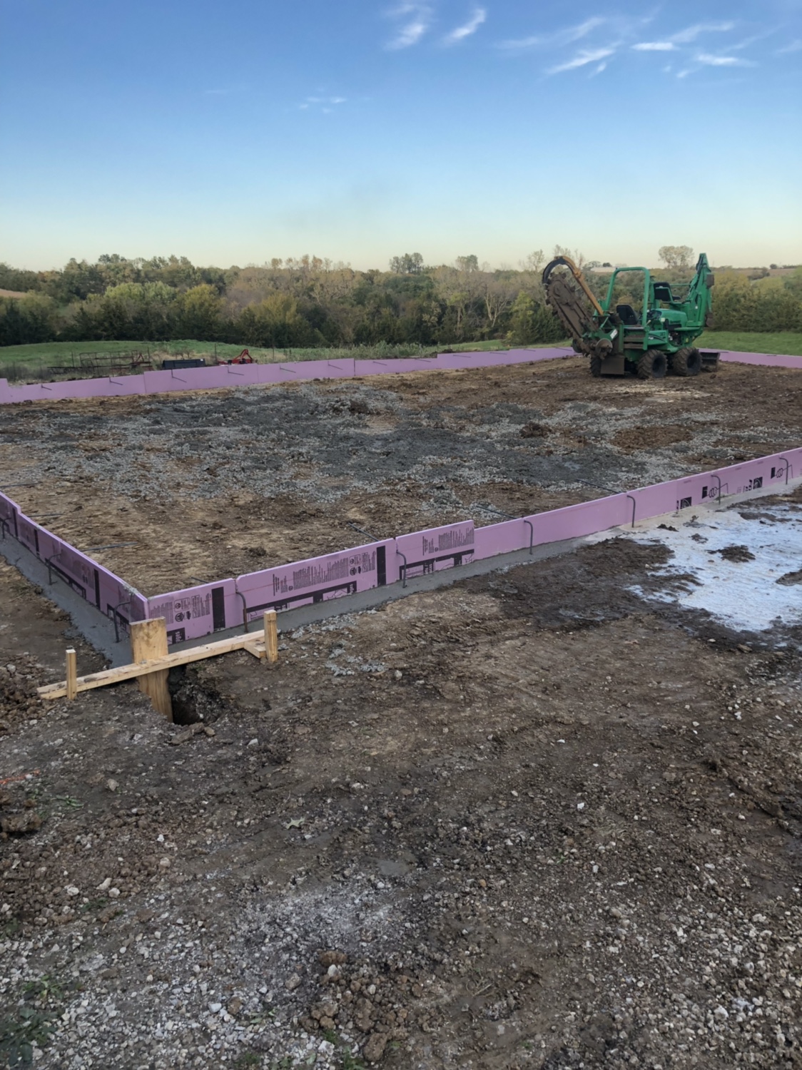

Getting the pad ready last week.

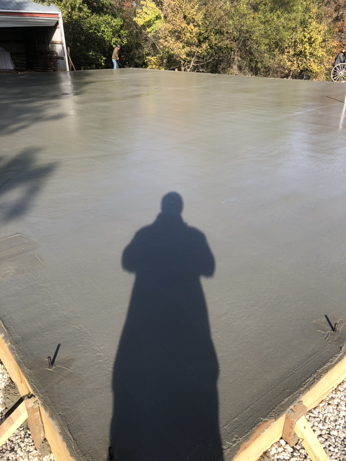

Rebar and foam in yesterday. Should get the floor heat ran today, and hopefully pour concrete on Thursday.
How much is a yard of concrete these days in yalls neck of the woods?

Ok that's cool. He did a nice job laying out the rebar.

Builder said they they were going to start framing today! Looks like they are dropping off material first thing this morn.
/ 40x60x14 Shop #29
As we talked yesterday evening, I'm surprised he's gettin on the concrete that quick. Hopefully Heath showed up first thing this morning and cut it.
/ 40x60x14 Shop #30
Was wondering the same thing on about starting the framing. I would get the slab saw cut first why nothing is in the way and the concrete still green.

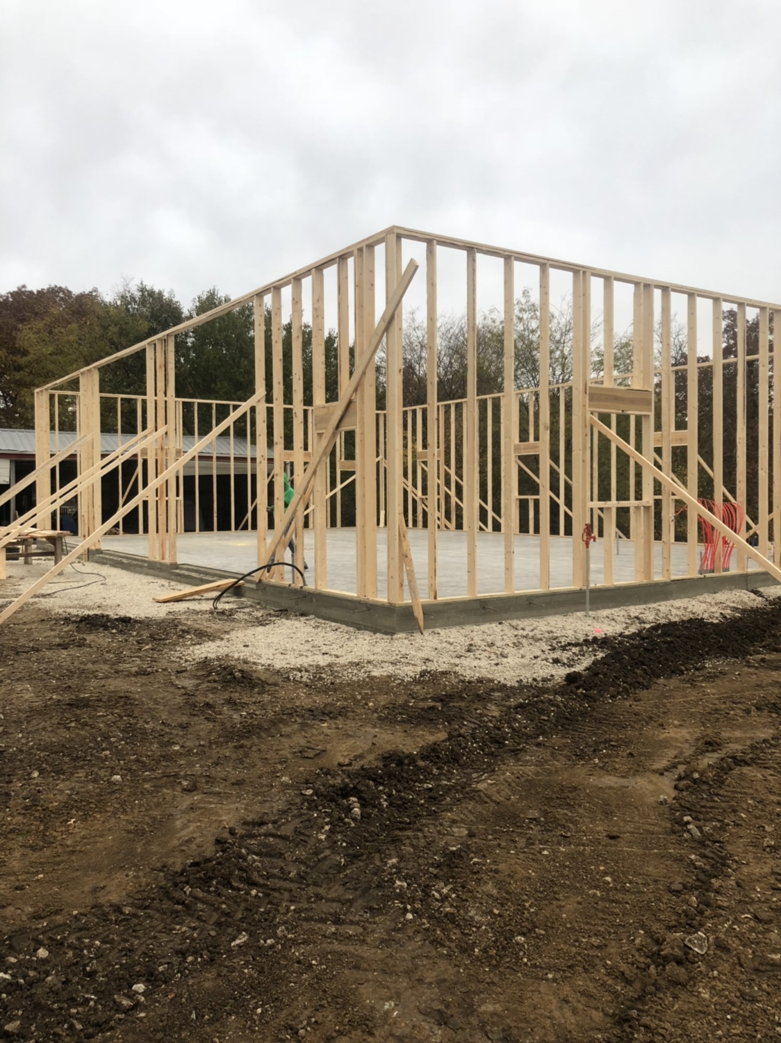

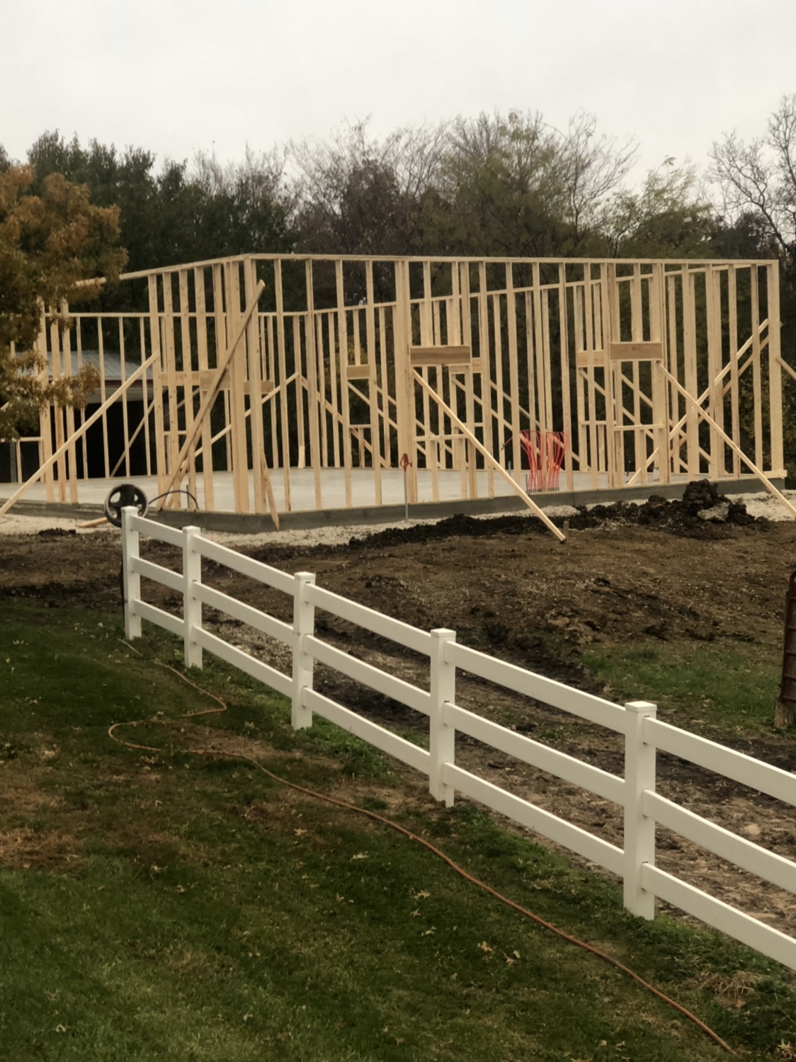

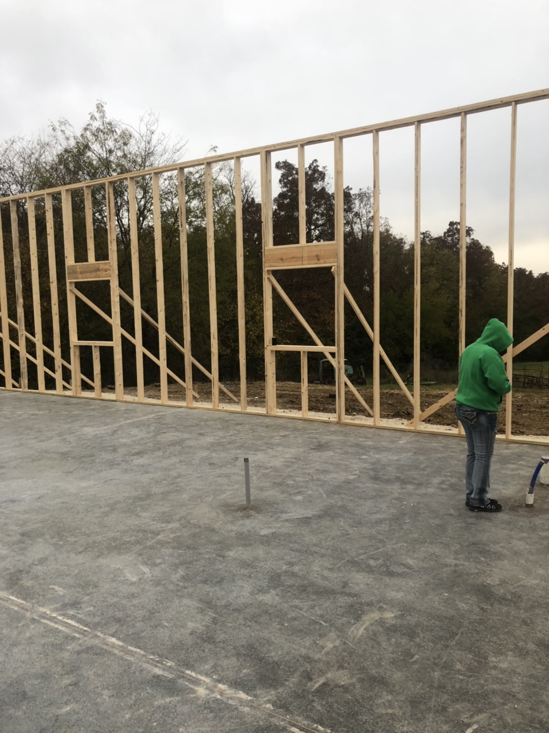

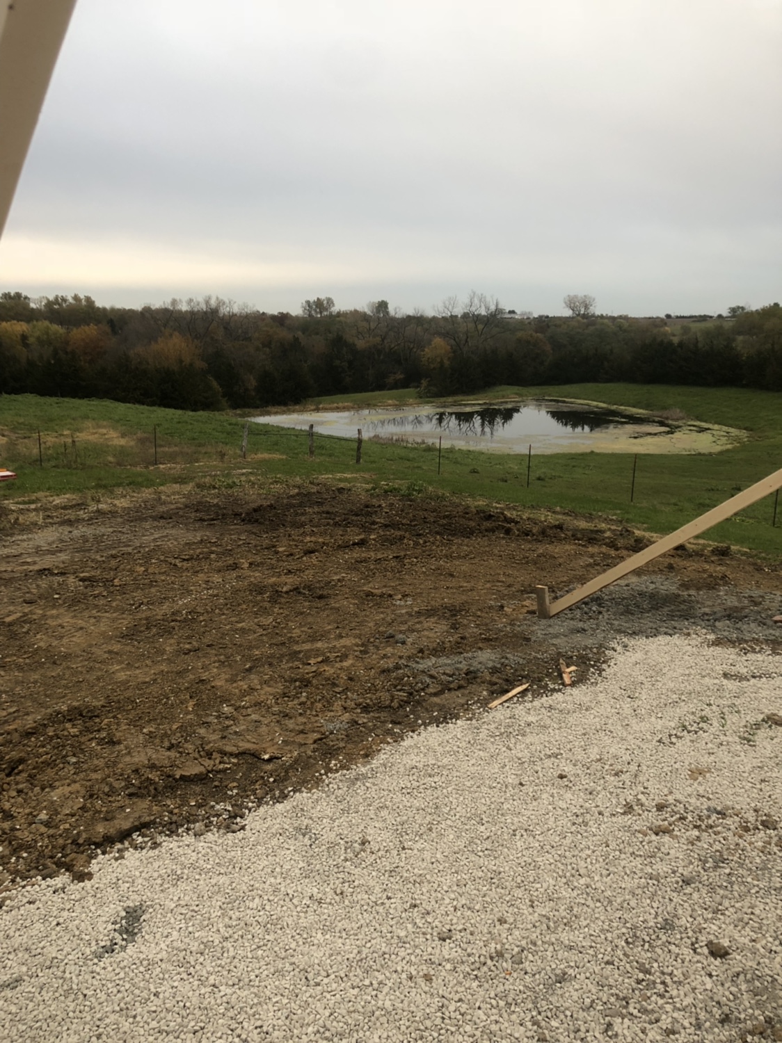

He set anchors in the concrete yesterday, so he didn’t have to drill today. They did cut the concrete in the center lengthwise and two cuts to split it into thirds. Four walls up, electric, water, sewer, and gas line run!

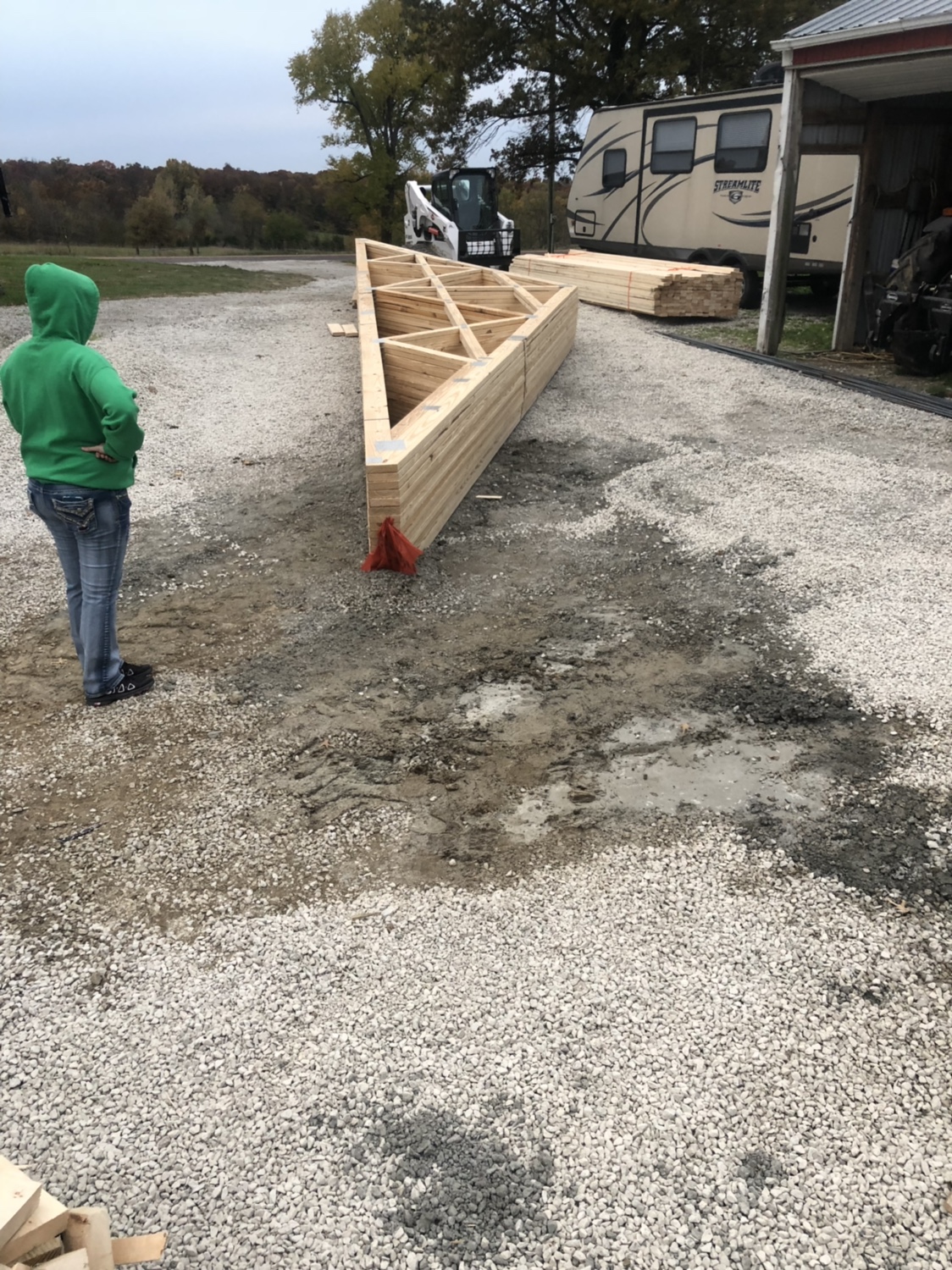

The boss checking it out!

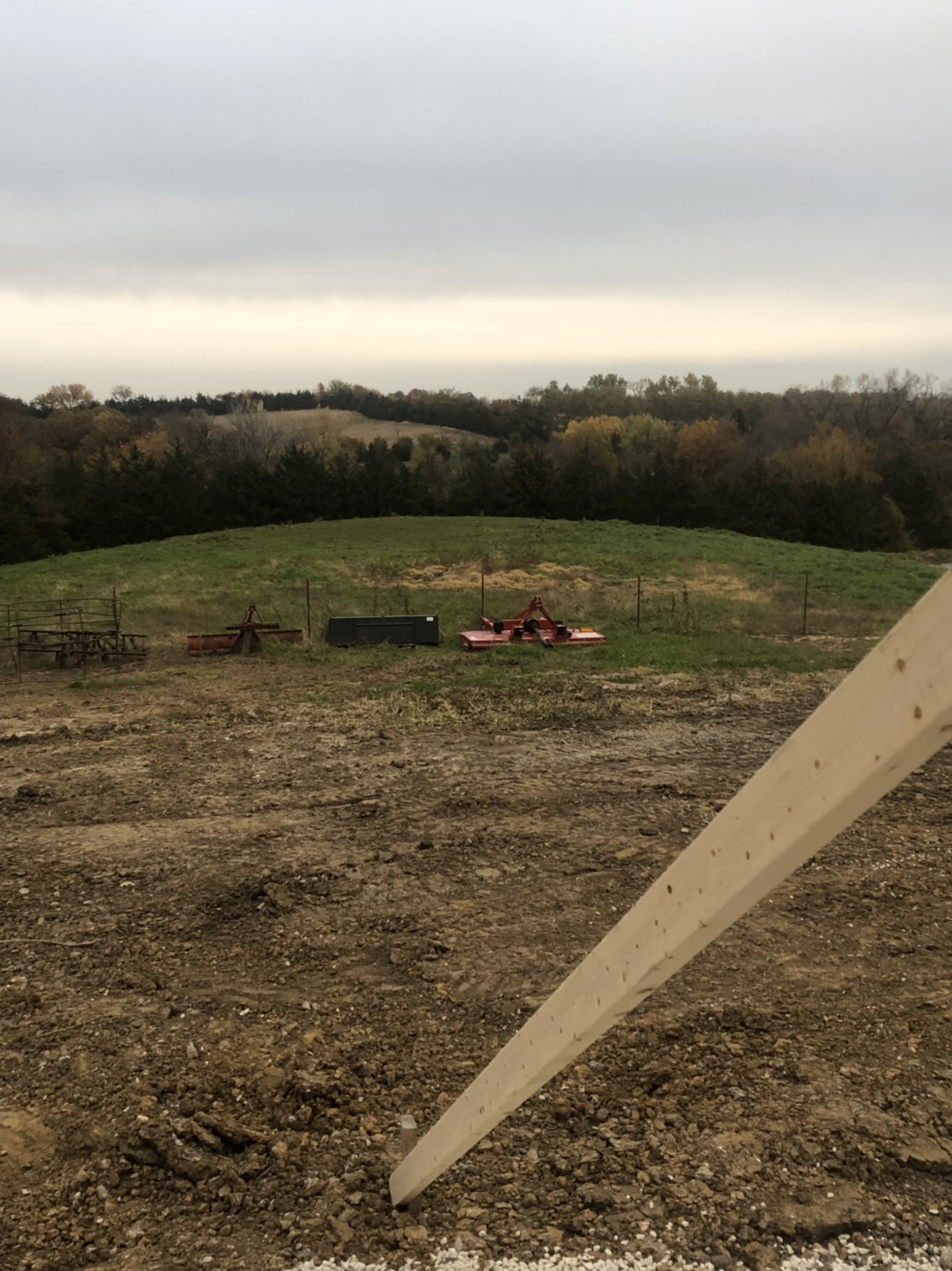

My view from the northwest window.

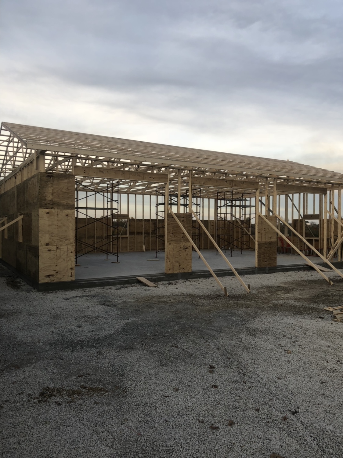

Guessing they’ll get the trusses up tomorrow and start putting sheeting on.IMG_2044.JPG
/ 40x60x14 Shop #32
Man this is happening fast for you:thumbsup: Looks great. They'll probably sheath the walls after they plumb everything then set the trusses. 14' walls need sheathing first.
/ 40x60x14 Shop
#33
Yeh I have no idea the order things will go. Two bundles of plywood sheets and trusses are on location. Pretty good chance of rain this eve, and tomorrow, so progress may come to a halt tomorrow.
