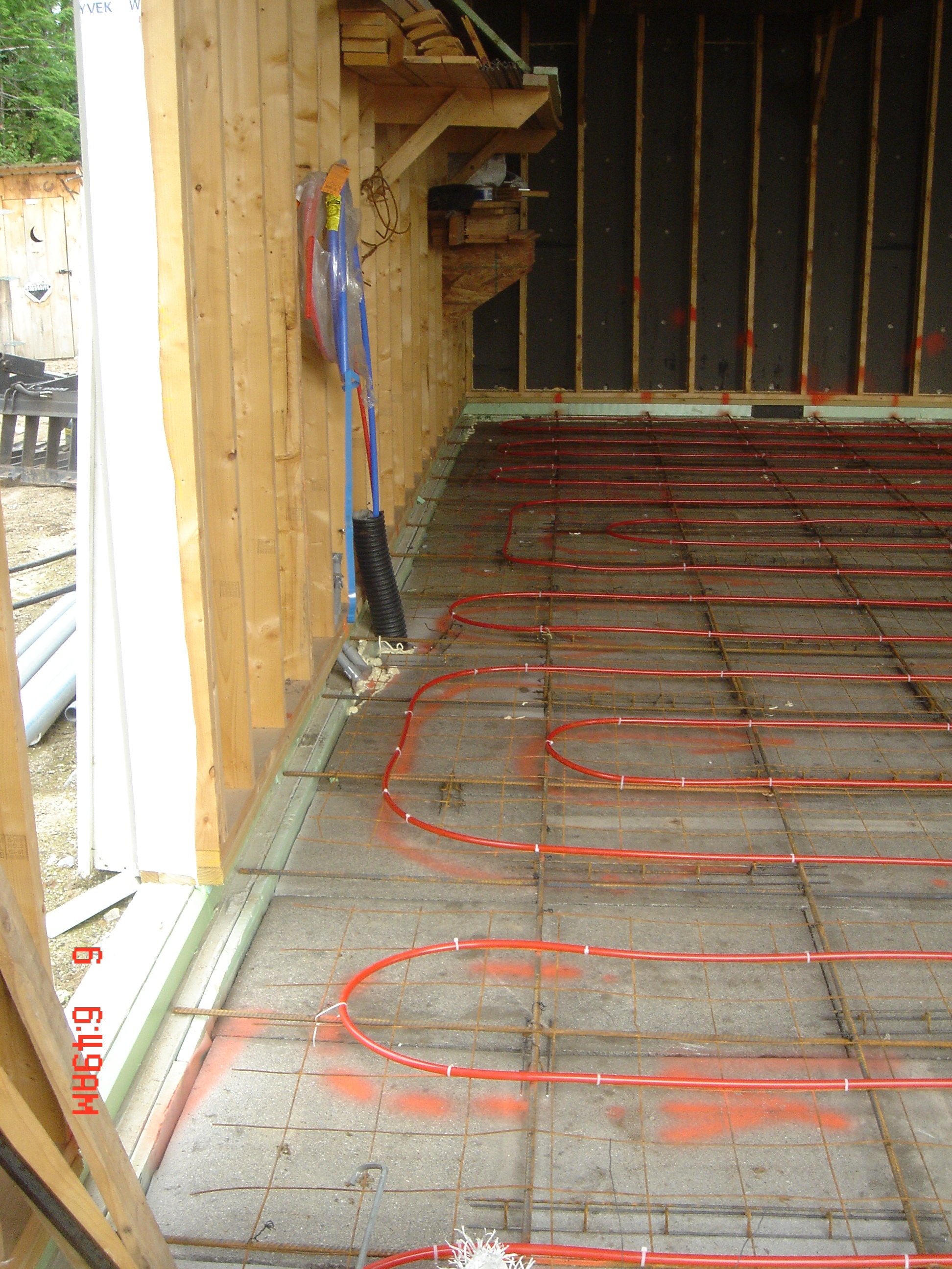

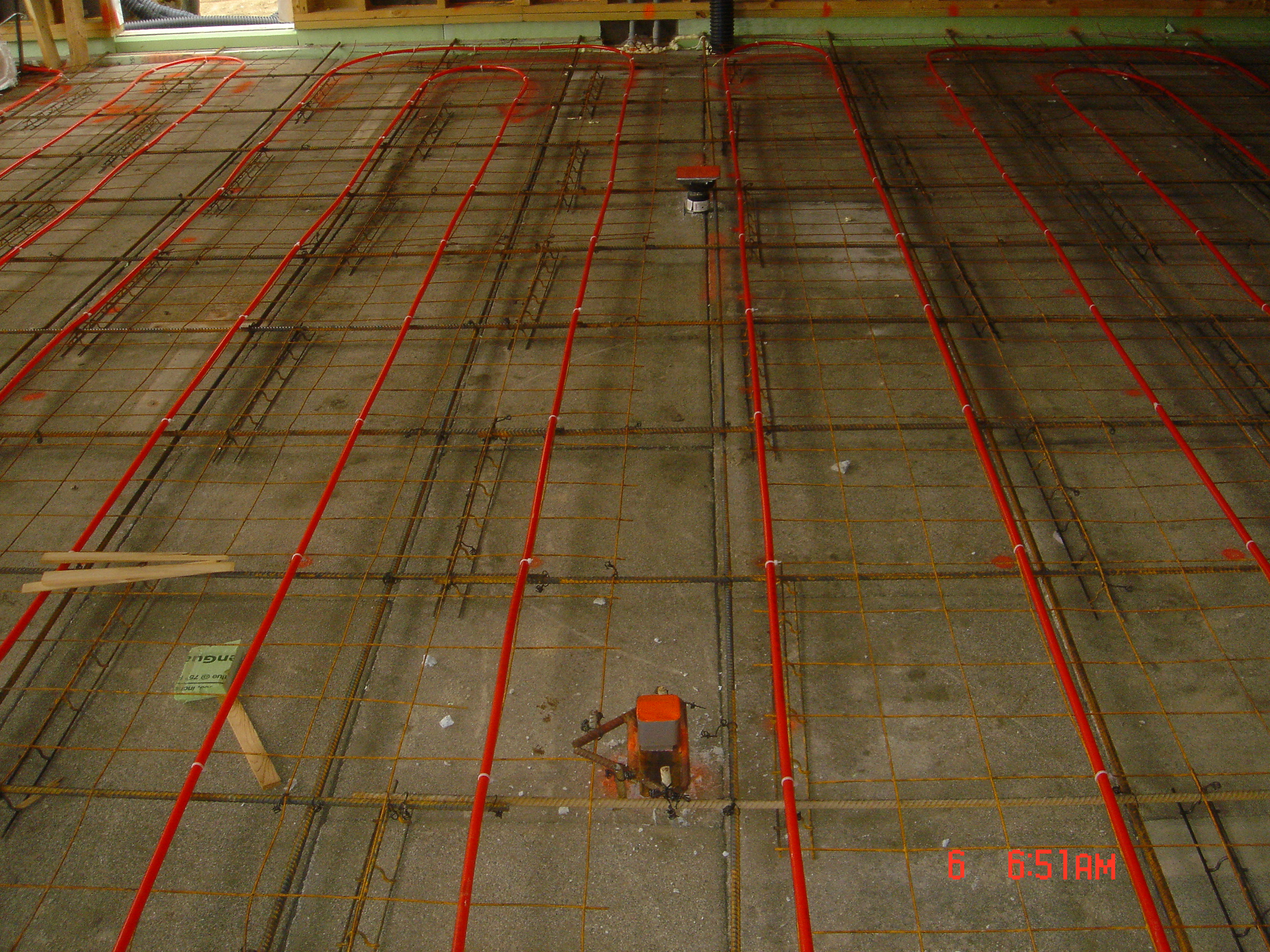

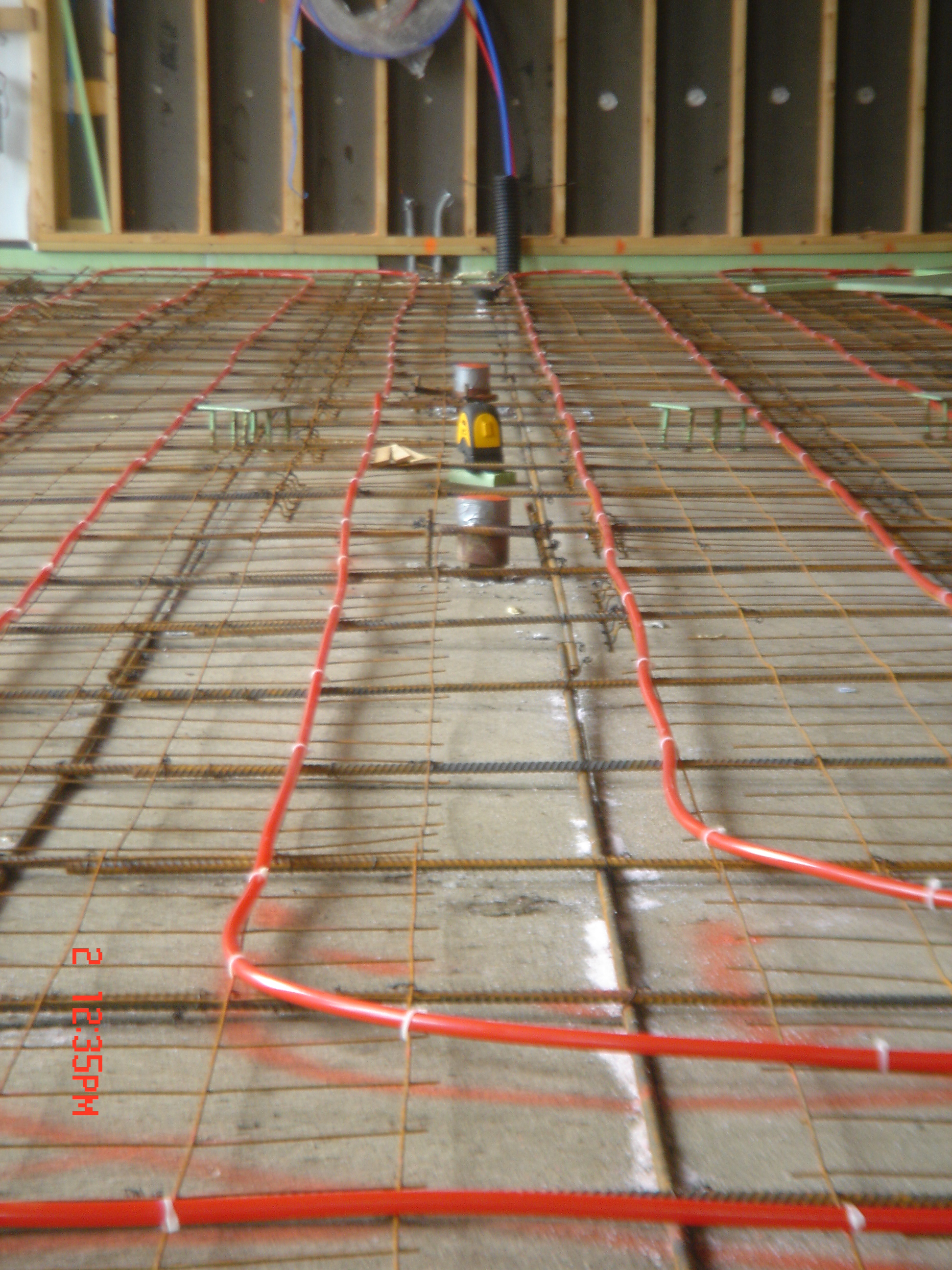

I put in "sockets" that I welded up with some rebar to hit the surrounding concrete. I bought the longest reciever tube I could find and cut it down to shorter pieces. Regular tube has a weld seam that will interfere with sliding a 2" into it.
Chain pots, I ran into a guy scraping a bunch of automotive stuff (at the scrap yard waiting for the scales) I bought about 8 of them for cheap and have them in my slab now.
All of these slab goodies only get used maybe once a year, but when you need them, there's no substitute and with radiant, coming back in and busting up concrete to add something is risky. In my previous shop I cast in a 4-5' piece of rr track (up side down) and that was very handy for some stratening situations.
Take a ton of pictures just before you pour, then when you think you have enough, take some more. Be sure you include references points. I'm in a situation where I'm adding a 2 post lift 10 years later and am sooo happy to have good pictures.

Mikester, you said to insulate...and Rusty Iron's photos looks to have 2 inch foam vertically on side walls.
Is that what you're meaning?
Not thinking you put foam under the floor also - is it just plastic vapor barrier over the stone fill?
/ Shop slab additions! #6
Both, they call it a "thermal break". I have 2" under the slab also. Some guys will just do an 8' perimeter, and foam is expensive but well worth it especially if you have plans to be there for years to come. :thumbsup:
/ Shop slab additions! #7
Rusty Iron, that floor you laid looks pretty well done...welded bracket supports for the rebar, foam holding it up around the edges, nicely tied down PEX. Sweet!
Have you used the floor heating and does the density/layout of tubing work for you?

Looks great. I just did a floor with rebar, WWF and foam insulation.
Soon will come the succinct “expert” concrete inspectors telling us “amateur contractors” that rebar isnt needed :rolleyes:
/ Shop slab additions! #9
I'm curious - you have both rebar and mesh for your reinforcement, do you need both? I always thought one or the other was sufficient. I've never seen both used. Also, what does your concrete guy say about having the reinforcement on chairs, most of the ones I've talked with say they can pull it up into the concrete during the pour so they don't trip over the rebar during the pour. (I've never seen pulling it up work all that well though.)
Thanks, and this is my first radiant I've done or experienced and it's very nice. Last shop I built was insulated walls only with a propane ceiling hung heater- pretty useless with 16' ceiling, and the ceiling fans blowing down basically just felt like a cold draft not to mention opening a 12x12 garage door (even at a Nascar pit stop pace) put you back to zero. And this was in central MD.
The radiant system was professionally designed and in the shop is all at 18" spacing but he knew my insulation values for the slab ceiling and walls.
Your right, they never pull it up! :laughing: With radiant heat that becomes more important.
I like steel in the slab, maybe old fashioned but for the most part, all concrete cracks and rebar and wire keep it together (I've always been told) and this being my first with radiant tubes in it really gave me concern. The wire gave me a perfect layout for tying the tube to and in my opinion, slightly providing some protection during the pour.
I have a friend that's a fairly big concrete contractor and he got me a full bundle (1 ton) of #4 bar, the bolsters (chairs) and the 6x6 wire panels and other misc. materials at his cost.

If you are going to add a lift you need space that you know is free of tubing to drill into the slab. I figured out a likely lift ahead of time and laid out where it would sit, then I compressed the tubing layouts in that area to either side of the mounting space so leave a tube-free zone. I took measurements and photos...now if I could only find them...:eek:

Ranger those chain pots look like what I have and I'm with you on just buying them over trying to make something.
I really don't know what their intended use is or their recommend installation is, but somewhere along the line I think I heard that in setting up a body/frame area that they commonly are installed in existing slabs and use a core drill for the holes. Are you thinking (with the PVC pipe) that it would be just a form and you'd pull it out after pouring then installing the pots later?
I've found that I use my 2" receiver's the most. I have a pair of them about 4' apart and a couple of uses are plugging in a 2 legged "sawhorse" and using a single hole to stabilize my Hossfeld bender. Then there's the 4 plates that I have cast in that are handy to be able to weld something to the floor then cutting it off and grinding smooth when done.
And the least used are the chain pots. Everyone's needs will be different and the first time you need something like this it'll just make your day. :thumbsup:
