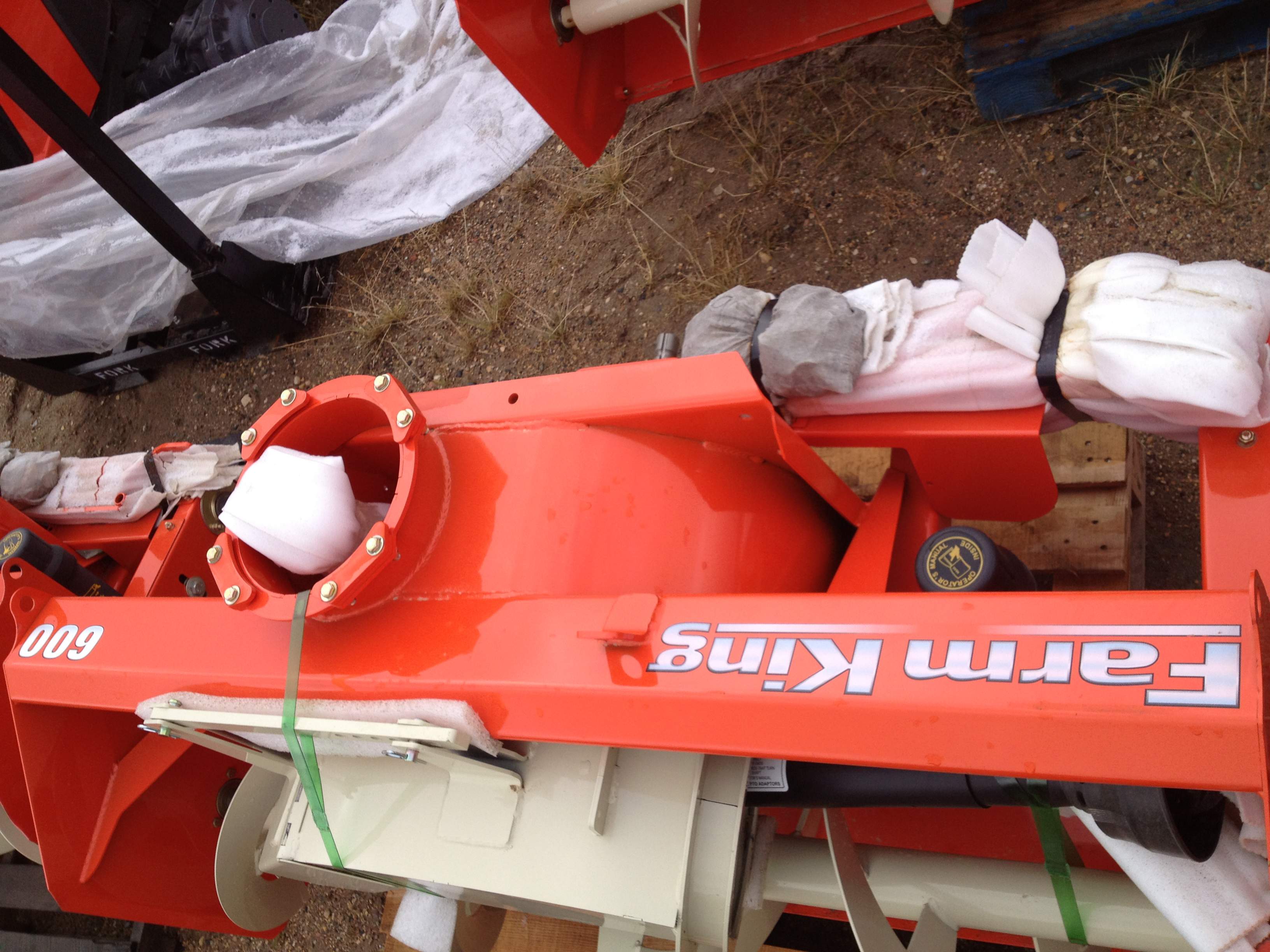

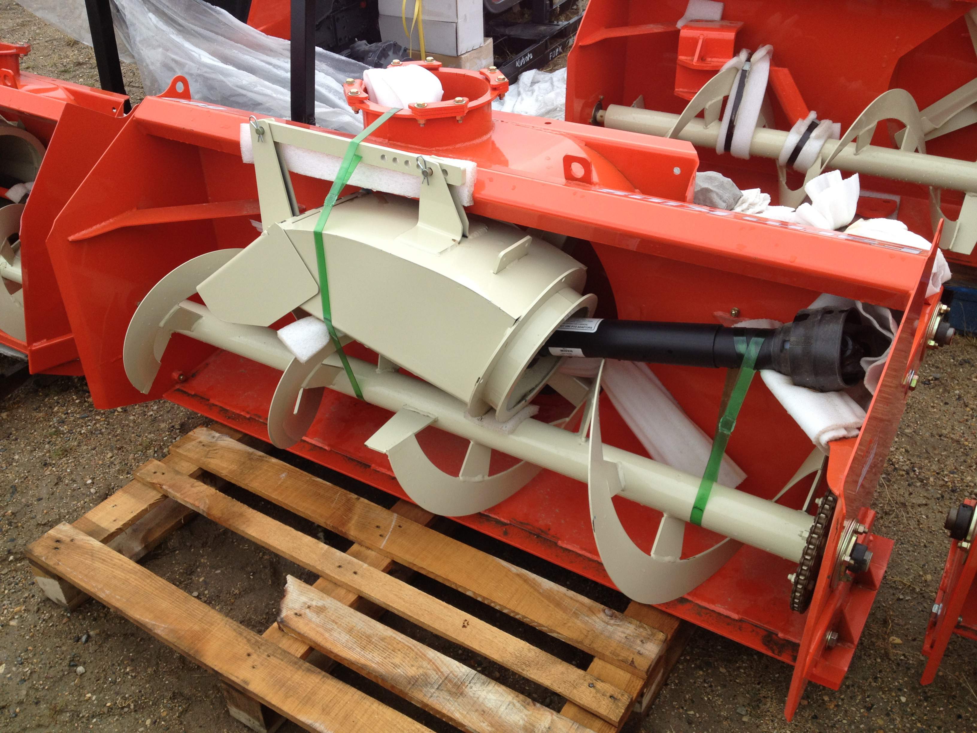

I ended up going with the Farm King Y600. The price was only $100 more for 10". The fact that the rear wheels are 46 1/2" it barely covered the tracks and I expect to do some turning. I was impressed with the quality of the welds and the overall appearance. I believe that my CS2410 will be able run it fine for my needs and will take a smaller pass if I get heavy snow. Time will tell as there is no snow yet. Going to set it up tomorrow and will post some pics. As I found it very hard to find any orange pictures anywhere of the Farm King I am posting some.
