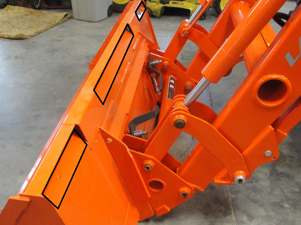

clee4020, Yes, I reinforced the back of the bucket with a 1/4x4 flat plate. I'll try to find you a pic. I like the slip hook in the middle and use it a lot.

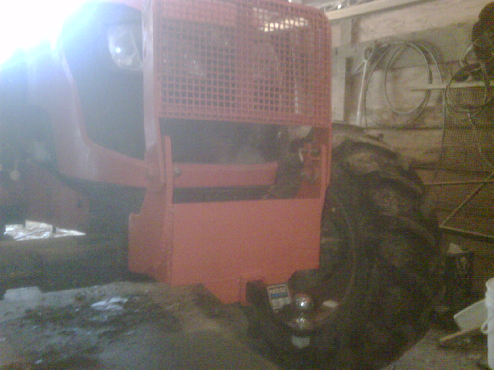

I am not finished with it, mostly because of 11 month twin girls in the house now and my job. When I am outside playing I normally have farm stuff to tend to so the tractor doesn't get sit in the shop much, but here is my brush guard mod. It has chain box and receiver hitch. Grill Guard Painted2.jpgGrill Guard Painted3.jpg

I am not finished with it, mostly because of 11 month twin girls in the house now and my job. When I am outside playing I normally have farm stuff to tend to so the tractor doesn't get sit in the shop much, but here is my brush guard mod. It has chain box and receiver hitch.View attachment 298994View attachment 298995
I like. Good idea about the receiver hitch. As a kid I pushed many a two wheeled and four wheeled wagon around with the front hitch of an 8N Ford. I recently added a Weight Rack to my front guard. Figured out real quick when I purchased a mounted JD1008 10' brush cutter that I needed front weights!!!!

I like the weight rack too. Do you have any pics of how you reinforced your bucket. I'm getting ready to add 2 grab hooks and 1 slip hook and I was looking for ideas.

Sorry, I hadn't forgot you. My bucket is at the farm and I haven't been there for a week or so. I added a 1/4x4x6 flat piece at each end and a 1/4x4x20(guessing) in the middle. I left a gap between the two factory pieces and what I added to let debris out. What I added is similar to the factory two pieces in this photo taken before I added hooks.
/ 3pt Hitch Adapter #29

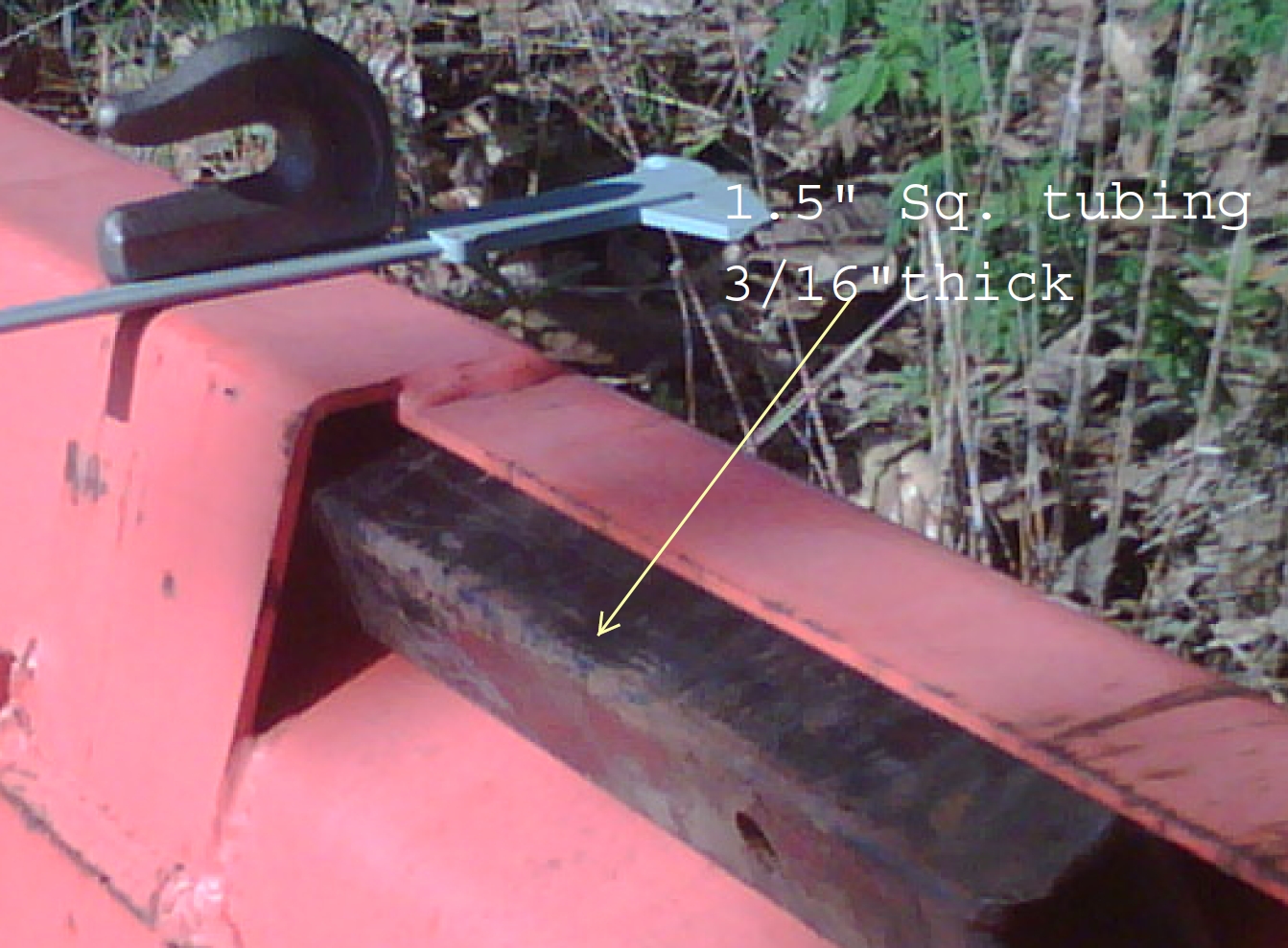

I assume your 1/4" flat bar is where I drew the black rectangles? I considered add some 1.5" by 1/4" square tubing under the bucket level indicators for added strength because I was planning on welding the grab hooks near the bucket level indicators instead of on the end like you did. What do you think?DSC05803.jpghooks.jpg

Looks nice and very functional. Good job.
