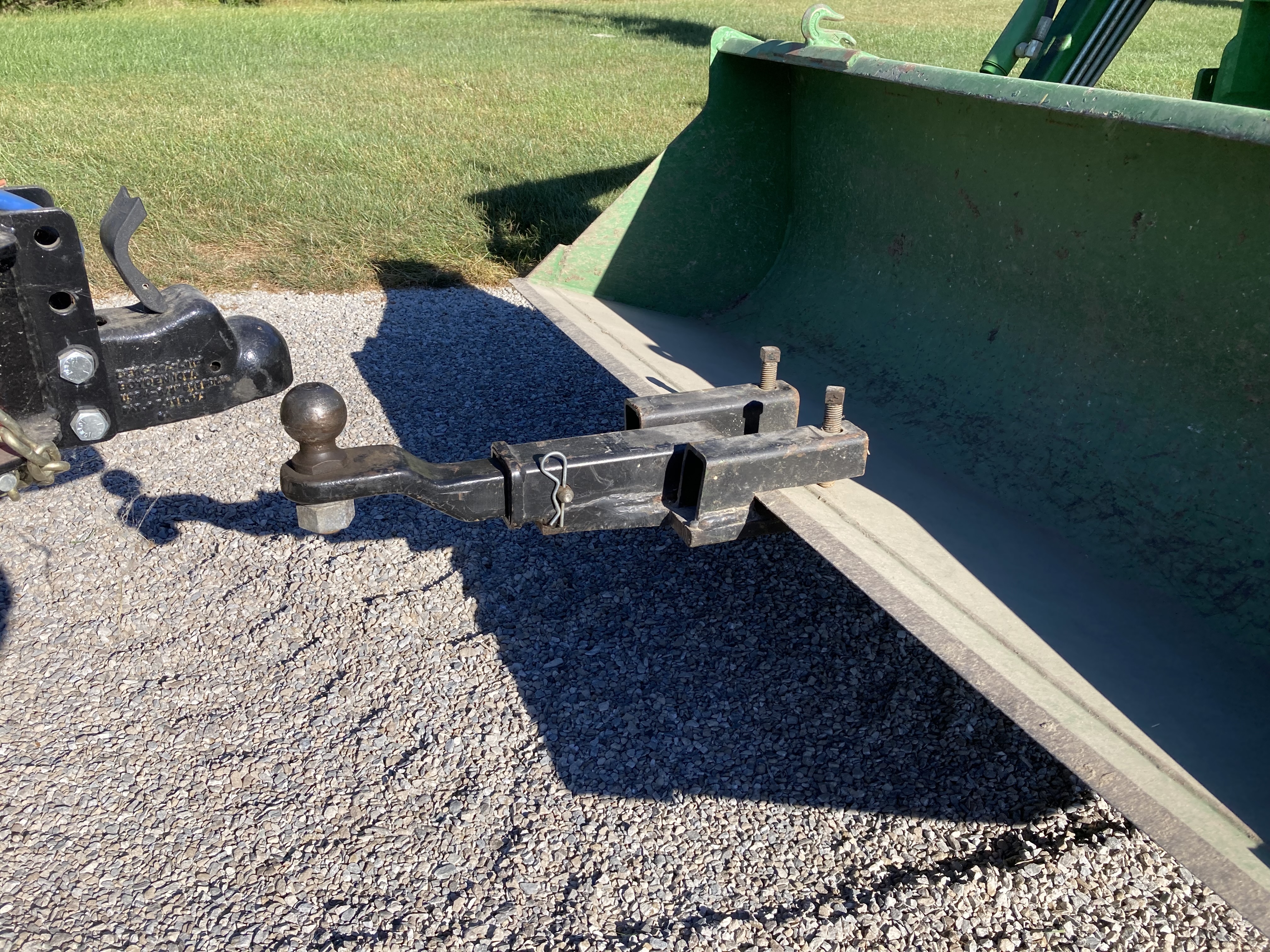

I made one like that. I used a 1/4” thick skid steer plate and I bent it moving a loaded trailer. I should have used a 1/2” plate instead.

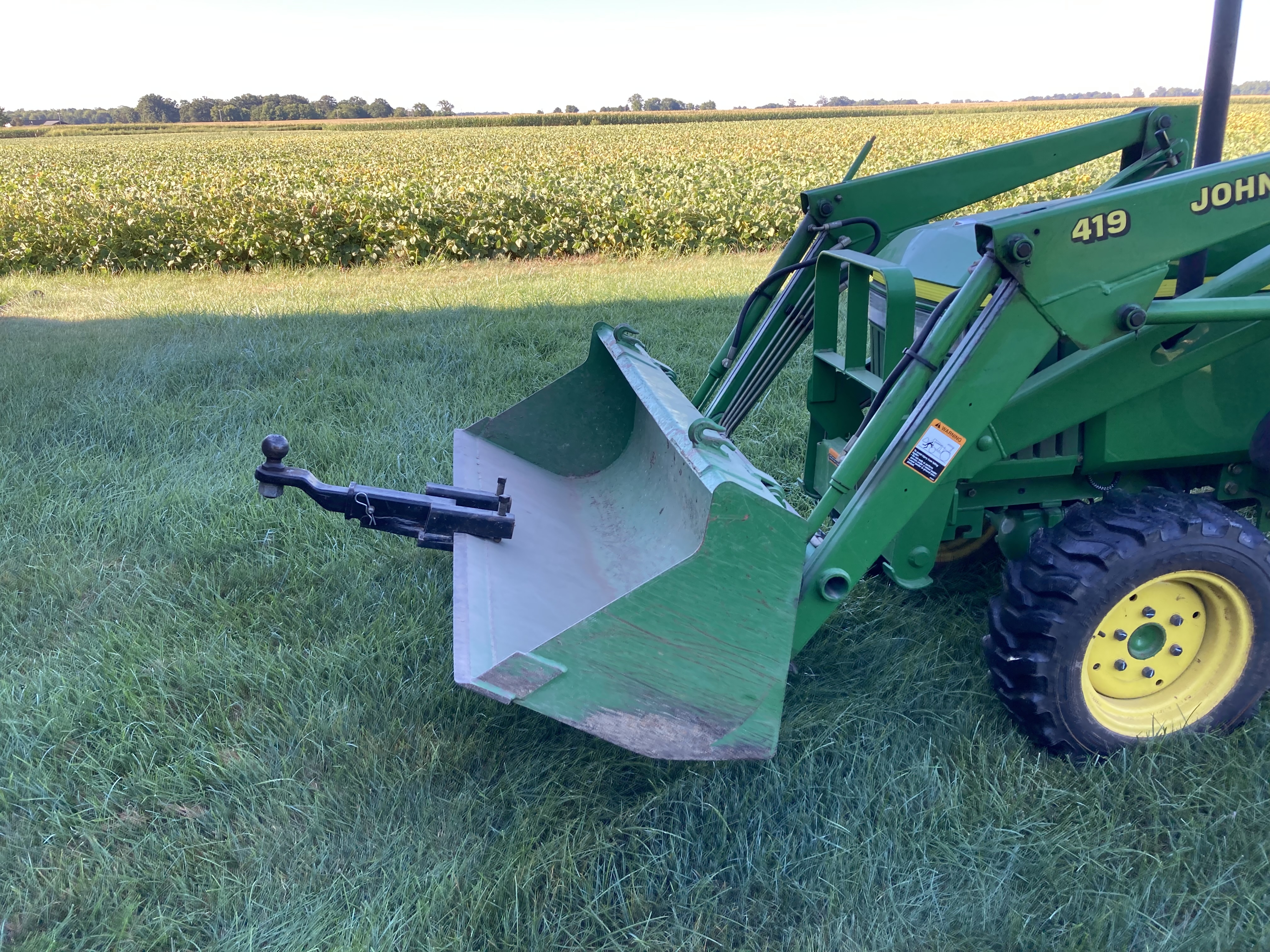

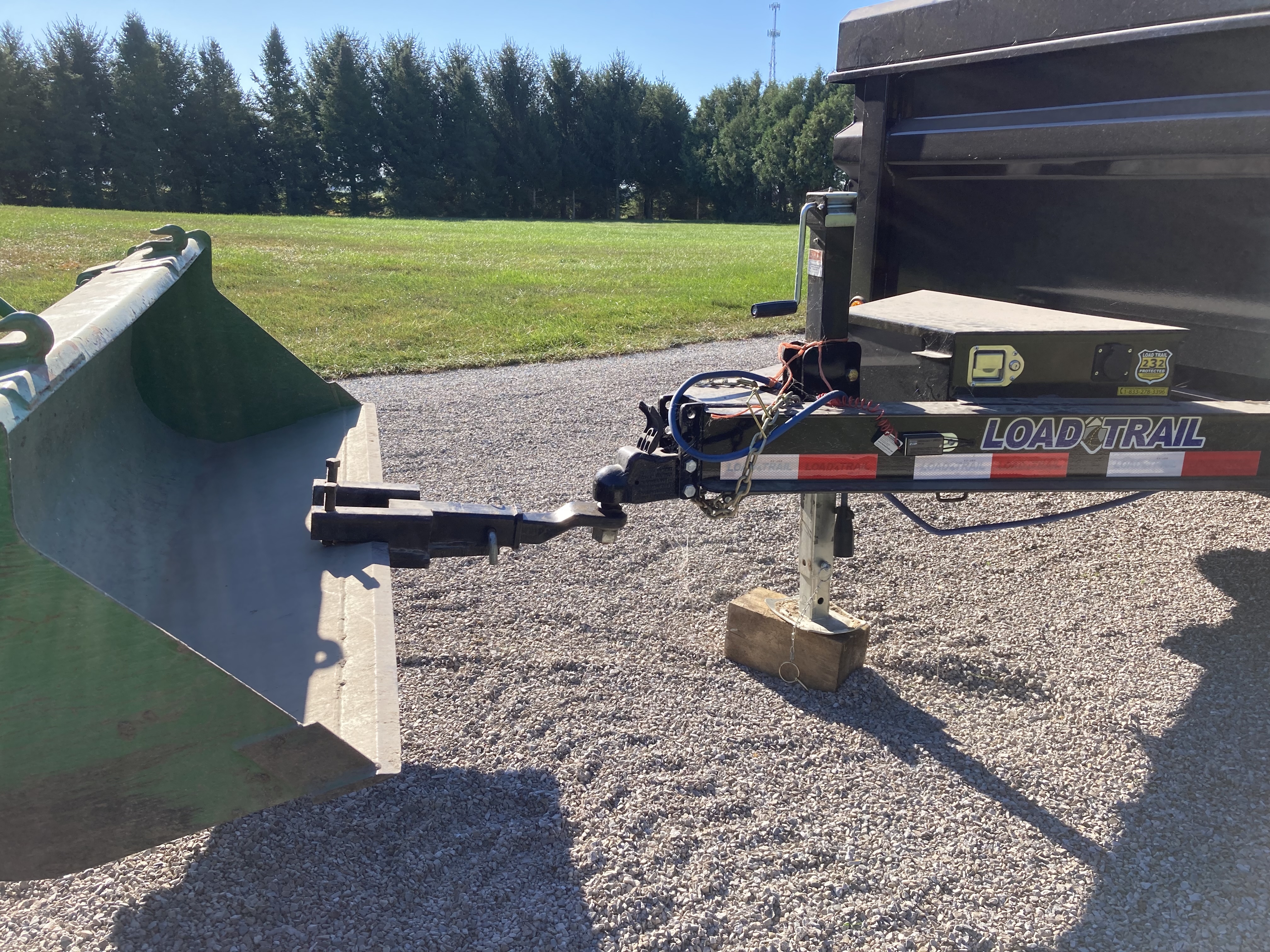

After reading of people unable to see the trailer ball while moving trailers, I thought to post these pictures. FYI. I don't have trouble moving trailers and by tilting the bucket can usually see the ball. Moving is quick and easy.
I didn't make this thing but did heavily reinforce it after it bent under heavy trailers. I got it in Kentucky with a trade and these are not my welds. It just an extra long bucket clamp arrangement welded to a long style receiver tube. By using the long style hitch and ball, the extra length makes it easier to see except when the trailer is real low to the ground. Then I have to crook my neck or lean forward.
The extra-long makes it work and I can usually hook up in seconds. Surely others have made better so if you have a pic, post it.

The point of my using a small tractor is that it won't lift enough to bend the bucket. I've had this arrangement for 20 years and lifted many trailers and no bend yet. Think stuff out, don't overload your equipment and it's all good.
